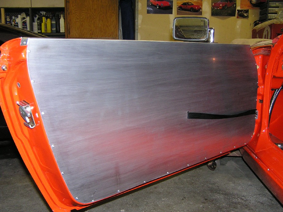

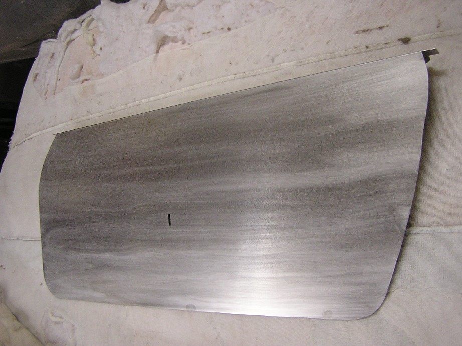

couple of more pics from the weekend.
Went to work on the door panels.
Dad cut these from aluminum sheet and had the edge done with a brake:

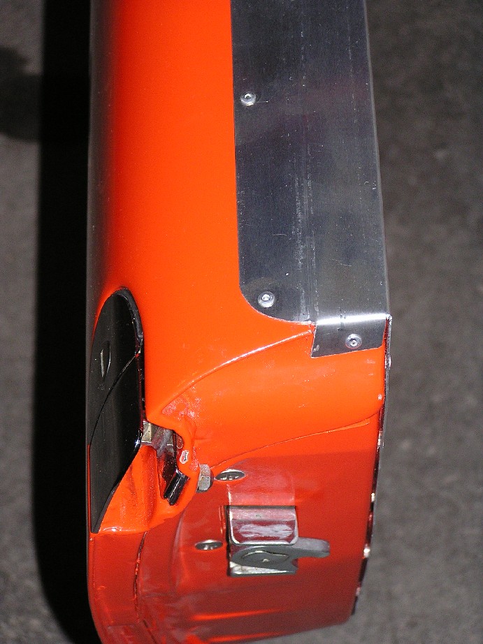

Next we riveted them on (aluminum rivets of course)
Here is the front edge:

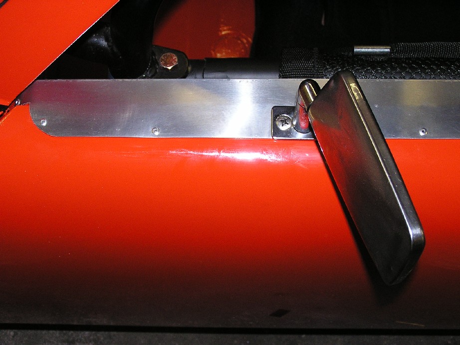

Back edge.
The top actually has two brake lines in it to get the best shape:

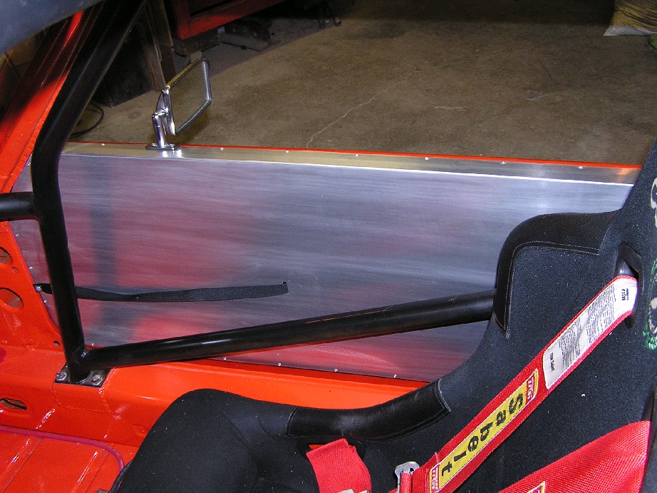

The inside strap is actually functional.
It's attatched to the release handle/lever... and can be pulled from inside the car to release the door.
Here is the drivers side:
brant
post Apr 25 2005, 04:19 PM
Post #325
Posts: 12,279
From: Colorado
Member No.: 47
Passenger's side:

I am inspired!!!! Started clearing out the junk so I can get to mine again. Great engineering and fabrication work.
Two bits of safety advice:
If that's a portable fire extinguisher, it should be within reach of belted driver
I think the washers for passenger should harnesses are too small. I used 4" X 4" welded doubler plate and then large washers shown. I think some race/club rules require this.
Keep the photos coming.

cool...
thanks for the kind words TGM
regarding the safety harness. I'll double check. I think we were within spec, but its worth double checking.
thanks
brant.

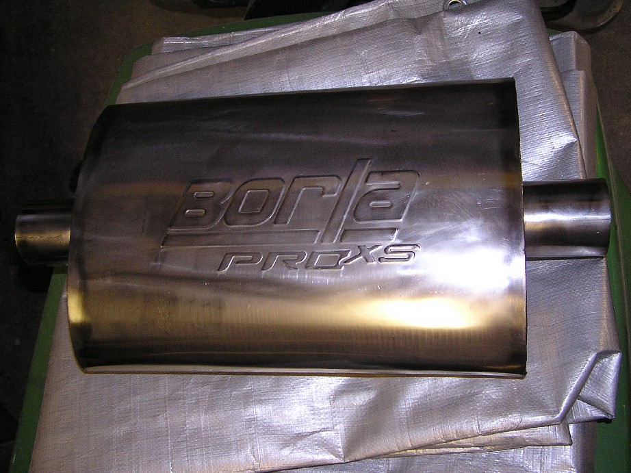

Here is the last picture from the weekend.
We got the mufflers fabricated, but not mounted as the paint was still drying.
I'll get mounted pictures next time in a couple of weeks when I get back to the car.
here is a before shot of one side.
Borla Stainless:

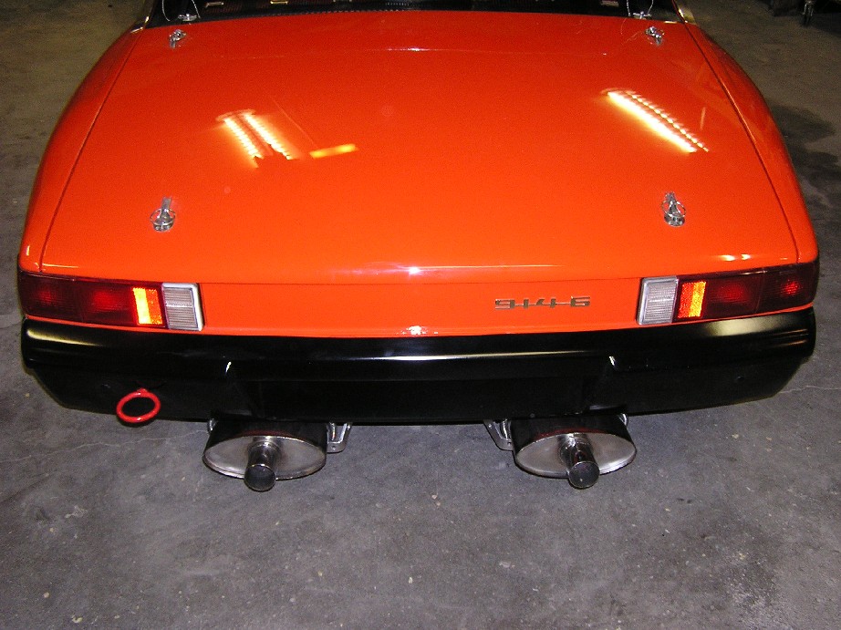

post May 9 2005, 09:14 AM
Post #340
Posts: 12,279
From: Colorado
Member No.: 47
Not too many pictures this go around.
we did get some things accomplished though.
The exciting accomplishment can not be captured on film...
In that on saturday, we started the motor for the first time.
It needs lots of re-jetting and tuning still.
but I put 2 heat cycles on it and have changed the oil twice now.
Speaking of oil I was very curious to see what the capacity was. Found out that it holds 18 quarts.
Hopefully this week the valves will get adjusted for the first time.
I've got a few shots of items that dad finished up.
Here is a shot of those stainless mufflers hung:
