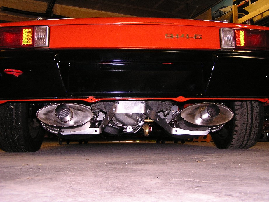

2nd view of the same. You can see dad's fancy aluminum muffler hanger bracket.
They sound pretty great really...
not quiet by any means but has a nice throaty tone:

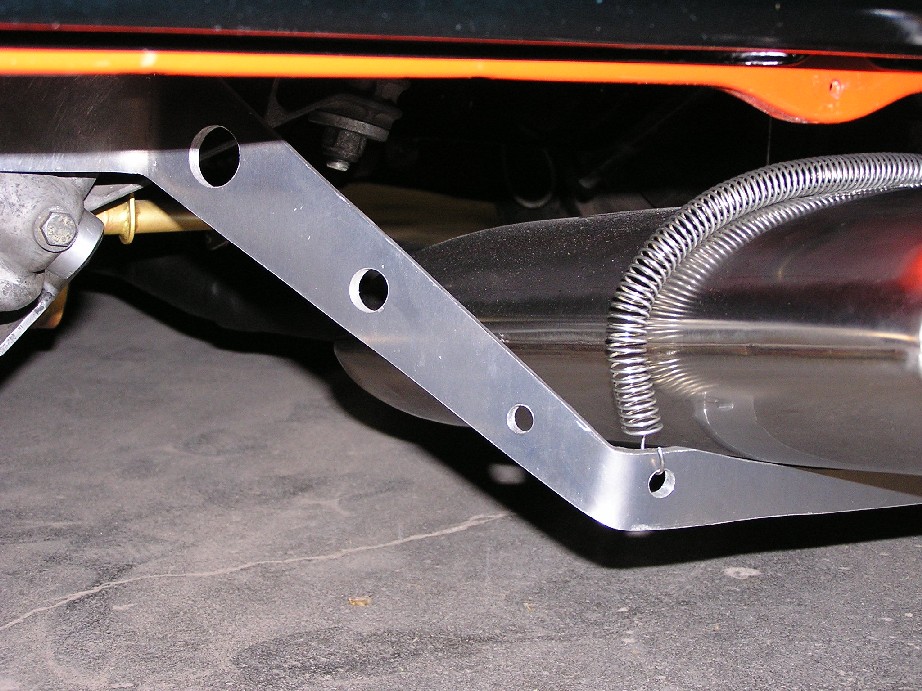

Little closer view of the same bracket:

Excellent job. I'm sure you're proud.
How about some shots of Dad?
(Can I borrow him when you're done? Room/Board/Food)

(IMG:http://www.914world.com/bbs2/html/emoticons/smilie_pokal.gif) Looking good!
But,have one question.
Shouldn't you thiking of something between Aluminmum and StainlessSteel?
A lttle too much room for vibration.

I expect the aluminum to scuff the mufflers up pretty good, but you can NOT hear any vibration when the motor is running... Something to do with the high volume (not because the hanger is quiet I'm sure)

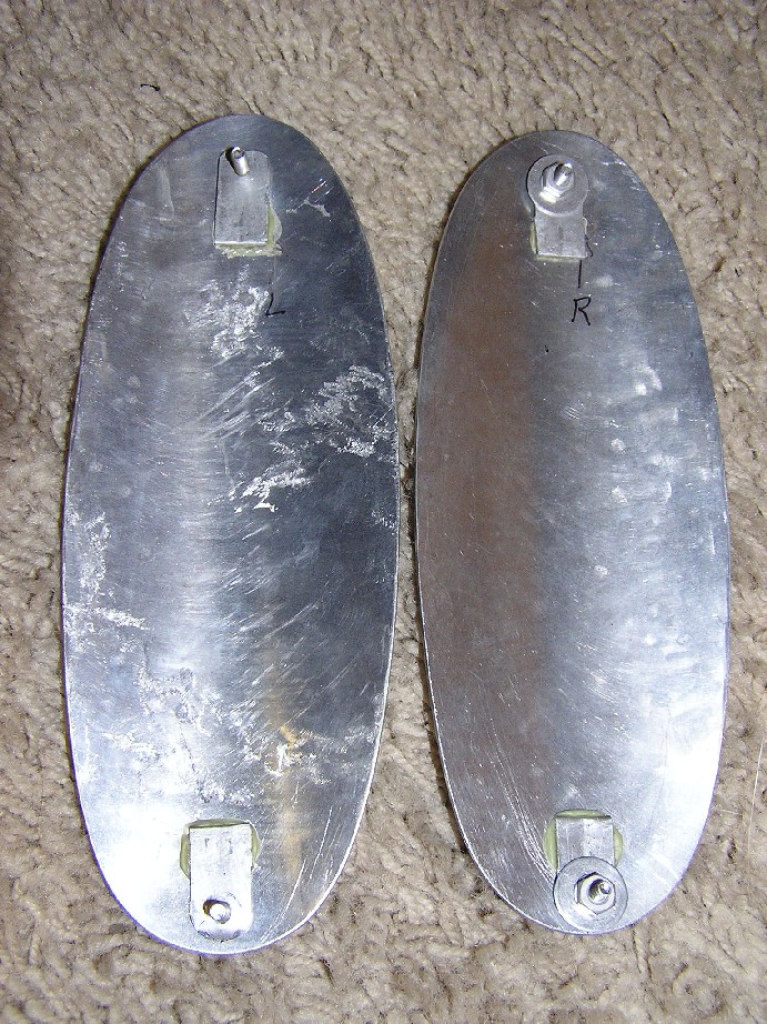

This one partly for John Kelley.
Its a shot of the attatchment method we came up with for his covers. an aluminum bolt is glued in with a retaining tab. The glue is Fusor brand body panel adhesive. One shows the bare attatchment, and the other shows the washers that will hold it to the body:

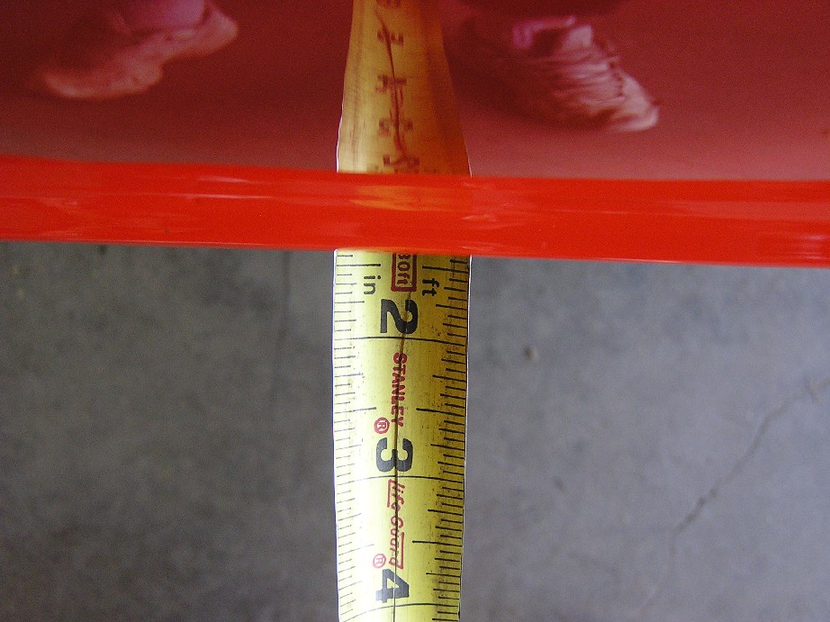

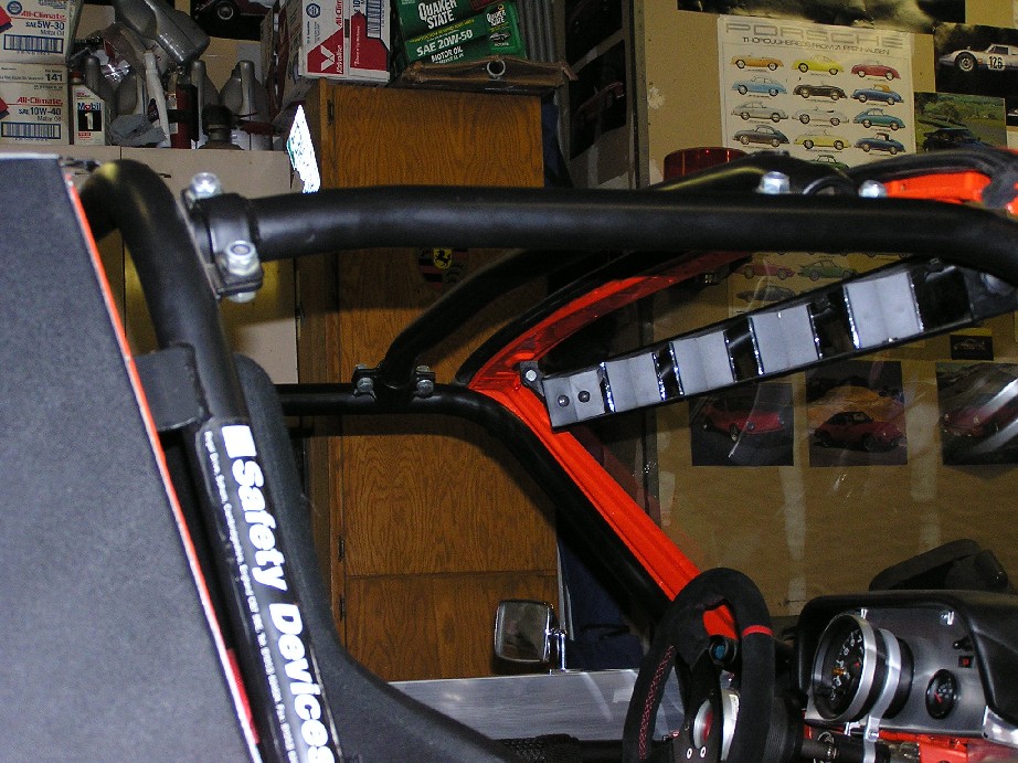

Update:
big productive weekend.
finishing up a bunch of details, and fixing things that didn't work the first time around.

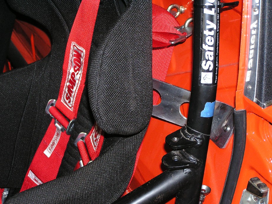

Dad took some more weight out of our seat-back brace and her is what it looks like now:
brant
post May 24 2005, 05:16 PM
Post #355
Posts: 12,279
From: Colorado
Member No.: 47
Wink mirror is installed:
brant
post May 24 2005, 05:18 PM
Post #356
Posts: 12,279
From: Colorado
Member No.: 47
7 inch wheels were put on. For now I'm running my old cookies with VERY old tires. But I figure I'm only trying to break in the motor, so it won't matter.
Here is the rear fender clearance with 7inch wheels and 225/50/15 's:

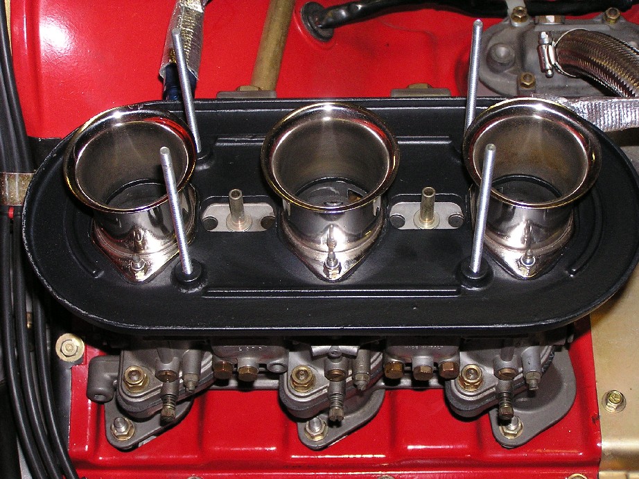

Here is the not so close version of that.
air cleaners are now on:
