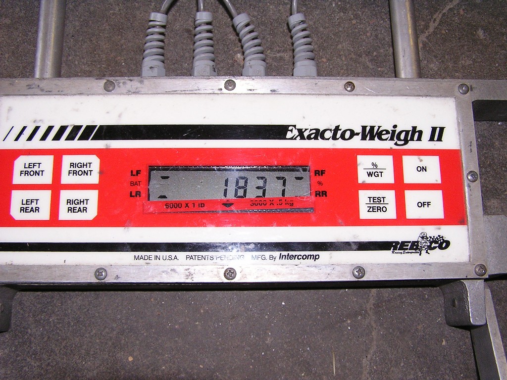

QUOTE(byndbad914 @ Aug 22 2006, 03:12 PM) *
Brant - looking good (IMG:style_emoticons/default/thumb3d.gif) So, two questions (maybe I missed this)
1. You mention doing a current corner balance, but what is the current weight of the car?
2. How much weight was removed from the hood (i.e. what was the weight before, then after the holes)? Curious as I may just stick with my nice stock hood instead of fiberglass if what you did really got the weight down...
It doesn't really get the weight down as much as you'd like.
its more of a visual thing at this point and showed only a 5lb savings
(with MANY MANY hours into it)
I'm required by rules to keep a metal car and metal fenders/hoods
let me double check my numbers..
I had already removed and lightened it before, so I think I was at 35lbs pre
and 30lbs post drilling.
regarding total weight...
this one I'm happy to talk about
we were able to get the corner balance VERY close this time
using the formula for ideal, we were able to get each corner within 1.5lbs of ideal
we re-aligned too and that came out pretty well with -3 camber on the rear now.
I shed 13lbs total (still with my heavy kumhos)
here is the new weight:

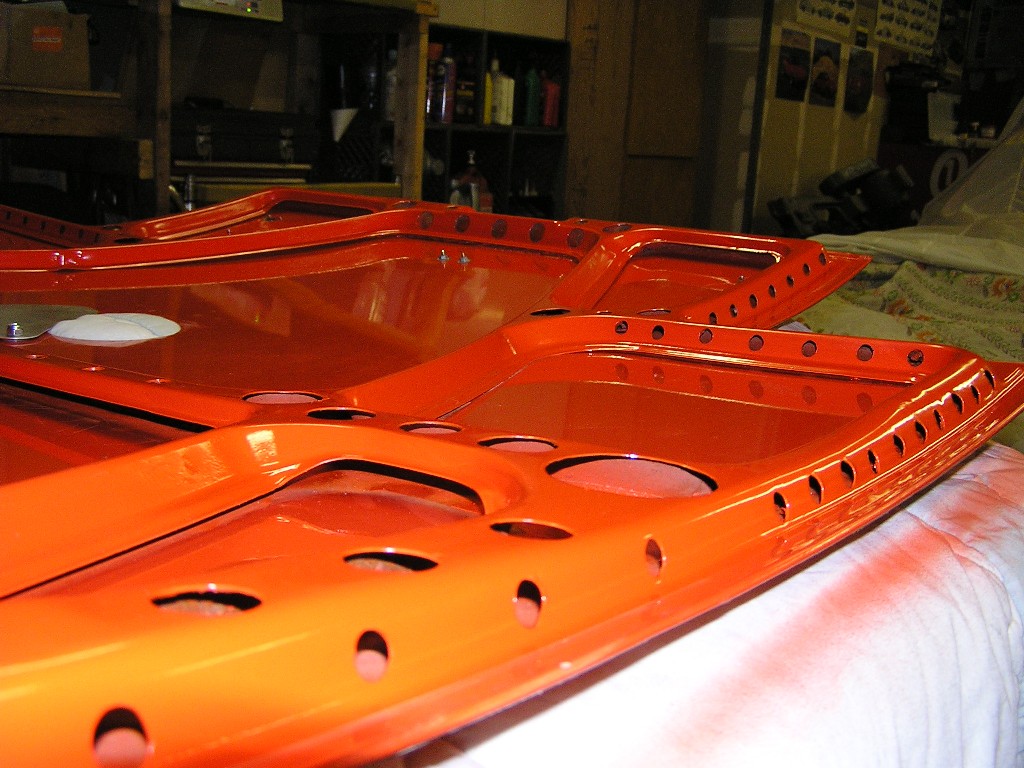

more front hood (post paint, artsy shot):
brant

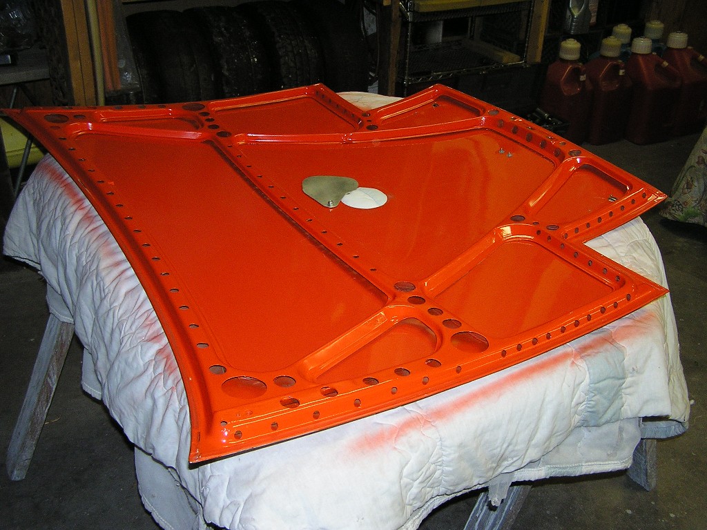

last hood shot:

honestly, I am really impressed with your car. Obviously I have a little bit different school of thought (build a brick sh!thouse and put 525HP into to get it around (IMG:style_emoticons/default/biggrin.gif) ), but the fact you have a 914 that still has the windshield, targa top, and steel body and so forth down at 1837lbs is pretty cool. You really put a lot of effort into making a lightweight 914 racer, not just "914-based" racer if you catch my drift.
I am lazy enough I wouldn't sand the roof down, I would just get a fiberglass cap for instance, which is why your efforts rarely go unnoticed (IMG:style_emoticons/default/wink.gif) Solid job on a sweet car.

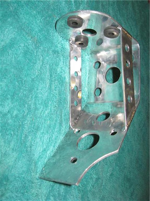

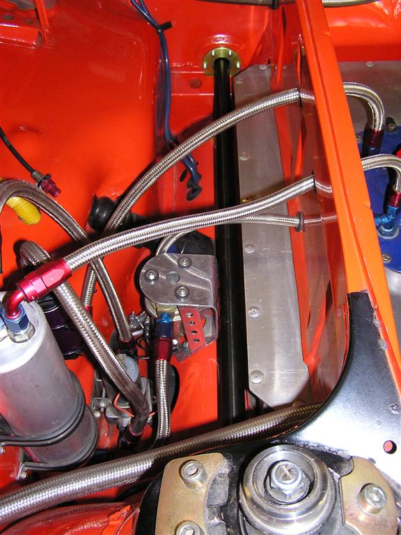

I was having fun reading this and thought I'd throw in another pic.
lots has changed... I got T-boned by a spec miata along the way
some improvements, some repairs, different flywheels, tranny's and a new lump of gold is on the way...
I did some wrenching yesterday as a matter of fact
here is the new carter fuel pump with built in regulator
its on a custom aluminum mount that dad made (with plenty of holes):

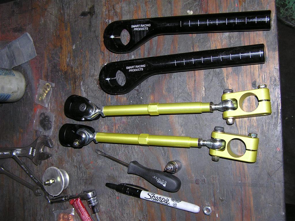

also in that picture (and this one) is the new 27mm hollow SMART bar:
post Aug 20 2008, 11:54 AM
Post #450
Resident German
Posts: 42,539
Joined: 21-January 03
From: Oakland, Kalifornia
Member No.: 179
QUOTE(brant @ Aug 19 2008, 08:59 PM) *
how much did that set you back ???
(IMG:style_emoticons/default/drooley.gif) Andy

Andy,
too much really... probably not worth it
although the craftsmanship is very impressive
Phoenix,
