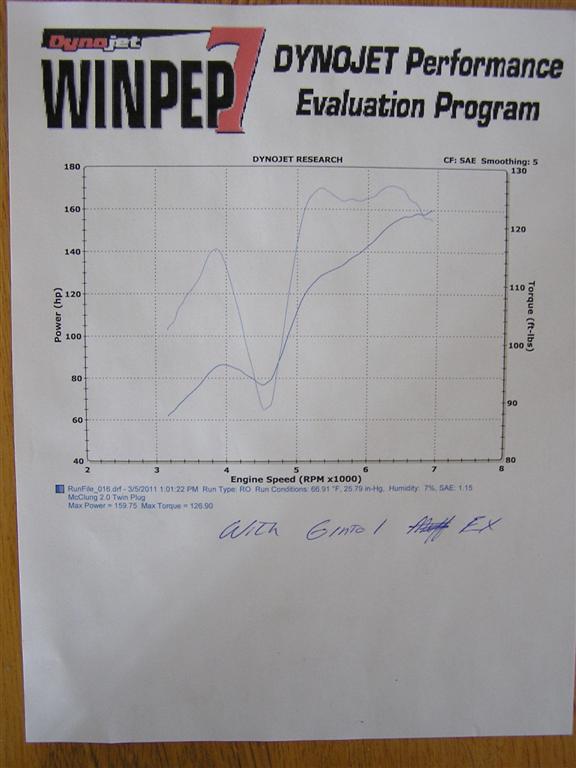

the install trip was a success
I have a few things left to fabricate and rewire
but we did get it installed, got a couple of hours of break-in time
and some rough dyno time
we had to limit the rpm since the motor isn't broken in yet
I didn't have time to increase the venturi's or nail down the jetting
this is 6900rpm with small vents and really mild timing
hopefully once its broken in we can bump the redline up, bump the timing, add bigger jets, and pick up another 10-15hp
(the hp was still climbing without hittings its peak yet)
this is at the rear wheels:

what is that dip at 4500?

QUOTE(sean_v8_914 @ Mar 8 2011, 08:54 AM) *
I think that is actually the beginning of the dyno run when he first "floored" it.
the moment the accelerators pump in and all of the gas hits the motor
we geared the car to stay above 5K, and try to never drop below 5k in any corner.

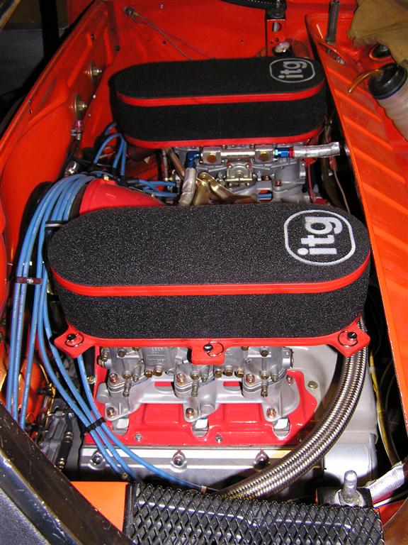

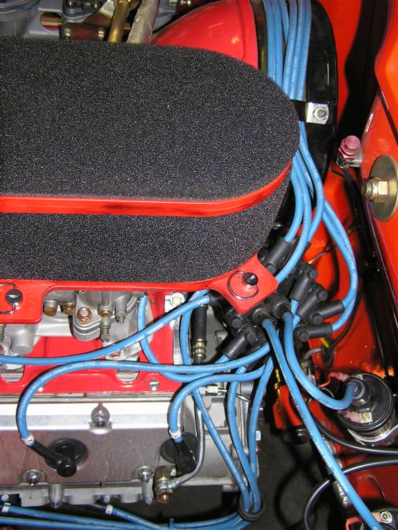

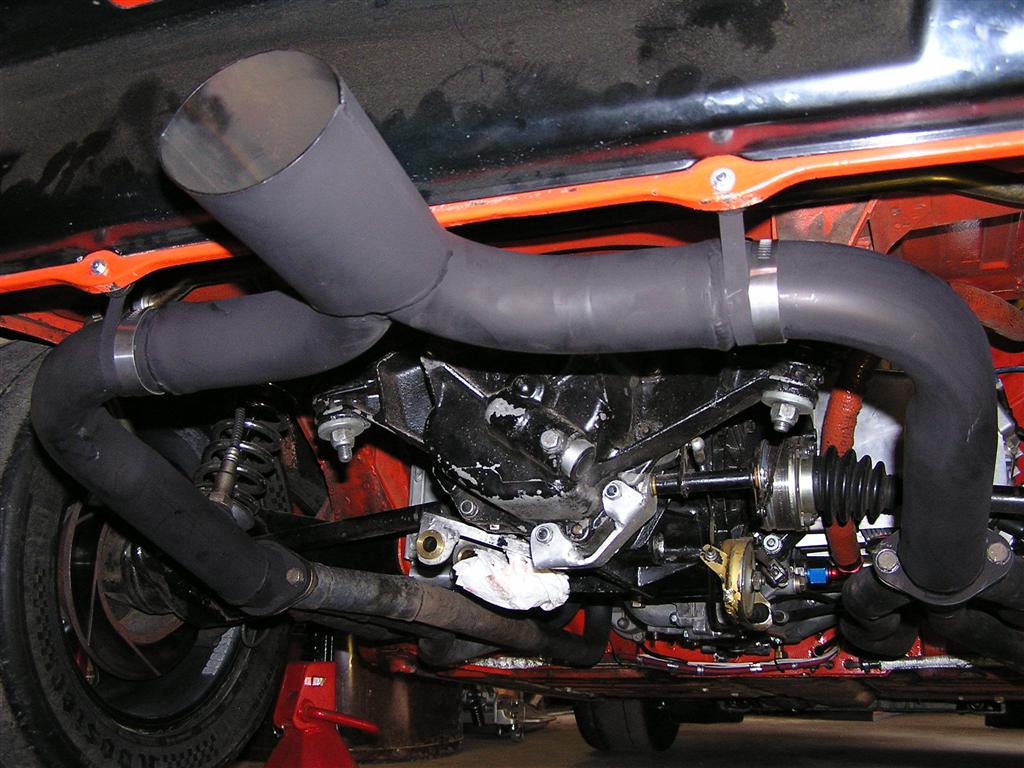

a couple of pictures to save of the motor installed:

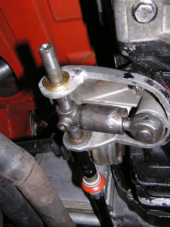

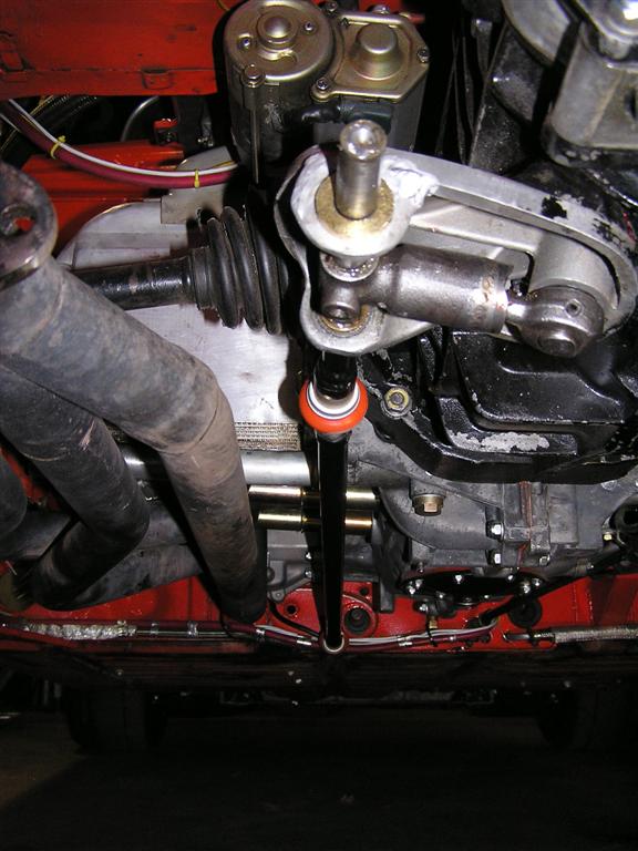

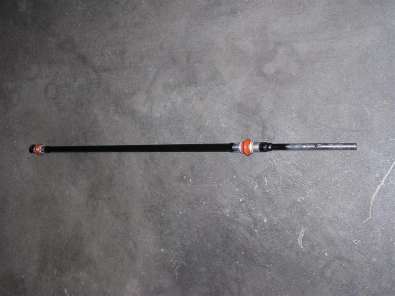

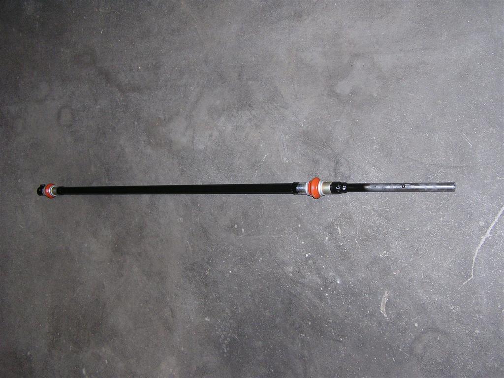

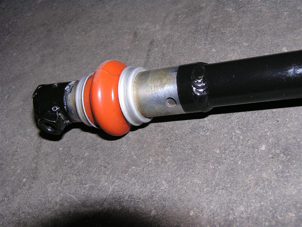

A very trick new shift console and rod.
very very straight with a pair of Apex bushings

post Mar 22 2011, 10:58 PM
Post #515
Posts: 12,279

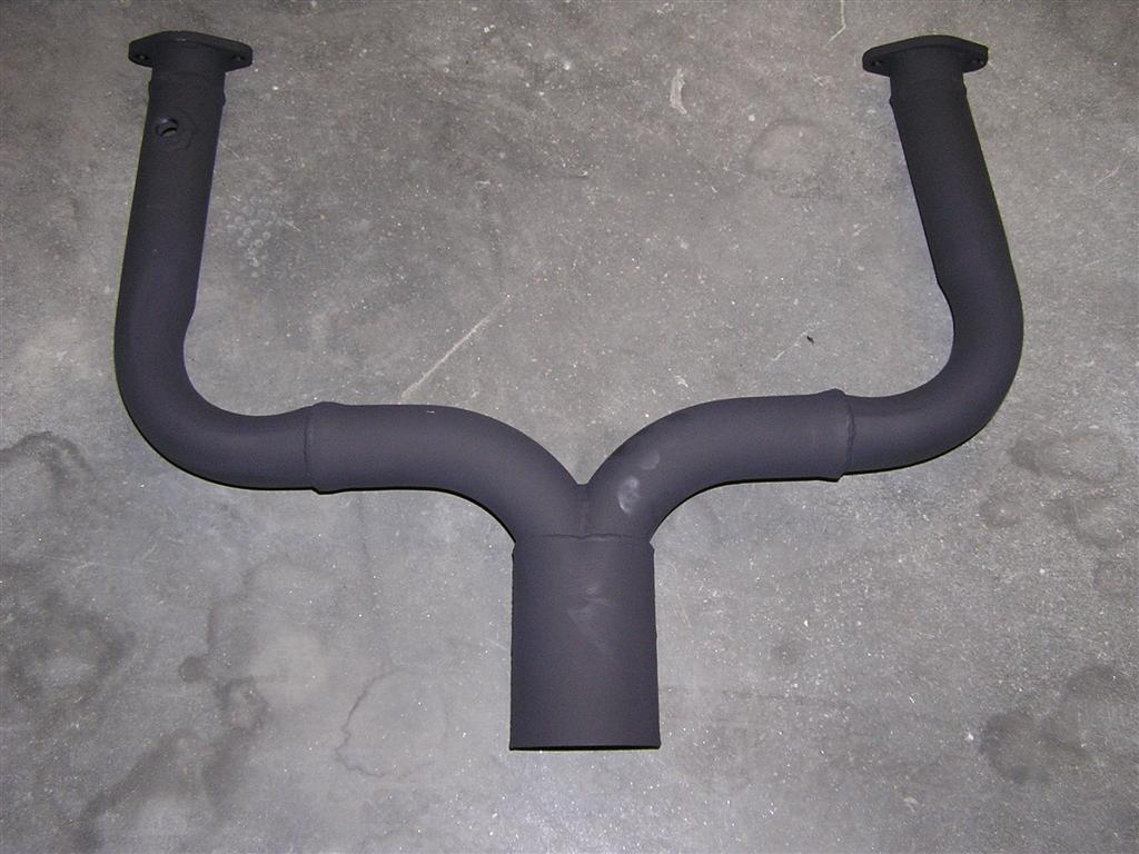

The new merged exhaust
no horse power gains on the dyno
but lots of midrange torque numbers showed up

the machinist and tig work plus apex bushings all are pricey
some savings.
but hopefully the bushings are a little more precise
making the cover is a pain in the butt though!
