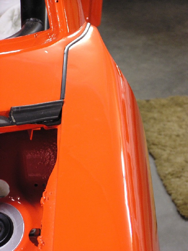

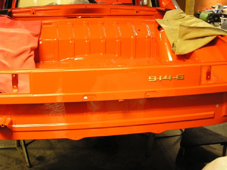

One more "dead" weight picture...
I filled the trunk button hole on the rear panel:

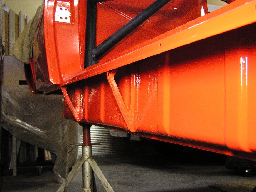

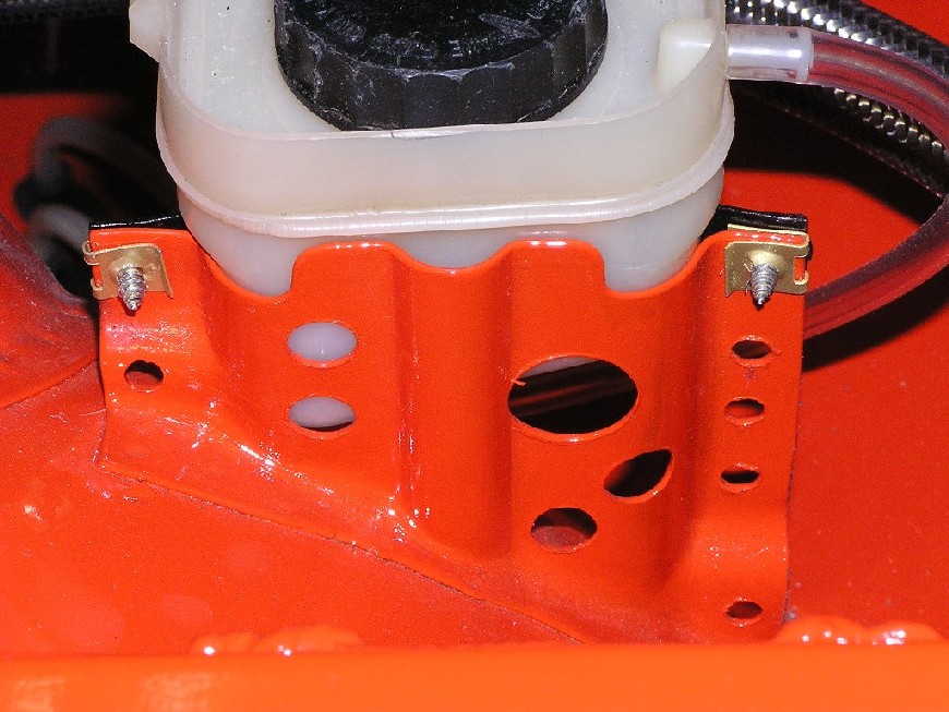

Here are a couple of pics on weight savings items.
holes in the long supports:
brant
post Nov 15 2004, 04:26 PM
Post #67
Posts: 12,279
From: Colorado
Member No.: 47
Brake reservoir attatchment:

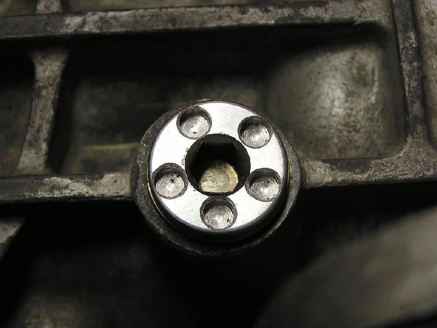

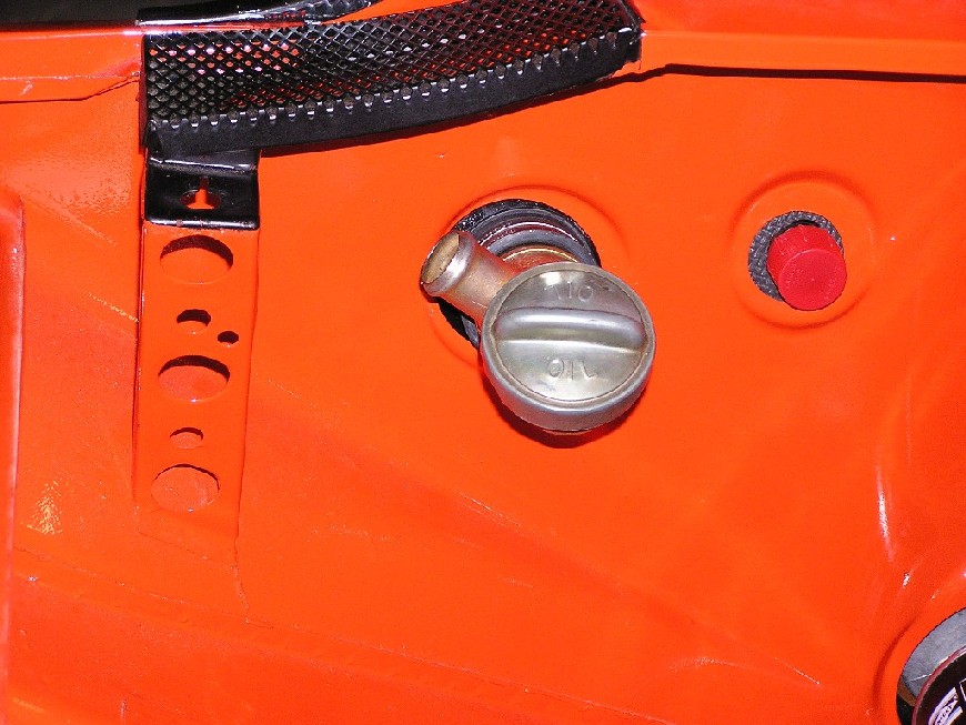

Oil filler neck, and weight saving upright:

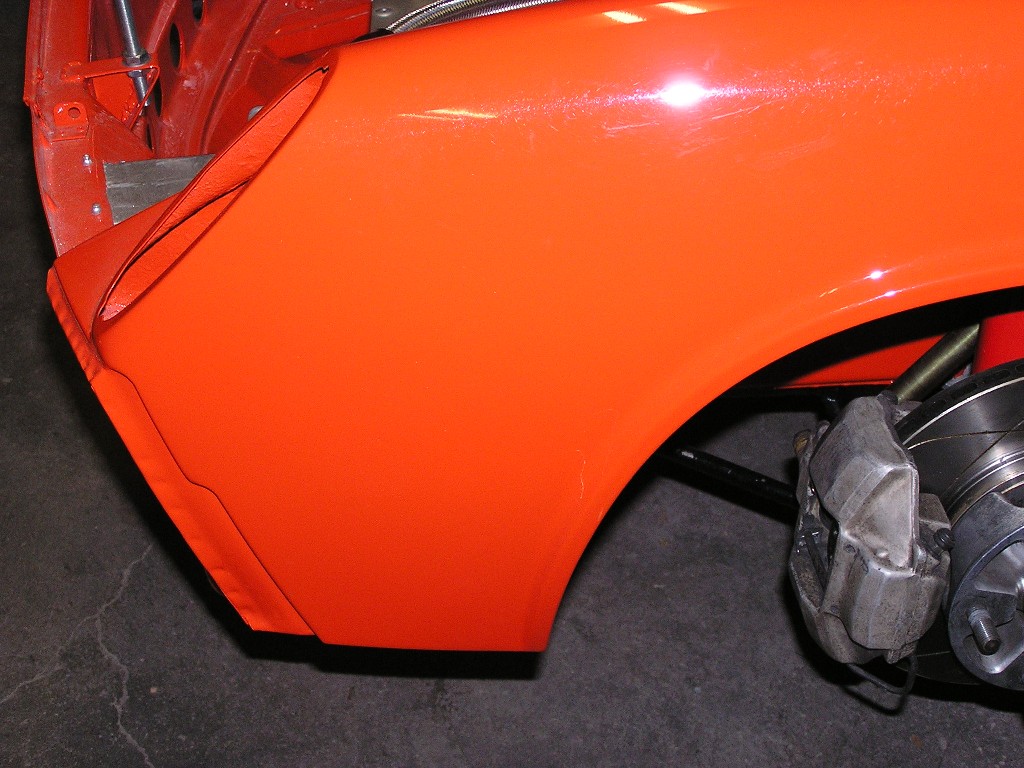

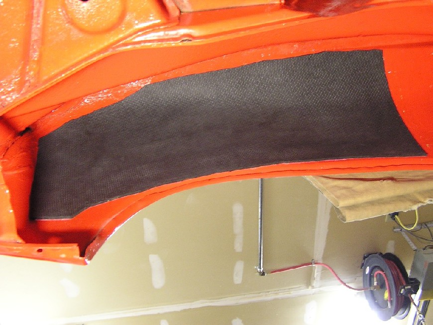

I mentioned my fender linings before.
I used contact cement to glue in a piece of neopreme on the inside of each fender. I've done this before on my old race car and it preserved my paint for 3-4 years from the rock stars that you get from track tires...
The neopreme seems to offer good compression, and more density as it compresses.... what ever.. but seems to work very well.
This picture is confusing, but I took it lying on the ground and pointing up at the ceiling. (left rear fender):

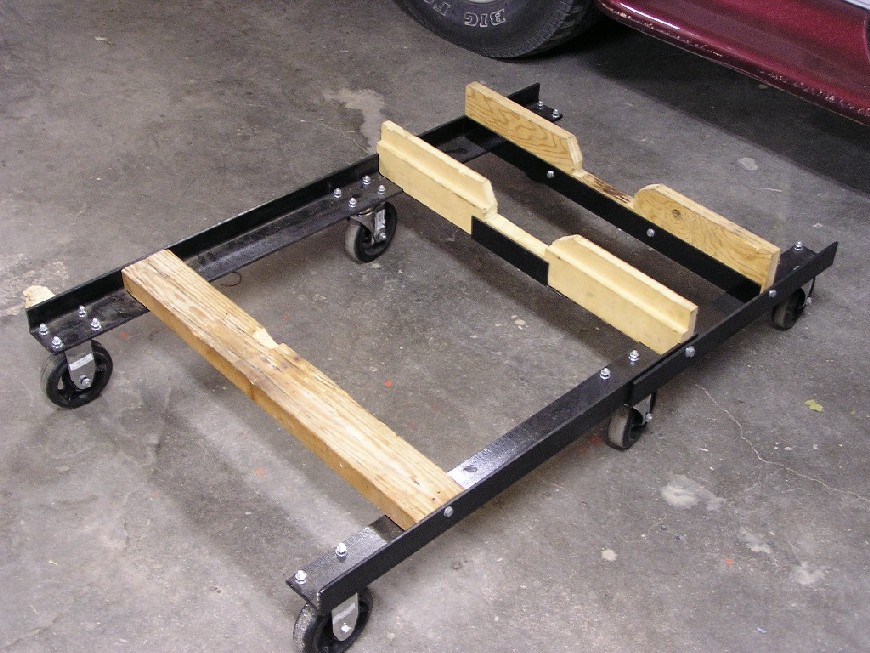

I also previously mentioned that my dad had built an engine dolly. Well I took a photo this weekend. Dolly was built to be as low as possible but still allow our jack to slide underneath.
Its got 6 wheels and the forward 4 are rigid, but the back 2 are on casters so they can spin in any direction. There is also enough of a bend in frame to keep the 2 rear wheels off the ground.
The point to all of this; it doesn't swing right and left when sliding it in from the rear... then after jacking up the forward part and attatching the forward engine mount there is a weight transfer (duh) onto the rear casters and the rear can swing right/left in order to facilitate final alignment...
don't know if that makes any sense.. Either way the dolly works great. It will suppor the engine/tranny combo, or just the engine alone. I've had the engine in a few times now during the dry fitting process and it works great:

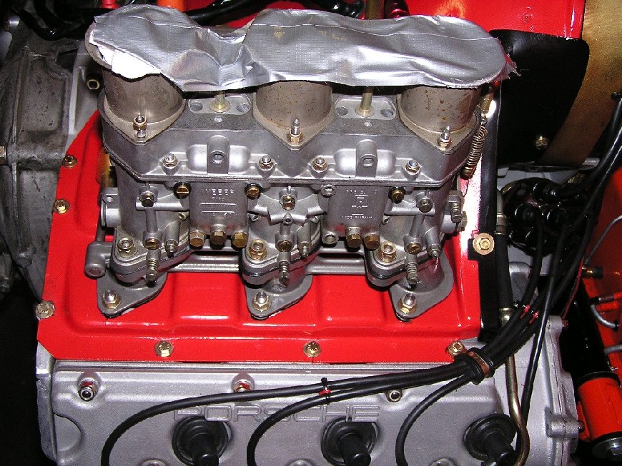

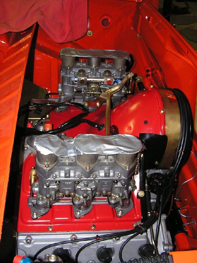

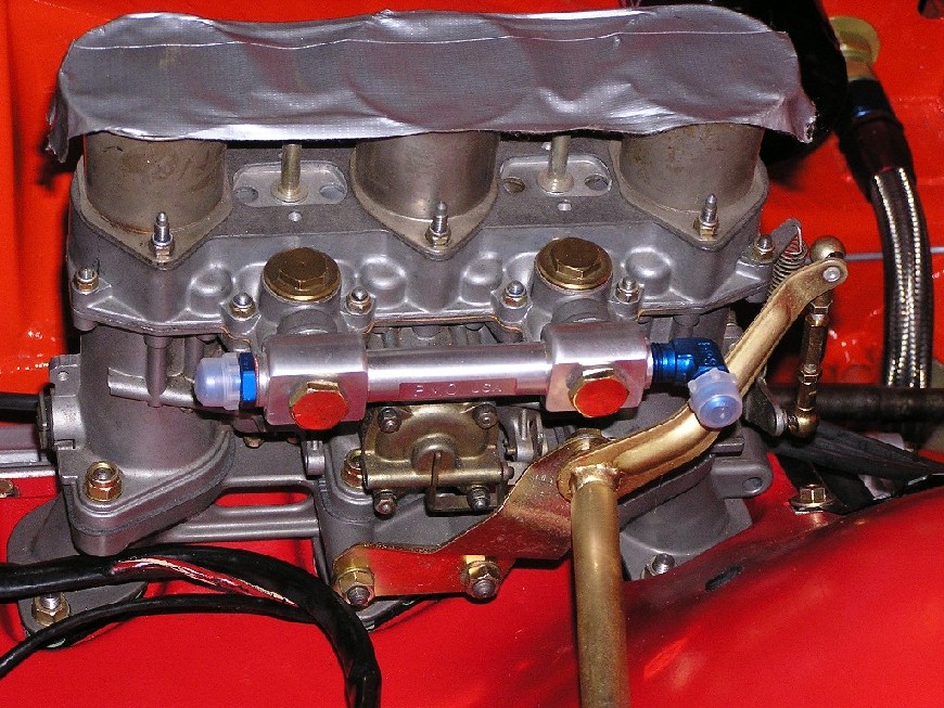

I reassembled the carbs onto the motor this weekend.
Carbs are IDS carbs, with the head blocks, perc mod, and baffles. The manifolds look to be powder coated and the carbs rebuilt
here is a shot:
brant
post Nov 15 2004, 06:54 PM
Post #73
Posts: 12,279
From: Colorado
Member No.: 47

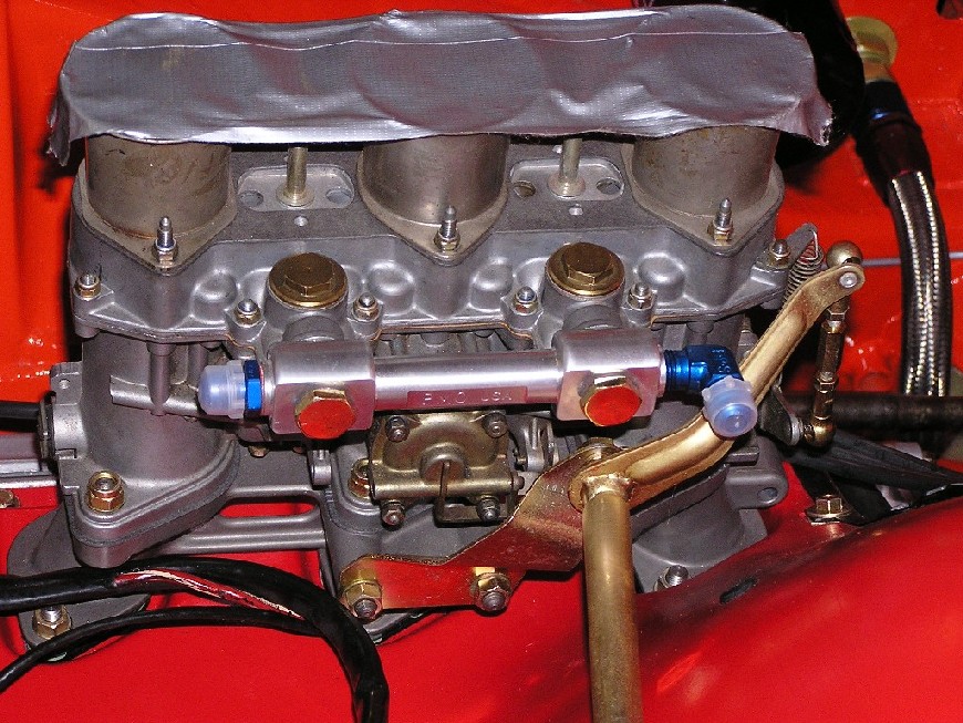

One more that shows the fuel blocks:
brant

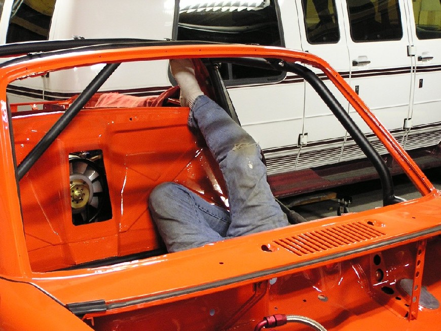

I had to take this one...
I'd like to call it "nap time"
but in reality its my dad fighting with the steering column:

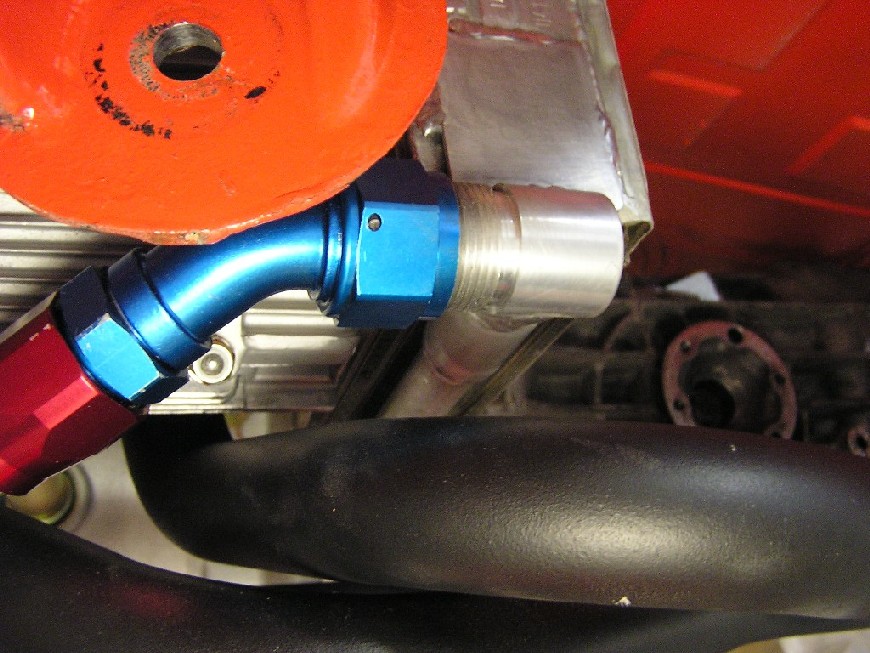

Here is the oil cooler that AJ modified for me (dash 16):
brant

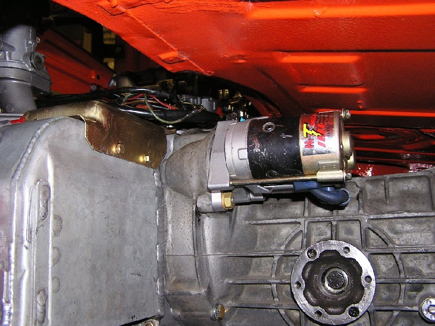

Starter off of my -4 retired racer:
brant

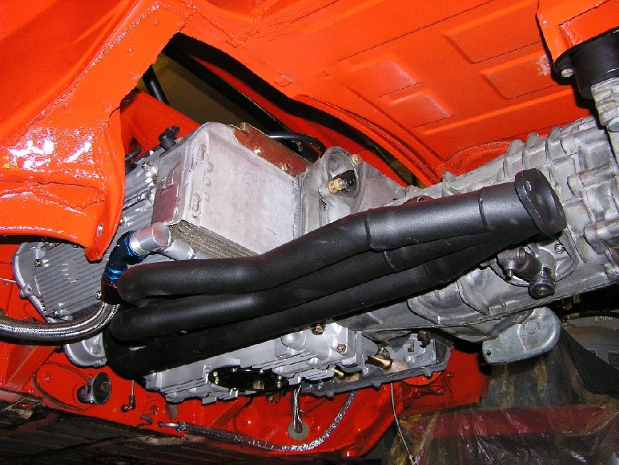

Trial fit on the header.
They are Jet hotted.
oil line will have a heat sleeve when we get done:

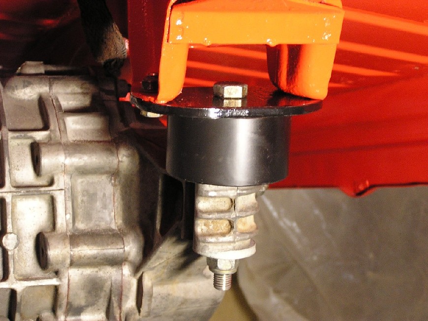

Rear tranny mounts are delrin:
brant

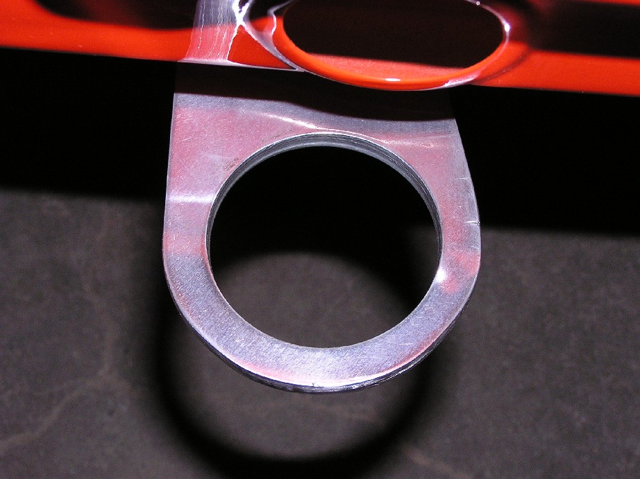

post Nov 15 2004, 07:14 PM
Post #80
Posts: 12,279
From: Colorado
Member No.: 47

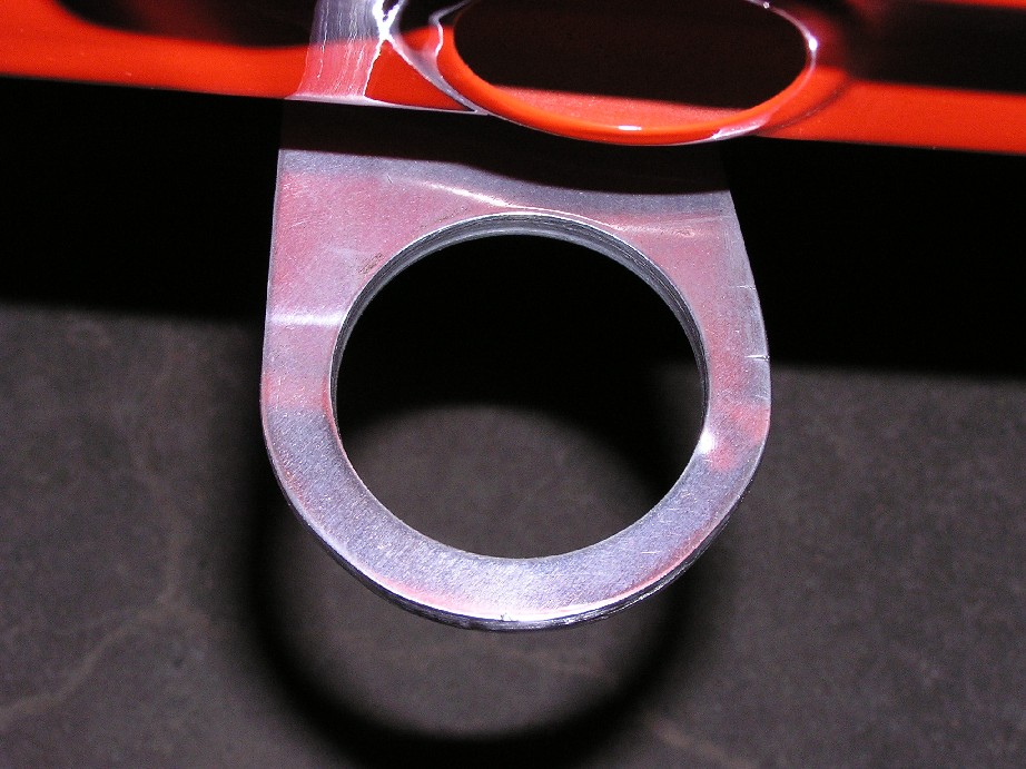

This isn't finished yet.
but here is the front tow hook (alluminum) that dad has been making:
