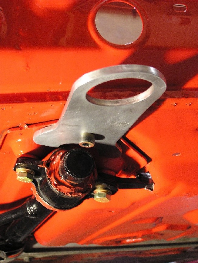

And this one is a shot of it from underneath...
Its only a test fit, and not tightened down in this photo.
This photo also shows my front bolt in brace from earlier in the thread.
You can also see the mueller bearings..

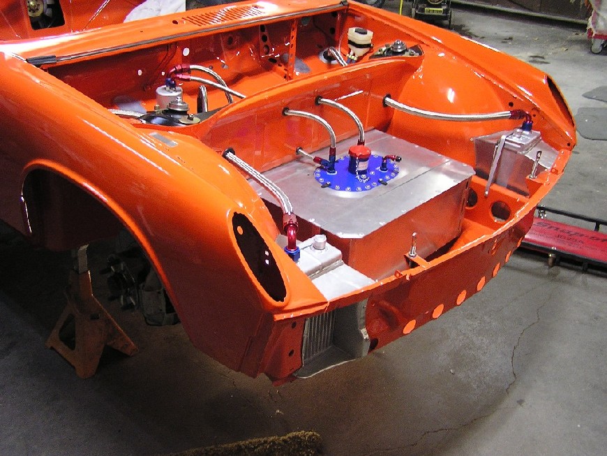

This is just a front trunk view from the second side:

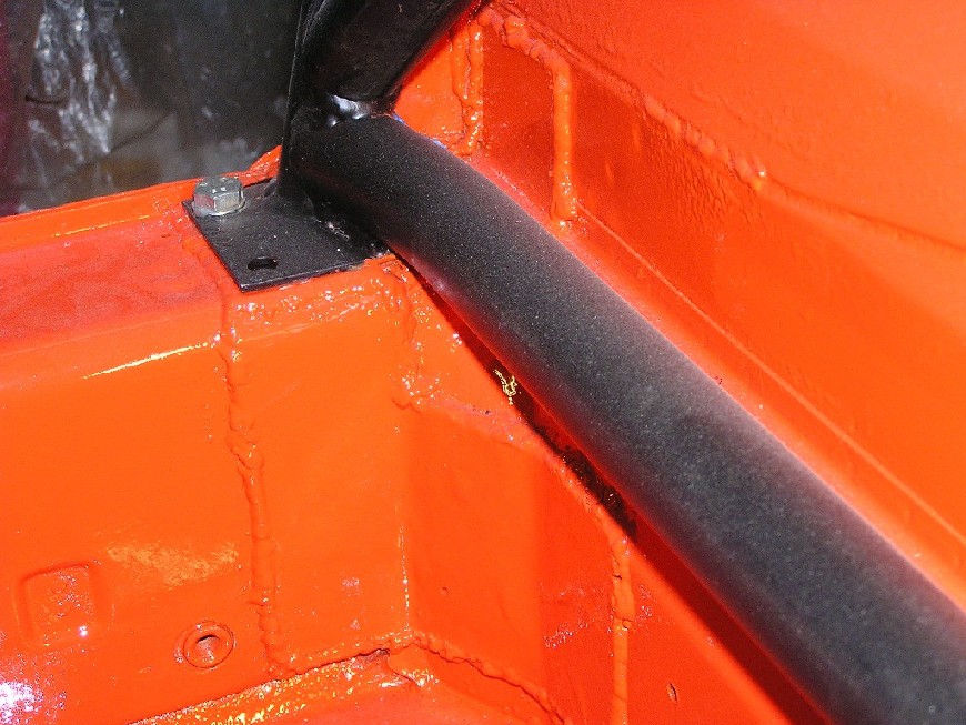

Back in the begining of this thread, I mentioned that my roll cage had extra large foot pads. Its not an Engeman kit by any means, but the foot pad is unique.
Its one piece that does a bit of reinforcing in the lower corner on the long, and also comes up and ties into the firewall.. (on the hell hole side there is a similiar bracket that ties into the back of the firewall)...
Remember, I'm not allowed to weld in bracing really... So this is technically a foot pad for my roll cage:

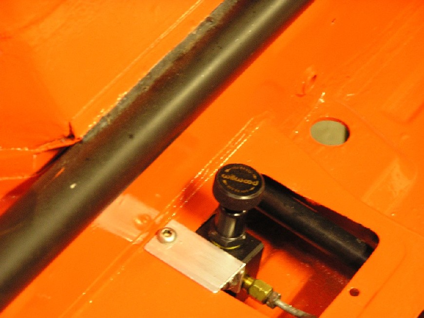

Another cage shot...
This rear lower cross bar was added... and has a tiny bead onto the rear firewall.
This is also where we put the bias valve:

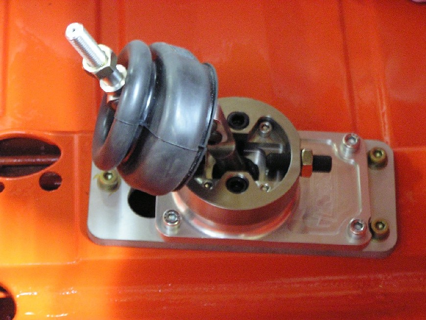

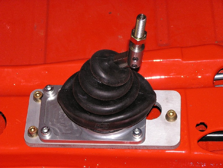

As previously mentioned... Here is the shifter we ended up using:
brant
post Nov 15 2004, 07:36 PM
Post #88
Posts: 12,279
From: Colorado
Member No.: 47
innerds:

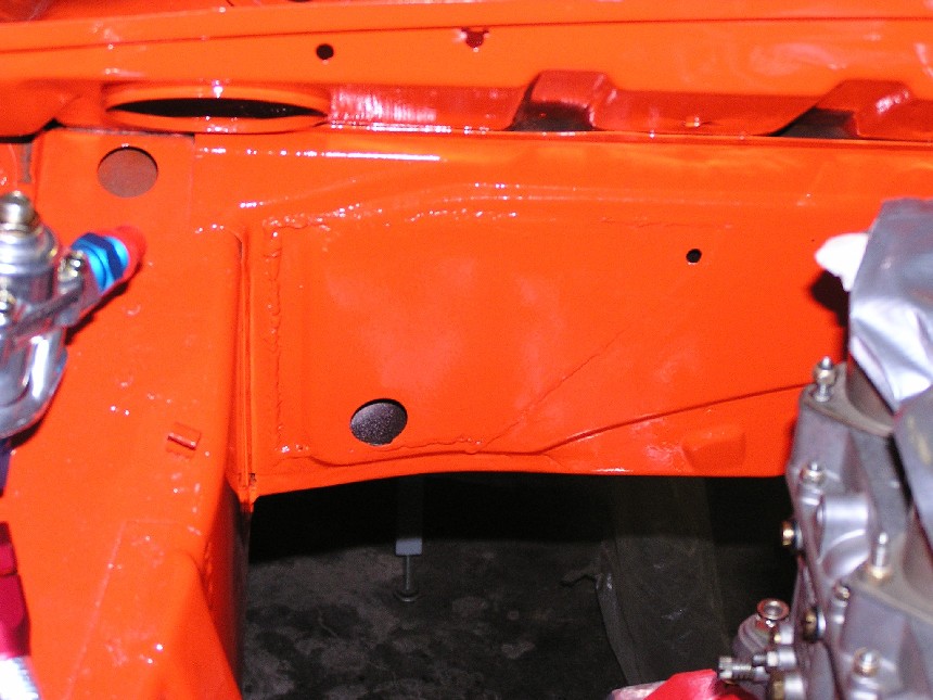

how does that hole in the firewall work, i understand fresh air, but is that safe or is it just cuz itsa racecar.
McMark
post Nov 15 2004, 07:56 PM
Post #90
914 Freak!
Posts: 20,180
Joined: 13-March 03
From: Grand Rapids, MI
Member No.: 419
I believe it's for accessing the front of the engine for service work.
That looks like a Mustang shifter. Do you have more pictures of that?

QUOTE(nein14-6 @ Nov 16 2004, 05:24 AM)
I think its based off of a heavily modified mustang shifter.
I don't have any more pics right now... won't be back in lamar until christmas unfortunately.
