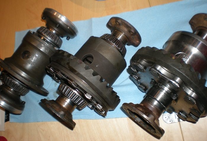

904 /aluminum case 901 ZF limited slip.
My buddy had this lying around , it wont work in the 914-901...
Well to much time and little cash....
First the drive flange adapters= Done
Second bearing sleeve and spacer. zf uses 45 mm bearings, 914 are 50mm
and is about 12mm narrower.
Attached Image Attached Image Attached Image Attached Image Attached Image Attached Image Attached Image Attached Image Attached Image

rdauenhauer   Ok maybe Im dense but what are we looking at here?...   Oct 28 2012, 09:32 PM
sixnotfour   My buddy was going to sell the early ZF LSDiff, bu...   Oct 28 2012, 10:00 PM
Randal   My buddy was going to sell the early ZF LSDiff, b...   Oct 29 2012, 08:00 AM
sixnotfour   Worked fine, old school .. low horsepower..and had...   Oct 29 2012, 08:38 AM
Randal   Worked fine, old school .. low horsepower..and ha...   Oct 29 2012, 12:44 PM
sixnotfour   Vintage Racer, spare gearbox , His other Box has a...   Oct 29 2012, 01:05 PM

wingnut86   That's some real nice carving. what did you u...   Oct 30 2012, 12:36 PM
sixnotfour   Old hercules lathe and a bridgeport. material is 1...   Oct 30 2012, 02:47 PM

rdauenhauer   BOT how did you HT? do you have an oven in your ga...   Oct 31 2012, 04:58 PM
sixnotfour   No Oven to 900 at home, Tyee in tooling we have a ...   Oct 31 2012, 05:21 PM
