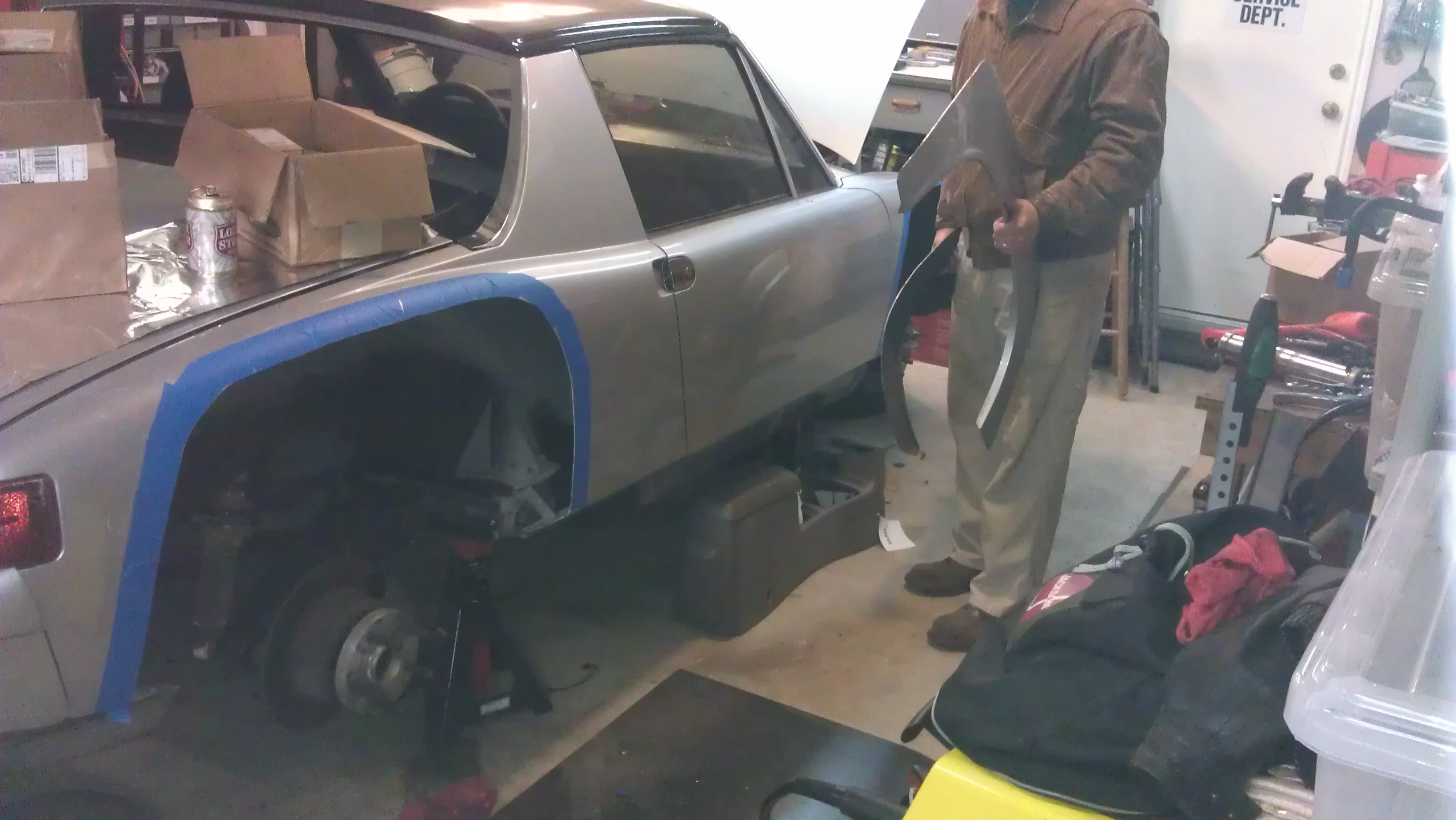

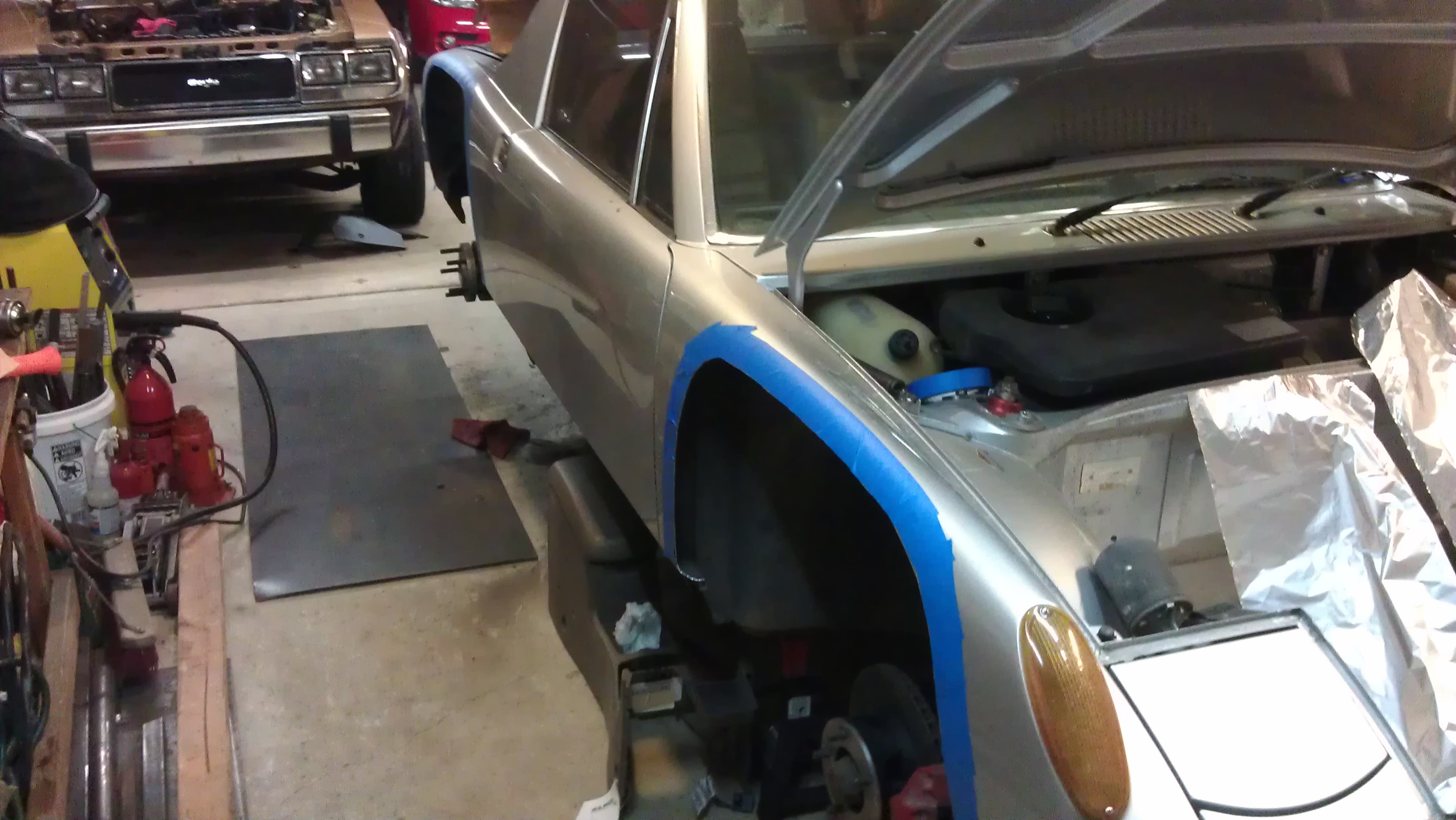

Measure and mark the car carefully before cutting:
(IMG:http://www.914world.com/bbs2/uploads_offsite/i944.photobucket.com-1413-1351881777.1.jpg)
(IMG:http://www.914world.com/bbs2/uploads_offsite/i944.photobucket.com-1413-1351881777.2.jpg)
(IMG:http://www.914world.com/bbs2/uploads_offsite/i944.photobucket.com-1413-1351881778.3.jpg)
After holding/clamping the flares in their finished position, trace a light pencil line along the outside edge of the flare onto the car.
Apply 2" masking tape to the line.

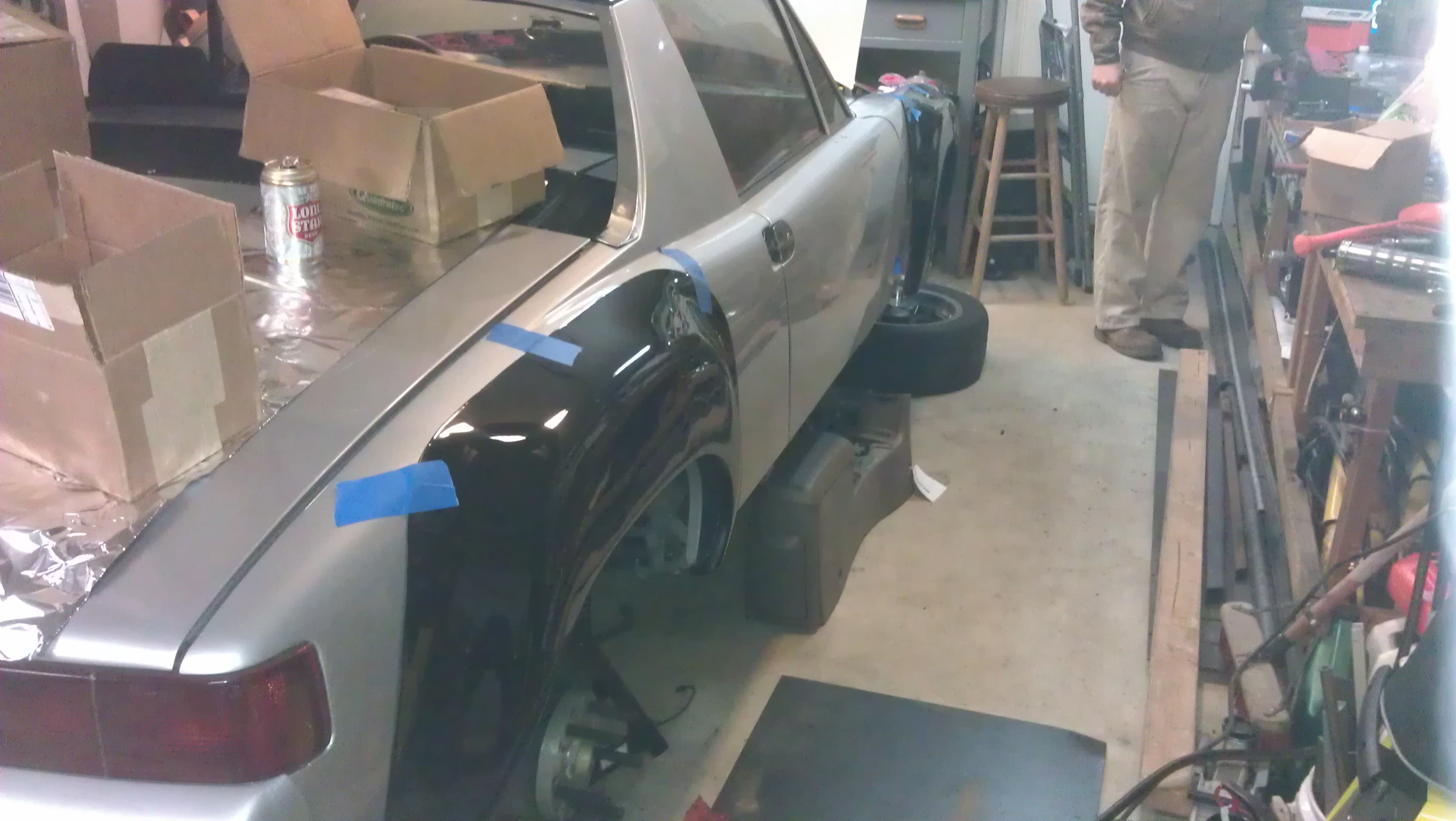

The inside edge of the tape becomes your cut line: (IMG:style_emoticons/default/sawzall-smiley.gif)
(IMG:http://www.914world.com/bbs2/uploads_offsite/i944.photobucket.com-1413-1351881778.4.jpg)
(IMG:http://www.914world.com/bbs2/uploads_offsite/i944.photobucket.com-1413-1351881778.5.jpg)
KT

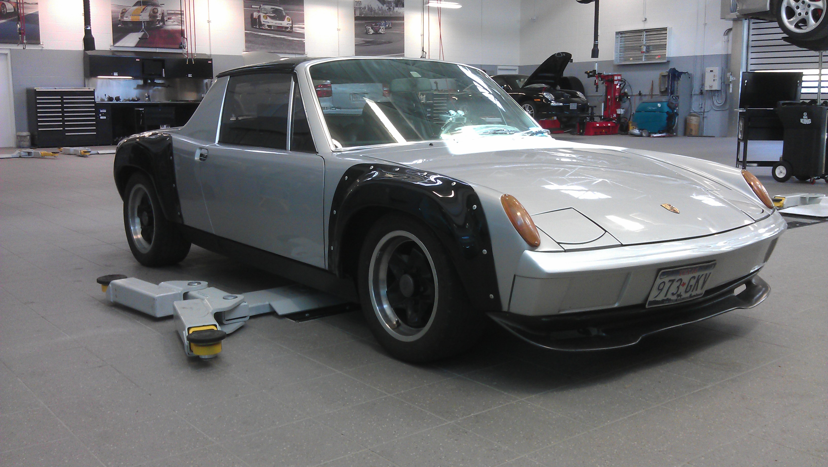

After you are done, trim the excess molding with a fresh razor knife.
(IMG:http://www.914world.com/bbs2/uploads_offsite/i944.photobucket.com-1413-1351883065.1.jpg)
8" front wheels, 10" rears.
The flares can be quickly removed for repair or replacement.
Also, if you decide to go with metal flares in the future, nothing done will interfere with that process.
Hope this helps someone!

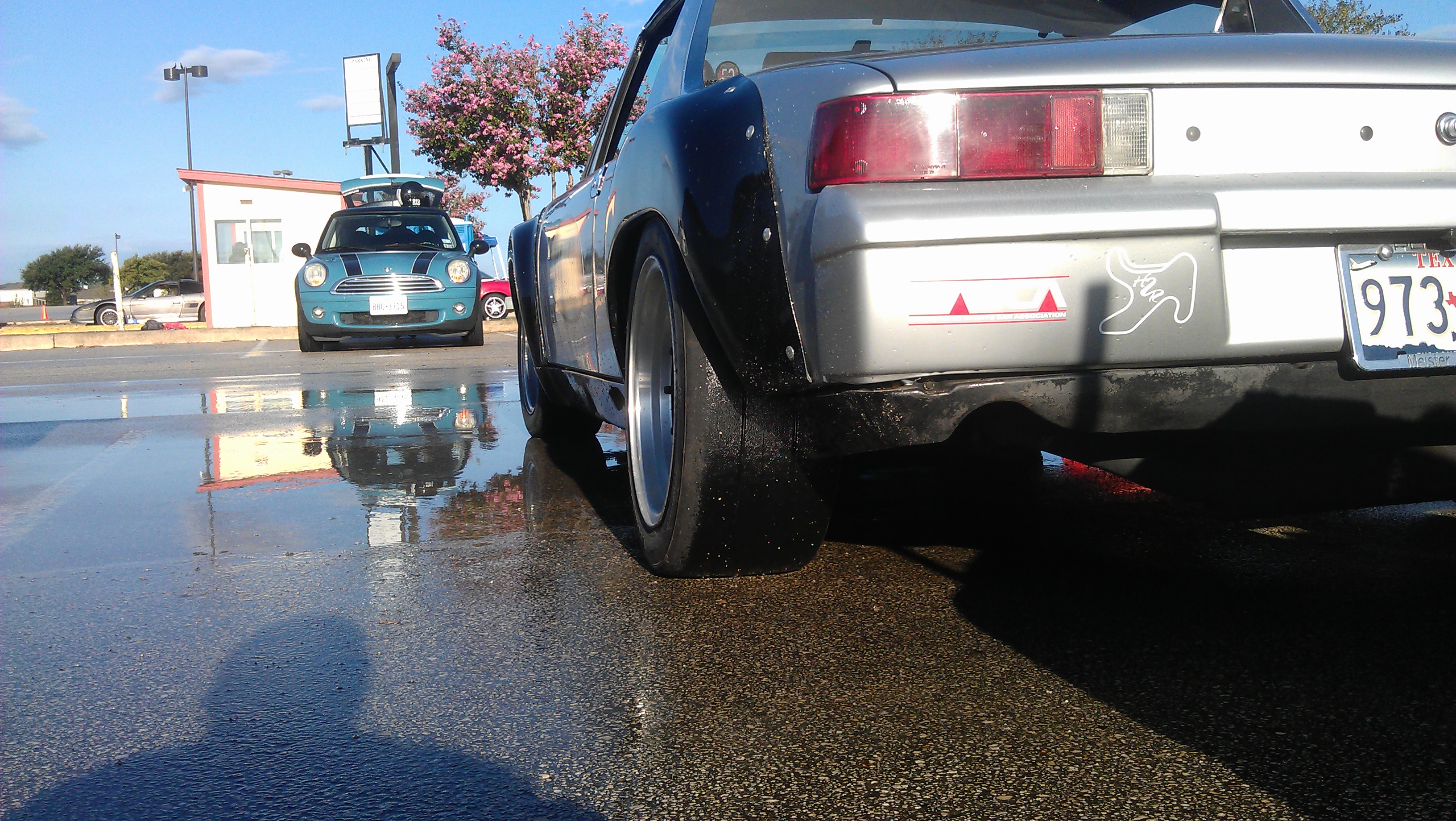

This is how much rear tire I gained!!
11" tire on a 10" rim:
(IMG:http://www.914world.com/bbs2/uploads_offsite/i944.photobucket.com-1413-1351883505.1.jpg)

I taped the fenders up till I got the position I liked, then outlined them with a sharpie, then used that line to lay my tape. I used 2" masking tape as my cut line. Then I used 1" tape on the fenders to plot where I was going to rivet. I painted all rough sheet metal edges with a stick of touch up paint. Looks like Trekkor and I used a very similar method.

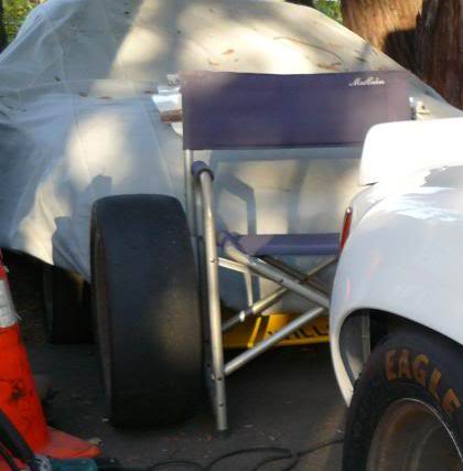

FYI:
The source of my tires!
(IMG:http://www.914world.com/bbs2/uploads_offsite/i944.photobucket.com-1413-1354224666.1.jpg)
KT
Jeff Hail
post Nov 29 2012, 06:03 PM
Posts: 1,141
Joined: 3-May 07
From: LA/ CA
Member No.: 7,712
I think you need to flare that open wheeled chair next. Just doesnt look right with all that rubber hanging out.
