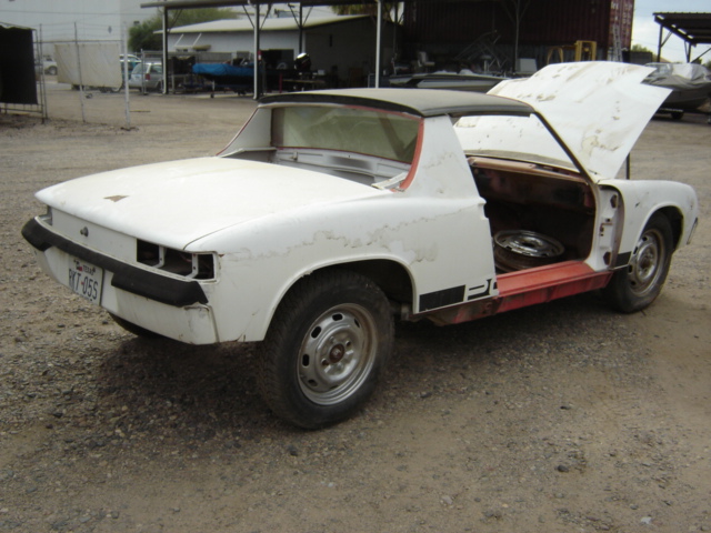

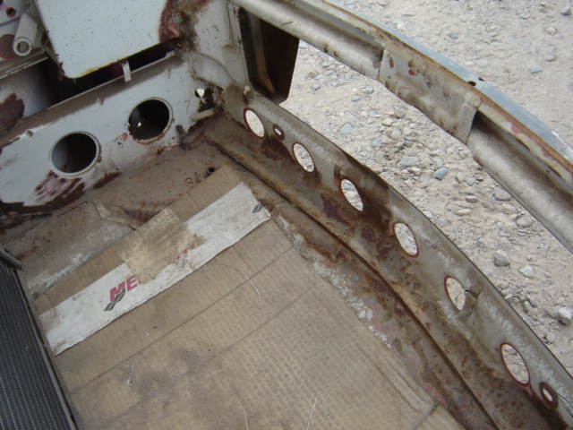

Hello. New here,so here goos.

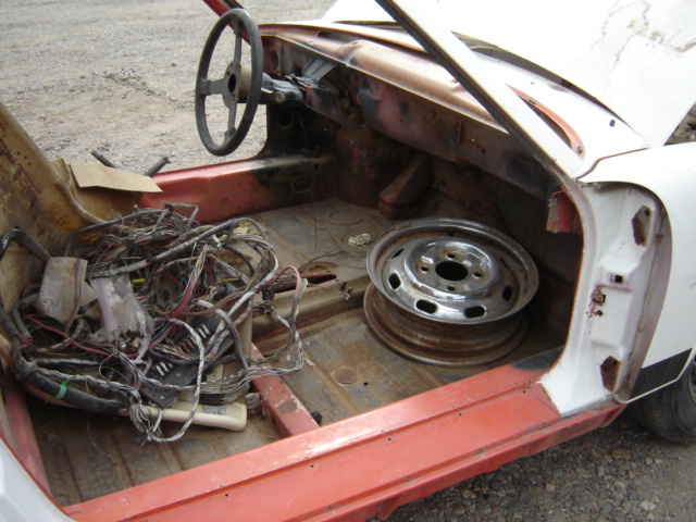

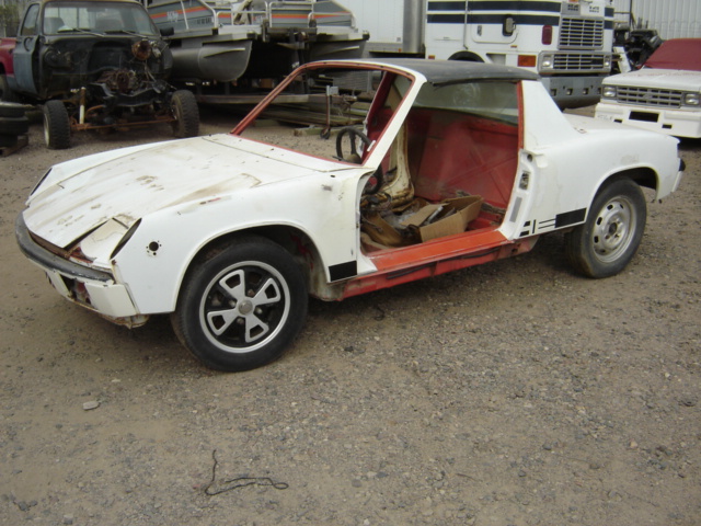

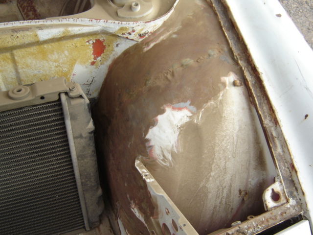

Back in 2007 started to put the parts and chassie together. I have 3 chassis to work from,2 from Texas and one from Ca. The Texas car seems to be better/less rust but it was hit in the driver front and repaired. Will look into that when I get is up on Rotisserie. Will start building the Rotisserie next.
She will be powered by a JDM Sti using a adapter to the 914 transaxle. Didn't want to go to the Subaru,to much work.
When I get it up on the Rotisserie is this a good time to have blasted clean/paint free?
Here are some photos . Any input is welcome!
Randy

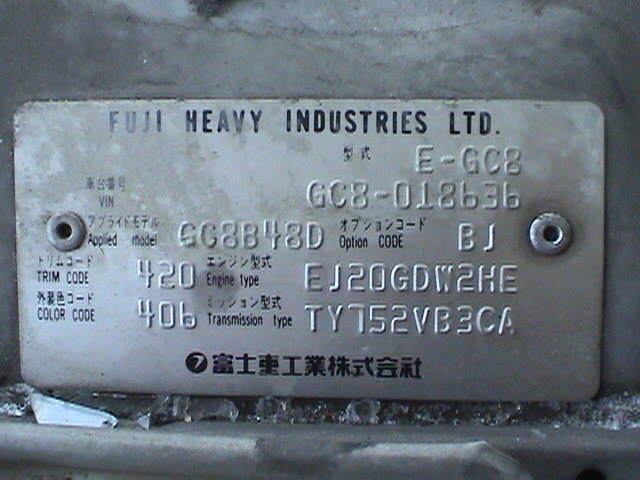

The motor is from a 1994 Sti. She is close to a 555, Like 275 HP stock.
Here is the chassis tag.

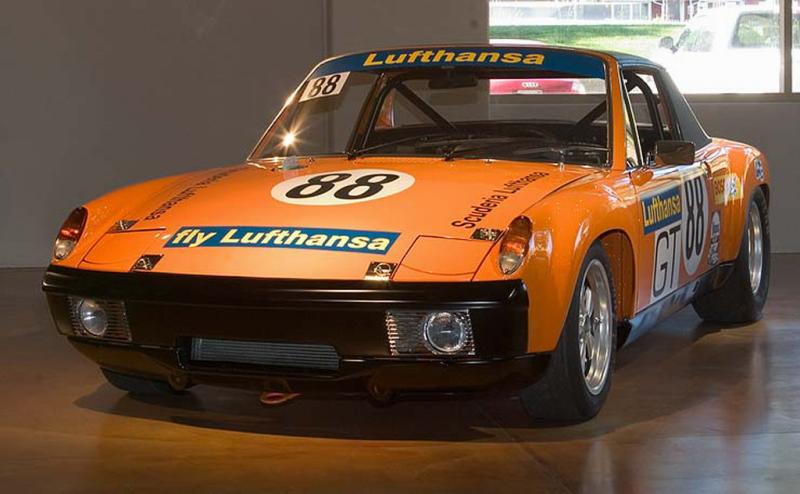

914GTSTI
post Nov 8 2012, 10:11 PM
Posts: 275
Joined: 16-September 07
From: Glendale AZ
Member No.: 8,123
Andyrew that was what I was thinking! And the glass may not work well with the people on the city streets? Maybe this is the way to go??
(IMG:http://www.914world.com/bbs2/uploads_offsite/i916.photobucket.com-8123-1352434279.1.jpg)
Andyrew
post Nov 8 2012, 10:37 PM
Spooling.... Please wait
Posts: 13,381
Joined: 20-January 03
From: Riverbank, Ca
Member No.: 172
The GT look is the most preferred.
I have fiberglass fenders front/rear (Molded in). Daily drove for a year no issues. Just mount them well and dont stand on them.

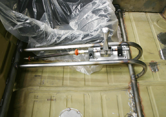

So ,I have been looking at a lot of build photos. In this photo the center tunnel has been removed. What about making it taller to take the water lines?
(IMG:http://www.914world.com/bbs2/uploads_offsite/i916.photobucket.com-8123-1352525988.1.gif)
Porcharu
post Nov 10 2012, 12:06 AM
Posts: 1,314
Joined: 27-January 05
From: Campbell, CA
Member No.: 3,518
Never thought about removing the tunnel. The Subaru trans is TOTALLY worth the little bit of extra work. With the modern trans you can just drive the car without the constant f*(*cking with the 914 trans - ie just drop into 1st gear and go.
Mike Bellis
post Nov 10 2012, 12:15 AM
Resident Electrician
Posts: 8,348
Joined: 22-June 09
From: Midlothian TX
Member No.: 10,496
QUOTE(914GTSTI @ Nov 9 2012, 10:39 PM) *
My first V8 car had water lines in the tunnel. They transmit a lot of heat into the cabin. You will have to insulate the lines in the tunnel. My car now runs lines under the car. Never had a problem.

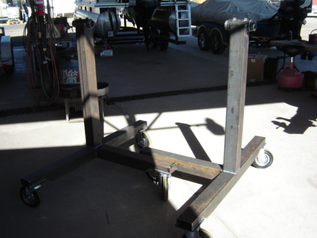

Welded up the ends for the mount.
(IMG:http://www.914world.com/bbs2/uploads_offsite/i916.photobucket.com-8123-1353272480.1.jpg)
53 " off the ground and 42" to the leg.
