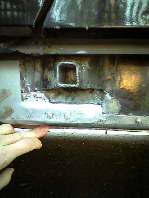

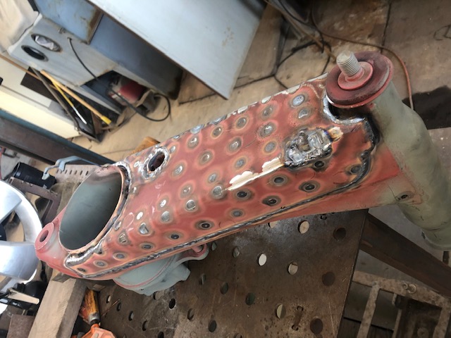

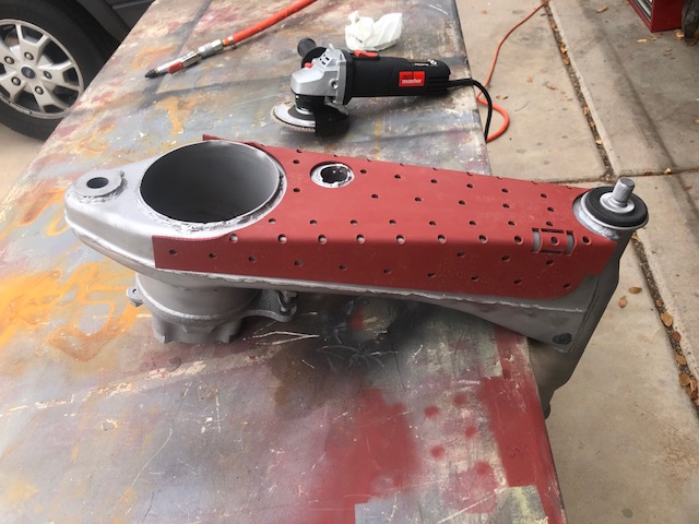

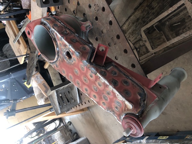

Working on the trailing arm. Does this look ok ?
Attached Image Attached ImageAttached Image

Went back and reread my build. Only change was I used weld-through paint on this arm. Man I have been doing this car for a long time. Sad. But I'm not dead yet.

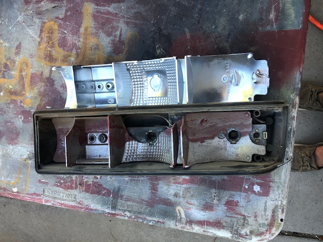

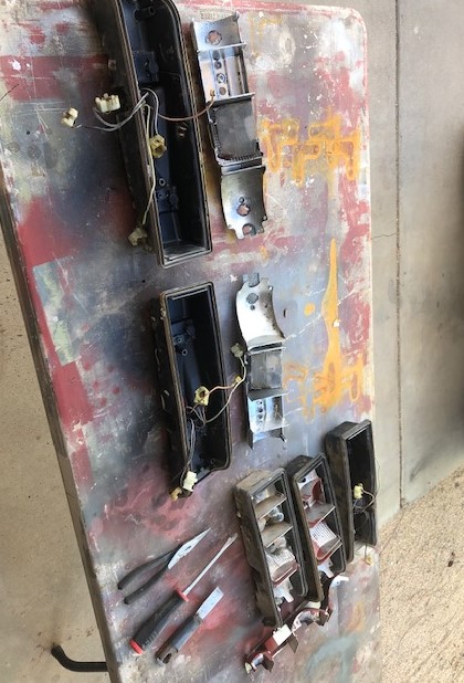

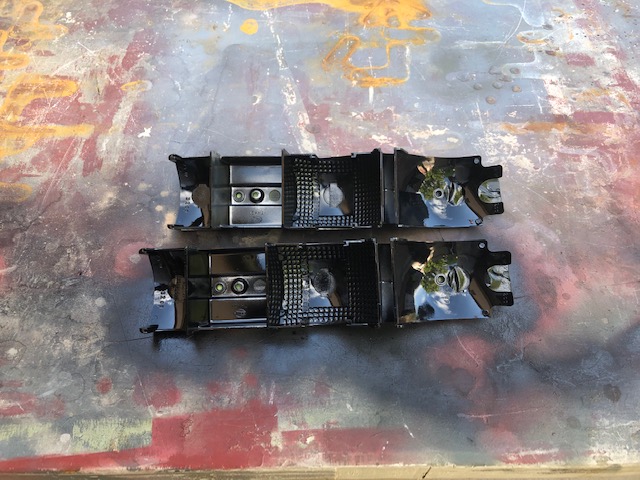

After looking at 6 taillights. I now have one left and one right. What a pain. But I saved $$$.Attached Image Attached Image

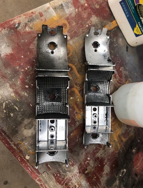

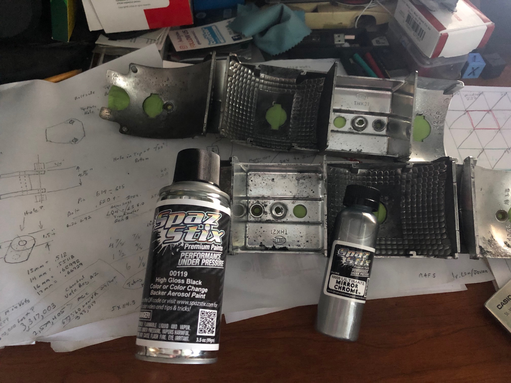

Supply's are here. Paint the "Mirror Chrome" tomorrow .Attached Image

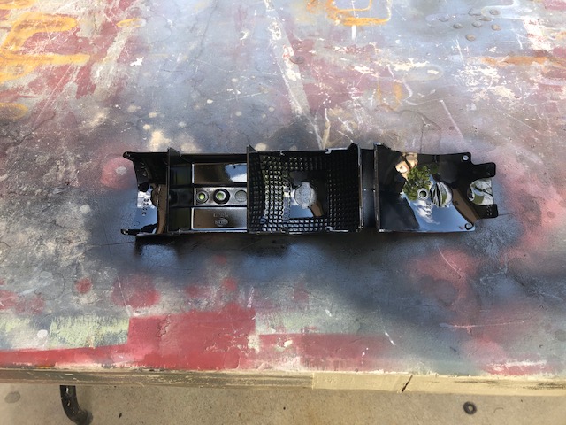

First paint down. Black. In 48 hours I will spray the chrome. Then we will see. But anything will be better than what is not their now.

I've used that paint before and it works great, do light coats and it will really look like chrome. The only problems I've had is when I try to clear over it, the chrome turns dull and just looks like silver paint.

I did some checking and the "net" said don't do it and that is the way I will go.

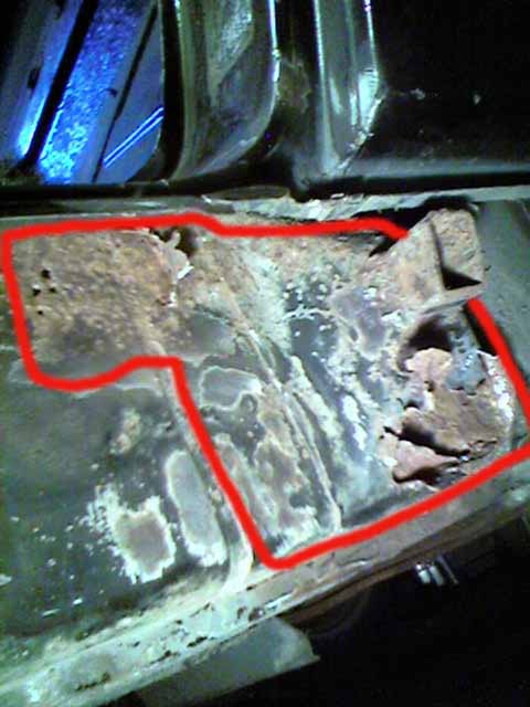

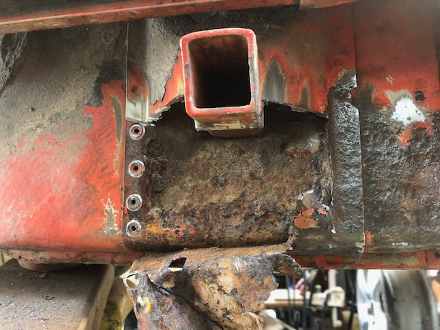

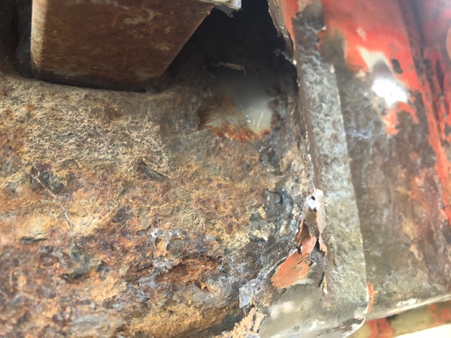

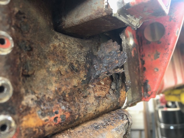

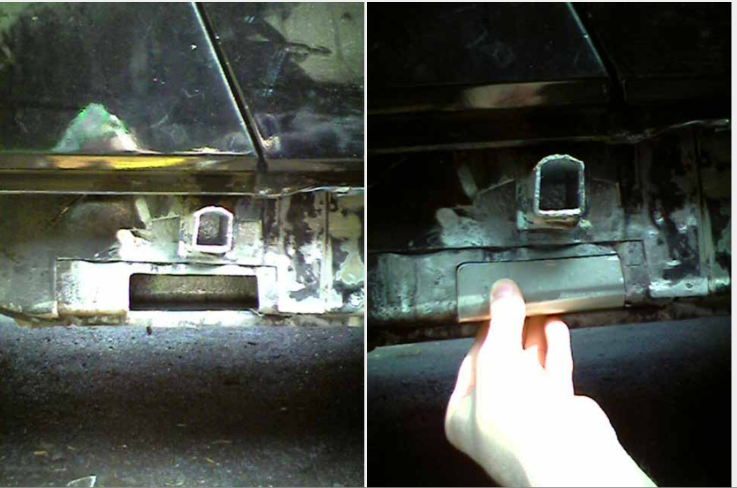

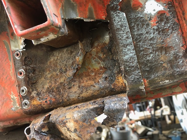

Opened up the right jack point. Lower outer jack cove is rusted. The next inner panel is rusted. The next panel looks ok so far. Take a look and tell me what you would do ?
Need to move the lift arm to cut our the lower spot welds.
rjames
post Aug 17 2022, 07:58 PM
Post #112
I'm made of metal
Posts: 4,474
Joined: 24-July 05
From: Shoreline, WA
Member No.: 4,467
Wire wheel and keep cutting back little by little until you hit good metal, then replace it.
I encountered a similar issue when I first got my car.
914GTSTI
post Aug 17 2022, 10:11 PM
Post #113
Posts: 275
Joined: 16-September 07
From: Glendale AZ
Member No.: 8,123
That was what I was thinking.
Thanks.

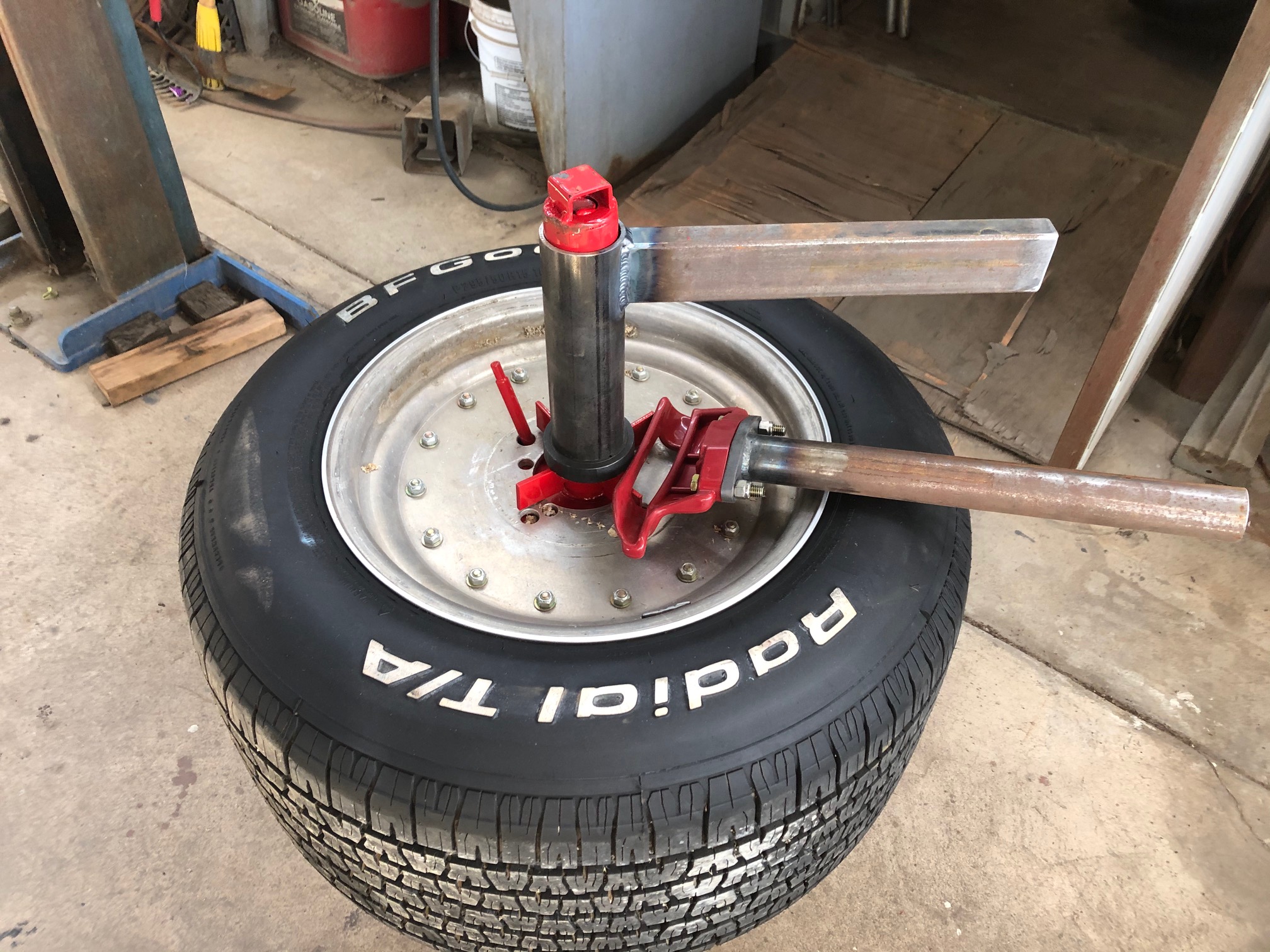

post Aug 27 2022, 04:23 PM
Post #114
Posts: 275
From: Glendale AZ
Member No.: 8,123

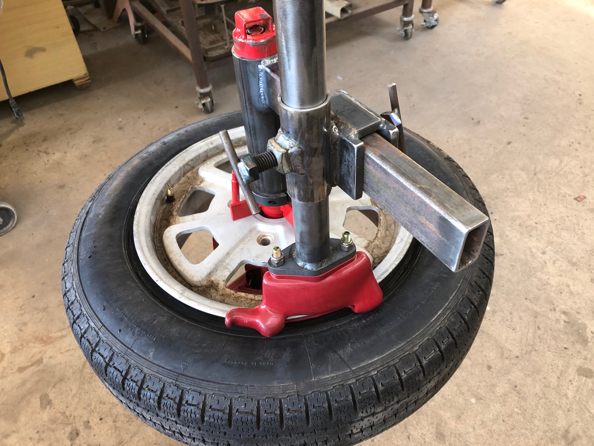

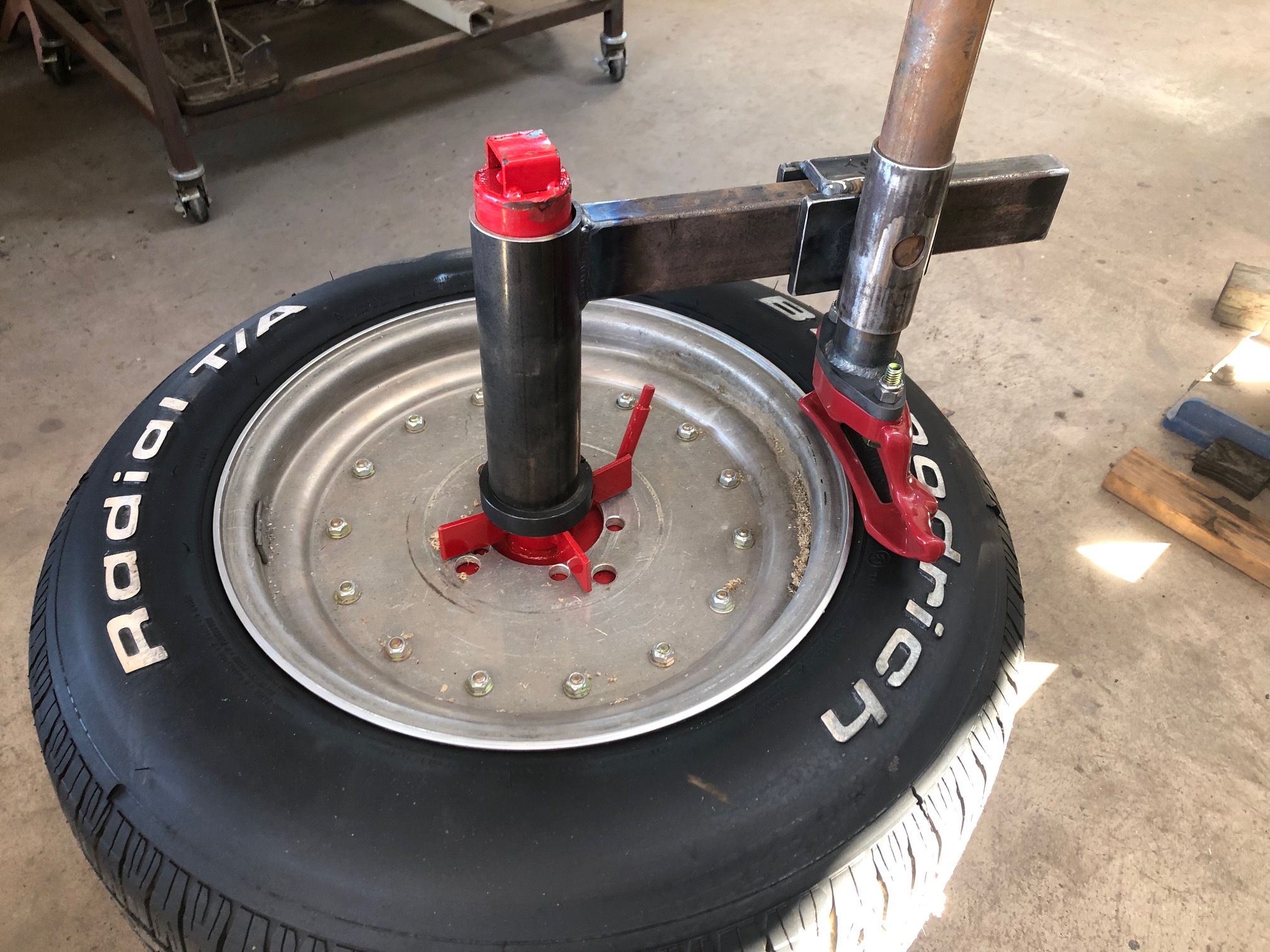

Been planning what wheels I will be using and don't want to pay for changing them. So started building a HF manual with the duck thing. Will test tomorrow. Will use the biggest tire and rim I have 295/50r15 on a 10 x 15 .

From: Glendale AZ
Member No.: 8,123
A little more progress. Maybe test tomorrow ?

post Aug 29 2022, 04:58 PM
Post #117
Posts: 275
From: Glendale AZ
Member No.: 8,123
It works !
Just need to get it bolted to the shop floor.

post Sep 1 2022, 05:17 PM
Post #119
Posts: 275
From: Glendale AZ
Member No.: 8,123
Tested the tire change and it worked Great. Now I can play with any tires I want.

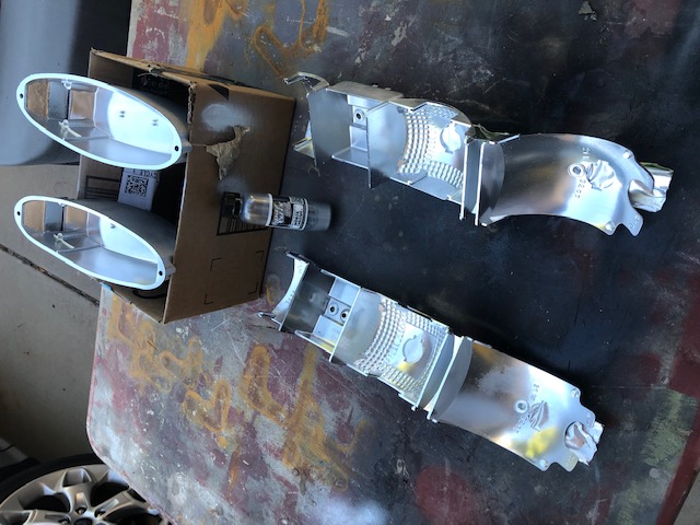

Painted the chrome today also. What do you think ?
