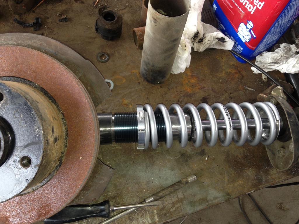

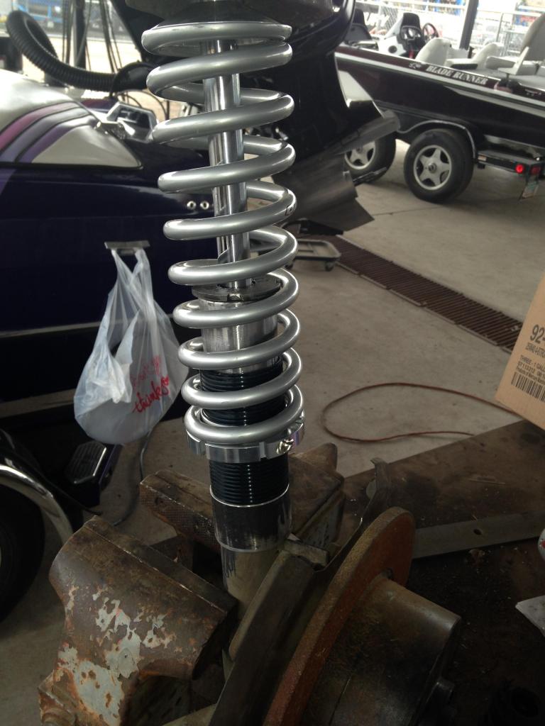

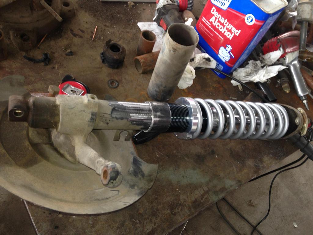

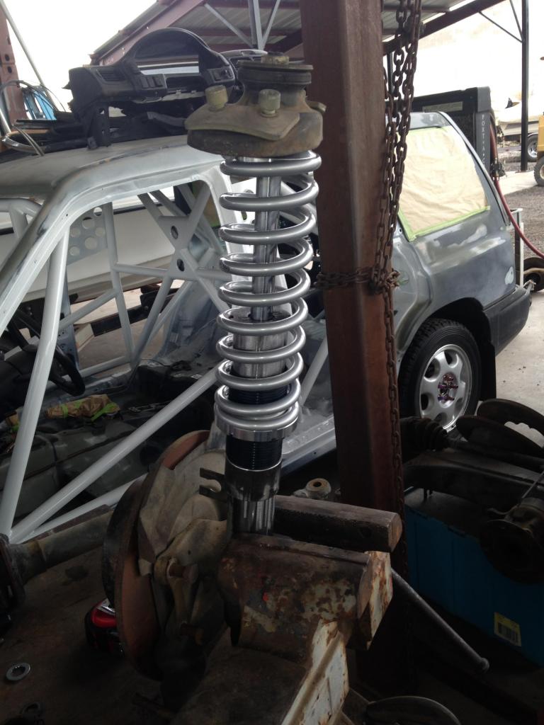

Been working and thinking about coil over's for the car. So I started playing with some old stuff for a project I never started.
I will try to reuse the front BOGE tubes/spindles but with KYB's in it ? I can always go Bilsten later. Same with the rear but will need to do some more thinking about that.
Here is my first look at making a coil over. For you at home I have a lath to help with making things fit.Will need to turn the cartridge nut. To big and to close to the spring. Spring is a 10" x 2 1/2". Thinking the front will be 175# and the rear at 200# +- ?
Plan is to weld a perch on the front tube and build a spacer for the rear ? Will try to keep its mounts all stock.

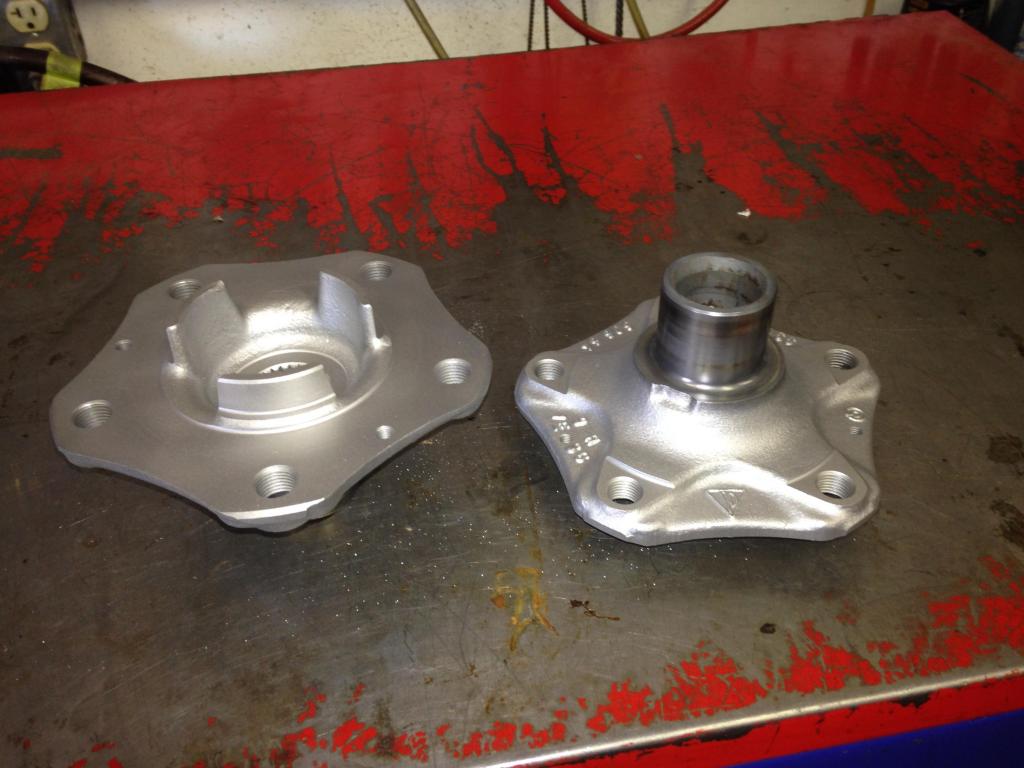

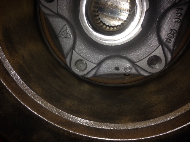

I got a set of Boxster hubs. Now I need to know if a 1976 911, 108mm stub will work with it. I have read a little about needing a spacer,and I can make that. And the need to add mounting holes to tie it to the hub.
(IMG:http://www.914world.com/bbs2/uploads_offsite/i916.photobucket.com-8123-1423076323.1.jpg)
Thinking about staying with a parking brake. Was thinking after reading, that a 914-6 brake rotor and a spacer on the 914 caliper would be the way to go ? Do I have that right ?
With it being a 930 flange it looks to be a little tight but should work. Think I will use a small offroad CV boot ? Because of the Subaru trans I will build the a flange for another 930 and use 28 spline offroad axles.
What do you think ?

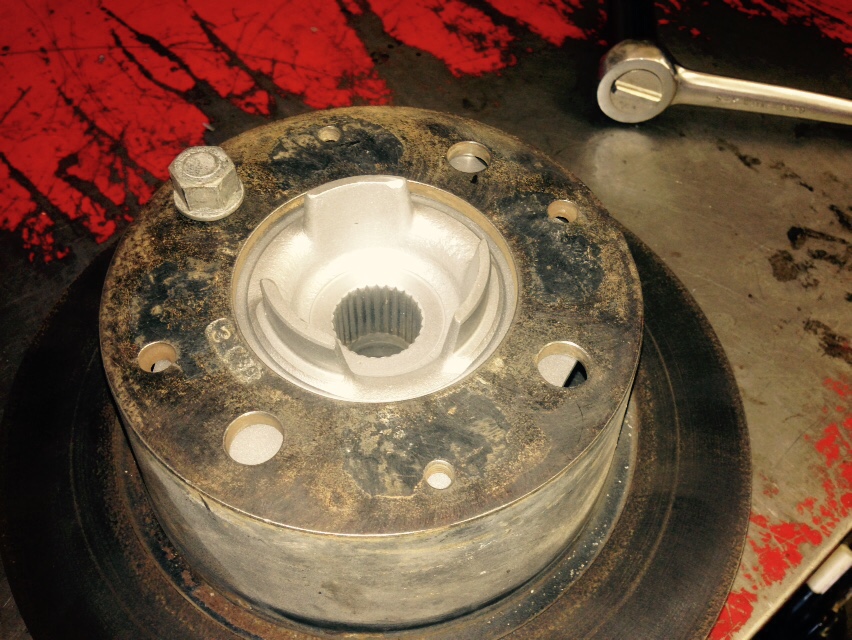

I, cleaned up a 914-4 brake rotor and bolted (one hole) to the Boxster hub. It almost self centers. I then tightened up the wheel lug. Used a transfer punch to mark the 5 bolt pattern. Will drill them after getting a bit for a stud mount ? I want to do a mock up so I'm using what I have. Anybody try using allen bolts for wheel studs ? In dirt racing it is a cheep way to go . With some luck the stub's will be here in a day or two ?
(IMG:http://www.914world.com/bbs2/uploads_offsite/i916.photobucket.com-8123-1423164673.1.jpg)
(IMG:http://www.914world.com/bbs2/uploads_offsite/i916.photobucket.com-8123-1423164673.2.jpg)
The trailing arm is in the bead-blaster for cleaning. Then some welding. Any body on the board sell the metal kits for the chassis and trailing arm's ?

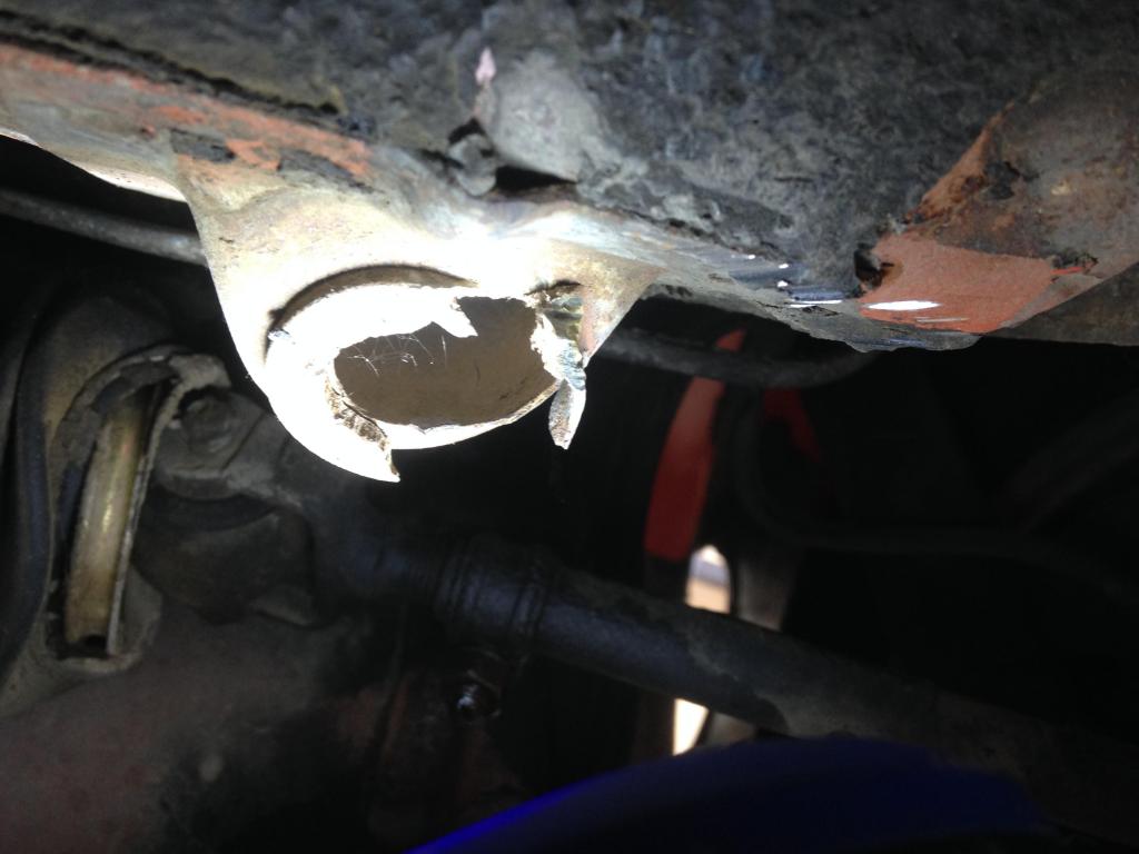

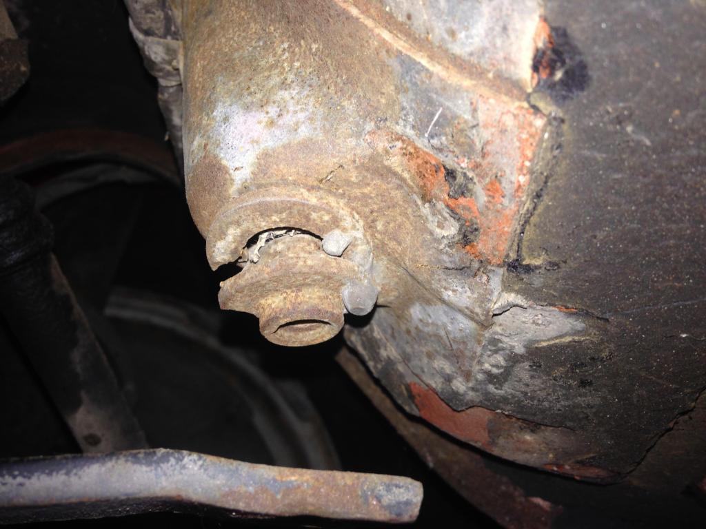

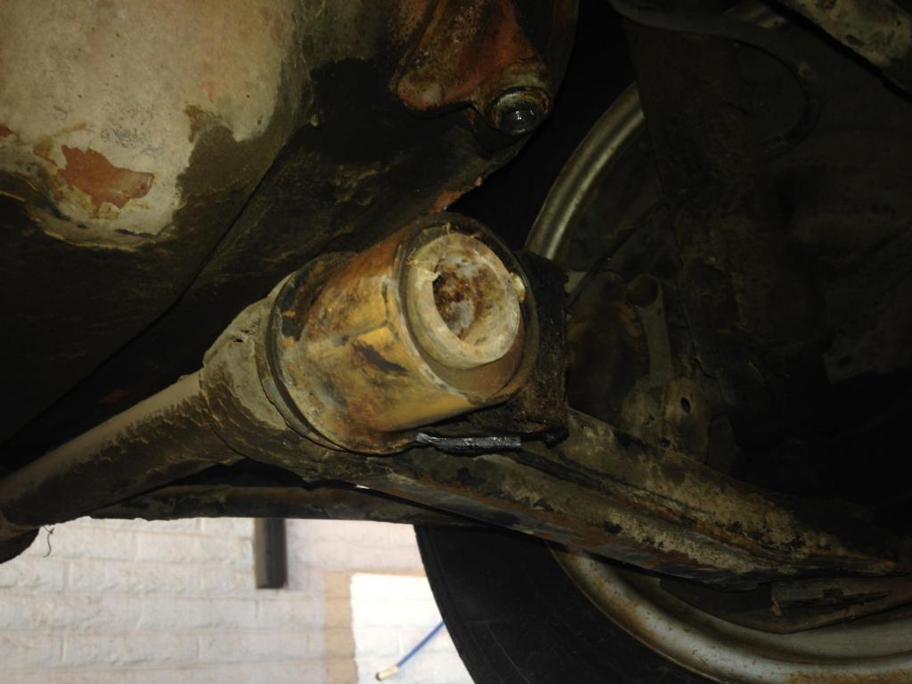

So I was looking into do I need the torsion bars if I go to coil overs and found this.
(IMG:http://www.914world.com/bbs2/uploads_offsite/i257.photobucket.com-8123-1423276736.1.jpg)
This car was hit on the driver side and I think it got pushed ? I will clean things up and think maybe I will need to cut the mount out of one of my donors ?
(IMG:http://www.914world.com/bbs2/uploads_offsite/i257.photobucket.com-8123-1423276736.2.jpg)
(IMG:http://www.914world.com/bbs2/uploads_offsite/i257.photobucket.com-8123-1423276736.3.jpg)
(IMG:http://www.914world.com/bbs2/uploads_offsite/i257.photobucket.com-8123-1423276736.4.jpg)
All cleaned up.
(IMG:http://www.914world.com/bbs2/uploads_offsite/i257.photobucket.com-8123-1423276736.5.jpg)
Back to the coil over with or with out torsion bar. The answer looks to be just leave them out. Rusted in good. But out now.
(IMG:http://www.914world.com/bbs2/uploads_offsite/i257.photobucket.com-8123-1423276737.6.jpg)
(IMG:http://www.914world.com/bbs2/uploads_offsite/i257.photobucket.com-8123-1423276737.7.jpg)

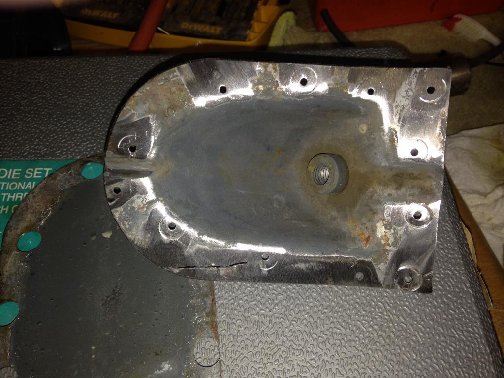

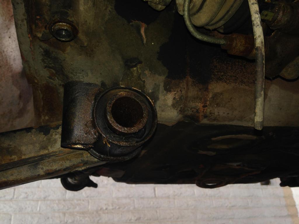

In looking at the mount today it will be a pain to remove . So what would be wrong with cutting it out ( dotted line) like the photo and weld it back in ?
(IMG:http://www.914world.com/bbs2/uploads_offsite/i916.photobucket.com-8123-1423327001.1.jpg)
Was thinking I can use the tab from the rear tie bar to hold it in place for welding .
Randy

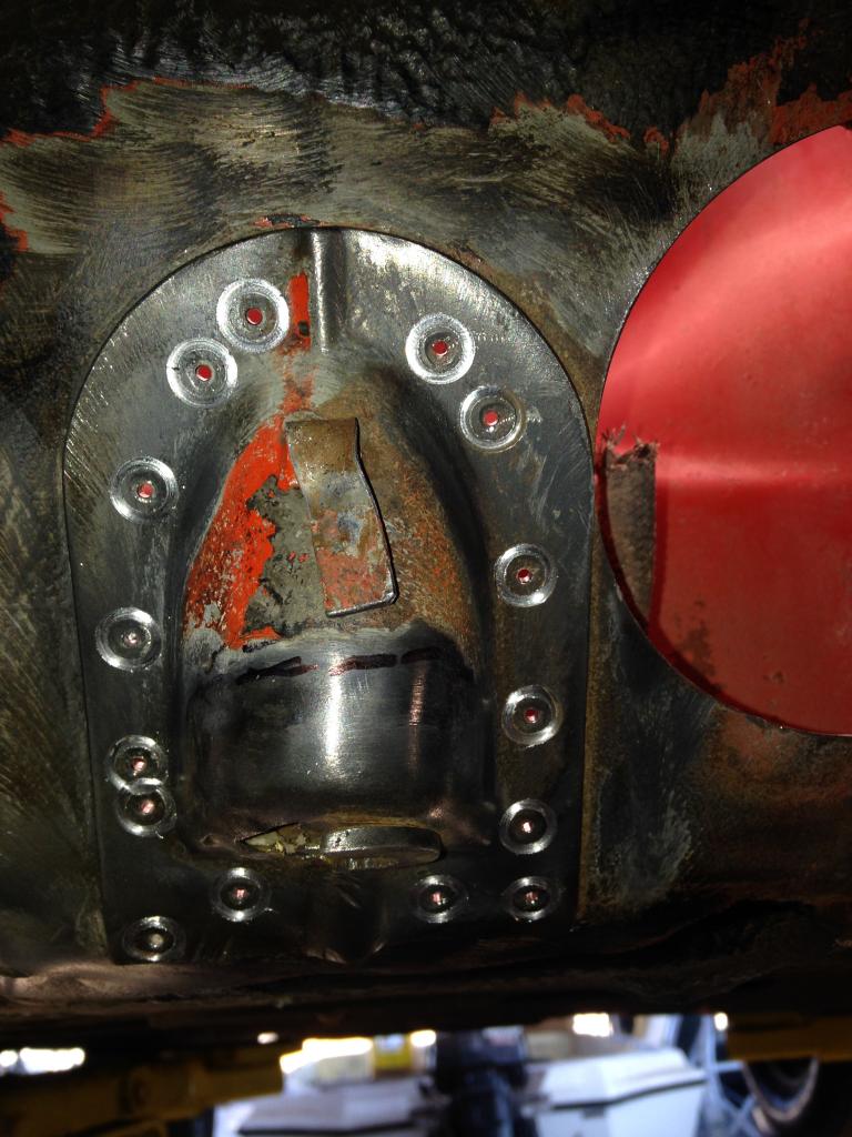

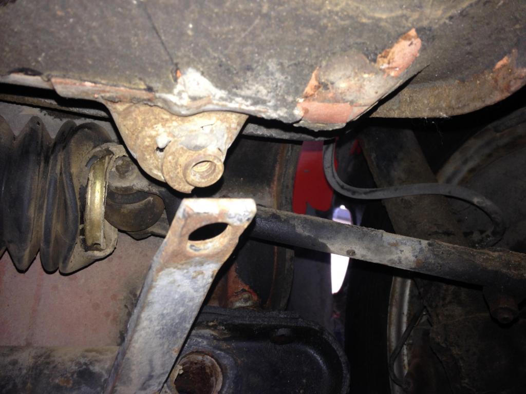

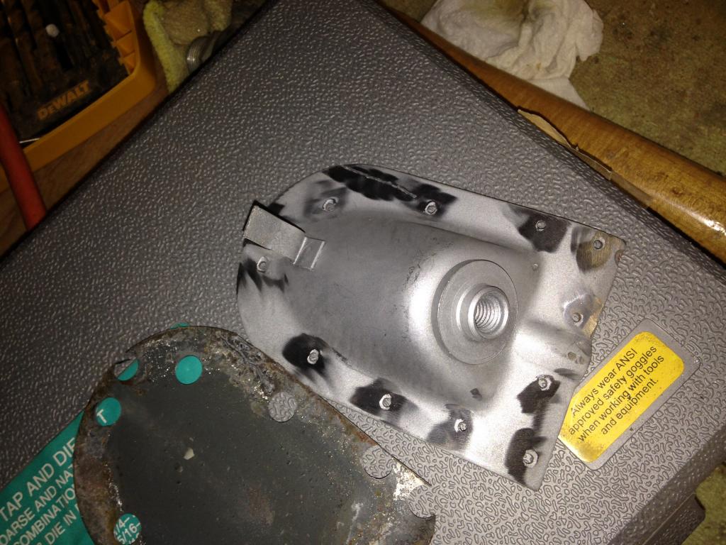

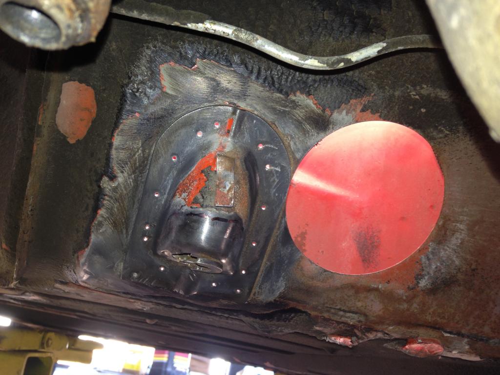

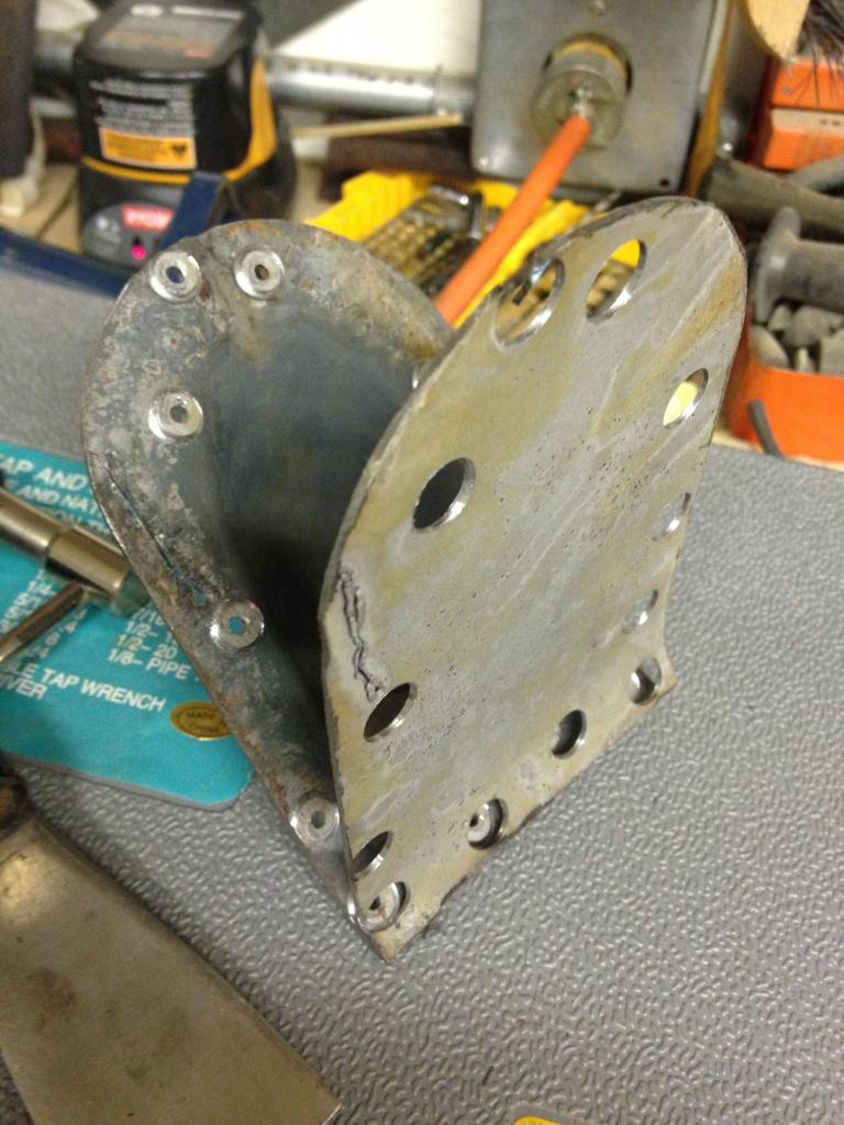

Got some thing out of the doner. I pulled the hole mount . I think I will remove the spot welds from the backside of the stamping. Then I will drill out the centers and spot weld to the chassis. This may give me more metal for the welding ?
(IMG:http://www.914world.com/bbs2/uploads_offsite/i257.photobucket.com-8123-1423360165.1.jpg)
I will need to pull the "A" frame on the passenger side and the steering rack to get to the spot welds on the damage part. PAIN !
But it is the best way to repair it. Going the other way was dumb ! (IMG:style_emoticons/default/chair.gif)

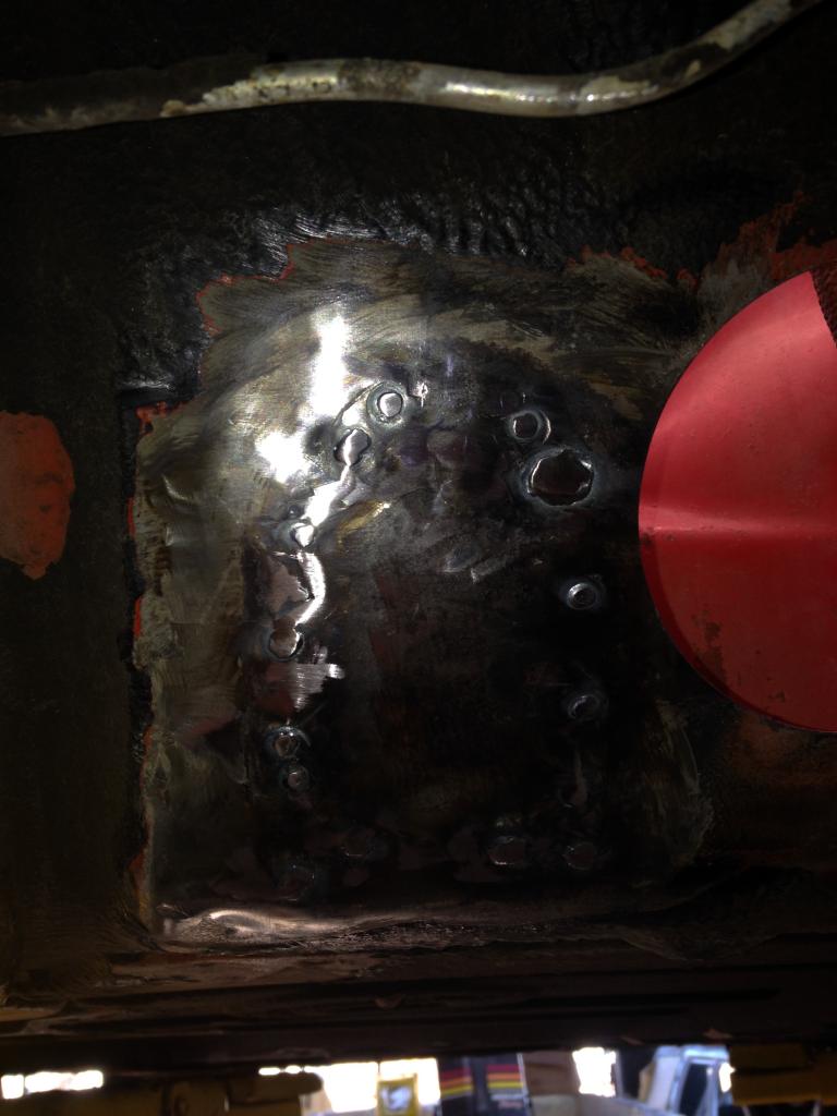

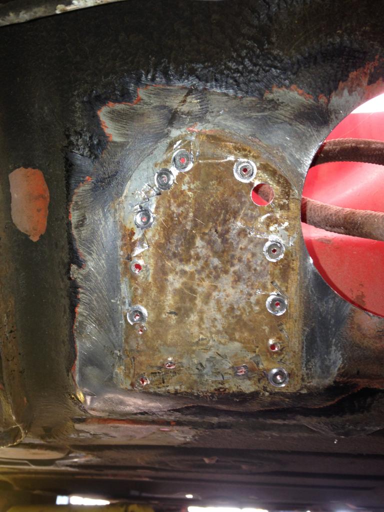

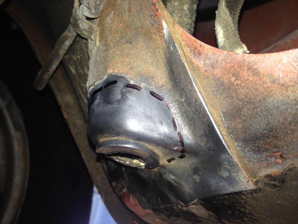

So I trimmed it up,drilled the pilot holes and used the weld cutter.
Now on to cutting out the bad part. Also need to weld up a small mistake. My bad. (IMG:style_emoticons/default/headbang.gif)
(IMG:http://www.914world.com/bbs2/uploads_offsite/i257.photobucket.com-8123-1423366742.1.jpg)
(IMG:http://www.914world.com/bbs2/uploads_offsite/i257.photobucket.com-8123-1423366742.2.jpg)
(IMG:http://www.914world.com/bbs2/uploads_offsite/i257.photobucket.com-8123-1423366742.3.jpg)

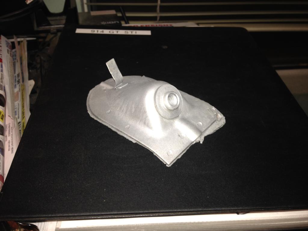

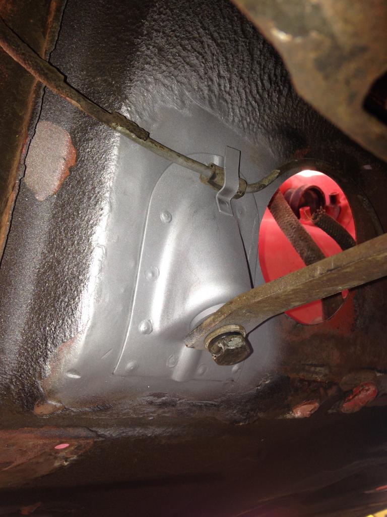

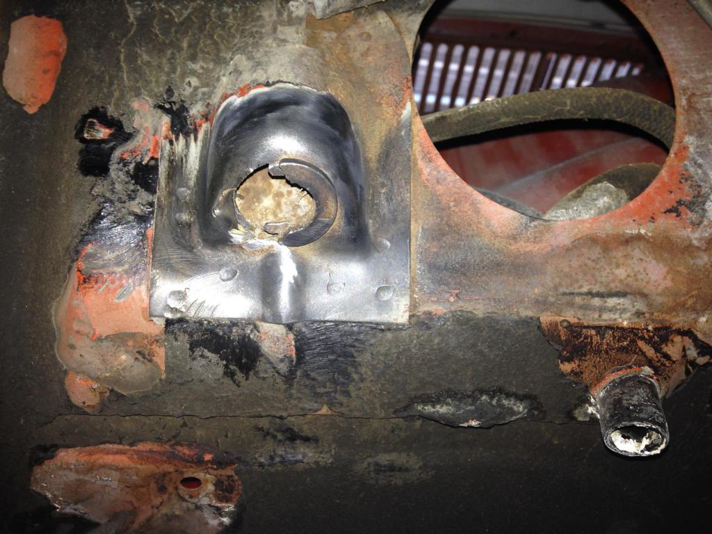

Back to work. I know this is nothing like the work I see here but its all new to me. Installed the steering rear mount. Took about 3 hours. You guys doing hole floors,just incredible is all I can say ! (IMG:style_emoticons/default/pray.gif)
(IMG:http://www.914world.com/bbs2/uploads_offsite/i257.photobucket.com-8123-1423436387.1.jpg)
(IMG:http://www.914world.com/bbs2/uploads_offsite/i257.photobucket.com-8123-1423436387.2.jpg)
(IMG:http://www.914world.com/bbs2/uploads_offsite/i257.photobucket.com-8123-1423436387.3.jpg)
(IMG:http://www.914world.com/bbs2/uploads_offsite/i257.photobucket.com-8123-1423436387.4.jpg)
914GTSTI
post Feb 8 2015, 05:06 PM
Post #57
Posts: 275
Joined: 16-September 07
From: Glendale AZ
Member No.: 8,123

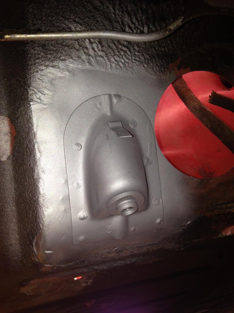

And now its all installed and almost looks stock ? Using the a frame mount work out well. Just make sure that the mount and chassis are in good shape.
(IMG:http://www.914world.com/bbs2/uploads_offsite/i257.photobucket.com-8123-1423436801.1.jpg)
(IMG:http://www.914world.com/bbs2/uploads_offsite/i257.photobucket.com-8123-1423436801.2.jpg)
Now on to the other holes and the jack plate. I may make my own mount ? Because I don't have the rear fender off it would be hard to install a complete one.
Not bad for a HACK ! (IMG:style_emoticons/default/lol-2.gif)

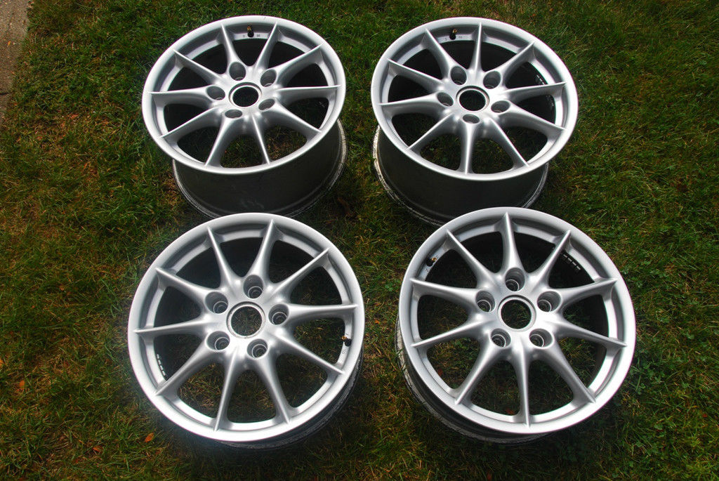

Hay CptTripps. Found some wheels you liked on a green 914. What do you think,can I make them fit ? Their 996 7" and 9" 50 and 55 offset.. From the photo of the green car it looks to have spacers.
(IMG:http://www.914world.com/bbs2/uploads_offsite/i916.photobucket.com-8123-1423501787.1.jpg)
