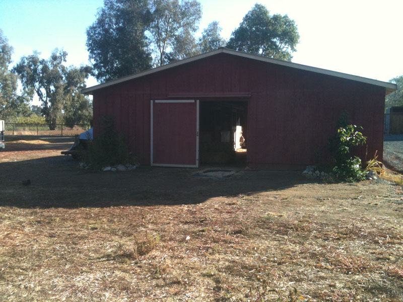

With the purchase of my 3rd 914, and winter coming I thought it was time to take a break from the cars and start working on my shop. Originally I was going to build a seperate building, but recently we shipped my daughters horse to her in Texas, and now with only one left I started looking at the unused space in our barn.
I built the barn 10 years ago, as a 4 stall barn, 34' X 36'. Seperating off the two end stalls would give me a 24' X 34' shop....works for me. (IMG:style_emoticons/default/beer.gif)
Here is the "Barn" end.

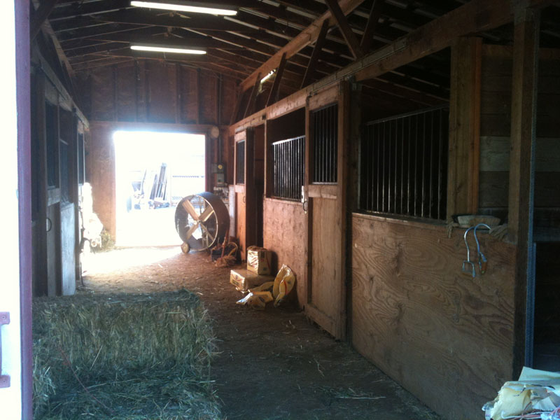

And the inside before the transformation begins.

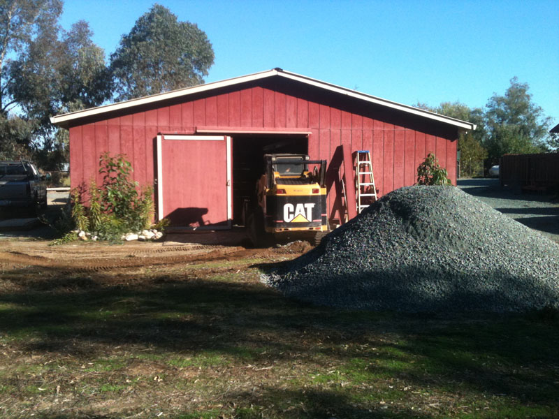

My other buddy, concrete contractor, spreading the base rock.
Base in and spread, even had enough to start a driveway. (IMG:style_emoticons/default/aktion035.gif)

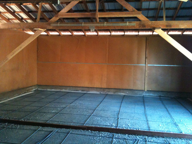

This weekend got the base raked and compacted, put in some bracing so I could remove the last two posts, and started laying rebar.
Today finish up the rebar, and install expansion joint material around the edges.

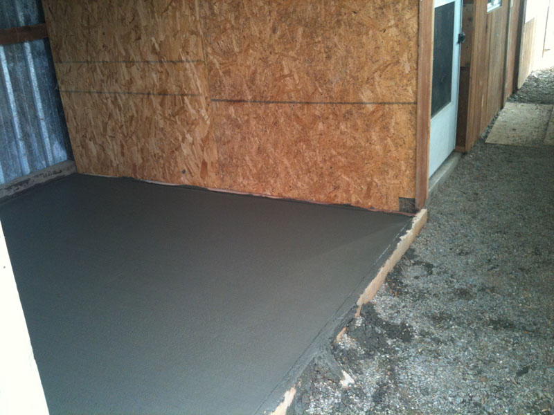

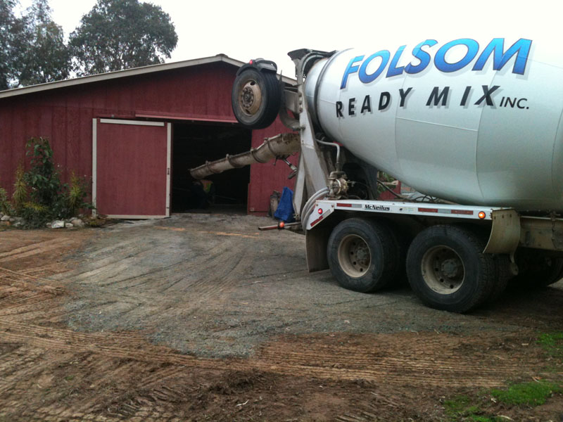

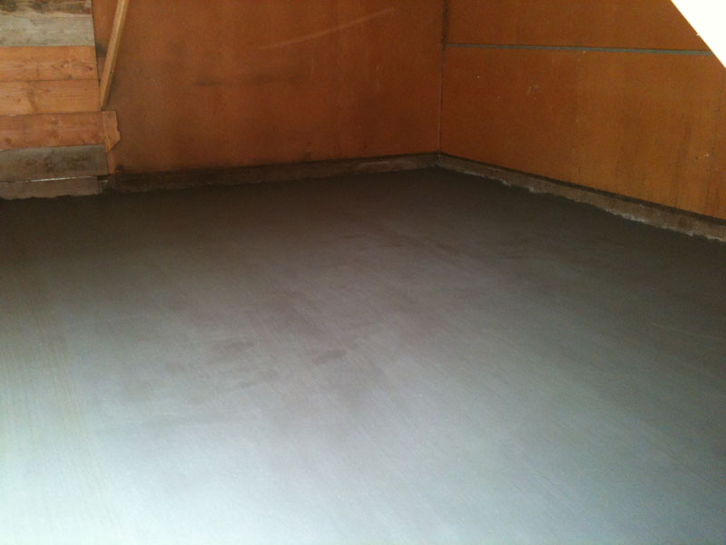

Since the shop was going to take more than one truck could haul I decided to pour a slab in my dog kennel also. I had one area in the covered part of the kennel, that I didn't have a slab in.
The weather held off, only had a few scattered showers here and there. Got the trucks in and poured before the nasty weather hit.
The dog kennel poured and finished
The shop poured and finished (IMG:style_emoticons/default/piratenanner.gif)
Now the fun begins, finishing off the inside.
