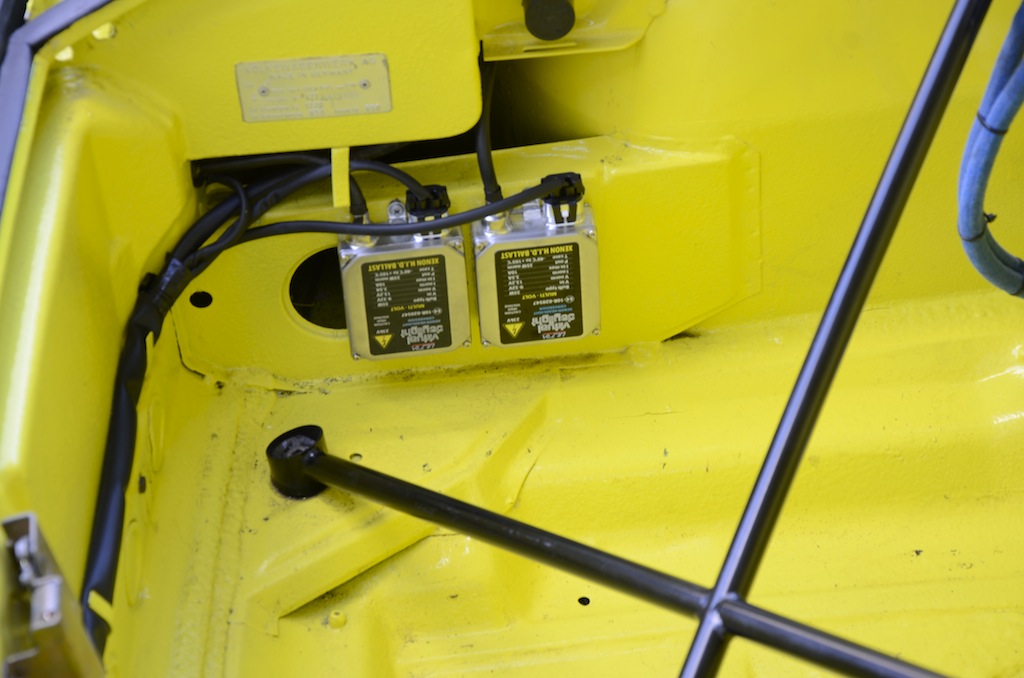

I'm running them for the headlights and driving lights. Had them done as part of the re-wire of the whole car. I just used the original housings. Have not had the opportunity to use them yet as the car is not registered but testing them in the driveway shows them to be exceedingly bright.
