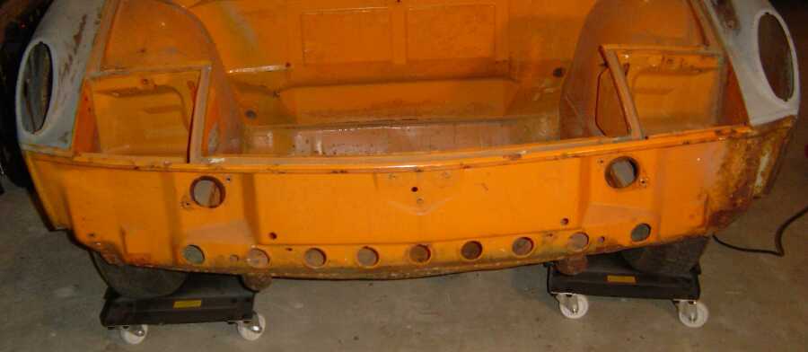

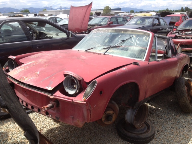

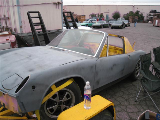

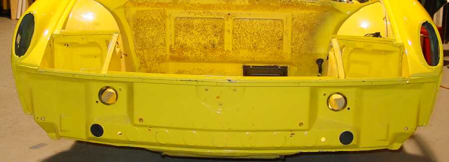

475.29.09903, painted over but clearly holes with plastic plugs:
(IMG:http://www.914world.com/bbs2/uploads/post-2460-1348093952.jpg)
(IMG:http://www.914world.com/bbs2/uploads/post-2460-1348094191.jpg)

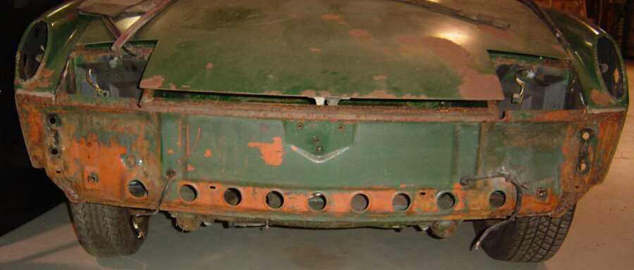

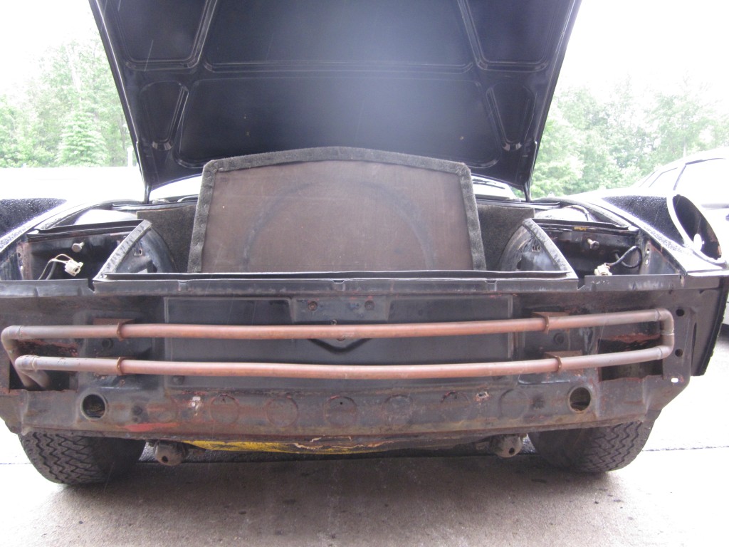

476.29.03506, and here's a '76 with holes:
(IMG:http://www.914world.com/bbs2/uploads_offsite/i1068.photobucket.com-179-1354331823.1.jpg)

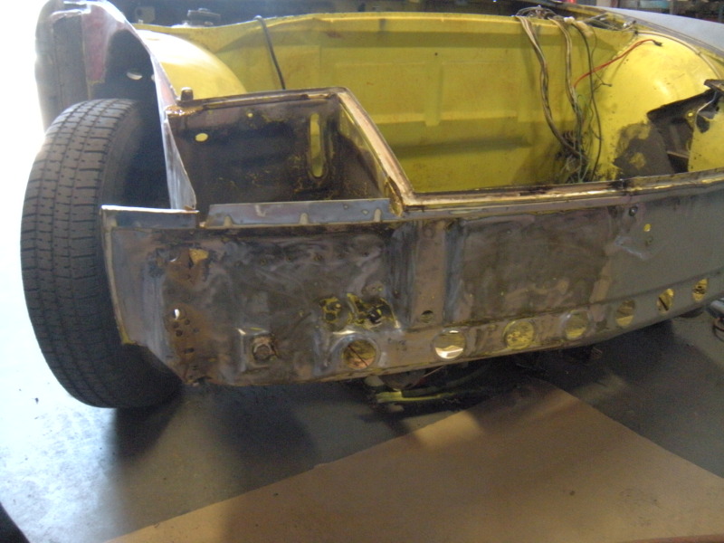

476.29.01132, and another '76 with the black plugs:

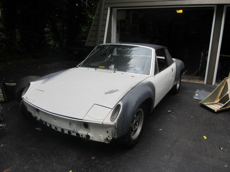

47629.00593, and another:

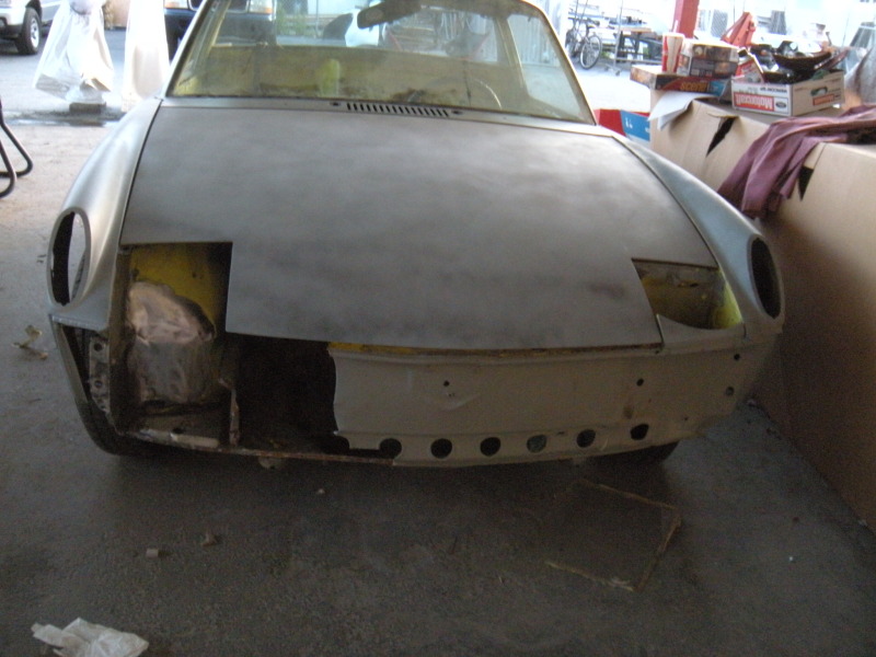

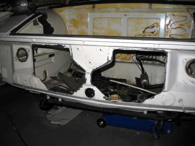

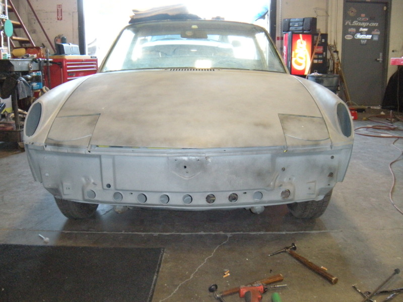

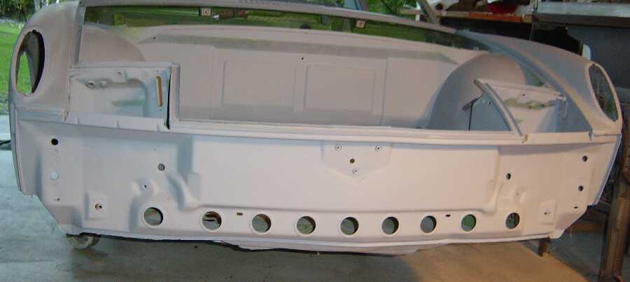

I Have a 72 and bought a right front body section off of a 73 with the
headlamp bucket as well (mine was toast from previous owner/hacked & filled
with bondo). I must of stared at that forever thinking it wasn't the same as the other side (we sectioned it) and now I also notice the headlamp buckets are different too as the 72 has the brush wipers as the the 73 side as the larger opening where the oval hole is "taller" and won't fit a brush (but figured out a way
to modify it). This is how it came out:
(IMG:http://www.914world.com/bbs2/uploads_offsite/img.photobucket.com-12969-1354390065.1.jpg)
(IMG:http://www.914world.com/bbs2/uploads_offsite/img.photobucket.com-12969-1354390066.2.jpg)
(IMG:http://www.914world.com/bbs2/uploads_offsite/img.photobucket.com-12969-1354390066.3.jpg)
