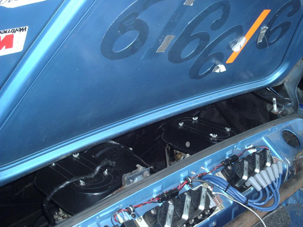

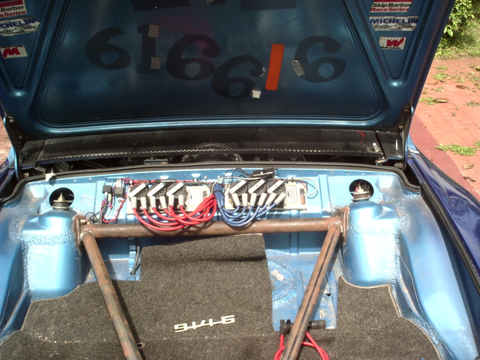

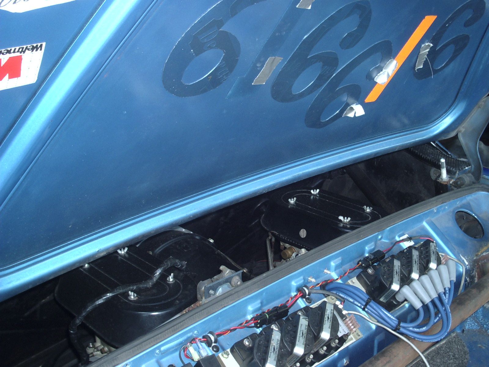

I have Electromotive on my 6, and yes Joe did do the install. You can see it in my signature. It is expensive, but once it is set up it is bullet proof. It is laptop programable.
