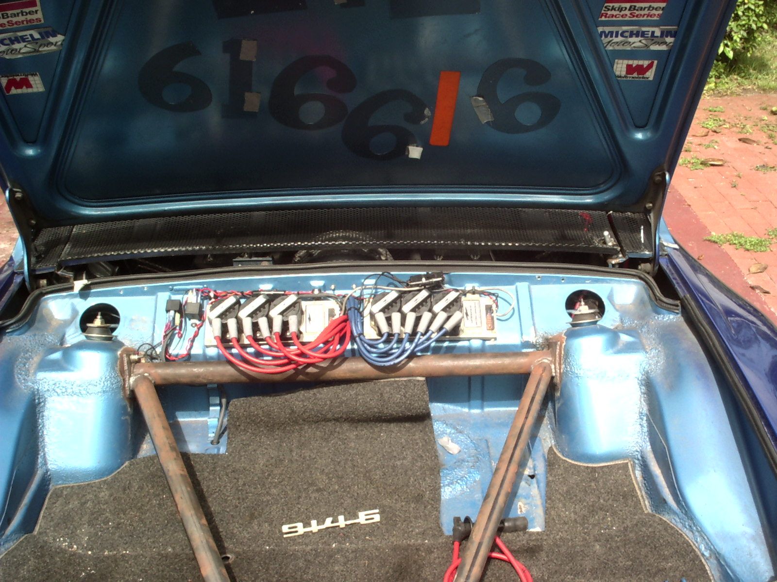

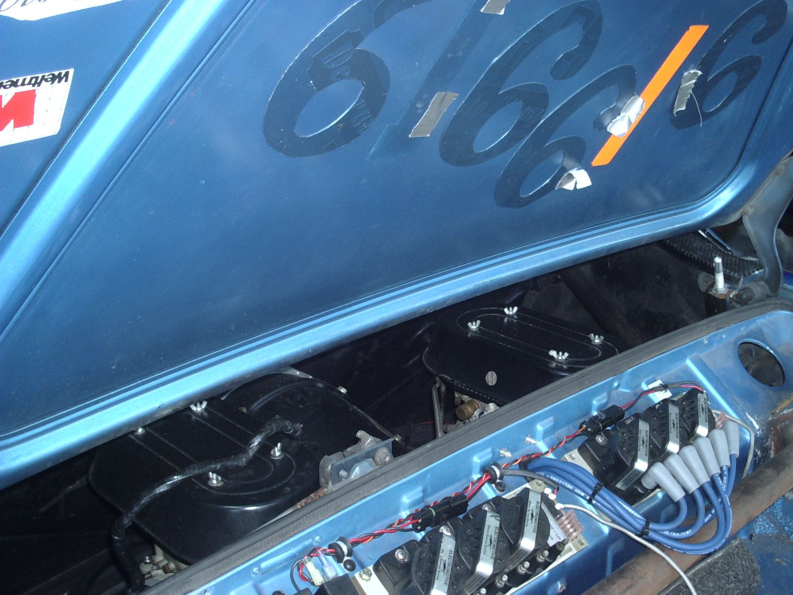

carr914
Dec 9 2012, 08:00 AM
I have used it in the Past on 2 Cars in Twin-Plug applications & it worked well. I used early versions (Dials not computer adjustments).
