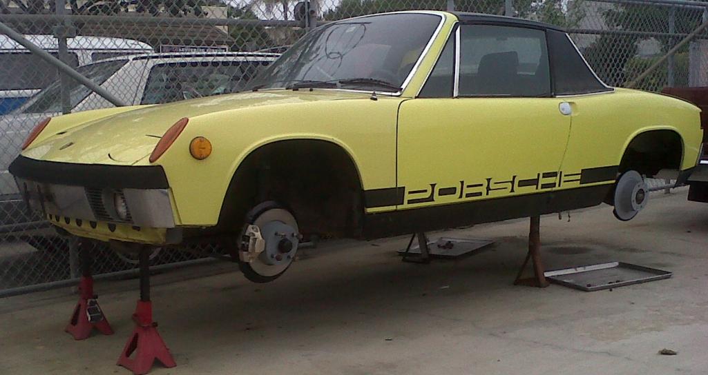

> So...need some help to decide the fate of my '72, To convert or keep original
NARP914
post Dec 14 2012, 04:30 PM
Posts: 15
Joined: 18-March 08
From: Mission Viejo, CA
Member No.: 8,826
So I found this pretty clean and I've been kicking the idea to do a conversion to a 6 or just get this running as is with a better motor. This is a '72 with 1.7L motor, found this in San Diego a few months ago and seems to have a bad cylinder, according to the previous owner. Finally got around to getting the brakes done and at the time I was just going to get it running. (IMG:style_emoticons/default/driving.gif)
Since I've had plenty of time to think about this car, I was wondering if a 6 conversion might be something to consider. My question for all those out there that have done a conversion... how much of a pain is it to do one and are parts readily available to finish a 6 conversion? (IMG:style_emoticons/default/welder.gif)
Just like to get some feedback from all those out there that have gone down the path to the darkside. (IMG:style_emoticons/default/aktion035.gif)
Thanks in advance,
Eddie

Nice ride..I never done a 6 conversion, but please be careful with those front jackstands..They are evil

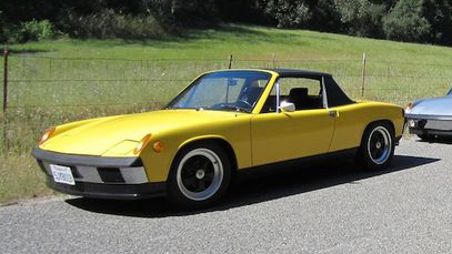

I finished my 3.0L conversion in about 9 1/2 months! But I spent 14 years collecting parts!
I bought my low mile engine first and kept it oiled, turned and very dry for the 14 years. I bought my 5 lug 86 sc suspension about 6 years ago. The wheels came about 3 1/2 years ago.
Then I sold my original 6 and bought a 75 with a blown 1.8L and a bad trans for $1100 to start the conversion!
The car $1100
The FI 3.0L engine with all gauges and harness $5000
The suspension $300
The oil tank $700
The motor mount $350
Engine shelf under battery (AC Crap) $165
The carpet kit $200
Rebuild trans (evil clinic) $400 including parts
Convert oil cooler $200
Oil lines $300
Engine tin $350 (group buy)
Misc cables and tune up stuff $600
Rear suspension bushings and bearings $300
5-lug hubs and rotors $500
2 sets of 4 16"x 6", 7" & 8" Fuchs $850
4 Toyo tires $950
Total $12265
Sold - $2000
New $10265
But, I got everything cheeper than what it would cost today! Luckly the paint was good and there was no major rust repair!
Edit: Forgot the Twin tip Muffler $300 and the headers (free with an engine stand I bought) I also sold a bunch of other stuff like 4-lug stuff and recovered at least $2000 back from that stuff!

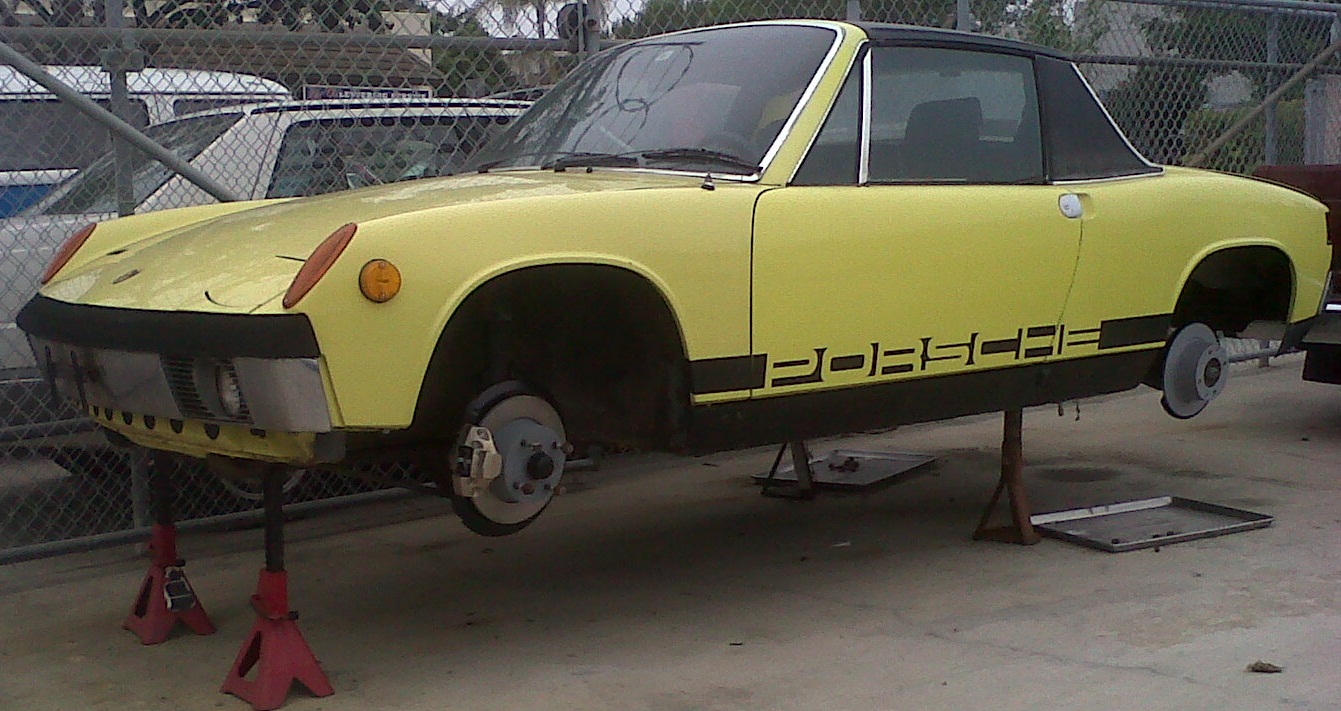

Thanks for the information on doing a conversion. I'm still up in the air about moving forward or not. I have bought some stuff along the way just in case I go down the darkside. Have my Fuchs already, picked up a 2.2L 6 motor and the tranny on this car is solid from what we were able to look over. (IMG:style_emoticons/default/aktion035.gif)
This is not my first 914, but the body is in such good shape and that was the main reason for picking this non running car when I bought it, had a great foundation to build a 6 on. I'm going to start picking up some more parts and see if this is what I really want to do. Besides, I can always sell off what I won't use. (IMG:style_emoticons/default/santa_smiley.gif)
Any good source for metal GT flares out there or does someone have a set they want to sale? (IMG:style_emoticons/default/chowtime.gif)

Those jack stands are making me queasy! When I get under a car I have QUALITY jackstands (I would have 6 or 8 under there for a car completely off the ground) plus I even have my floor jacks in position.
When I was growing up the father of a friend of mine was missing his right arm and leg....a car fell on him when he was in his 30's. That image sticks with me to this day. Jackstands are inexpensive compared to the costs of a limb or a life.

As mentioned before, this is a clean body car in excellent shape, Andy went with me on the road trip to fetch this car and he gave me the thumbs up to buy... I have soft spot for yellow cars...
Been learning a ton from this site and everyone on here giving advice, thanks for that in advance. I think this will be a great car for a conversion, can anyone point me in the direction to find metal GT fenders? Anyone have a set they're thinking of selling?
Where is a good source for the motor mounts I'll need for the conversion, I'm sure there is a long list of parts I'll need to gather.
