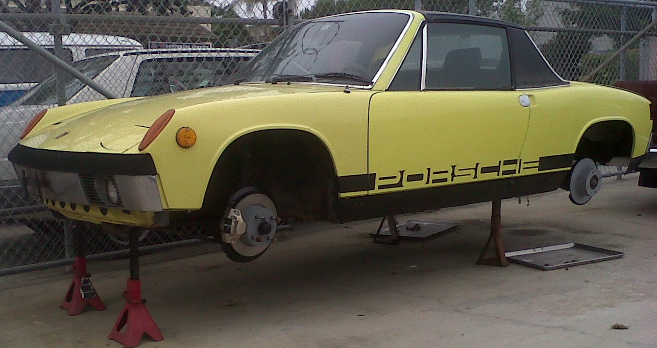

So I found this pretty clean and I've been kicking the idea to do a conversion to a 6 or just get this running as is with a better motor. This is a '72 with 1.7L motor, found this in San Diego a few months ago and seems to have a bad cylinder, according to the previous owner. Finally got around to getting the brakes done and at the time I was just going to get it running. driving.gif
Since I've had plenty of time to think about this car, I was wondering if a 6 conversion might be something to consider. My question for all those out there that have done a conversion... how much of a pain is it to do one and are parts readily available to finish a 6 conversion? welder.gif
Just like to get some feedback from all those out there that have gone down the path to the darkside. aktion035.gif

Nice ride..I never done a 6 conversion, but please be careful with those front jackstands..They are evil

If you're serious about the six and have money to burn, buy all the parts now and get it done. If it's going to take time, drop another 4 cyl engine in (decent running ones can be had for little money) and drive it while you're accumulating the parts. These cars are more fun on the street then when they are collecting dust on jack stands, regardless of engine size.
Whatever you decide, it looks like you've got a nice starting point with that car!

Those jack stands are making me queasy! When I get under a car I have QUALITY jackstands (I would have 6 or 8 under there for a car completely off the ground) plus I even have my floor jacks in position.
When I was growing up the father of a friend of mine was missing his right arm and leg....a car fell on him when he was in his 30's. That image sticks with me to this day. Jackstands are inexpensive compared to the costs of a limb or a life.

It looks to be ready for wheels. smile.gif It would be awesome with steelies imo. I love the stripe and the yellow. Is it the snowplow rear valance?
