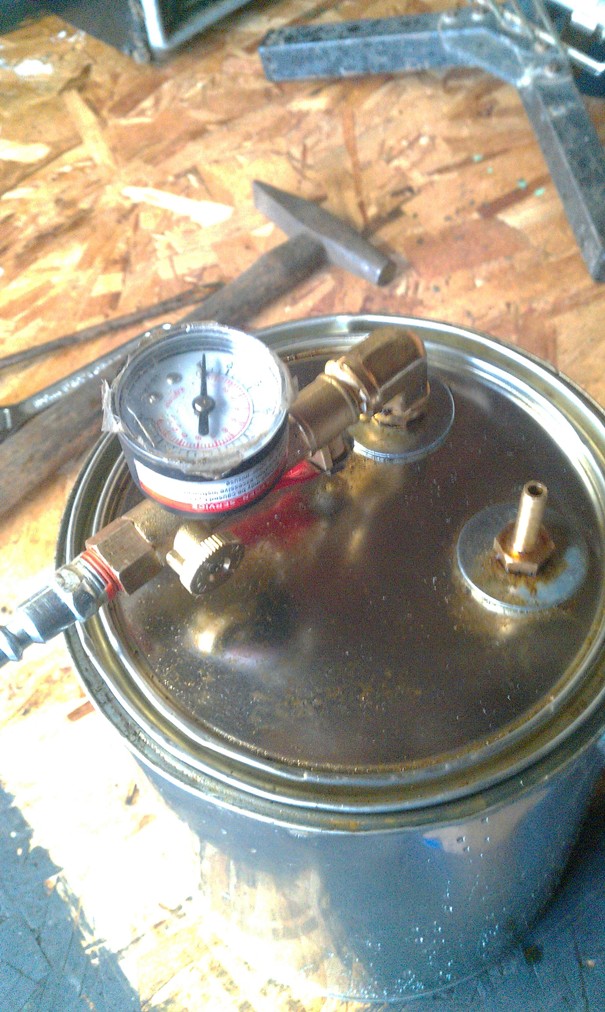

I going to be building a DIY smoke tester to find a vacuum leak on my sons 99 Explorer.
I was wondering has anyone used one on a 914?
Would it even work?
http://www.fiero.nl/forum/Forum1/HTML/081547.html
http://www.youtube.com/watch?v=HbkGhUov74Q
I'm thinking we would inject from the MPS hose to keep the smoke off the diaphragm.
Thought?
BTDT's?
I am the tool whore. But I'm not feeling the love on even a well used one.

Well it worked ..........
Found the leaks on the Explorer.
