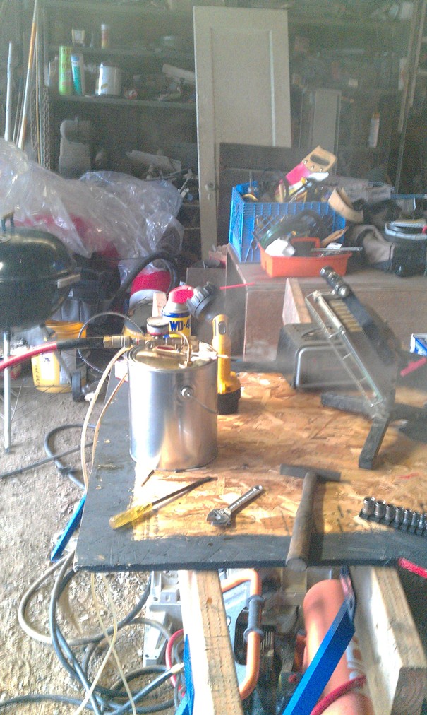

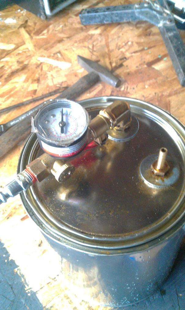

I going to be building a DIY smoke tester to find a vacuum leak on my sons 99 Explorer.
I was wondering has anyone used one on a 914?
Would it even work?

I'm thinking we would inject from the MPS hose to keep the smoke off the diaphragm.
Thought?
BTDT's?

Well it worked ..........
Found the leaks on the Explorer.

On the new cars the stuff is packed in there pretty tight.
I was pretty certain what the problem was. It was nice to see the smoke come out from exactly where I thought it would come from.
