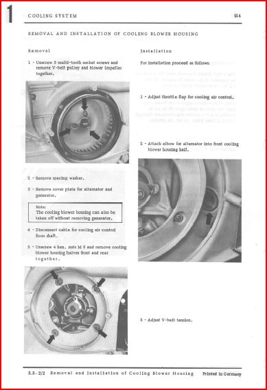

Is there a specific torque setting for the large bolt that holds the fan boss onto the front of the crank?
I have the settings for the bolts that hold the fan to the boss, but not for the boss to the crank.

Does this sound right?
"Screw for Blower Wheel Hub." M8 Thread 23.1 ft. lbs.
"Screws for Blower Impeller." M8 Thread 14.5 ft. lbs.

QUOTE(wndsnd @ Jan 5 2013, 01:29 PM) *
John
Bingo!
Tht was the one. Thank you!!
