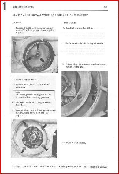

Is there a specific torque setting for the large bolt that holds the fan boss onto the front of the crank?
I have the settings for the bolts that hold the fan to the boss, but not for the boss to the crank.
Haynes doesn't have it listed.
TIA
wndsnd
Jan 5 2013, 03:29 PM
Does this sound right?
"Screw for Blower Wheel Hub." M8 Thread 23.1 ft. lbs.
"Screws for Blower Impeller." M8 Thread 14.5 ft. lbs.

QUOTE(wndsnd @ Jan 5 2013, 01:29 PM)
John
Bingo!
Tht was the one. Thank you!!
