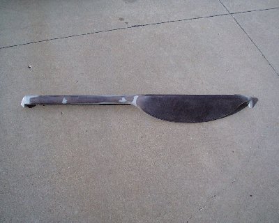

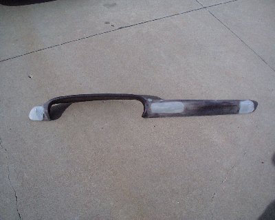

tracks914   I filled the cracks in my dash with 3 minute epoxy...   Jan 6 2013, 07:46 PM

tracks914   BTW I did cut back the edges too when i used epoxy...   Jan 9 2013, 01:02 PM
