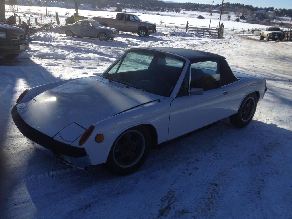

Here's a pic of the teener in daylight!Attached Image
