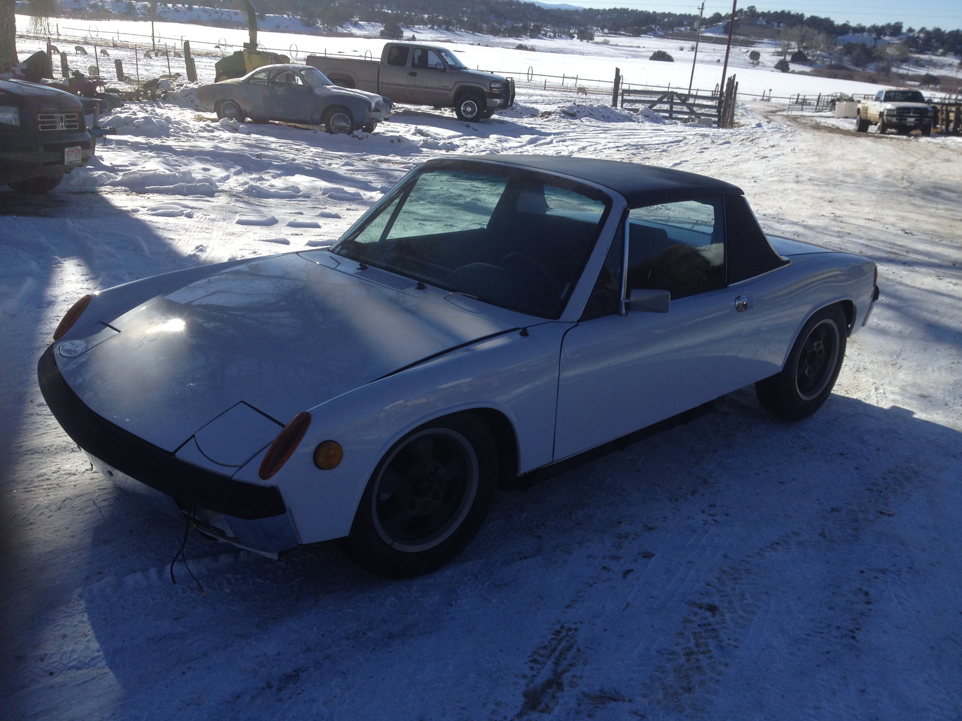

Here's a pic of the teener in daylight!Click to view attachment
