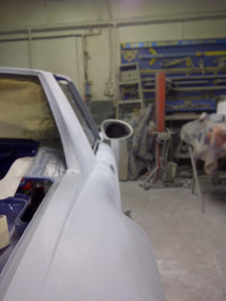

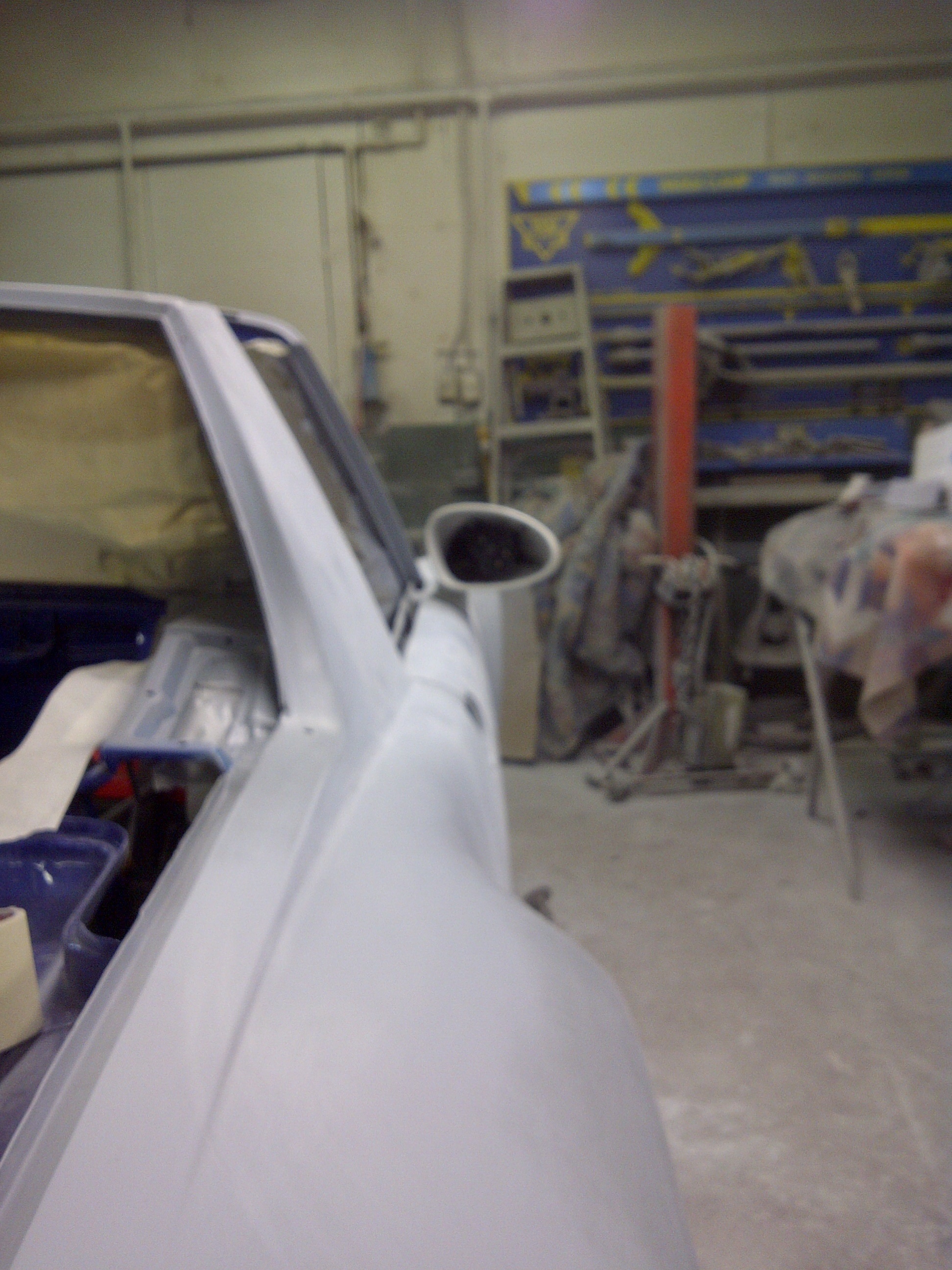

My car is currently at the body shop, and they guys just finished putting on the mirrors. The passenger side looks good, but the driver side looks like it points too high.
I bought the kit direct from Porsche, so they should be all the correct parts. We did notice that the base the driver mirror sits on is taller than the passenger.
Is this normal?
What have you guys seen in the past? Is there possibly another base that is smaller for the drvr side?

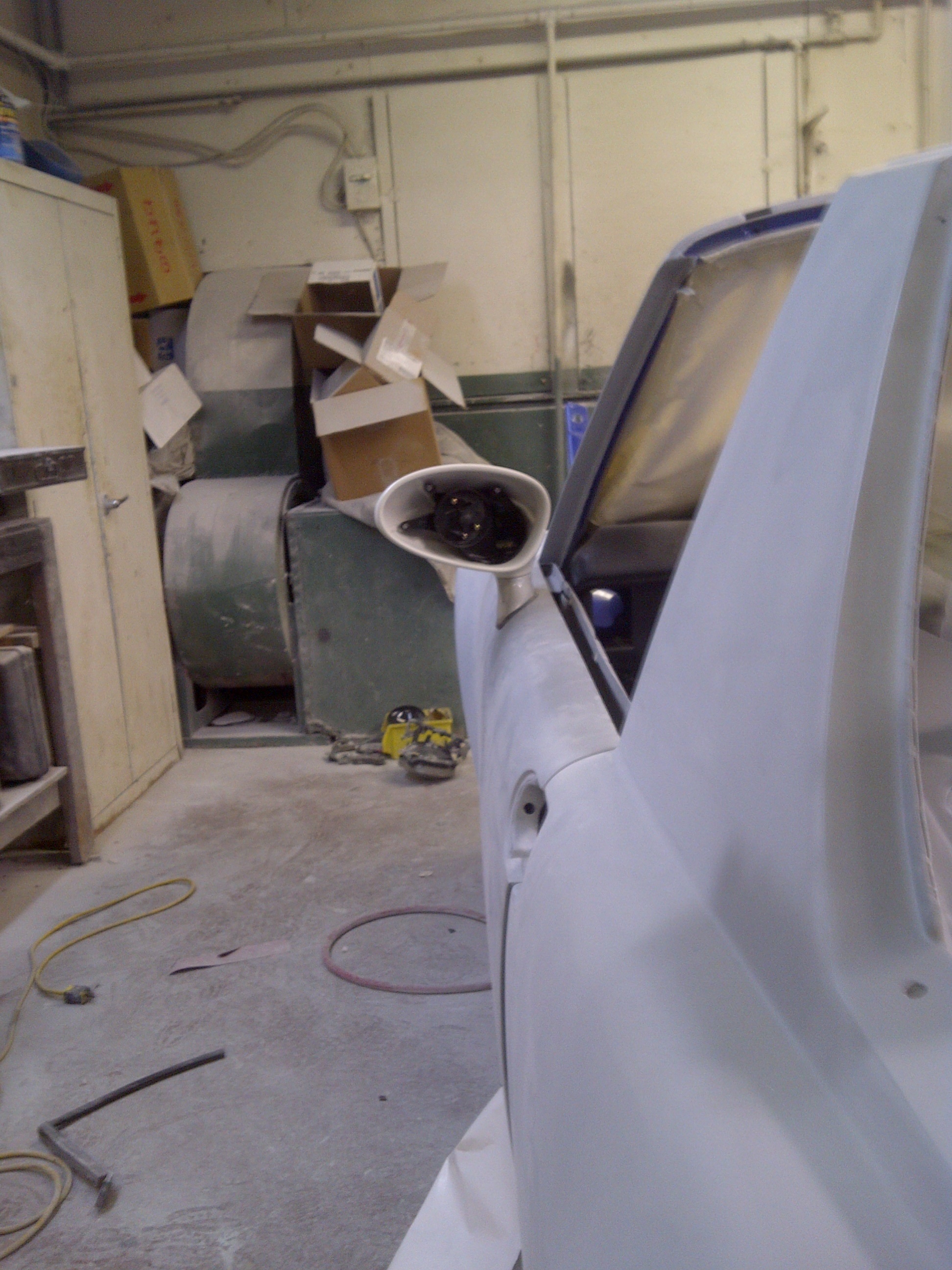

the passenger side, not as clear of a picture, but you can tell the angles are different

I don't know about those mirrors, but people have to shape the bottom of the flag mirrors to fit the profile of the 914 doors. You say the driver's side is "mounted higher", so it would be going up the curve into the top part of the door, tilting it like that. Maybe try shaping the base so it tilts further out... better than re-mounting it in the same lower position as the passenger side.

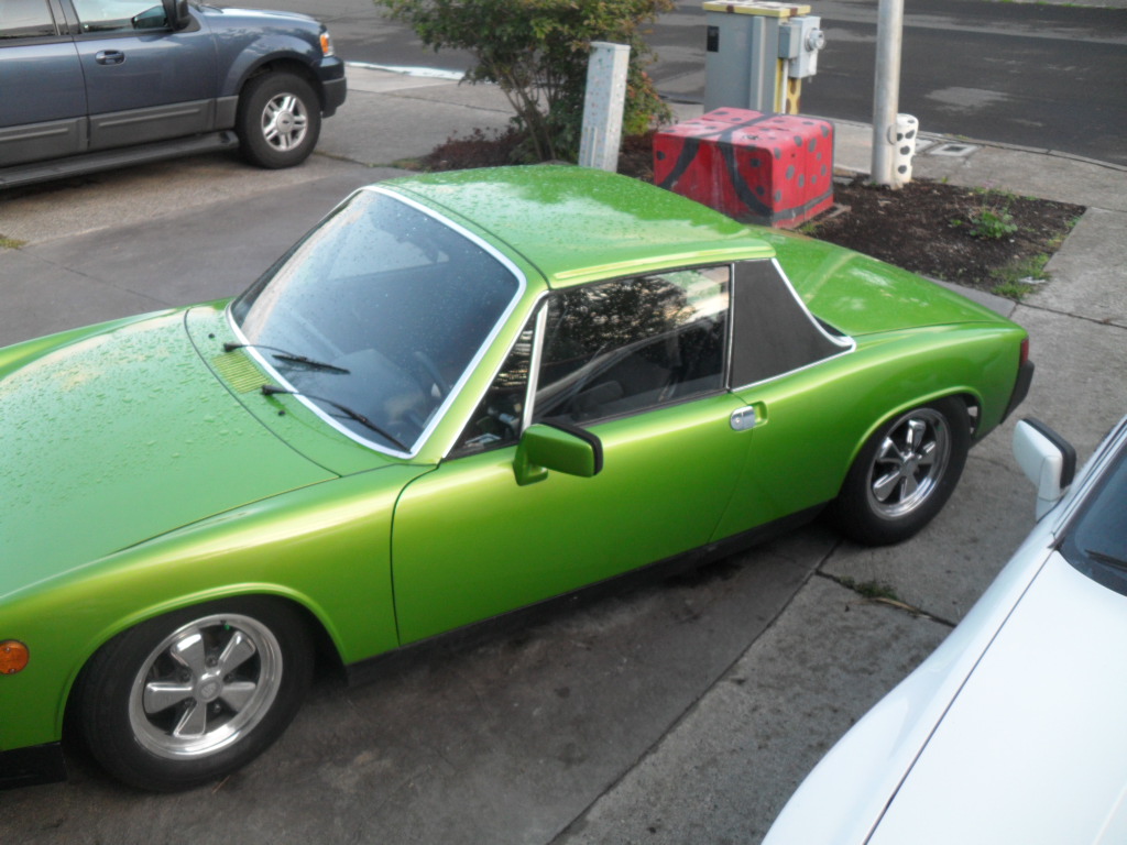

They don't mount symmetrically... (IMG:style_emoticons/default/sad.gif)
(IMG:http://www.914world.com/bbs2/uploads_offsite/forums.pelicanparts.com-10496-1357782972.1.jpg)

You need to lower the drivers mirror. Move it down on the door towards the ground. This will level out the top.
From your pic, I would guess it needs to move down 1 inch or so.

I don't think either one of your Aeros are mounted correctly
You definately have to machine down the Bases of these or Flags to fit correctly

Yeah, but don't re-drill mounting holes. Do what T.C. suggests, re-shape the mirror bases so you get the angle you want with the mirrors in the same mounting holes they're already in.

QUOTE(peteyd @ Jan 9 2013, 09:36 AM) *
There are no "correct parts" for this mod. Fitting these will be just like fitting aftermarket mirrors that were designed for some other car. Adjustment, fitting, trimming, possibly shimming, and more modifications may all be required.
Figure out how to make it work, and don't sweat having to alter the parts. Because they're not the "right" ones anyway. (IMG:style_emoticons/default/smile.gif)
