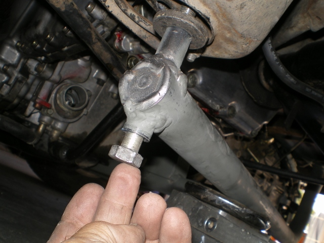

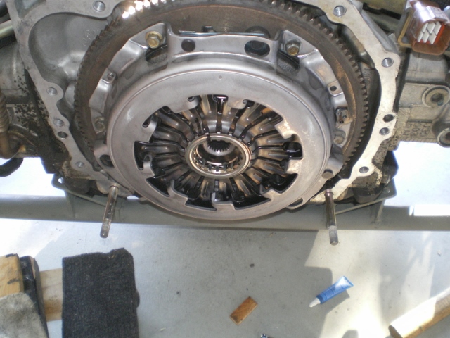

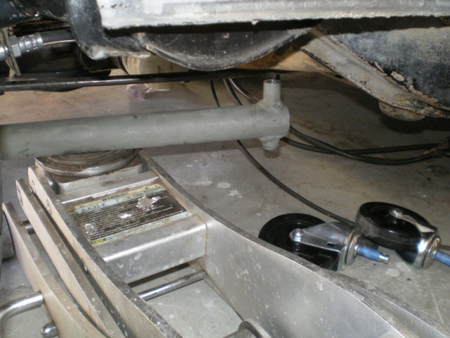

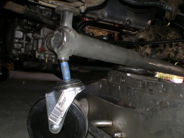

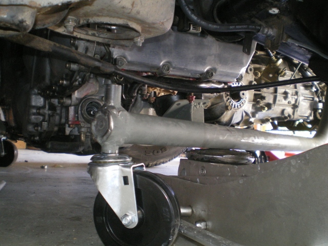

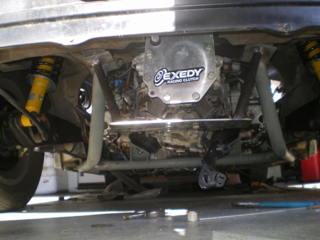

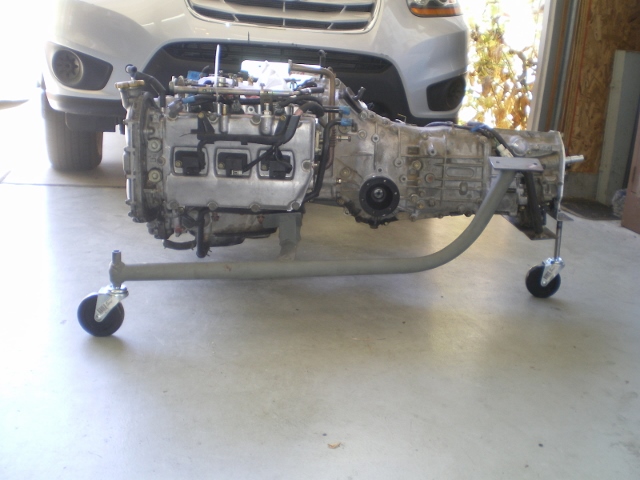

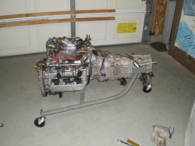

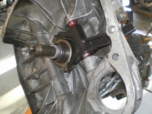

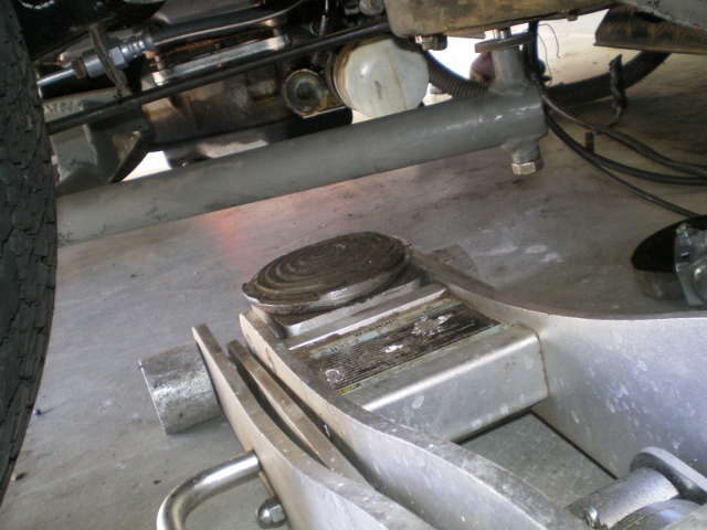

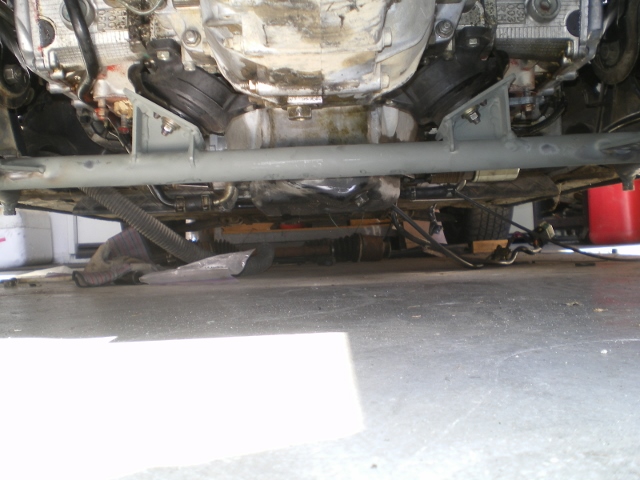

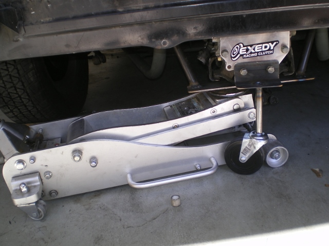

I installed the new clutch
and TO bearing. Must admit that "pull clutch thing" threw me a curve ball at first.
But before I slapped the drive train back into the car for another fit I did something I'd wanted to do since I began bouncing this cradle design around in my head. First I retired this contraption. They will be re-purposed in a welding station.

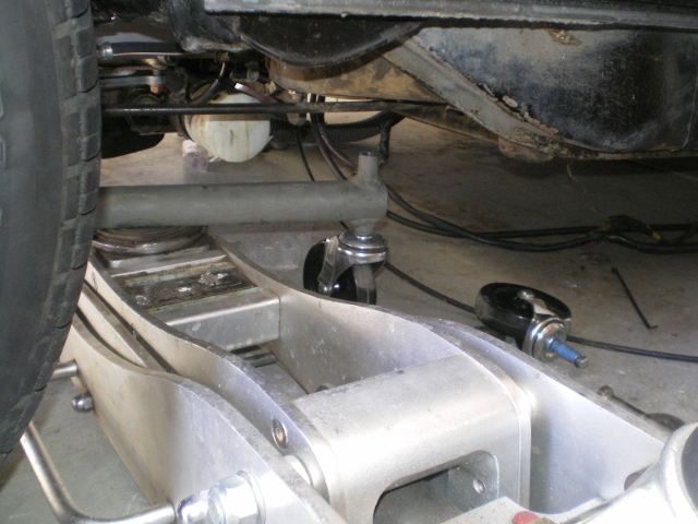

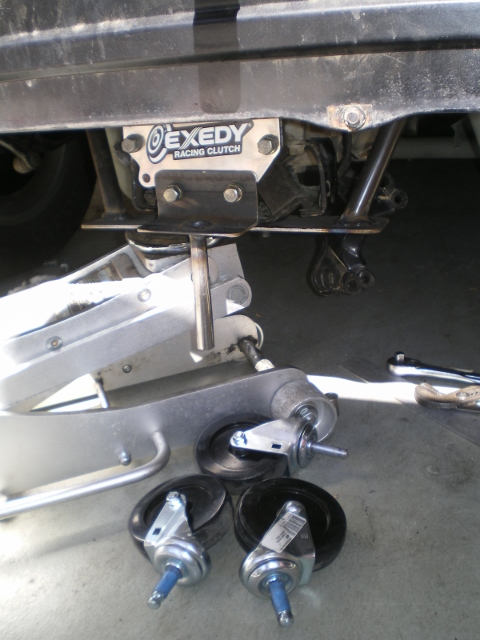

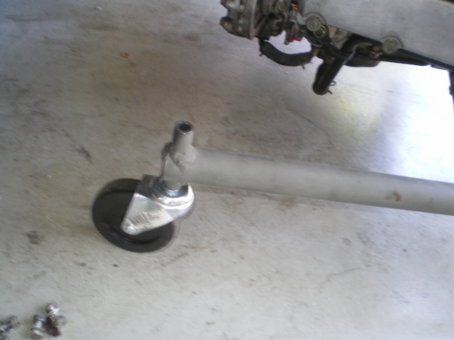

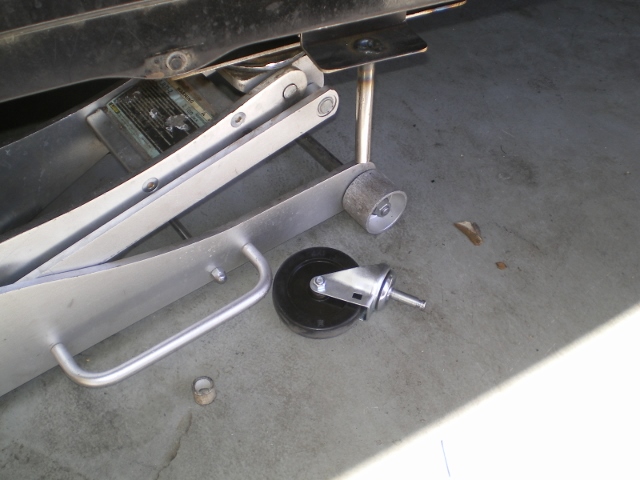

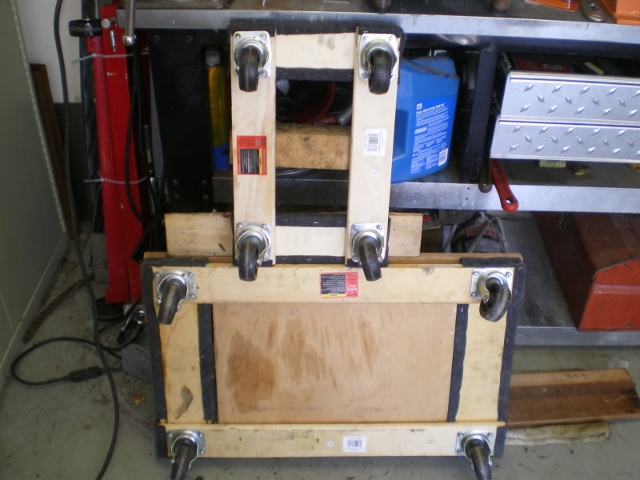

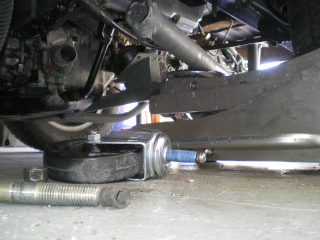

And did this. $24 worth of casters, scrap piece of DOM & 2" angle. It's a dream to move around the shop and no worries about tipping over, either.

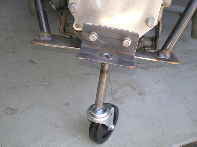

But I saved the best part for last. Watch how fast and easy the install back into the car goes. After rolling the assm under the car (with the wheels on the car) I line up front left mount and place the floor jack under the cradle
Raise it 2" or until the wheel falls out
Then the bolt is slid back thru with a large washer to mate against the factory bracket and spread the load. BTW, both the bolt and washers are re-purposed from the old rear mounts. The nut with a smaller diameter fat washer are started from above but not tightened. One down
Repeat on the right side. Two down
Back to the tail and just like the sides it's jacked up 2" but after the wheel falls out the receiver is removed from the tranny and the rear mounts are fastened to the old rear receivers as shown in an earlier post here. After the rears mounts are tightened I go back and finish tightening the fronts.
And it's a good thing that I went with gas struts for the lids because this brace that contained the 2 torsion rods for the old truck lift ended up dead center of the TB throat. I'll grind 'em down later but that spot might get a trim anyway. (IMG:style_emoticons/default/sawzall-smiley.gif)
Plenty of clearance up front
This is the Carrot in Front of the "yours truly" Donkey. Just seeing it sitting there should keep me motivated. I believe the cradle is finished short of paint and a few weld tabs for the shifter or exhaust system.

Cool (IMG:style_emoticons/default/smile.gif)

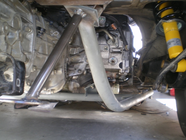

There's no front cross member under the engine? The mounts being aft of the engine's centerline are adequate? (IMG:style_emoticons/default/confused24.gif)

See now you're just showing off...slow down Kent! I almost caught up! (IMG:style_emoticons/default/poke.gif)
Looks great and it will be nice when you have to drop the engine. So easy.

Member No.: 9,964
QUOTE(euro911 @ Aug 12 2013, 10:02 PM) *
Adequate? Adequate! There's no adequate in 914's. (IMG:style_emoticons/default/happy11.gif) Actually your correct. No front cross member. When I pull the tranny I need to brace the front of the engine because it is totally front heavy w/o it. In it's factory configuration there is a support attached from top center of the tranny to the firewall.

I love that mount

Thanks. One of my ideas actually worked. (IMG:style_emoticons/default/dry.gif)

Kent,
I love the casters idea (IMG:style_emoticons/default/beerchug.gif)
When I get back to working on my car, I was going to look into a support attached from the tranny to the firewall. Maybe you can pave the way. (IMG:style_emoticons/default/smile.gif)

Nice engine cradle, the wheel setup is brilliant (IMG:style_emoticons/default/first.gif)
Definitely have to copy that design when I get ready to build mine.
You guys are way ahead of me....I'm still trying to get my shop done so I can get started.
Nice job Kent, keep the details coming. (IMG:style_emoticons/default/beerchug.gif)

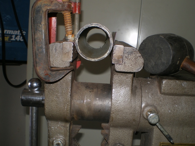

Hey thx Jeff. You might want to go .125" wall if you go DOM. BTW, that was one 10' piece of tube. I cut it a little close as I had 2.5" left over when finished! Next time I won't cut it as close as it took too much effort (you know, that double and triple checking your measurements (IMG:style_emoticons/default/stromberg.gif) (IMG:style_emoticons/default/wacko.gif) ). I could have used a little more cushion when constructing it. (IMG:style_emoticons/default/mad.gif)

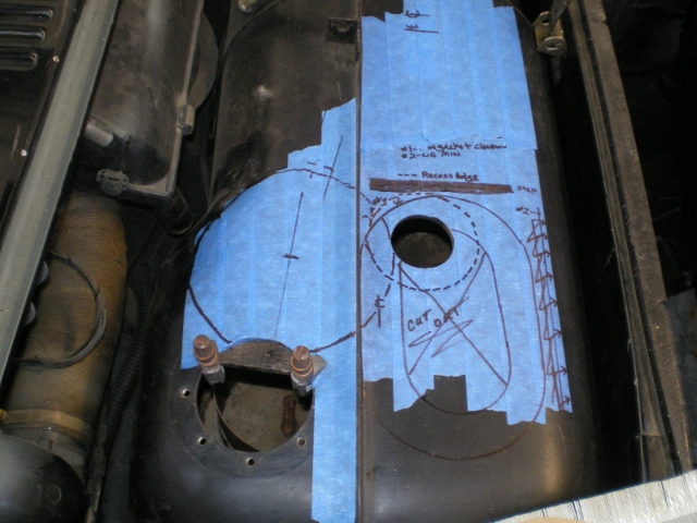

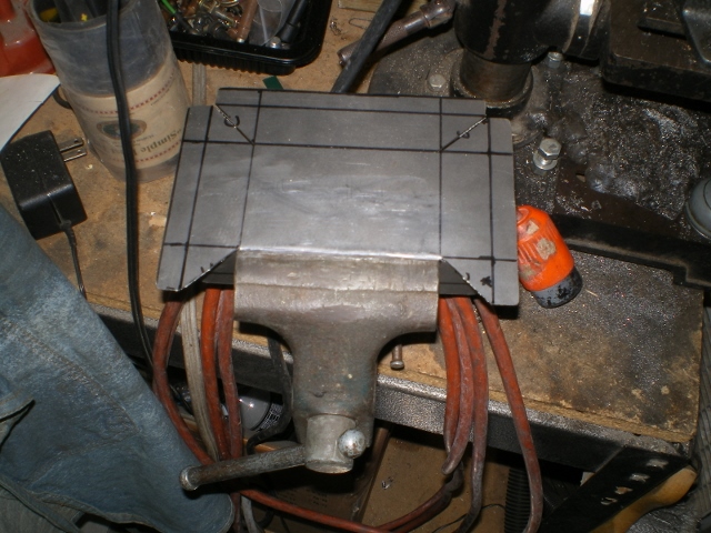

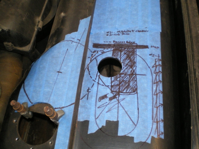

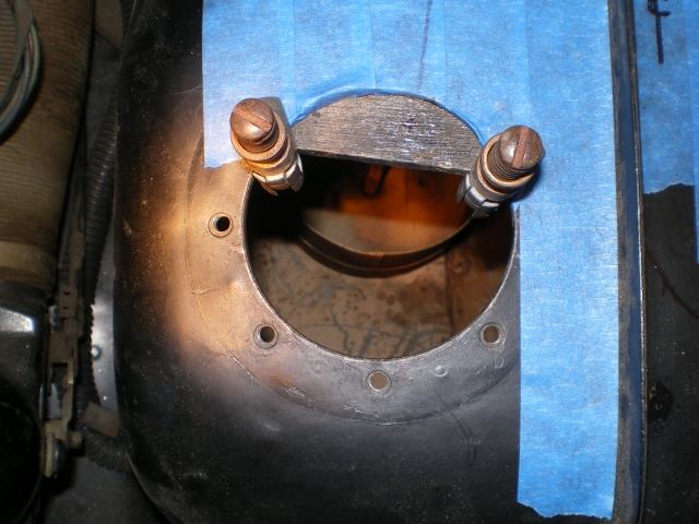

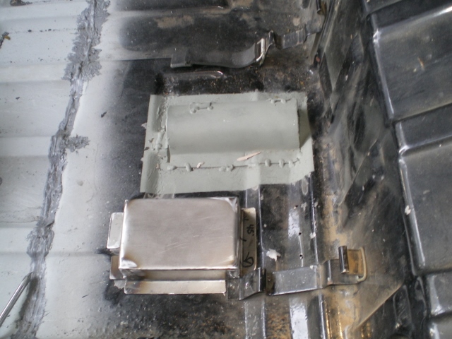

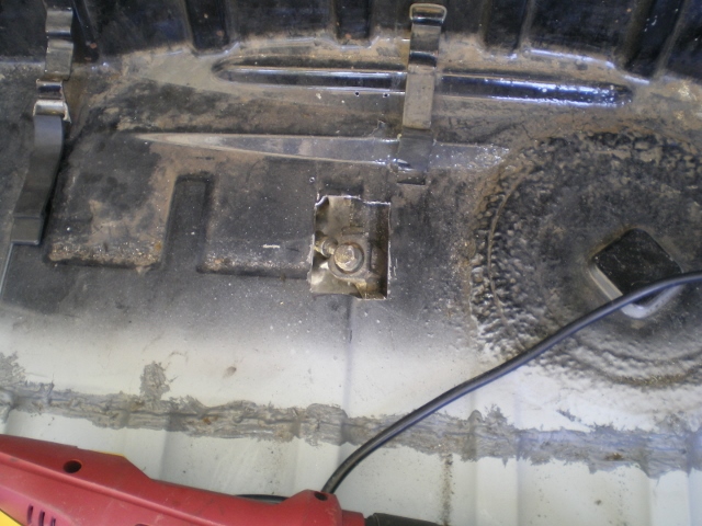

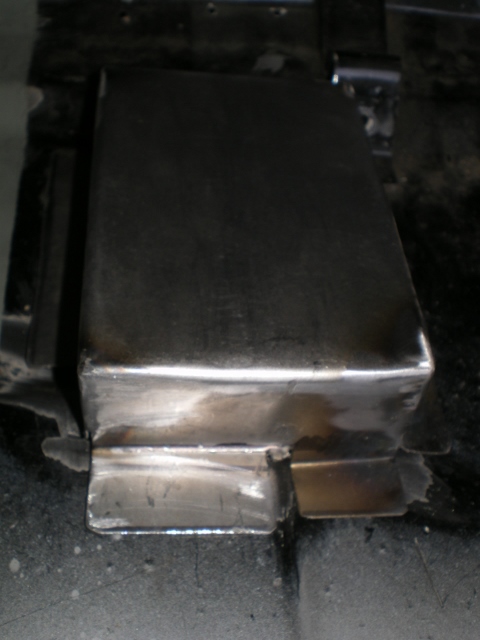

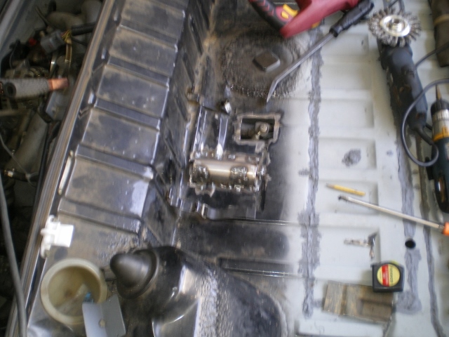

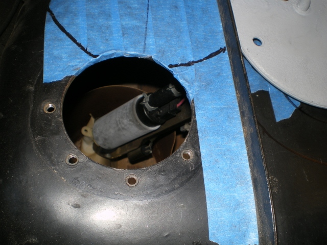

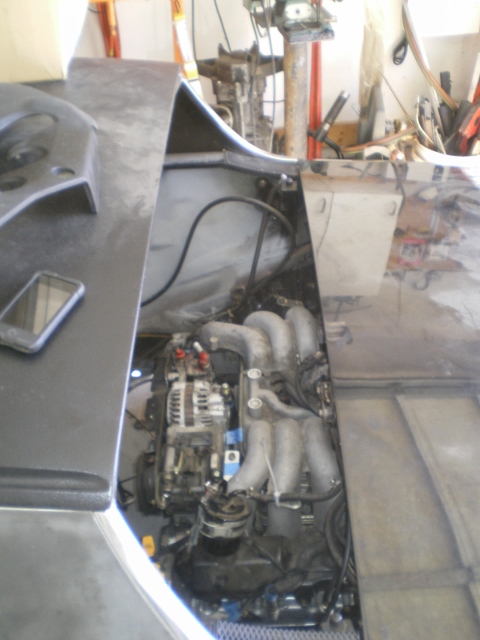

So I better post something up so I don't have to call myself out on "The Slackers Thread". I really don't have (IMG:style_emoticons/default/stromberg.gif) to show as I have been trudging thru this maelstrom known as a wiring harness. (IMG:style_emoticons/default/headbang.gif) There aren't enough joint's in the world to take the edge of this job. So I (IMG:style_emoticons/default/sheeplove.gif) with it until I begin to feel my sanity slipping away then move onto something trivial. Or should I say something less demanding? Simple suits me well. (IMG:style_emoticons/default/dry.gif)

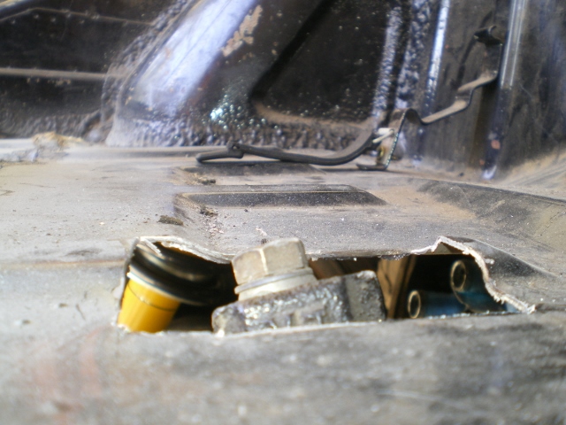

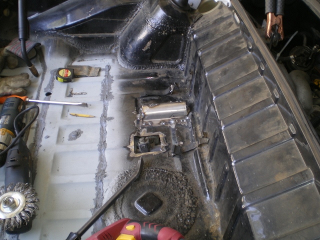

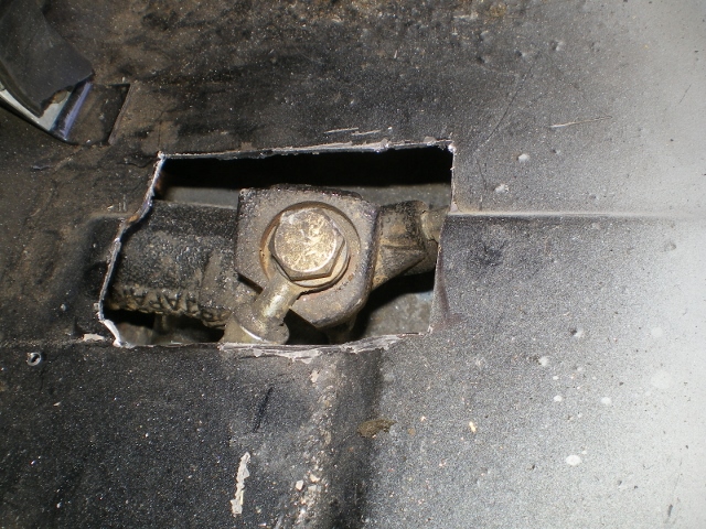

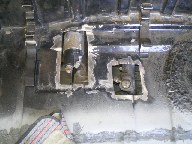

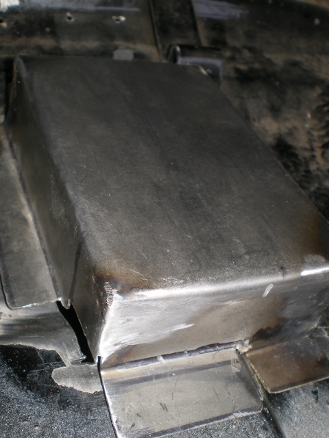

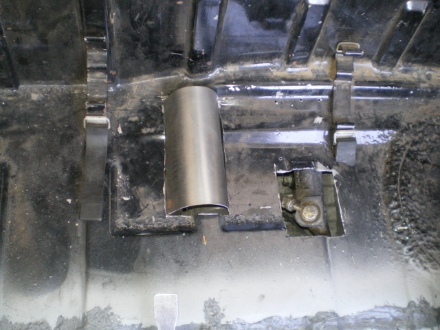

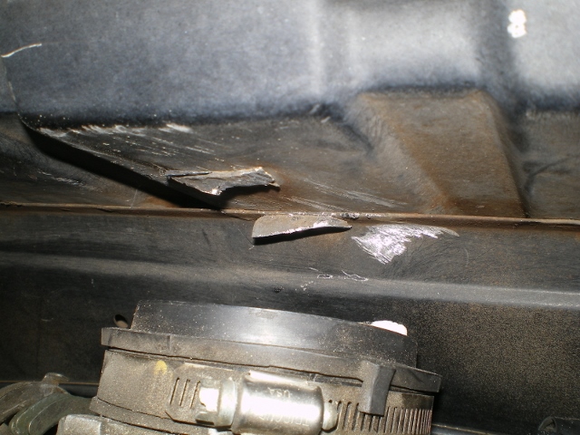

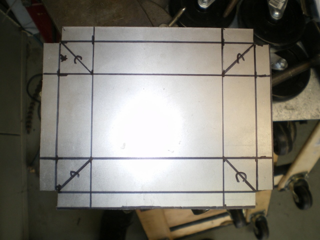

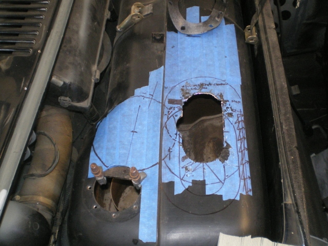

So as a diversion I'm falling back to something else. This is one of those items. The slave (is that politically correct?) cylinder needed another 5/8" clearance so....
(IMG:style_emoticons/default/sawzall-smiley.gif) (IMG:style_emoticons/default/smash.gif) (IMG:style_emoticons/default/welder.gif)
A flat panel would have made things a bit easier. This cover will need to be removeable to inspect/service the banjo fitting.

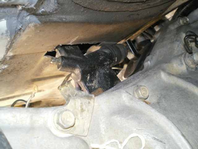

And as it turns out the starter needs a bit of room also. Even after I asked Bob which one would clear I still end up with a clearance issue. The good thing is if it takes a (IMG:style_emoticons/default/stromberg.gif) I won't have to worry about another one fitting if it happens in BFE. And before I get flamed for the elongated access remember that the engine/tranny combo is up and then slid forward, so it is necessary.
Rather than pontificate I'll just run some pic's past ya and you can use yer imagination or ask a question if ya have 'em.
This littl POS consumed 4 hr's of my day, after all was said and done. I couldn't be any slower if I tried. I had to go over it twice to fill any pin holes as I didn't want this piece rusting out soon.
After all that I ended up with this gap which I corrected with a tab welded in place. I'll show that in the next few days. It's primed, in place and already covered up as the trunk is converted back to the cat motel. Yea the little bastards sleep in the trunk but they do their business outside and whilst me neighbors have rodents we have none. (IMG:style_emoticons/default/confused24.gif)

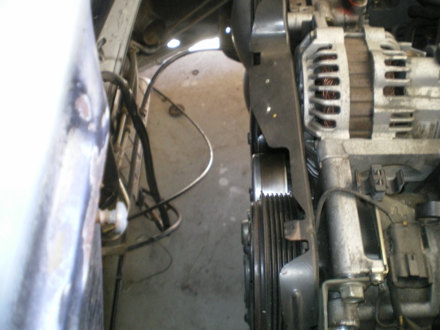

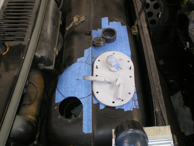

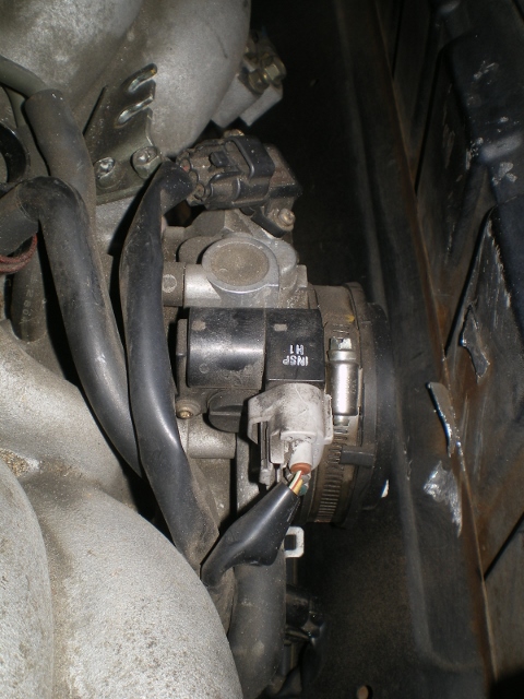

So after a few more stints in the wiring asylum I soon found another item that required my attention (just don't make me go back to wireworld. BTW, I stole this idea from Bob (bigkat). I had laid out what I thought to be the correct location for the pump assembly then a little voice said better double check that so I went thru the threads and noticed that Bob had his centered a bit more than mine. I had fixated upon installing it upon a flat surface and almost ruined a good tank. After looking at Bob's install it occurred to me that the criteria was where the pick up is located! DUH (IMG:style_emoticons/default/chair.gif) This is why you will see one drawing imposed upon another. The piece of wood held in place by the cleco side clamps is there to position the compass upon. By looking straight down the filler neck w/ a plumb bob I established the location of the reservoirs rim. By sticking a tape inside the reservoir I determined the diameter. Rather than bisecting a segment in the circle to locate center I just split the compass and worked off the edge of the circle. Once I felt OK about my location it was just a matter of figuring the offset in the pump itself and flipping the pickup sock 180'. I'll need to build a step onto the base of the cover to accommodate the offset on the tanks surface but that's another day.
and the $$$ shot

You're pretty good with that sheet metal fab, Kent (IMG:style_emoticons/default/thumb3d.gif)
When I mentioned an extra motor mount, I was thinking more along the lines of a front engine mount utilizing sort of rubber dampener to the firewall, rather than at the tranny (IMG:style_emoticons/default/idea.gif)
It just seems to me that a front mount will allow for a bit more aggressive driving (IMG:style_emoticons/default/confused24.gif)

Hi Kent,
As I was reworking my cradle or at this point I could just call it a X-bar, I spent a lot of time thinking about the load distribution.
The lower Suby mounts are just about the CG of my WRX/901 combo. So all the static load is on the lower mounts. Under power the motor wants to pivot about the drive shafts. That takes load off of the lower mounts and more downward force on the 901 ears. Downshift and you get the opposite, down on the motor and up on the transaxle mounts. The 901 ears may have very little static load but under hard driving may take a beating. Braking may also push the motor forward and down about the lower mounts. With all that said, if an upper transaxle mount was horizontal it should better control loads under the torque of the motor. Am I over thinking it? Missing something? (IMG:style_emoticons/default/confused24.gif) The way Subaru hung the motor or at least they way we 914 guys are doing it, just seems strange. Anyway, with the upper mount, I would be able to pull the transaxle without touching the motor. (IMG:style_emoticons/default/smile.gif)
