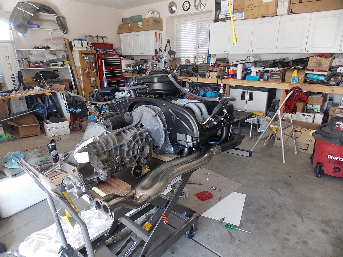

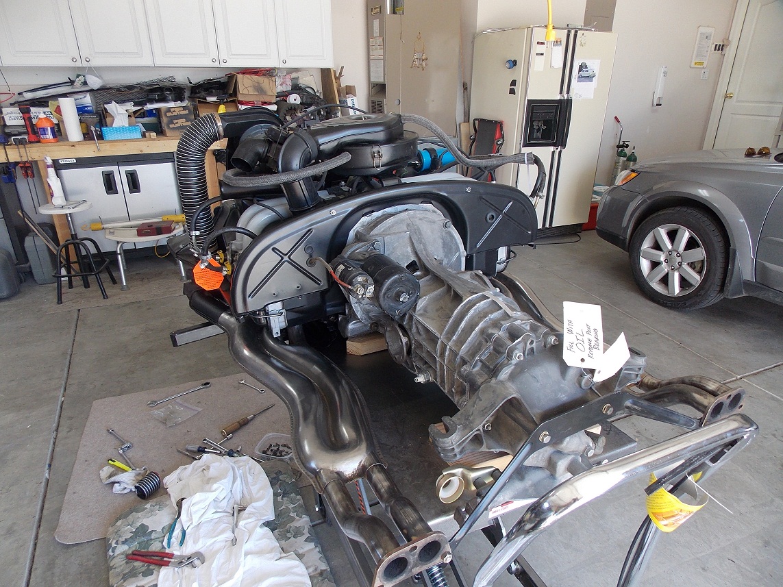

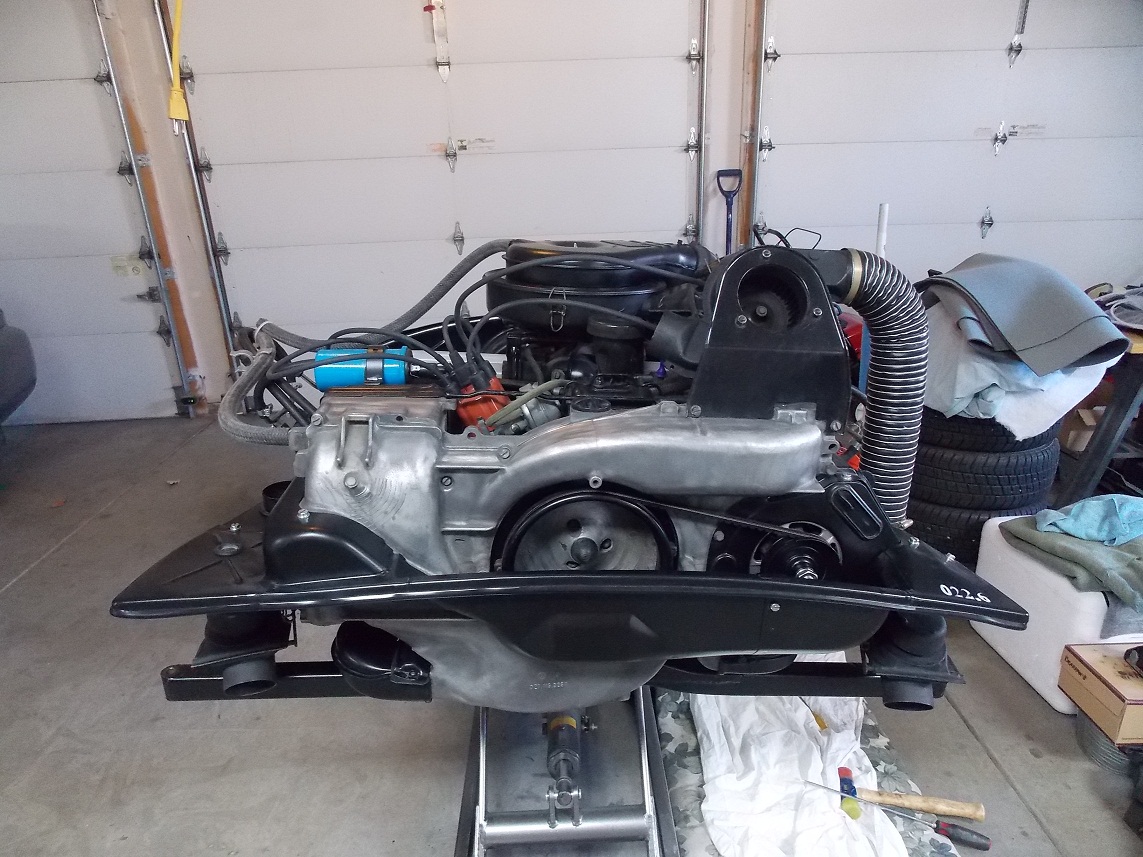

Since the car was still out, I worked on the motor a bit and decided to clean up the SS heat exchanges and install them. I have to find the correct heater tubes, or find some sort of 55mm to 60mm adapter to make the silicon ones work.

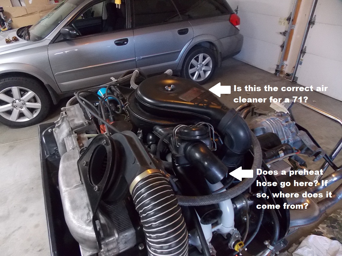

I was also wondering if I have the correct air cleaner for my car. It has what looks like a pre-heat tube on it. I don't know where the tube would hook to though.
The car is coming back tomorrow, and I should be able to get back to work on it next week.

Member No.: 15,027
QUOTE(rangrbob @ Mar 20 2015, 05:38 PM) *
I was also woundering if I have the correct air cleaner for my car. It has what looks like a pre-heat tube on it. I don't know where the tube would hook to though.
Well it appears I have a 72 air cleaner, and will have to find an earlier one.

My '71 does not have the pre heater tube and parts

QUOTE(mepstein @ Mar 22 2015, 09:03 AM) *
That's what I thought too. Although, while searching for 71 air cleaners, I'm finding that some have a pre-heat tube. I noticed that the 71 that dlee6204 just posted pictures of does not have one either. Looking at my engine number (W0023958), it looks to be a 1970. So, now I'm not sure if I have the wrong air cleaner or the wrong tins. (IMG:style_emoticons/default/confused24.gif)

Bob, check out the Originality thread:
http://www.914world.com/bbs2/index.php?showtopic=57169
posts 9, 10, 11 of Pat Garvey's engine bay may help..

QUOTE(turk22 @ Mar 22 2015, 05:42 PM) *
Thanks. I had seen Pats' pictures. That's were I found out the one if have must be for a 72, and I have it on backwards.

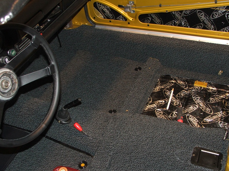

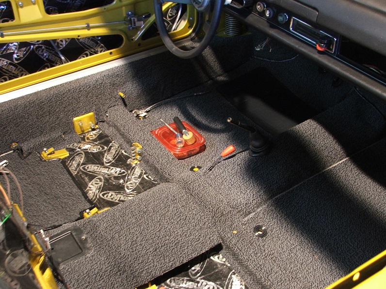

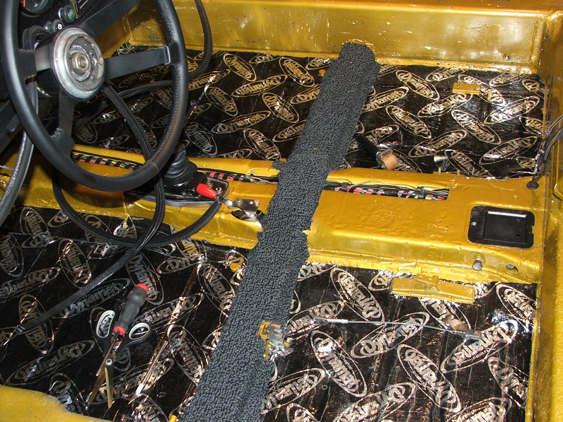

I got the car back a couple days ago, and the passenger side rear panel fit and door gaps are much better. (IMG:style_emoticons/default/smile.gif)
A couple weeks ago Mark from 914 Rubber sent me a passenger side carpet piece to replace the one missing the grommets, only to find out that I was originally sent the wrong carpet kit. I was sent the domestic loop kit and not the German one that was ordered. He quickly sent out the correct kit, and I worked on switching them out today. He's a great guy and provides superior customer service! However, I did have to do some tweaking to make it fit better in an early car.
Being a bit of a detail junky, I ordered an extra yard of the same carpet from an upholstery supplier to fully cover the rear half of the pan and tunnel. It's not a stock look I know, I just didn't like the look of the vinyl. I still have to cut the rears, and sew some binding to it to match the front. I may also, get some more to do the trunks.
