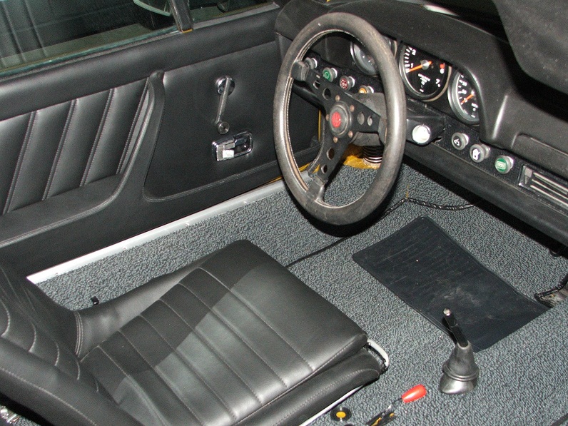

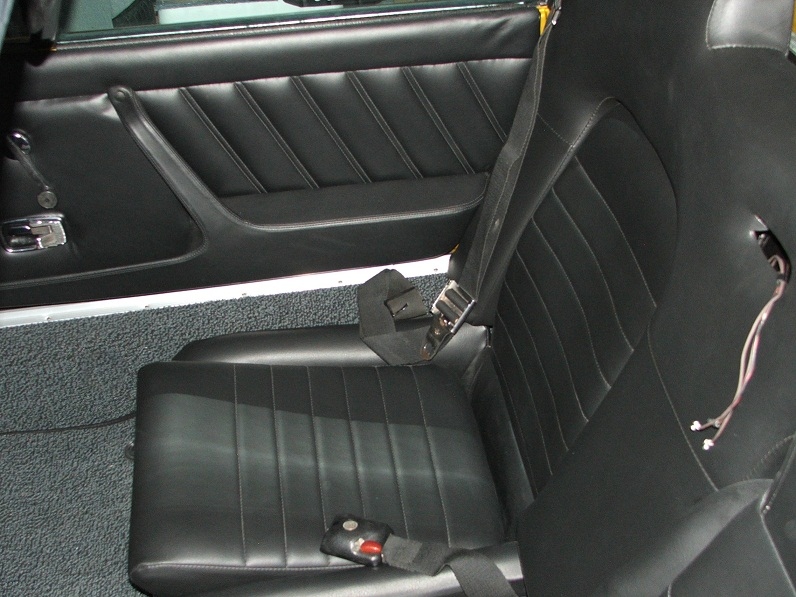

I messed with installing the back pad and seats today. They are not in for good yet. I still need to run wires for rear fog light, and finish gluing down the carpet. I also need to find a set of seatbelts that are in better condition.
The BWA Pordoi steering wheel is temporary while the stock one is out being wrapped.
The car is slowly getting there. (IMG:style_emoticons/default/smile.gif)

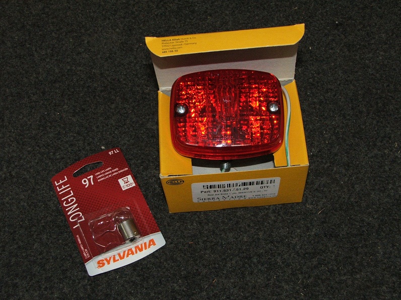

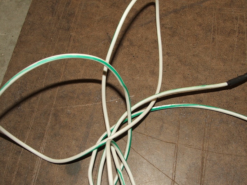

Today I focused on prepping to install a rear fog light.

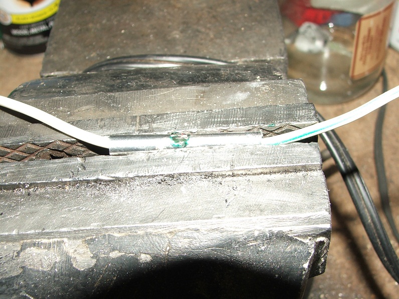

I made a little tool to mark a green line on some 16ga white primary wire. I used a small tube with a hole drilled in the side, and insterted a green Sharpie. It worked pretty well. You just need to have a helper pull the wire though the tube at a slow constant pace as not to get an uneven line.

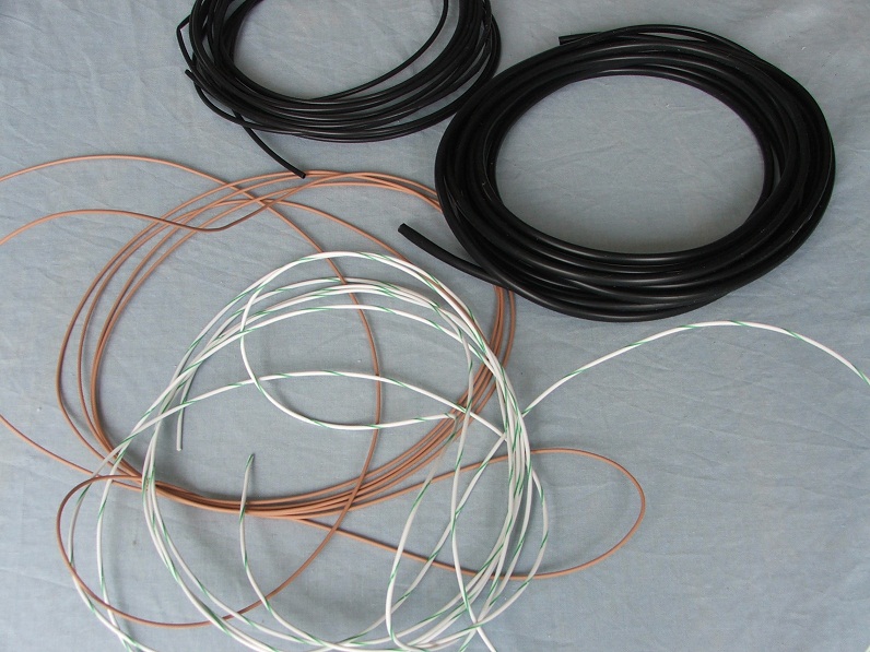

I need to find some PVC wire sleeving to complete the harness.

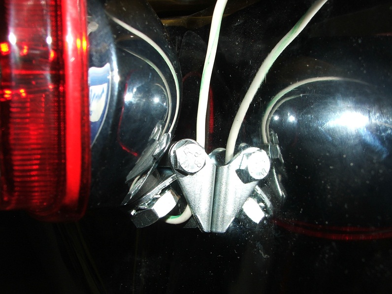

Curious what kind of bracket you're going to use to mount the rear fog.
I'll be doing a similar thing soon.

QUOTE(raynekat @ Apr 30 2015, 10:46 PM) *

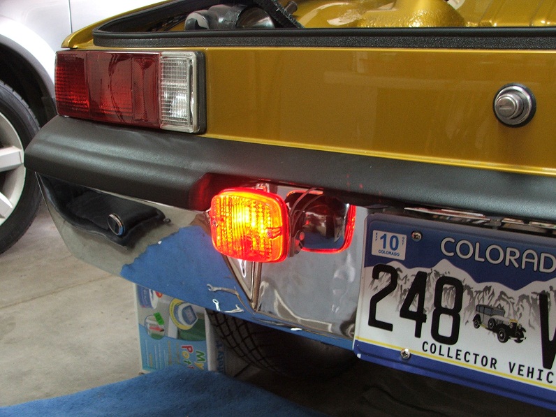

The lamp came with a little adjustable bracket. I just used it. It worked well enough.

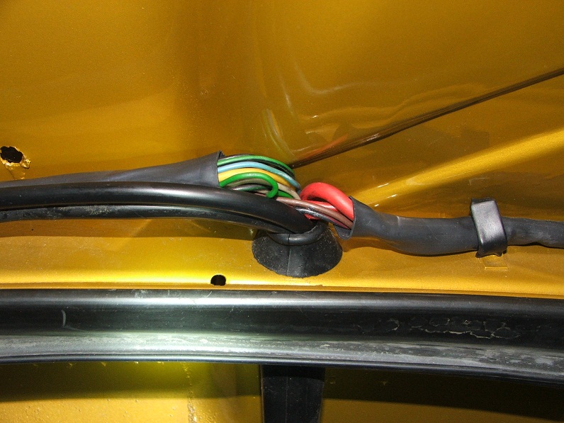

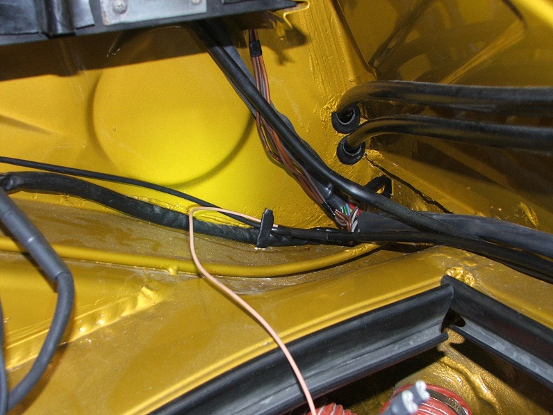

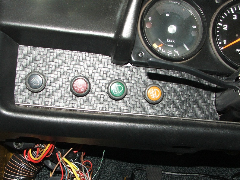

I also found a local source for the sheathing and picked up the correct wire since they had some in stock. I recreated the factory harness and ran it to the dash as I thought it should. Not much more room in the snorkel!

How does that mount work? Great light for fog safe driving. (IMG:style_emoticons/default/thumb3d.gif)

QUOTE(altitude411 @ May 1 2015, 11:07 PM) *

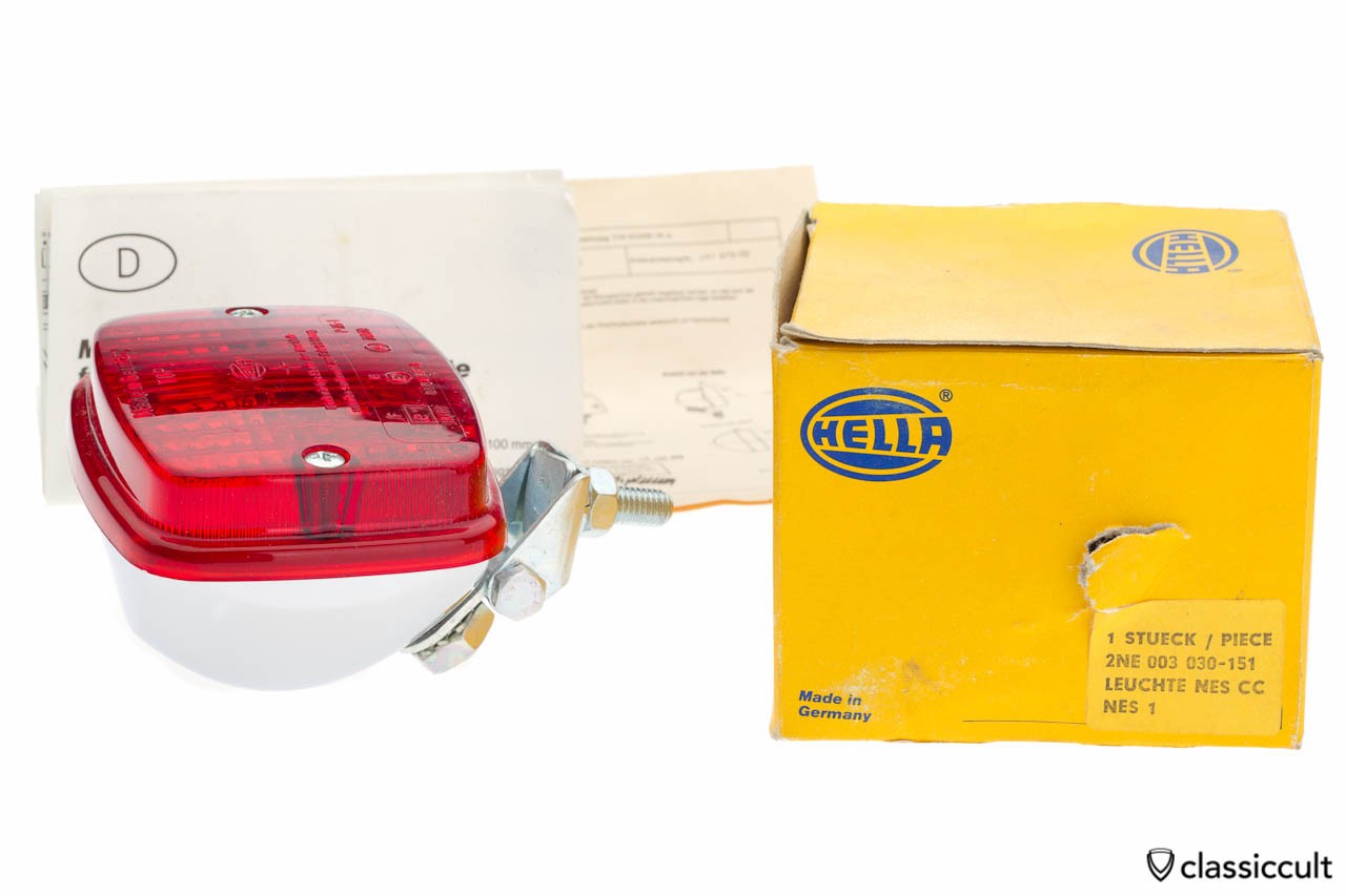

It is held on by a threaded stud with a square head to keep it from spinning in the bracket. The lamp attaches to a little adjustable tab that bolts to the bracket.
You can see it in the picture I found on the classicult web page.

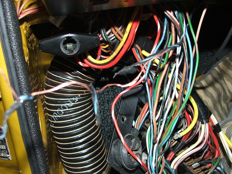

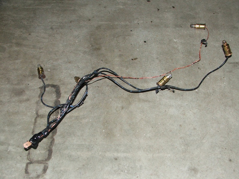

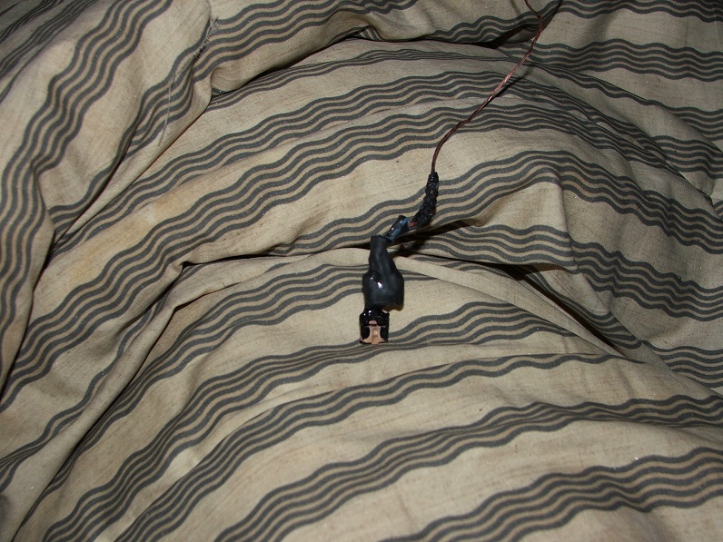

This car is going to be the death of me! The wiring harness started on fire today. (IMG:style_emoticons/default/headbang.gif)
Luckily I was able to pull the power soon enough before it got too far along. It looks like I just lost all of the blk/blu wires from the headlight switch running to the gauges.
Not sure what happened. I don't know if the dimmer switch is bad or it was due to the fact that I had the fog light relay disconnected. Luckily I do have another little harness that feeds the gauge bulbs. I just need to run a new feed wire from the switch to it.
