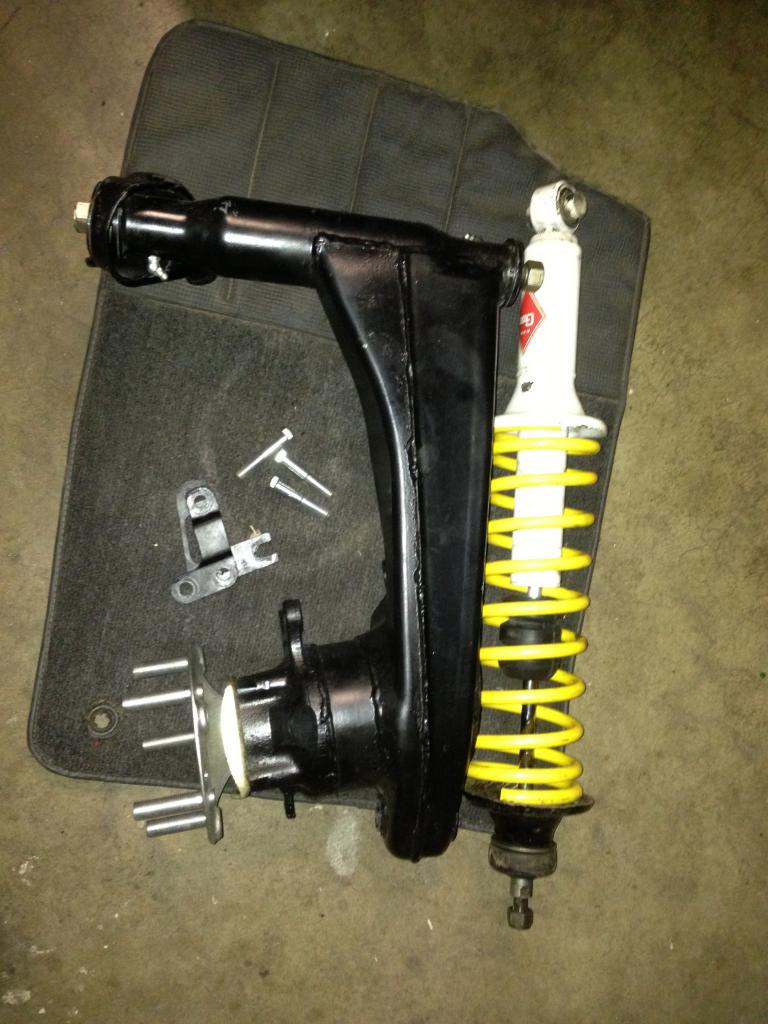

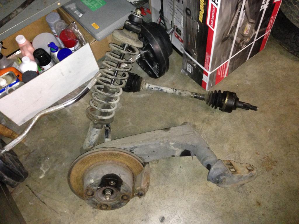

Just put another 4 hours in after i got home from class. Right now my bigest priority is getting the 5-lug suspension on this car and getting the 4-lug on the other so i can have them switch spots and have my new baby in the garage!

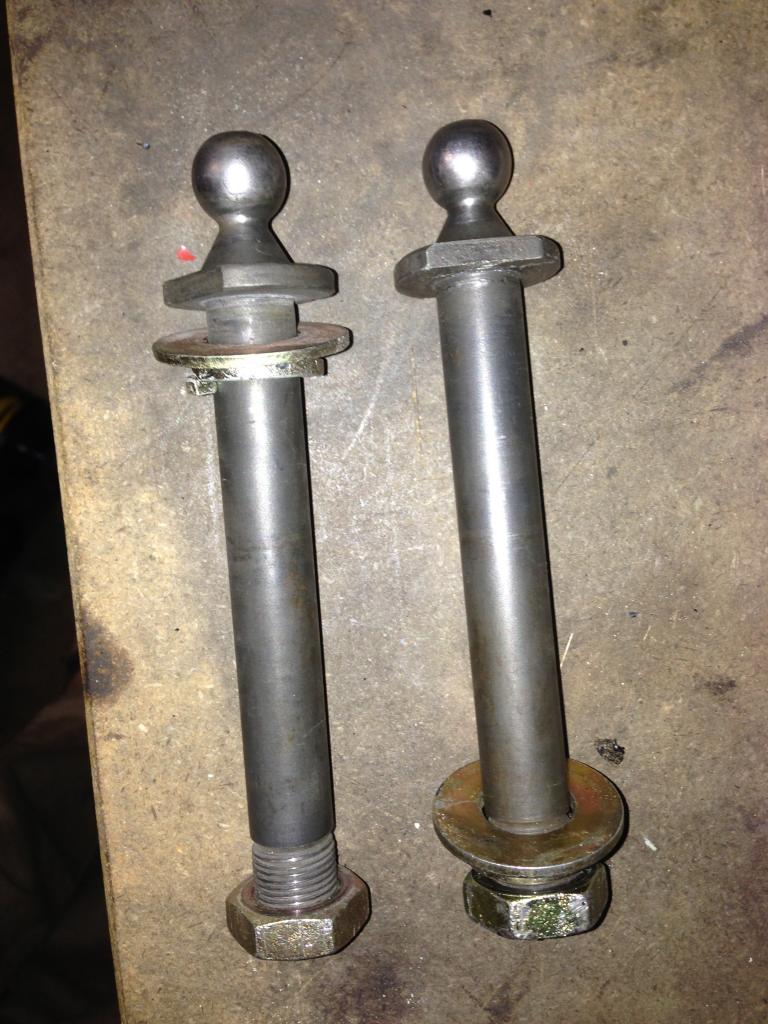

So i started by taking off the rear suspension on both cars. I am also switching out the shock bearing pins with the kind that has the ball on the end for a rear sway bar. Although i wont be installing the bar right away it will be easier to do it now rather than later.

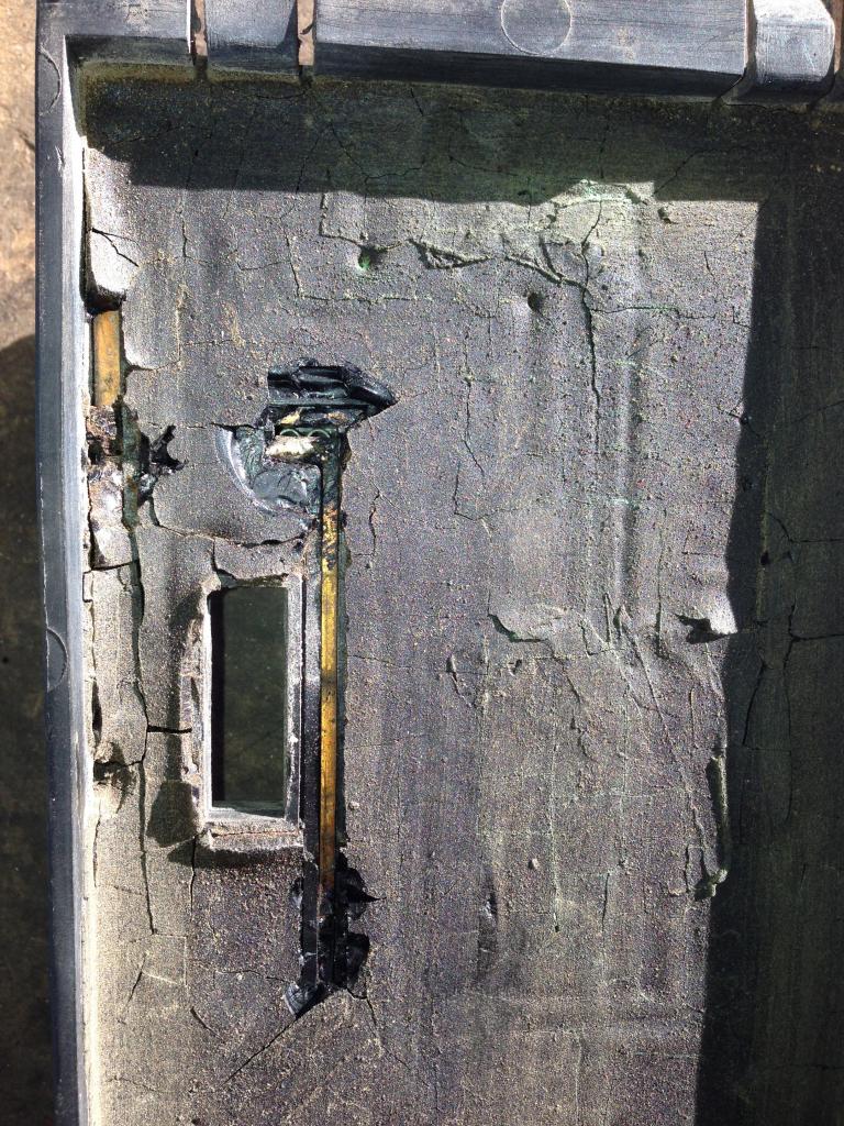

So before i started working on the suspension, i took out the relay board from my engine/parts car to clean up and examine. noticed one small problem on the backside of one of the regulator terminals. It pops out when you push the posts on the regulator side in.... hmm, should i epoxy over this void area to hold it in place and protect it from the elements???

Carefully dig out all that old potting material, VOM all the connections and re-pot it.

QUOTE(euro911 @ Jan 14 2013, 09:43 PM) *
Nice find (IMG:style_emoticons/default/smile.gif)
VOM stands for...????
Where can i get the re-potting material, whats it called?
Thanks Mark

QUOTE(dfelz @ Jan 14 2013, 09:56 PM) *
Thanks Mark
I think the factory used sun-baked adobe clay, spray-painted black. (IMG:style_emoticons/default/biggrin.gif) They all seem to crack like that. Maybe you could use 2-part epoxy to re-seal. Mark??

Clean out the old insulating material, and pour over liquid electrical tape. It's acts similarly as the old stuff. Liquid Elec. tape

Volt Ohm Meter Link
... or what they looked like when I first started using them (IMG:style_emoticons/default/laugh.gif)
Yeah, liquid electrical tape, or Plasti Dip will do the trick.

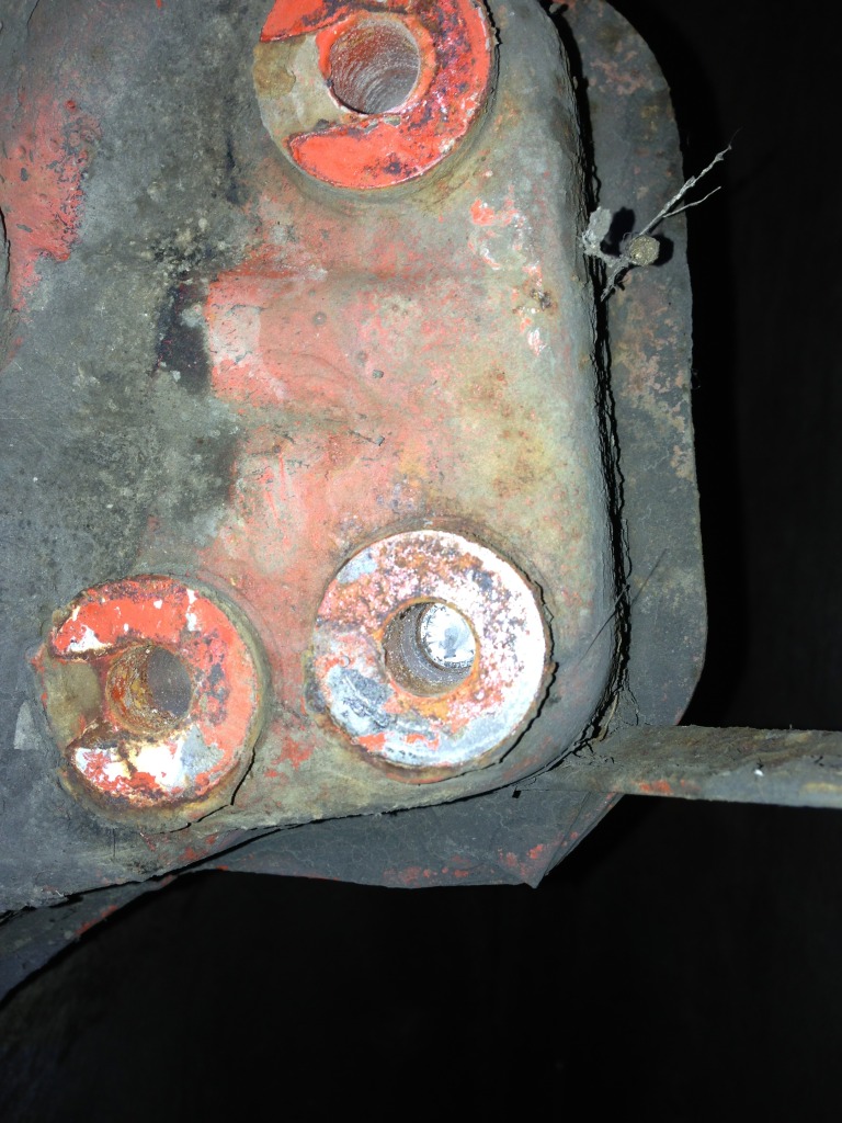

HELP
Was taking off the trailing arm and one of the bolts sheared off inside the suspension console!! What do i do!?! (IMG:style_emoticons/default/headbang.gif) (IMG:style_emoticons/default/headbang.gif)
anything besides drilling it out and ruining the threads????
