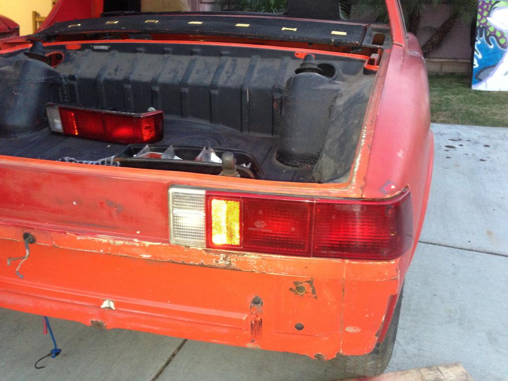

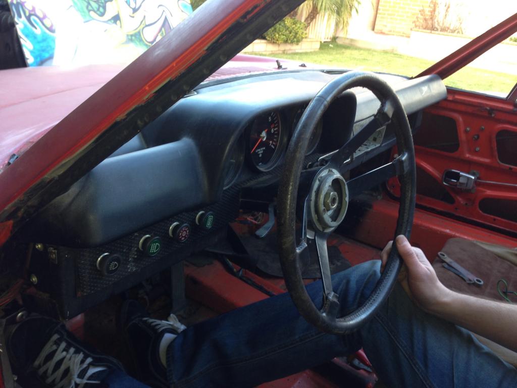

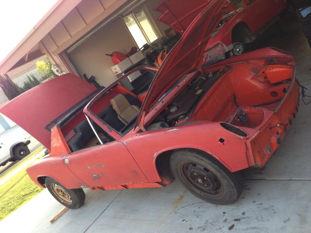

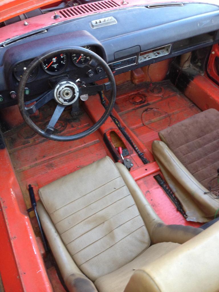

So today I bought a new shell for my project build, and I am extremely happy with my purchase! The body is in wonderful condition, perfectly straight, clean title, very minimal rust (and the rust it does have can be easily fixed without having to purchase RD pieces), and most importantly it was the right price (IMG:style_emoticons/default/first.gif)
Looks better in person but here are some pics.
(IMG:http://www.914world.com/bbs2/uploads_offsite/i1293.photobucket.com-14538-1358146784.1.jpg)
(IMG:http://www.914world.com/bbs2/uploads_offsite/i1293.photobucket.com-14538-1358146784.2.jpg)
(IMG:http://www.914world.com/bbs2/uploads_offsite/i1293.photobucket.com-14538-1358146784.3.jpg)
(IMG:http://www.914world.com/bbs2/uploads_offsite/i1293.photobucket.com-14538-1358146785.4.jpg)

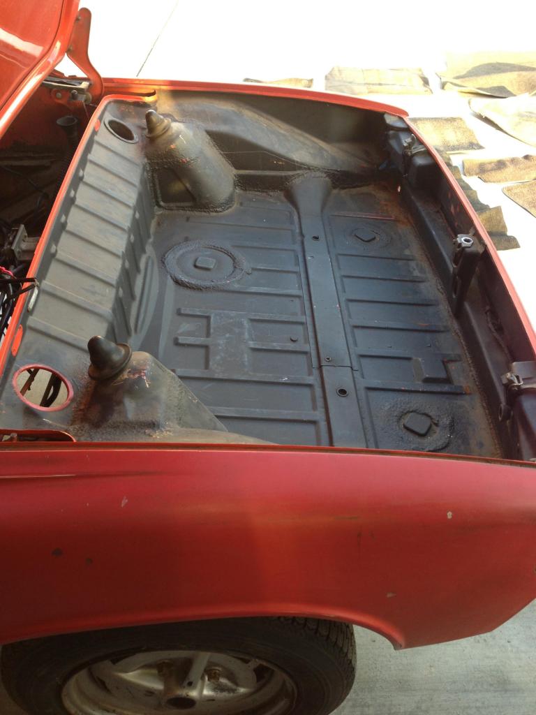

Already swapped on the tail lights from my 72 parts car (the one in the garage)
(IMG:http://www.914world.com/bbs2/uploads_offsite/i1293.photobucket.com-14538-1358146785.5.jpg)
Car has no front or rear windshield or engine/trans, but thats what parts cars are for. The car does have all the wiring in tact and non-molested, yay. So i have all of the parts needed to put this guy on the road plus lots of extras that will be added at a later point (one piece front fiberglass flared clip, rear 7" FG flairs, FG 911 dash with 5 gage pod..etc)
