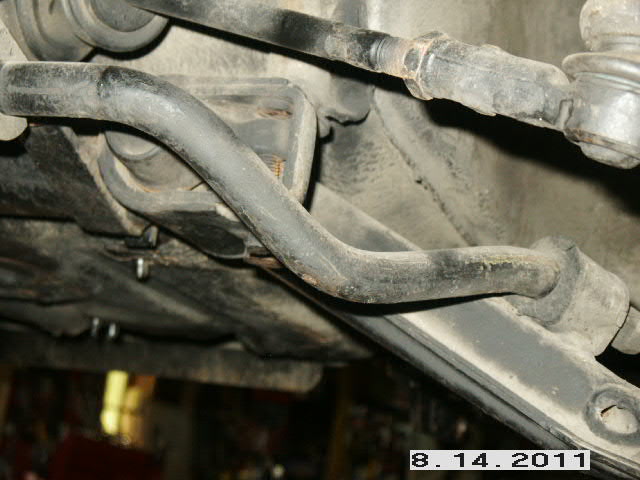

i did this about 15 yrs ago
- same reason - oem bar was cracking the body & i did not think it was a good thing going scca racing that way
bought a complete 911 cross member & lower arms - my sixer already had 911 Bilsteins on it so it was an easy swap
you could fabricate these on your oem arms by getting the parts online from Speedway Motors in Nebraska
here's a picture of the 911 bar, 911 lower arms with tabs - you also can just make out the attaching bracket location at upper left
i'll look for another picture better showing the attaching points to body & post later

thanks Larry. I contacted bruce earlier today about a few things, one being if he had these brackets, and he does, so I am set on that end, going to pick them up next weekend, along with some other things. So nice having bruce local!
Another question i have though, how is the bar retained on the ends. On my bar there are two clearance holes (dont think they were threaded). I realize because of the geometry it would be difficult for the bar to just "slip" out but those holes have to be for some thing right? I can take a picture if need be.

(IMG:style_emoticons/default/agree.gif) I'd love to see details on the original sway bar cracks that developed. Can you snap some pics?
