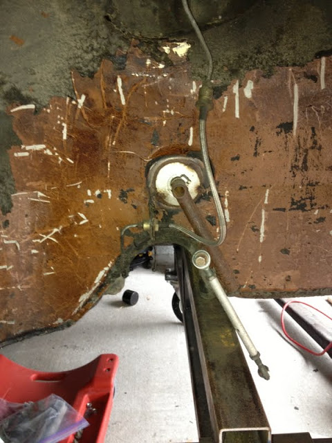

Im just looking for a reasonably cheap upgrade to my current sway bar. see below... I mean, this was a good effort by the PO, but huh.gif blink.gif
IPB Image
From the pictures I can see in the other threads I do not think I need the 911 cross member.
It wouldn't make a difference to me if I used 911 t-bars, but I really don't want to change my struts. I've already got a really nice set of 320i calipers from PMB and a good set of slotted and cryo'ed non-vented rotors that are not going to work if I change struts. Do you know if I can keep the '71 struts with the 911 A-arms?
This is going to be a light weight street car. I really don't want to drop $400-$600 on a heavy duty adjustable sway bar for this car. I figured I could go with the later 911 style bar for half (or less) of that cost. I won't have to weld in the reenforcement plates and it may give me a little more room under the tank for a possible fuel pump relocation.
