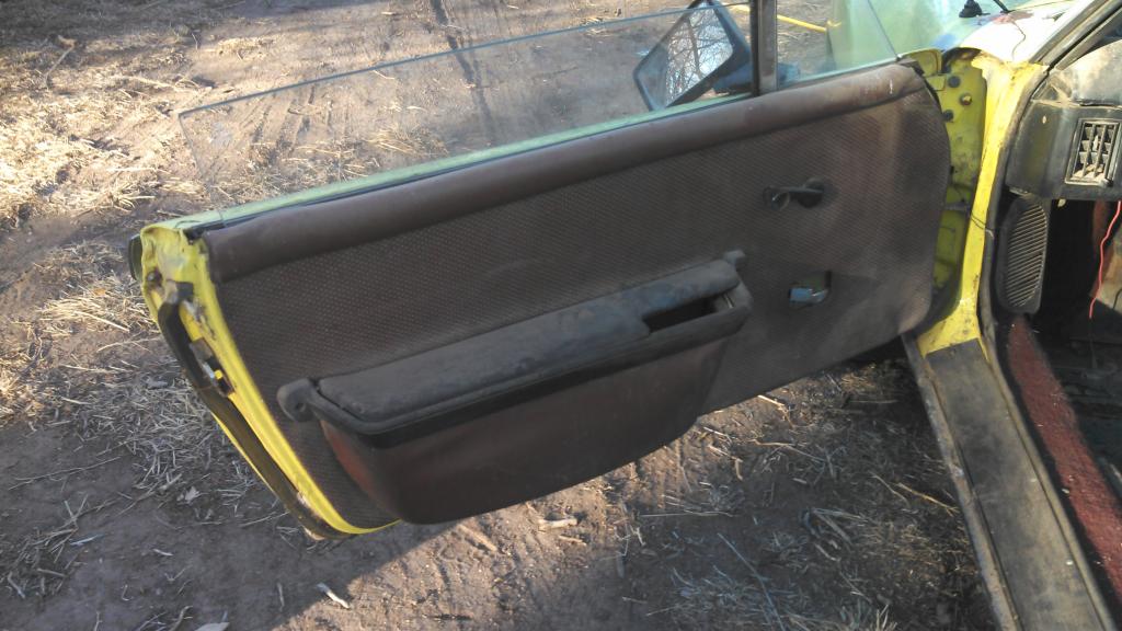

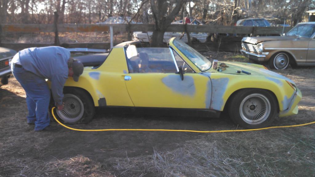

Hello everyone! my name is Aaron and im from central Kansas. i recently traded an Audi of mine for a few other cars that an older gentleman had sitting around his property. among those are a 80 Datsun 280ZX, 80 450SL, 92 Subaru SVX, an 80 el-camino, and a poor beloved 74 914 with widebody fenders that had been sitting in the weeds for nearly a decade (IMG:style_emoticons/default/sad.gif) ... it just amazes me that someone can purchase these cars only to have it sit in the weather. i have decided to take this little jem on as a project car, and sell the rest.
(IMG:http://www.914world.com/bbs2/uploads_offsite/i1102.photobucket.com-15376-1358358413.1.jpg)
(IMG:http://www.914world.com/bbs2/uploads_offsite/i1102.photobucket.com-15376-1358358414.2.jpg)

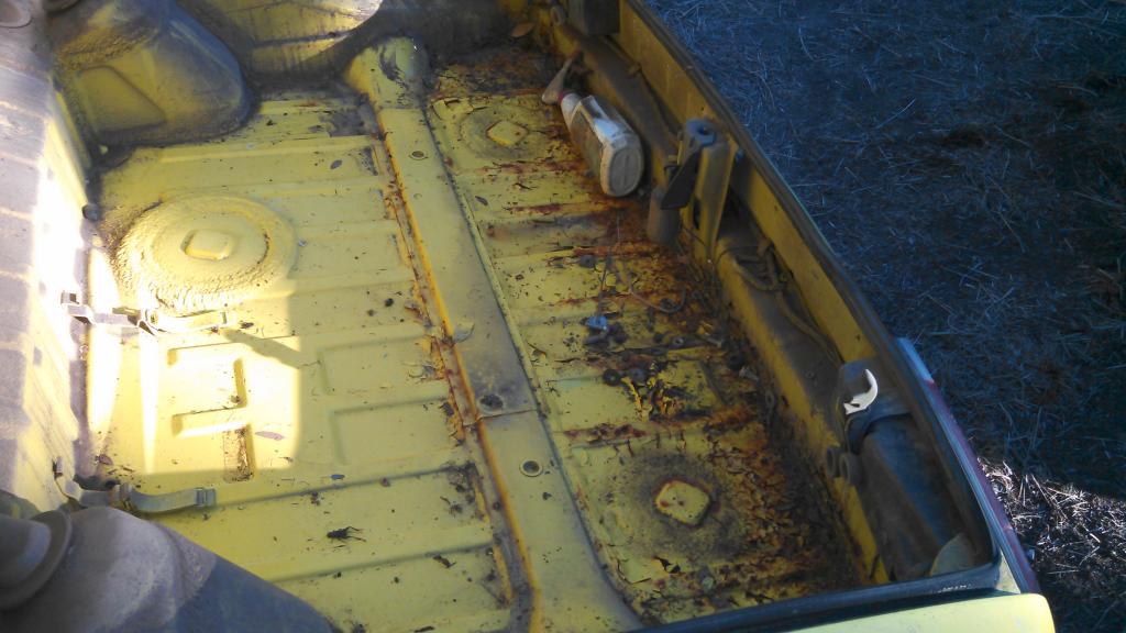

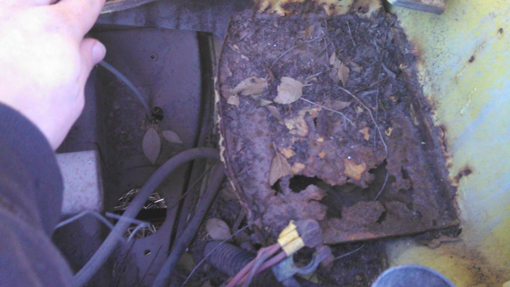

the interior is (use to be) burgundy, a color i dont think ive seen in a 914. after a brief look-over the car, it seems fairly rustless for being outside so long, however the floor board near the peddles has a couple holes in it, the interior needs nearly 100% replacing (gauges, lower dash, steering wheel seem fine) the engine is siezed but the clutch still engages and disengages the gearbox. no telling how bad the fuel tank or suspension bushings are just yet. i have yet to pick up the cars.
so here are a couple of questions:
1. my biggest concern is the floorboard - is there a replacement piece i can buy, or just go at it with sheetmetal? id like to keep it looking as original as possible (i think an engman kit would be nice aswell)
2. how can you tell the difference between a 1.7, 1.8 or 2.0?
3. is it worth the work?? (my vote is hell yes)
thanks for reading guys, thoughts, comments and concerns are welcome

Welcome Aaron! Great find. You can get floor pans at:
Restoration Design
You will probably need more stuff, and they have pretty much every panel available outside of NOS.
If the engine is stock it will be a 1.8 or 2.0 for the year 1974... if it still has fuel injection post a pic of it from the top and we can tell you which one it is...
As far as it being "worth the work", the amount of rust is usually the deciding factor. Post pics of the underside and engine bay. Are those flares fiberglass or metal?
FYI lots of people (like me) are transplanting SVX engines into 914s. You can offer it for sale here if you don't want it. Does the SVX run BTW?

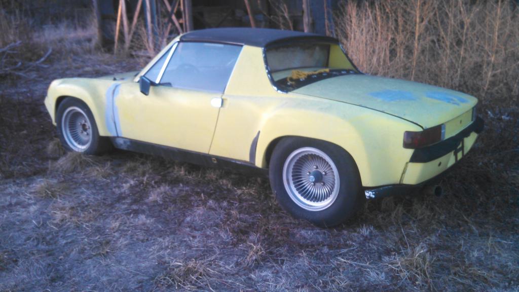

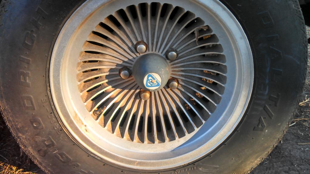

Those rims are awesome. Never seen 5 lug "fans" before . The exhaust appears to be a Bursch Sport. VERY loud but cool.
Bottom line is we need more pics...lots more...

Your statement, "it seems fairly rustless for being outside so long, however the floor board near the peddles has a couple holes in it" scares me the most. Here's hoping it's not indicative of more serious issues elsewhere. (IMG:style_emoticons/default/unsure.gif)
Those flares look extra large to me. I wonder if they're fiberglass? 5-lug conversion done on it too. Considering the interior, you can make it "look original" there, but elsewhere it would be cost-prohibitive IMO unless you start with a better candidate.
In the end, only you can answer the question, "is it worth it?" I hope you find that the rust isn't terrible and you say "yes!" to restoring it to a fun driver. The more of these rescued the better, and I like idea of having a blank slate with a car that's already "non-original" ... as in wide-body, 5-lug wheels, perhaps redone interior ... make it your own! (IMG:style_emoticons/default/shades.gif)

QUOTE(Madswede @ Jan 16 2013, 01:05 PM) *
pretty sure those are the extra wide F/G Flares (11 inch wheels will fit)

they are indeed fiberglass, however the lower strip (black) needs to be molded to fit the panels.
as for the rust.. its only rained about twice in kansas in the past 3 years, and i have no fear of doing some panel work. it will be a first for me, but i look forward to it.
HA i didnt notice the 5 lug swap.. i guess that means at some point someone knew what they were doing. ebay has new carpets and even seat sets for what i consider reasonable

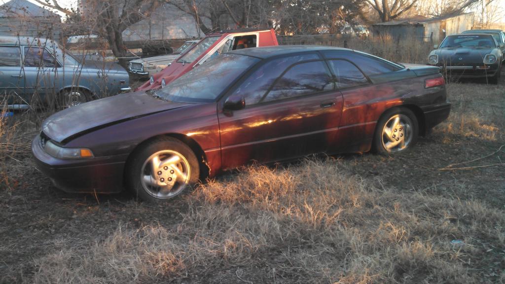

the SVX runs, but smokes (burning oil (valve guides??)) and the transmission is out, so its mainly good for parts. i will sell it for REALLY cheap.
(IMG:http://www.914world.com/bbs2/uploads_offsite/i1102.photobucket.com-15376-1358361564.1.jpg)
thanks for the fast replies! it gives me hope that i can take on this project. btw im no noob to porsche, ive had a couple 944's, my daily driver is an Audi A6 and my toy is a 79 Alfa romeo Alfetta sport sedan.

what is the crazy red car in the pic, behind the SVX

Looks like an old electric car from the '70's...
The MOST valuable pieces of the SVX are the drive train, so I would probably scrap that one...leather interior is somewhat desirable. svxworldforums.com if you want to post it there or part it out.

the red door stop is a CitiCar electric vehicle. 3 or 4 hp and 50+ miles per charge. (IMG:style_emoticons/default/aktion035.gif)
agreed. the SVX is a parter

Cool vintage Western Turbines! I wonder if the car has wheel adaptors or a true 5 lug conversion... (IMG:style_emoticons/default/idea.gif) (IMG:style_emoticons/default/icon_bump.gif) (IMG:style_emoticons/default/welcome.png)

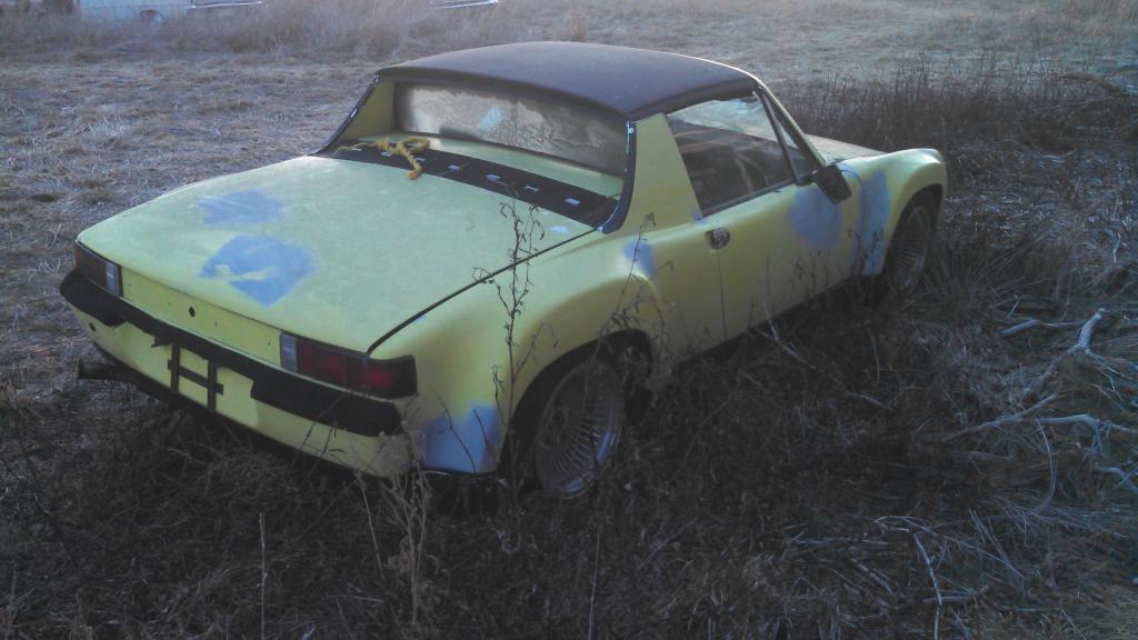

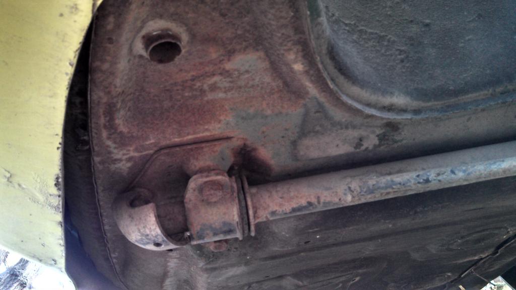

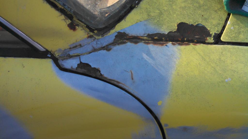

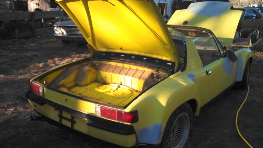

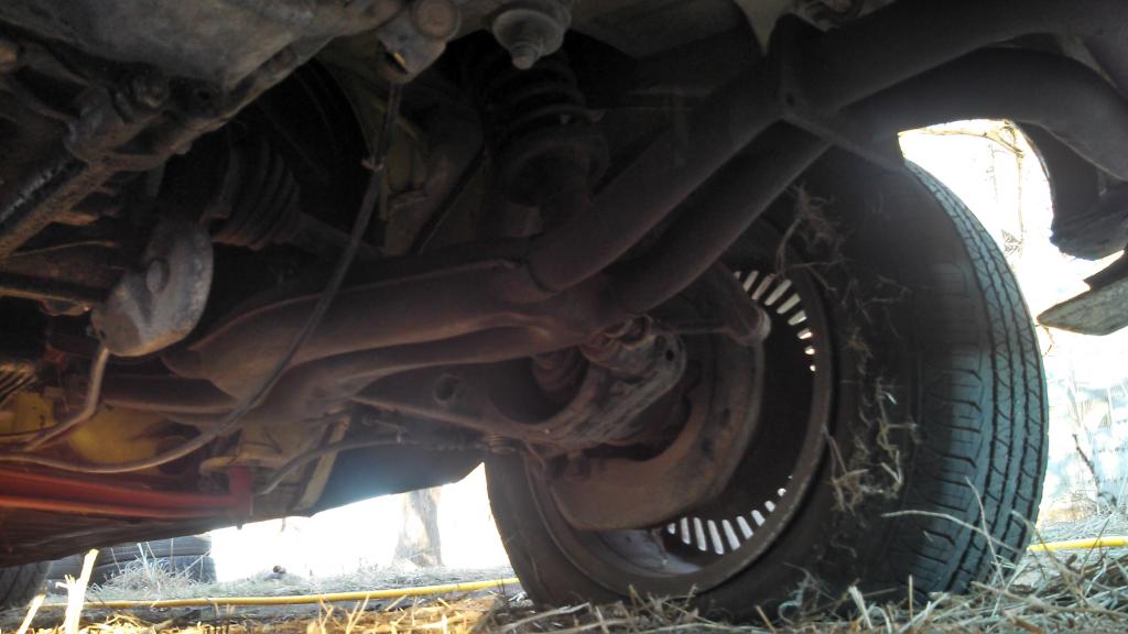

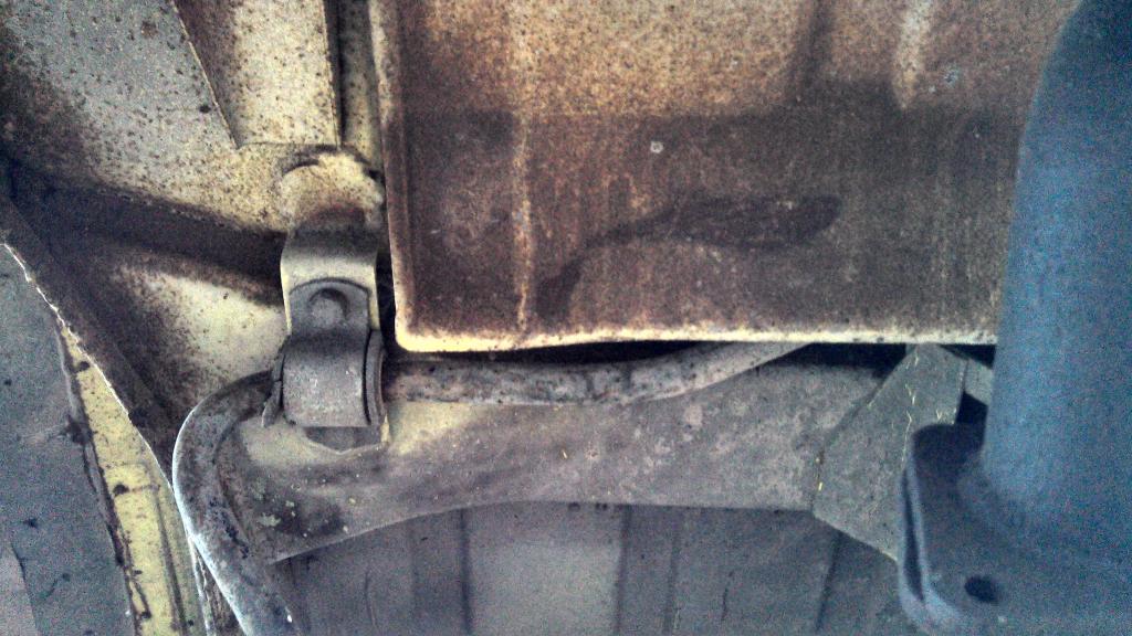

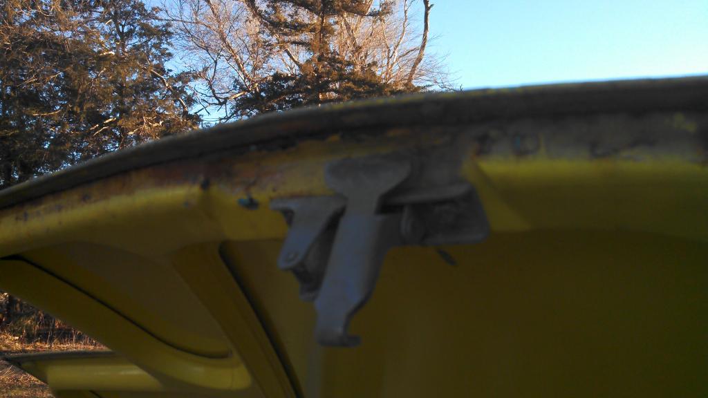

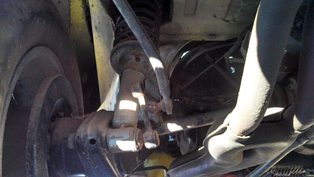

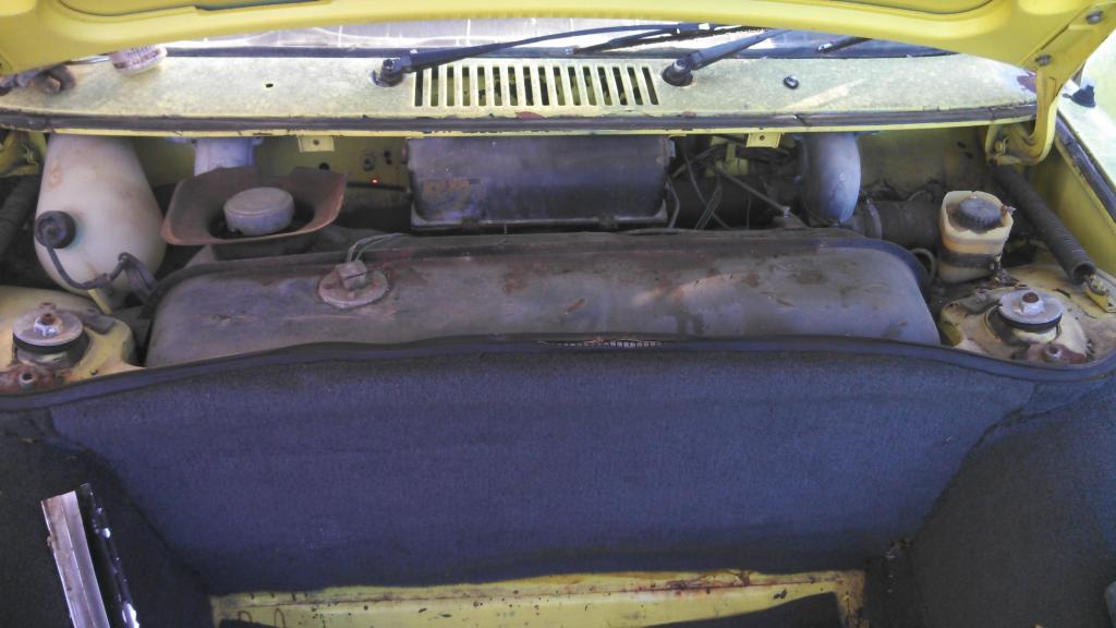

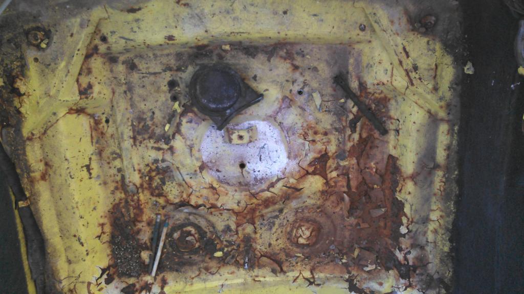

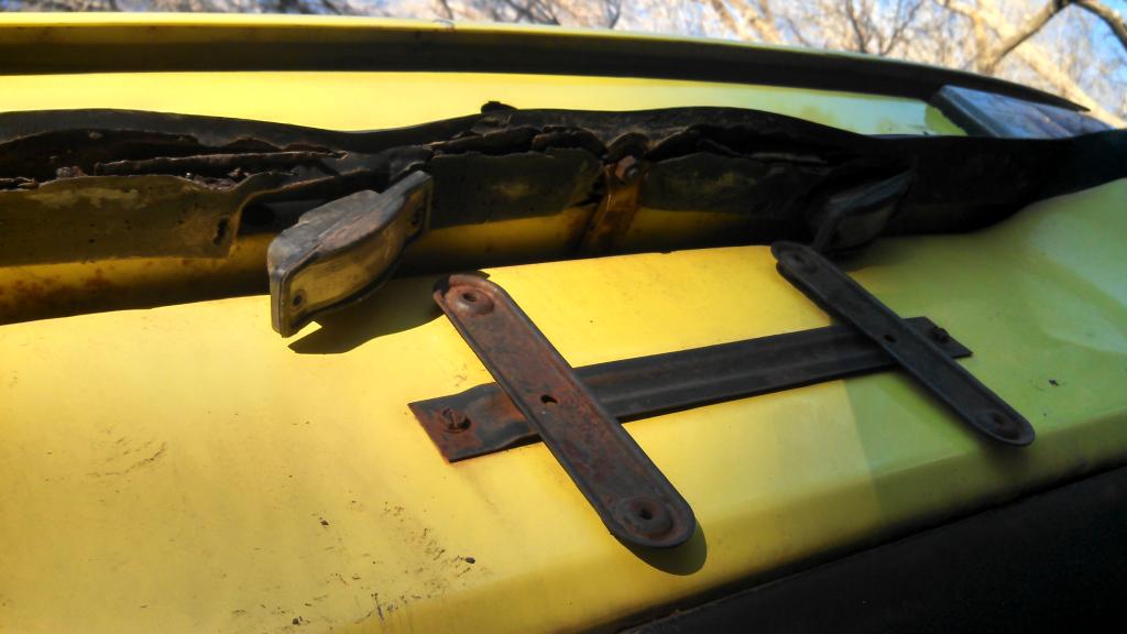

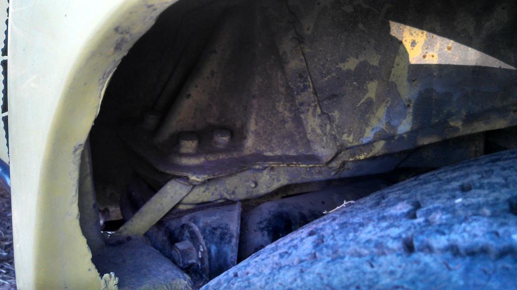

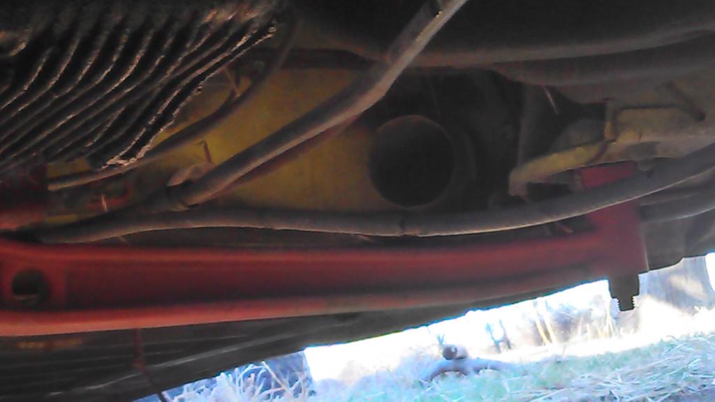

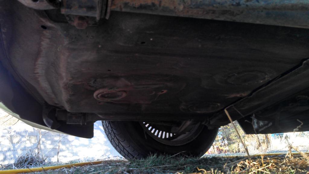

so i got the opportunity to take a "few" pictures of the major rust areas.. i cant believe how clean this car is!
(IMG:http://www.914world.com/bbs2/uploads_offsite/i1102.photobucket.com-15376-1358656057.1.jpg)
in front of the left rear tire... damn thats clean! (well.. not rusty)

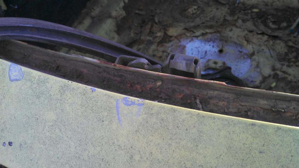

front latch sill area

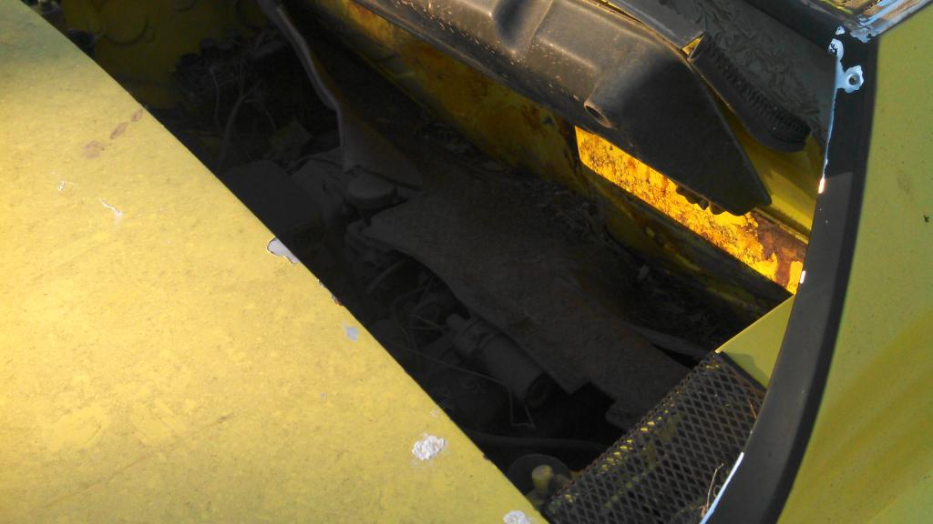

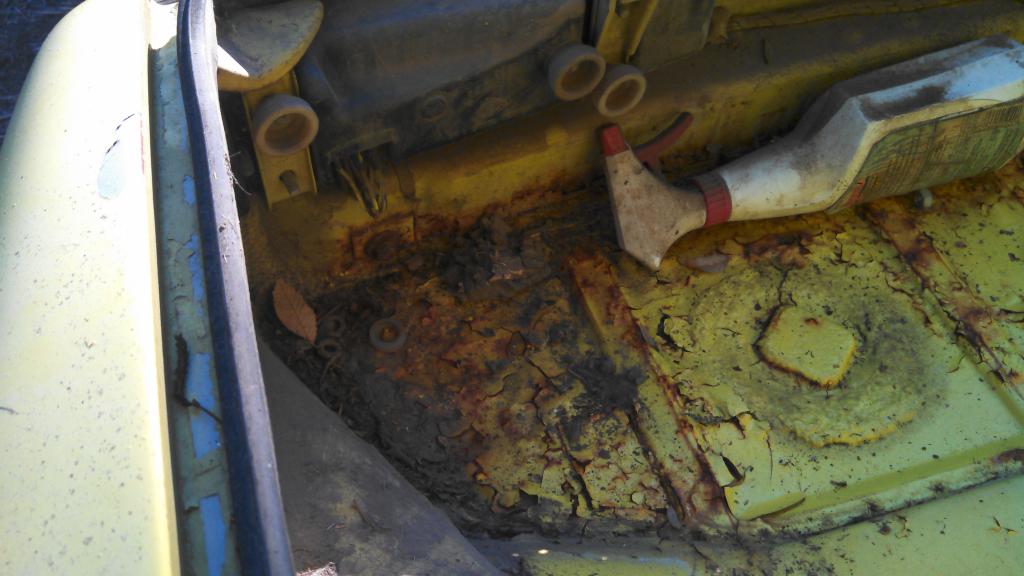

front trunk pan

My guess is a Chevy bolt pattern with wheel adapters...

those aren't the rust area's
you need to pull the rocker covers.
I'm betting anything that the jack points are completely gone from the looks of it...
those are 1.7 heat exchangers so most likely thats what your motor is.
weird that its got a real sway if its a 72 though...... could of been added. although the brackets look like they could be factory. What year is it according to the vin?
that rear valance is really trick.... nicely flared.
