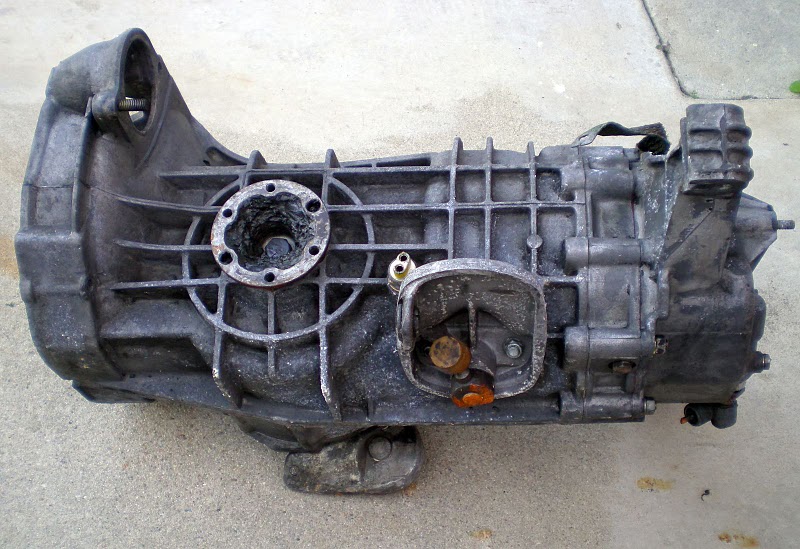

turdo
broken trans mount..
is this a "side shift" transmission?? ive seen the term, but not sure if its special.

billh1963
I don't want to be a party pooper but that car is rusty as hell. Look at the thread on my car that Scotty B just finished up. I'm not saying your car can't be fixed up; however, you need to go into this with realistic expectations.
billh1963
QUOTE(turdo @ Jan 22 2013, 01:38 PM) *
side shifters are on all '73 and newer cars. Nothing special.
Look on the web for pictures. Basically, a side shifter has the shift rod coming into the shift console on the side like this:
turdo
sorry. shift linkage

BTW: You have a side shifter
