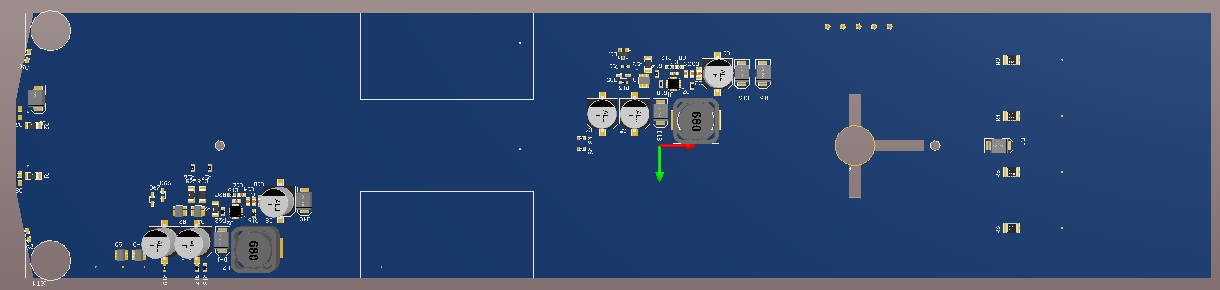

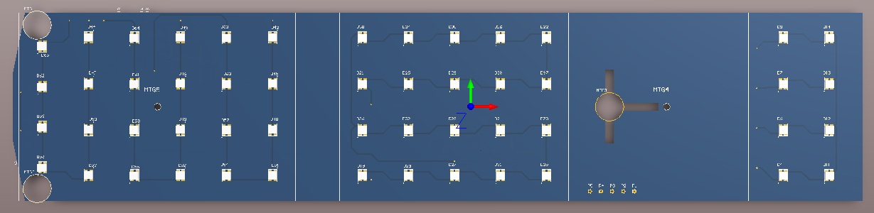

I'm still moving forward. I'm looking for a more efficient amber LED. I got some samples of an OSRAM amber LED from Digikey but the damn things are red. We questioned Digikey if that was the right part and they claim the amber wavelength overlaps the red wavelength and some amber LED could look red. (IMG:style_emoticons/default/WTF.gif)
All the LEDs will use the Polymer Optics lens. These will have to be glued onto the boards. The good thing about the lenses is they don't require holes and this will allow me to put circuitry behind the LEDs. Can't fit the power supplies on the same side of the LEDs so they will go on the bottom of the board.
I started designing the circuitry to provide the "back off" brake light where the brake light flashes quickly a couple of times when you hit the brake.
Also designing the turnsignal lights to be sequential. There are 6 columns of 4 turnsignal LEDs that I will turn on 2 at a time so they'll go: 2 - 4 - 6 ON.
All the flashing circuitry will be done in a CPLD.
