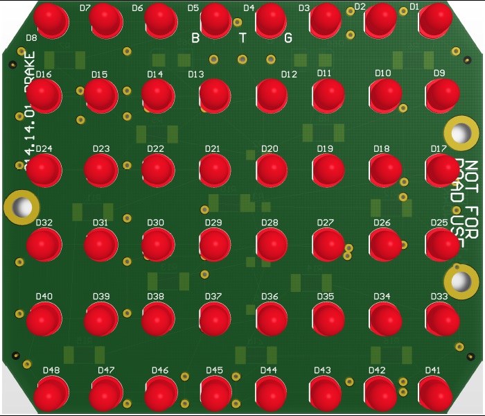

An update on the 5mm LED lights; I have been testing the prototype set of 5mm LEDs to understand the temperature rise when the brakes are applied. This is the highest power dissipation state and will generate the highest temperatures.
The prototype with 63 LEDs and maximum current runs very hot. I've measured temperatures over 100C which is way too high. I've cut the current down a bit but the circuit still runs very hot.
My goal is to keep the temps about 40C above ambient. To do this, I had to turn off 12 of the LEDs to reduce the power dissipation. Now the circuit runs around 60C (room temp is 23C).
Even with the reduced current and number of LEDs, the circuit still puts out way more light than the 1157 bulb and is on par with the CREE board.
With this info, I decided to reduce the number of LEDs to 48 which will still give a wall of light. The board is about 1/4 inch taller than the prototype should work well.
I need to test this board out so I will build only 1 pair to begin with so I can evaluate the thermal performance of the unit.
Sorry for the delay but I need to make sure these work well before doing any mass building.

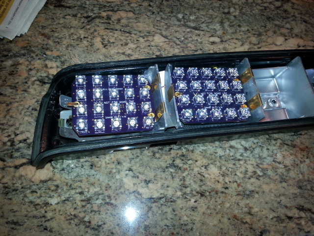

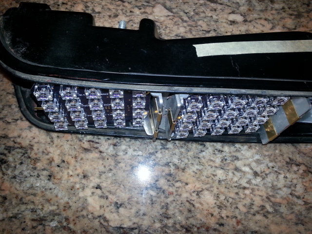

I built one PCB with high power Cree amber LEDs to use as turnsignals.
The PCB was mounted in the turnsignal housing using brass clips. The one on the end is quite long and doesn't hold the board as tight as the brake light.
This pic shows the skew of the boards in the housing so that they're pointed directly behind the car. If made on one board, the brake lights would be quite deep in the housing.

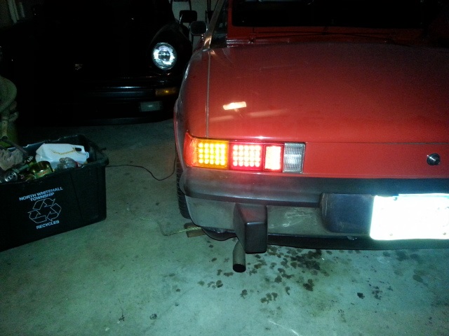

When I built the Cree amber board, I didn't think the LEDs were quite as bright as the red LEDs so I increased the current to 70ma (brake lights are at 40mA).
Here's a comparison of the original turnsignal bulb and the amber Cree LEDs.
I think I went too far with 70ma. It is very bright.
https://www.youtube.com/watch?v=Mxb6IvHO_SA
Here's what the turnsignal light looks like with just parking lights on. I'm only running about 3ma in the LEDs. These put out about as much light rearward as the little side light does.
