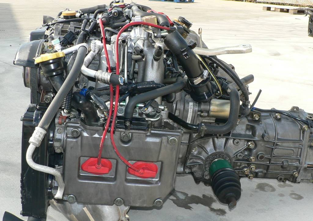

The fun stuff first, the JDM ej20 engine to put the GO in the PorschaGO 914:

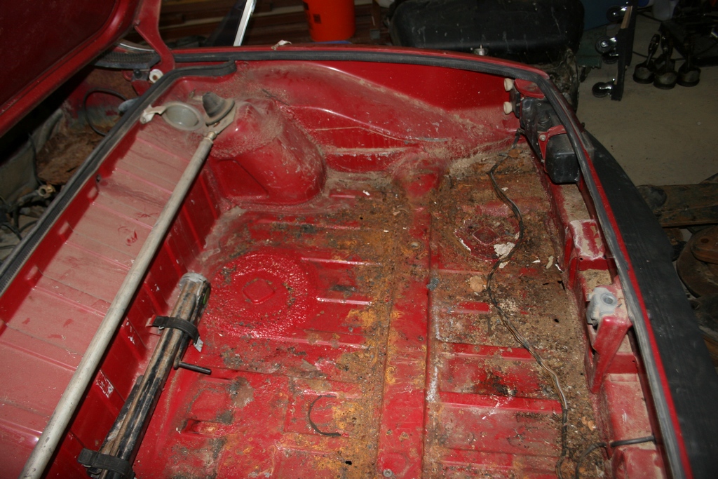

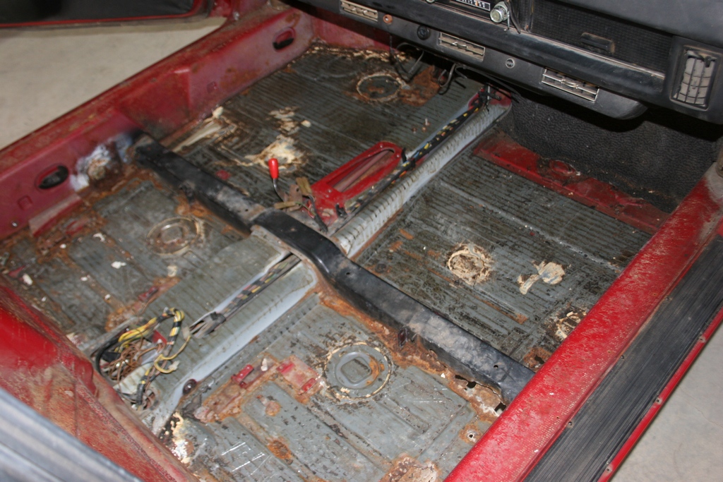

The pan after stripping the tar, looks much better than it is. Right crossmember is toast as well as the seat mounts. Entire lower area of firewall is gone on the pax side but will be easy to patch in.
The trunk, also looks much better than it is, will require some patches at the rear wall. You can see the really ugly hell hole just peeking in. This would have been a parts car to me a few years ago and it probably should be today but I can cut and customize as much want and not feel bad about ruining a good tub.
Overall it's in poor condition but it's a great base for what I wanted.
