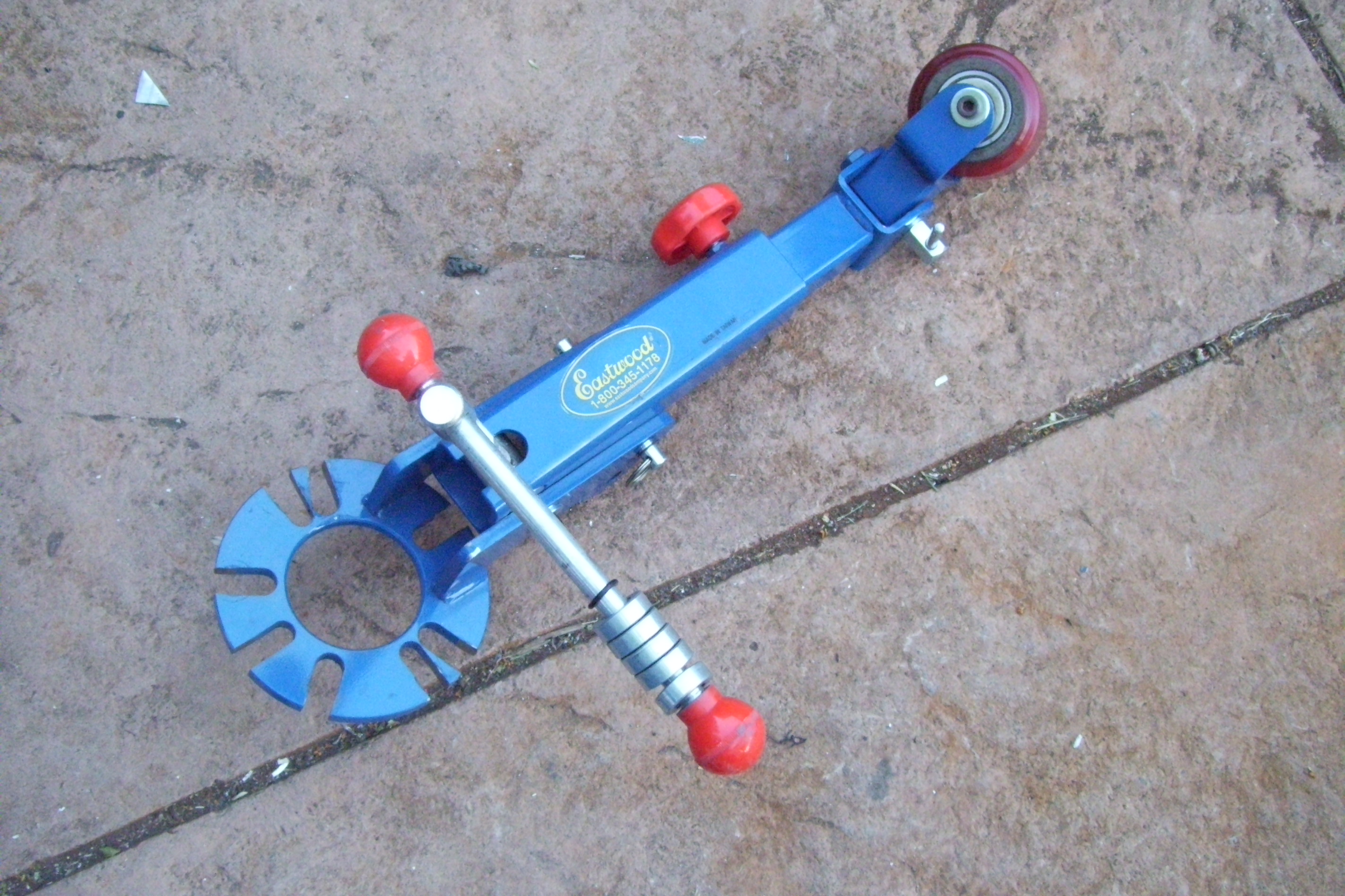

You just need to roll the fenders. Esatwood makes one that will work with a little tweeking.

They look rolled it that pic... I have been told you can stretch them a full inch with the roller.

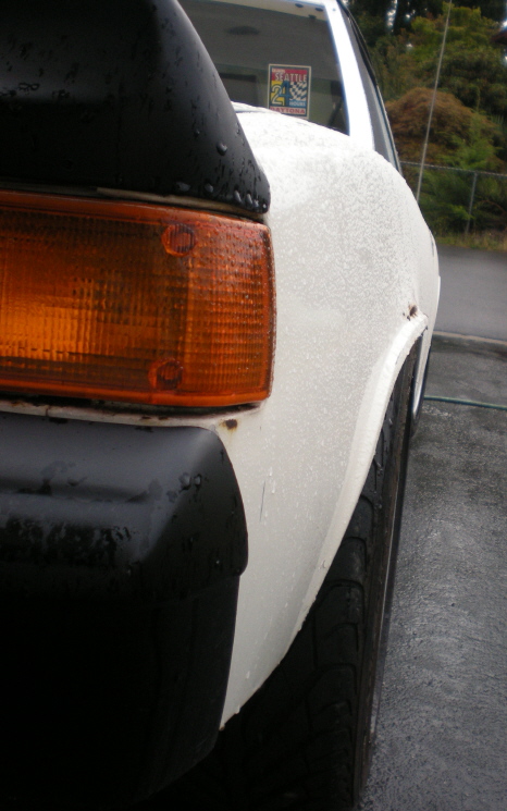

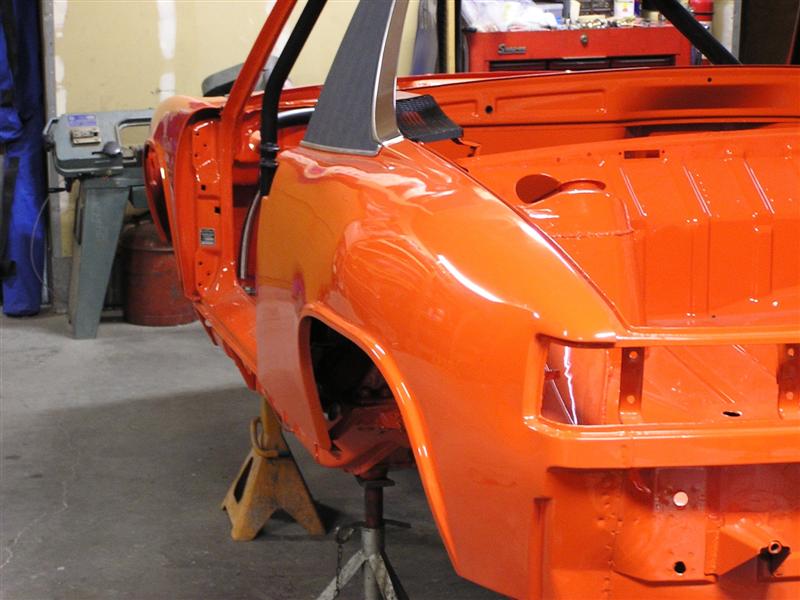

Harold's 914-6 is awesome, but if lowered he would be rubbing, I had them on a 914 that was low , I started with 7's a bit of fender rolling with a 1x2 wood board, A while later switch to the 16x8 951's and had to go a bit more same method. I don't know if the roller would work as the rear fender is not a true radius.

Finally found a pic of what it takes to run em, 245/45x16 951's, the burnt paint is from years of different wheel combos.
FYI my car now restored to stock.

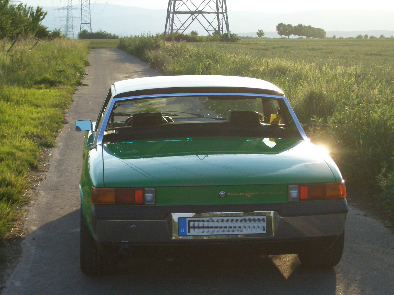

HaraldD
post Feb 3 2013, 06:49 AM
Posts: 100
Joined: 23-November 08
From: Germany
Member No.: 9,781
Region Association: Germany

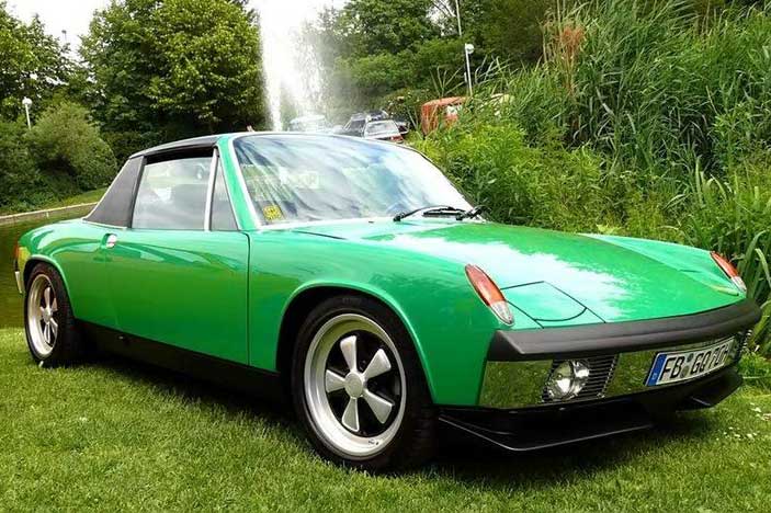

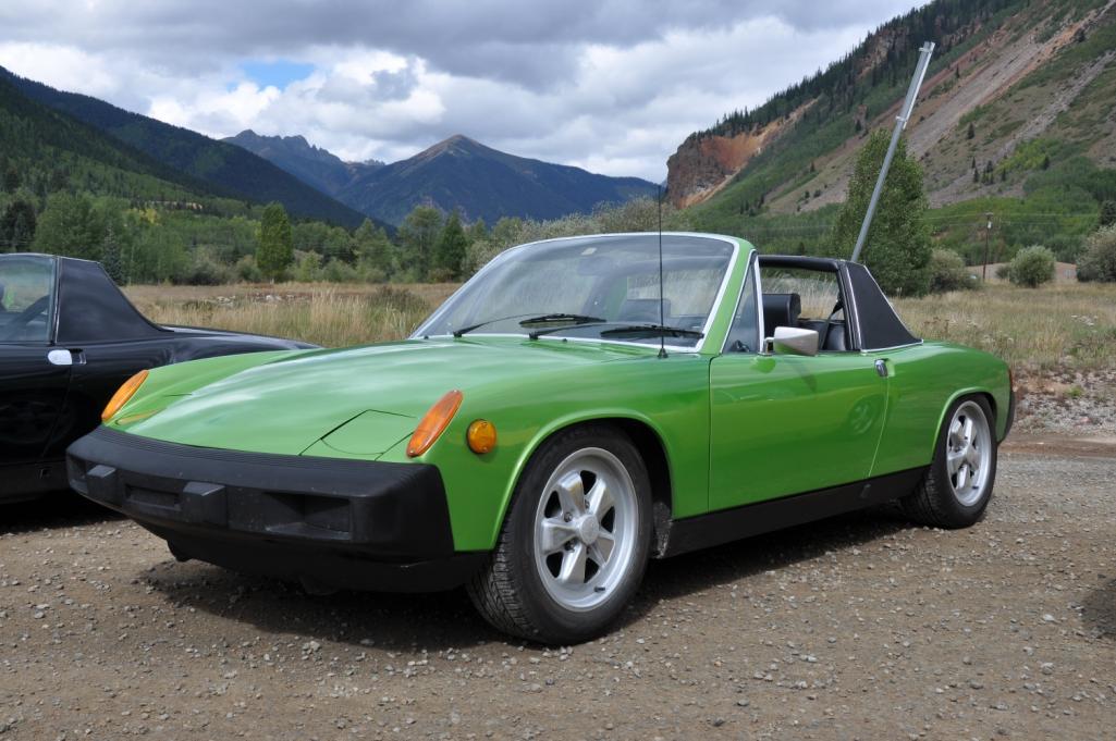

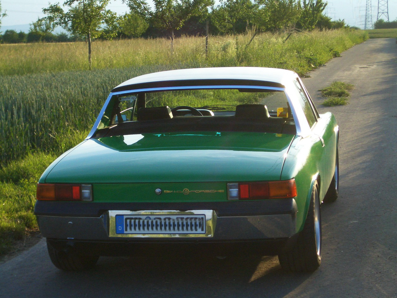

Hi,
here are 2 Fotos of my car. It is maybe 1 inch each side, but it`s enough. If you don`t know it - you don`t see it... (IMG:style_emoticons/default/smile.gif)
Regards
Harald

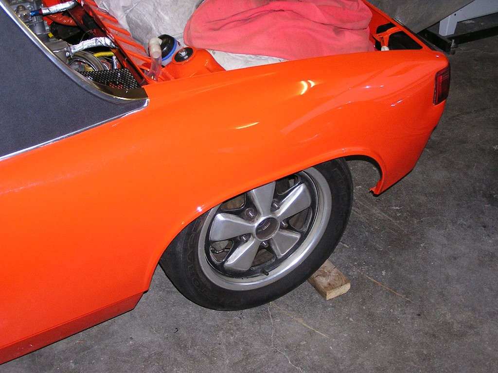

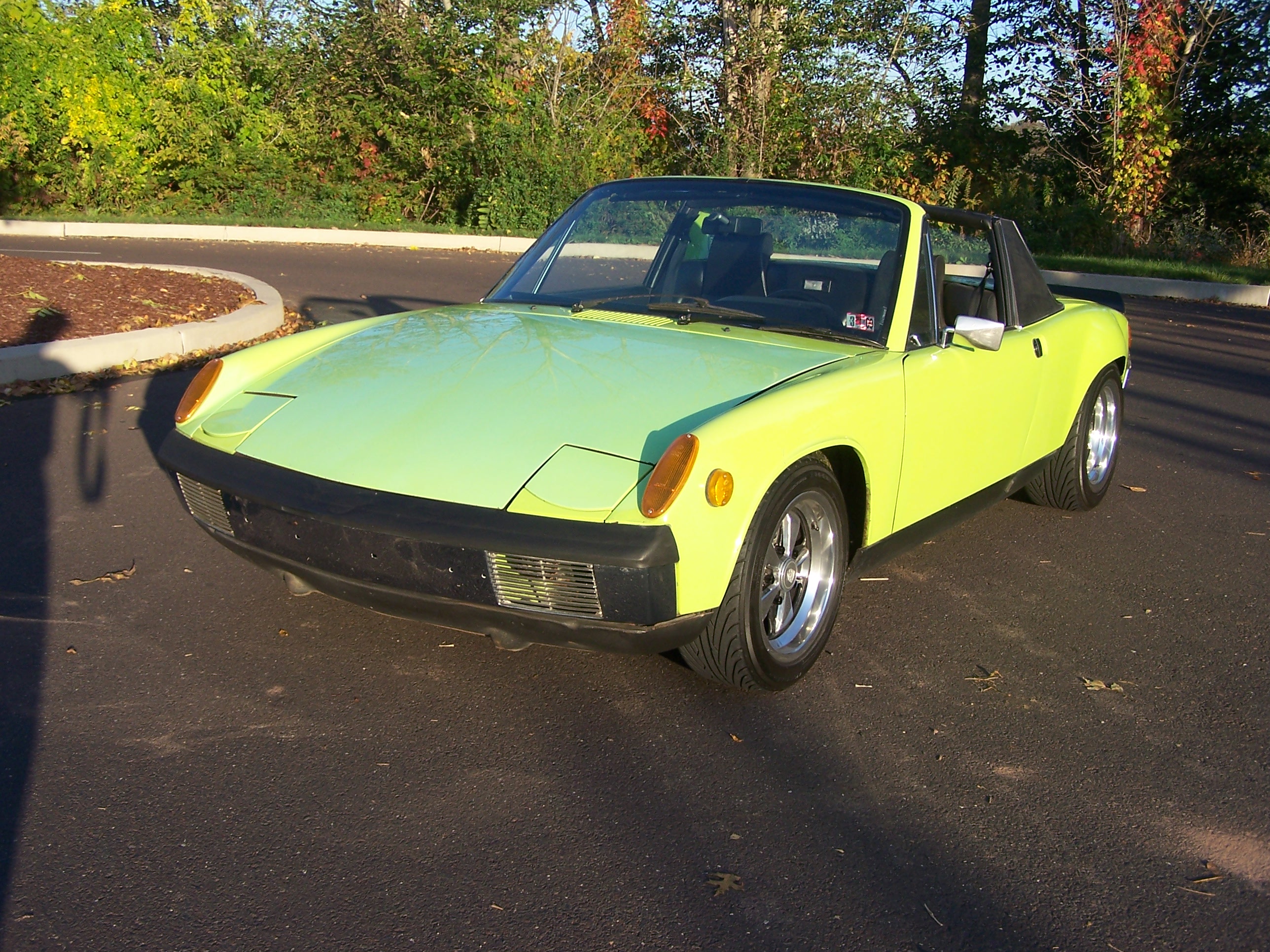

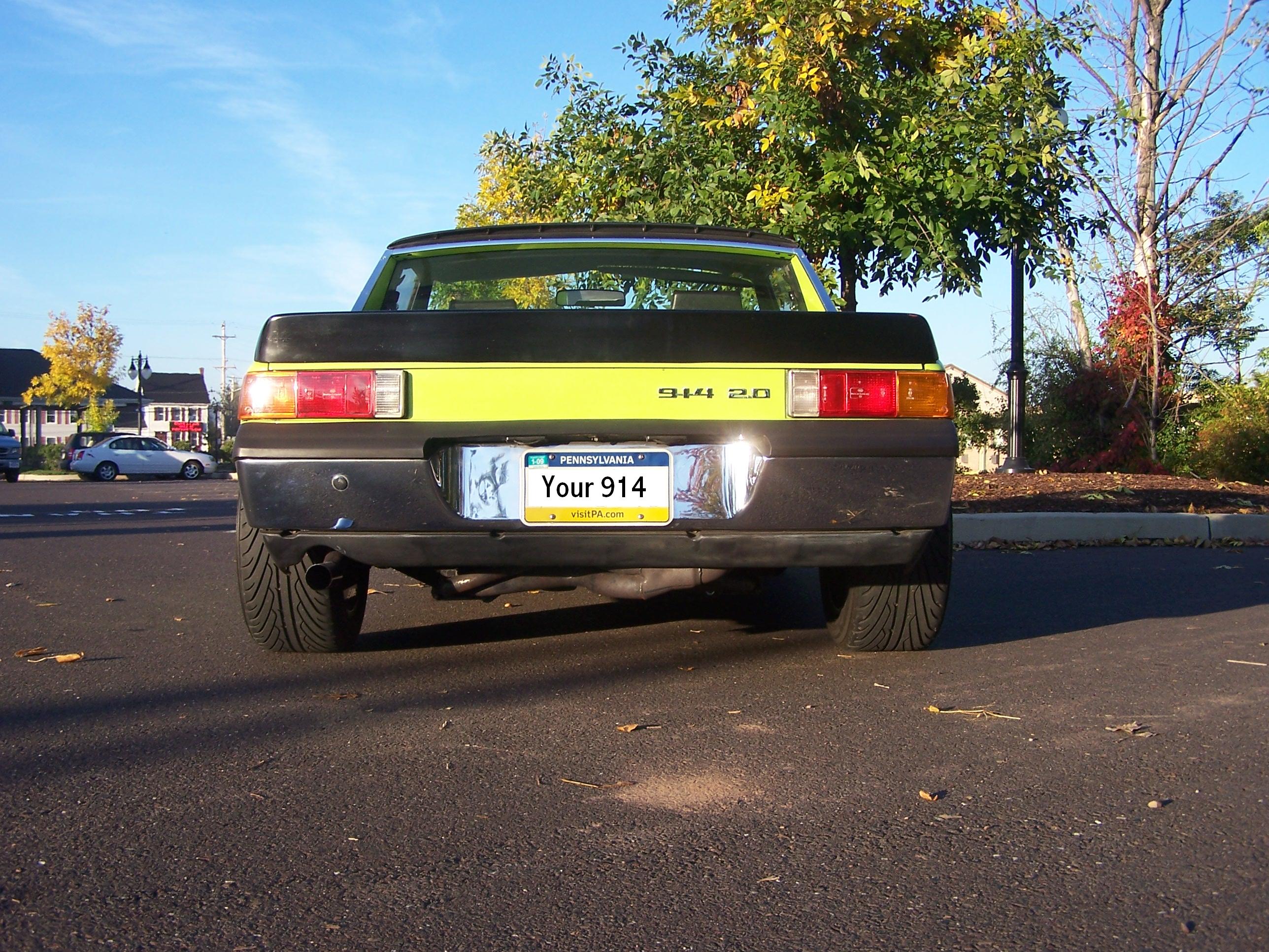

how wide are Harold's rear rims though?
here are 7inch fuchs with 911 offset
(different offset)
these have 1 inch spacers and still plenty of room
I have test fit 8's on the car and honestly might be able to run 8's with some spacer
but the fenders are VERY worked over and not stock at all:

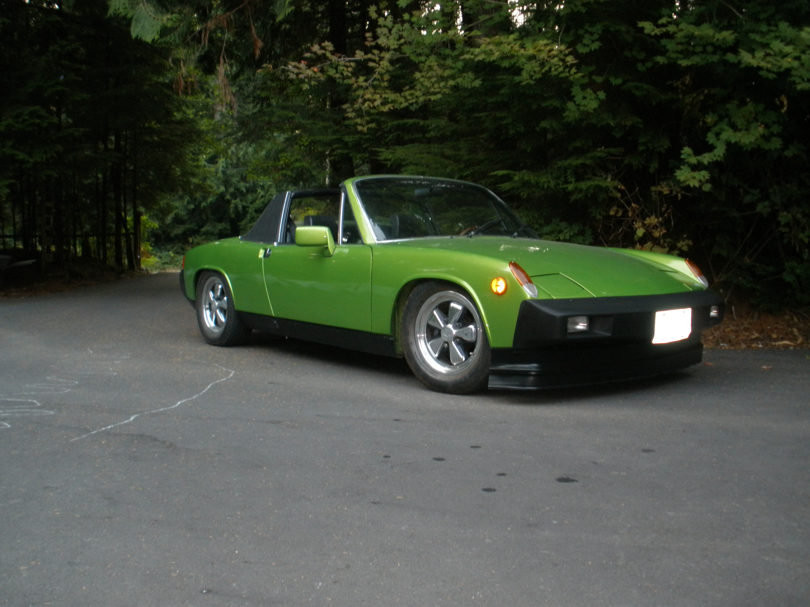

here are 6inch rims with no spacer as a test:
brant
post Feb 3 2013, 01:24 PM
Posts: 12,283
From: Colorado
Member No.: 47
and 7inch fuchs with no spacer:
