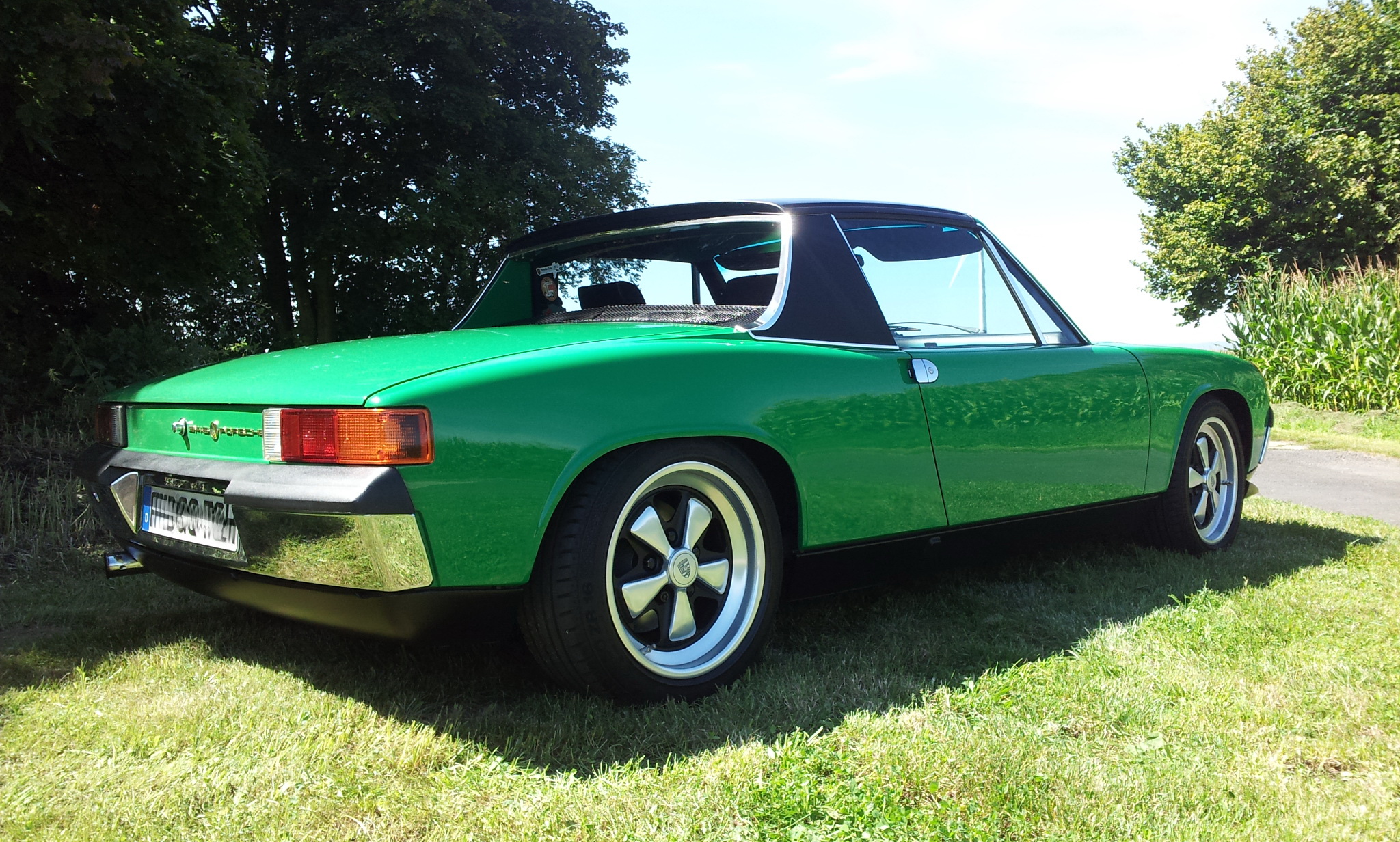

HaraldD   Hi, here are 2 Fotos of my car. It is maybe 1 inc...   Feb 3 2013, 06:49 AM
bigkensteele   Hi, here are 2 Fotos of my car. It is maybe 1 in...   Feb 4 2013, 12:28 AM

HaraldD   Hi Ken, thank you very much! Yeah - these are...   Feb 4 2013, 01:47 PM

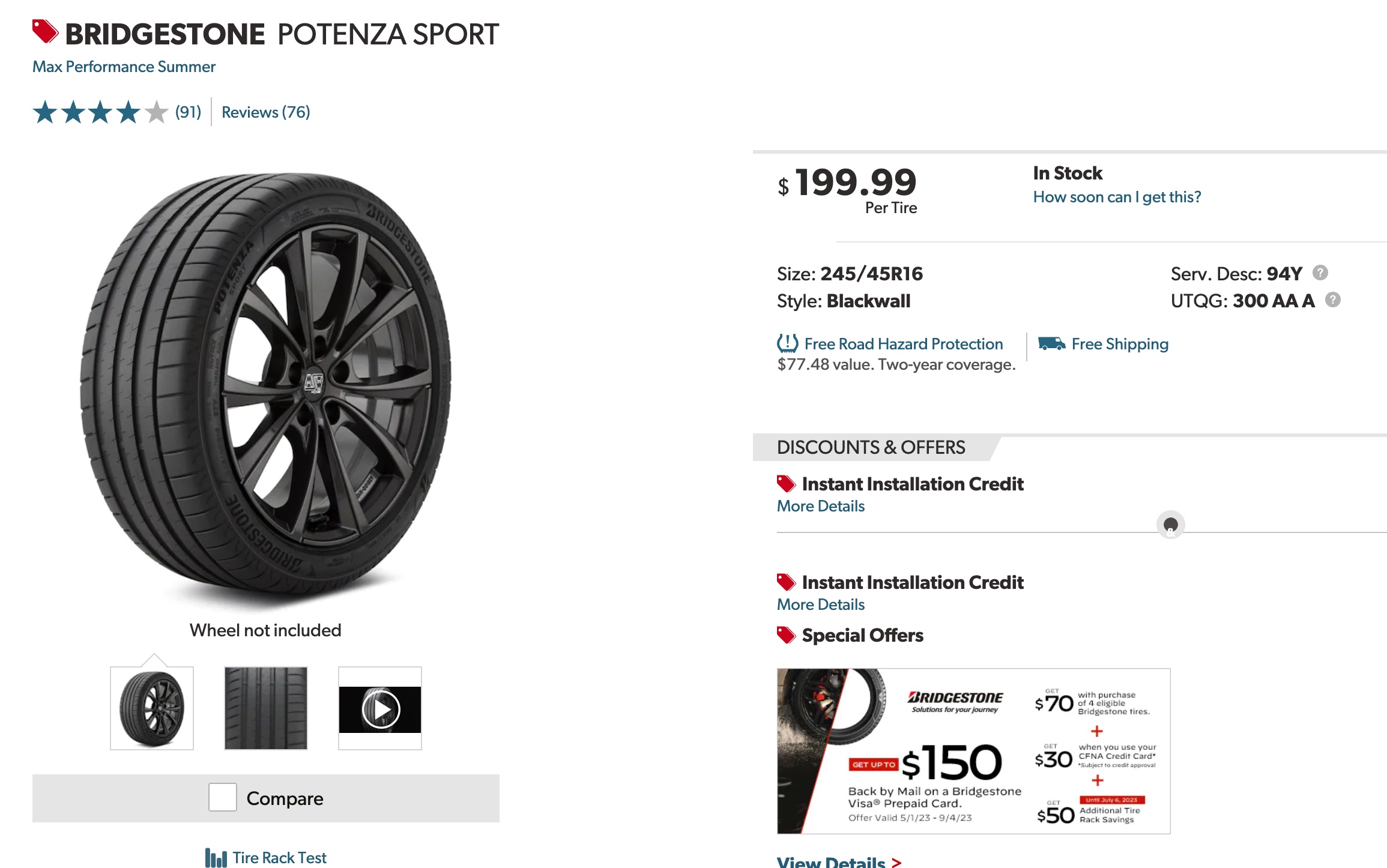

burton73   Just a thought on the 8s. The only company maki...   Jun 22 2023, 12:26 PM

NARP74   Waking up a 10 year old thread, good job. Love th...   Jun 22 2023, 12:33 PM
