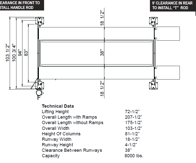

I have the Direct Lift PP8S. Dimensions are below. I didn't have room for anything bigger and it fits perfectly in my garage, but this is the first limitation I've come across. As you can see in the schematic below, it says 38" between the ramps, but the flanges that the jacks run on are 3" on the inside of each ramp, so only 32" of open space.
JmuRiz
post Feb 5 2013, 10:51 AM
Posts: 5,652
From: NoVA
Member No.: 50
Gotcha, I think that's like the narrow side of mine...mine can widen out to 44". Is there any room to move the ramp w/o the ram over?

doug_b_928
post Feb 5 2013, 01:22 PM
Posts: 740
Joined: 17-January 13
From: Winnipeg
Member No.: 15,382
I don't think my lift is width adjustable. Turning around the lift ramp is creative solution, but it's not practical for me to do that.
