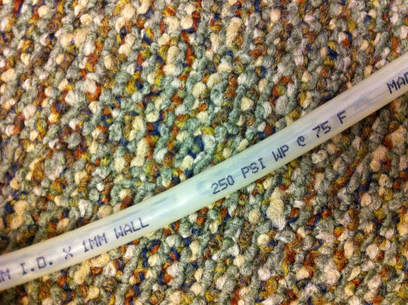

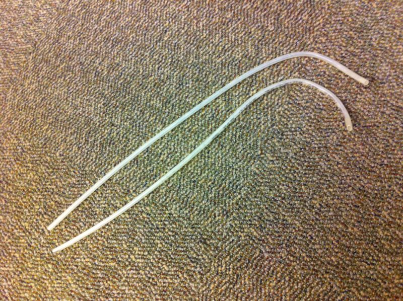

Jeff Bowlsby   I prefer the orignal non-metallic tubing. No real...   Feb 5 2013, 09:51 AM
grogthegreat   I see your point. I plan on replacing the lines in...   Feb 5 2013, 06:51 PM
Kraftwerk   I will say it another way: "stock "doesn...   Feb 6 2013, 02:38 PM
Jeff Bowlsby   Tough crowd! Porsche designed these cars with...   Feb 6 2013, 05:51 PM
yeahmag   Crazy... That looks like PEX tubing.   Feb 6 2013, 06:58 PM
euro911   Were the fuel lines originally white and turned br...   Feb 6 2013, 06:09 PM
Jeff Bowlsby   Were the fuel lines originally white and turned b...   Feb 6 2013, 08:13 PM

Jeff Bowlsby   Hey John, to be clear, we are talking about the en...   Feb 7 2013, 10:32 AM
John Jentz   Hey John, to be clear, we are talking about the e...   Feb 8 2013, 02:14 PM
