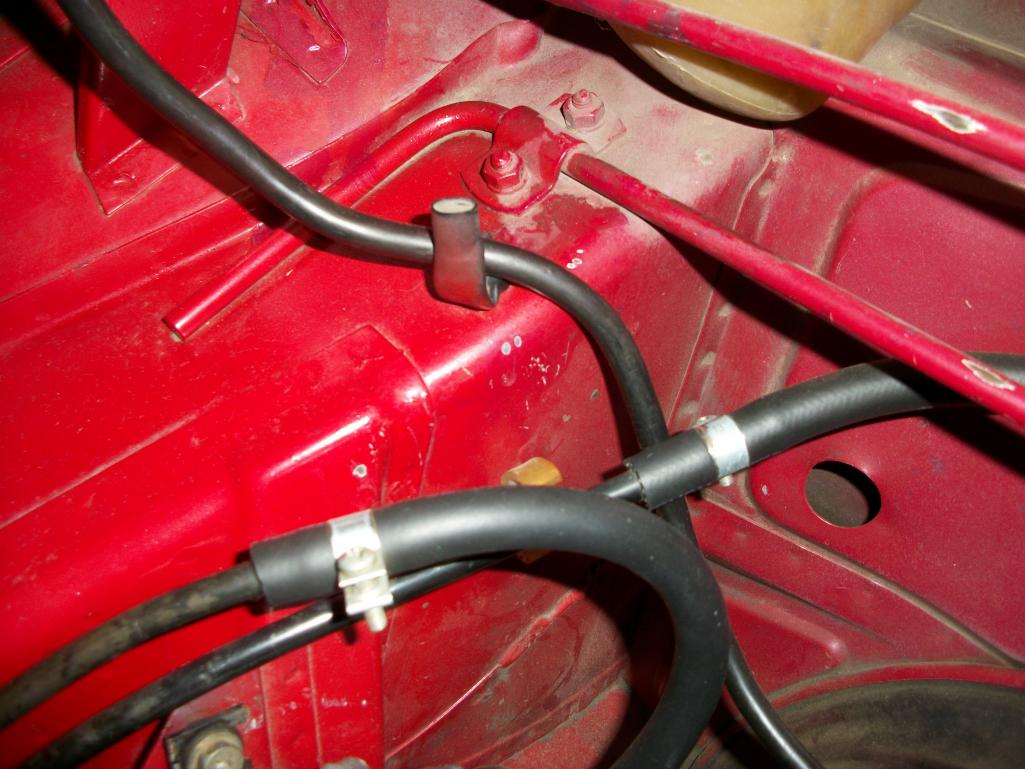

Chris H.   In '75-'76 the tubing was definitely black...   Feb 8 2013, 07:03 AM
gcrotvik   Hey Jeff, I just looked at the pictures of my 75 ...   Feb 8 2013, 08:17 AM
Tom   Jeff, Here are pics of mine. As far as I can se...   Feb 8 2013, 08:20 AM
