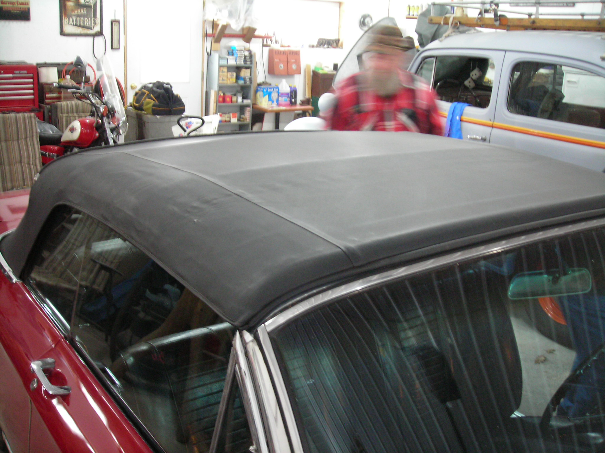

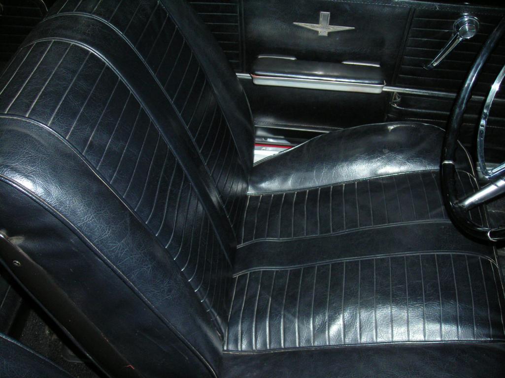

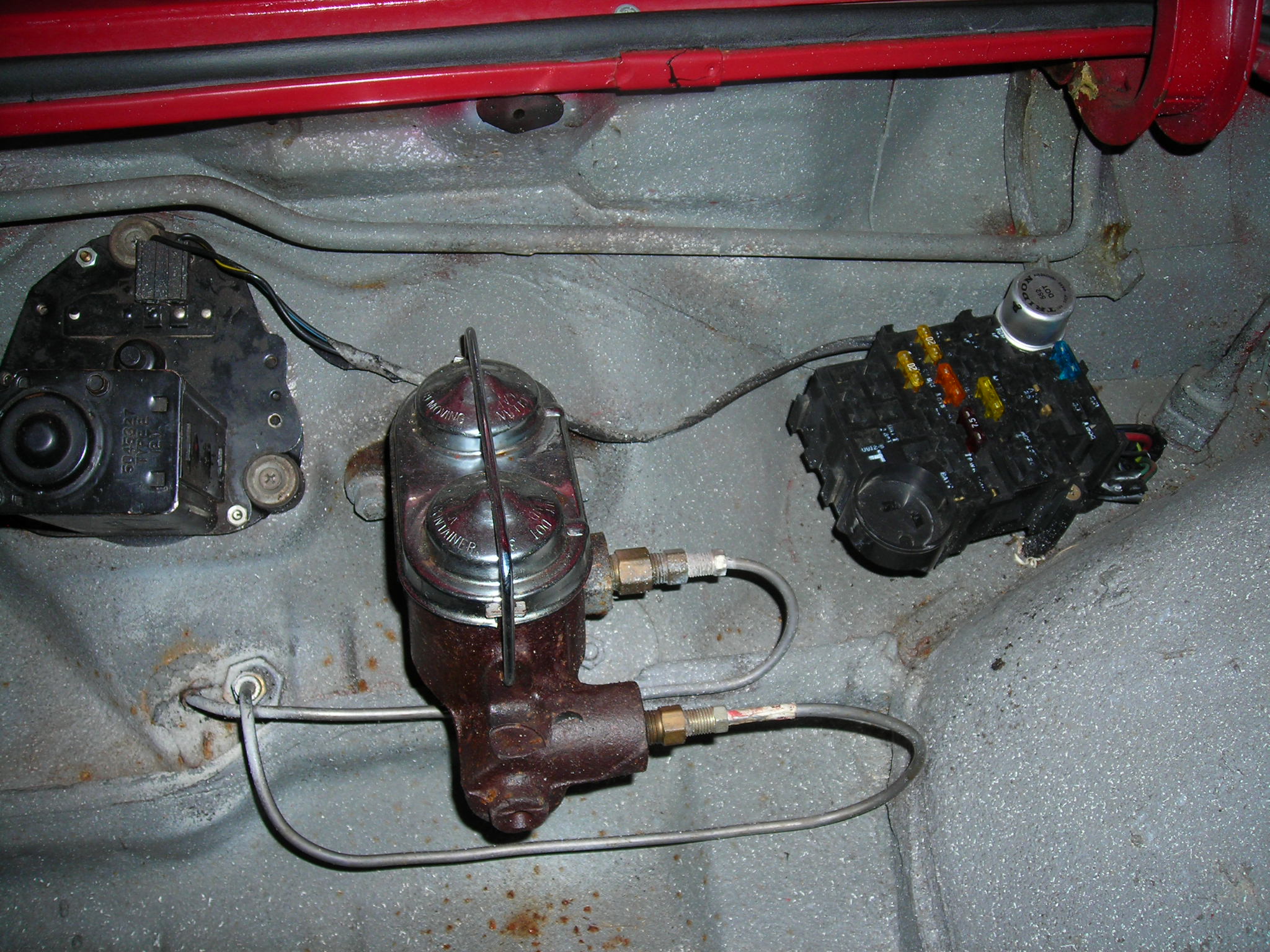

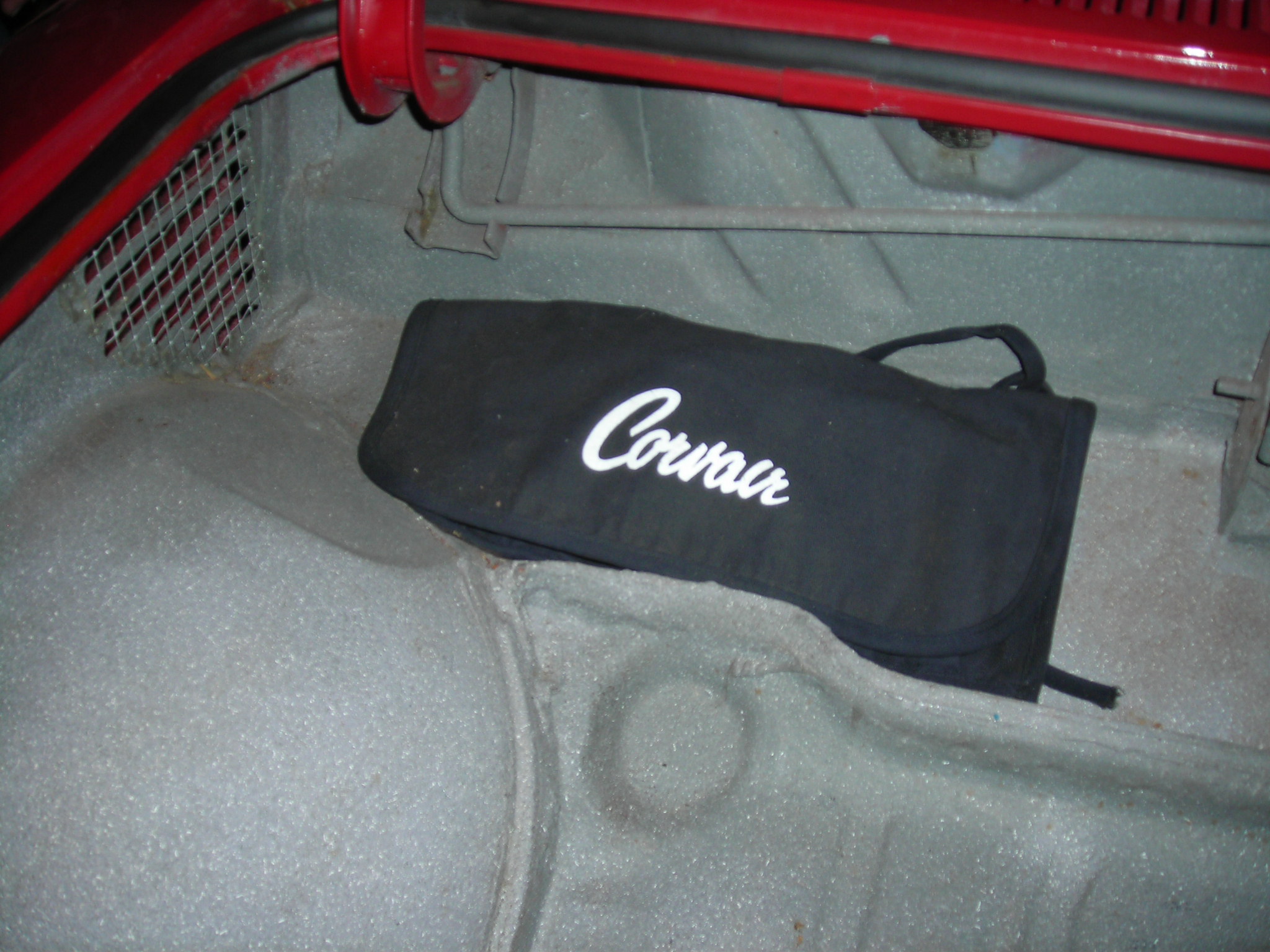

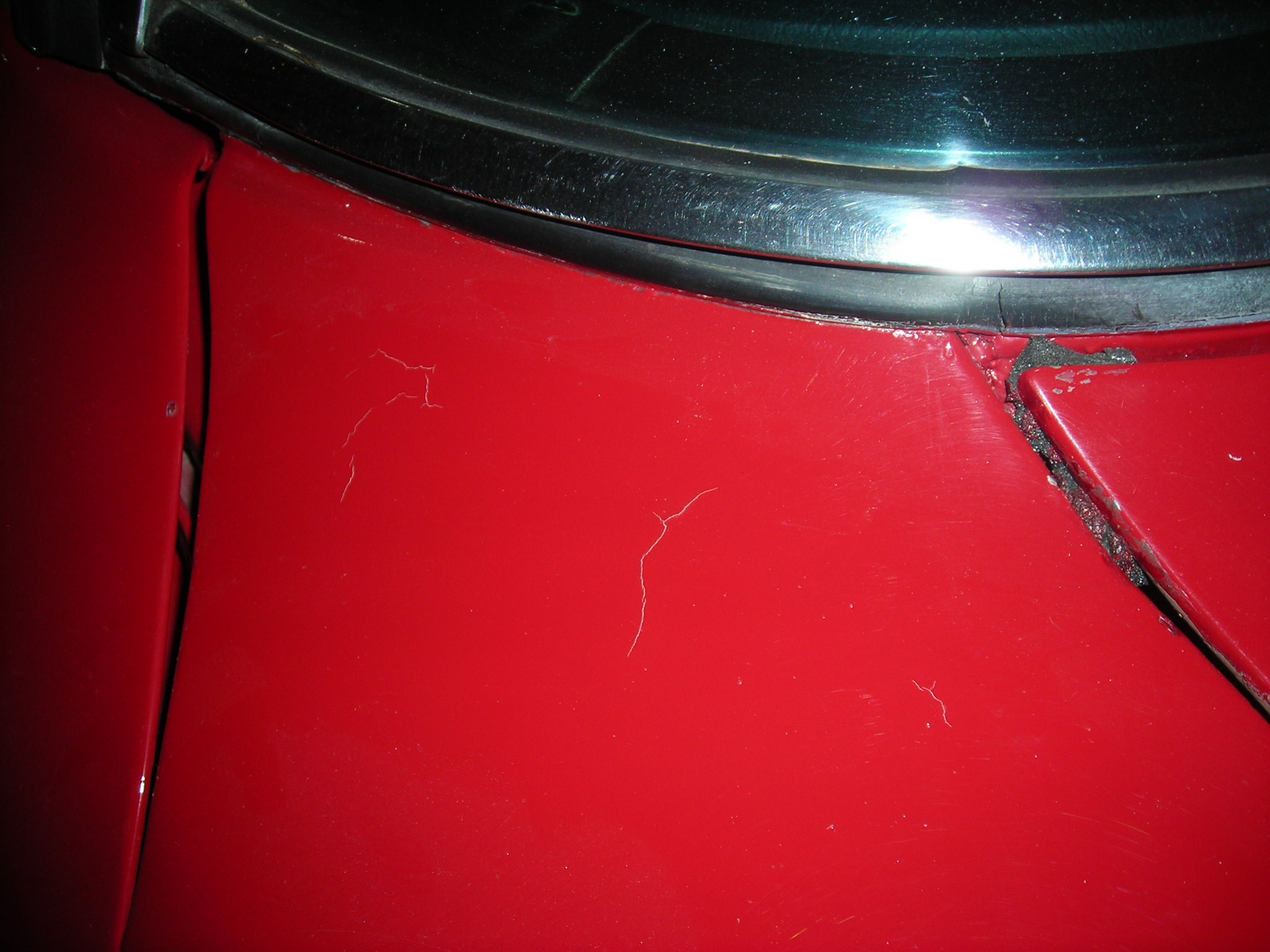

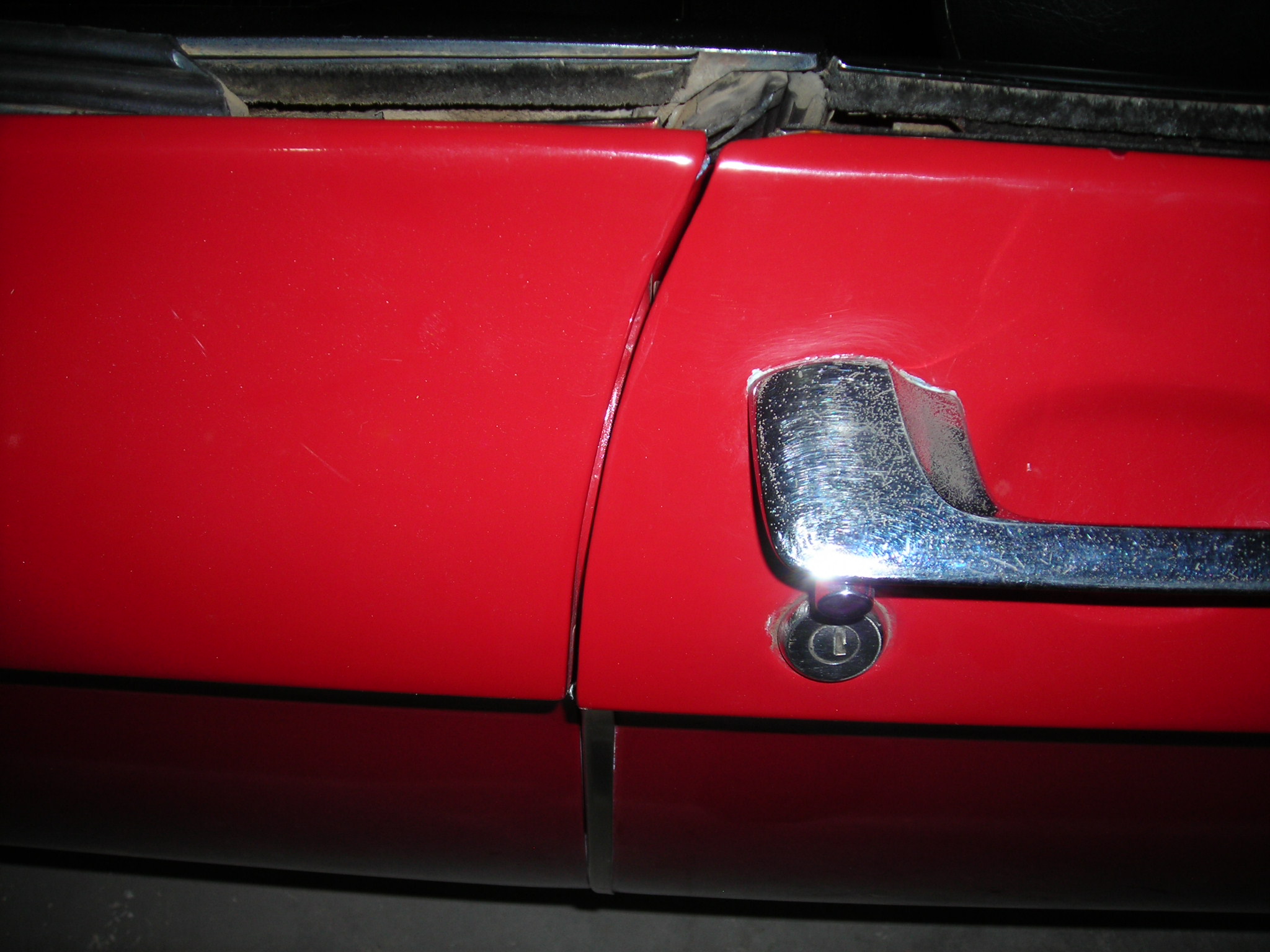

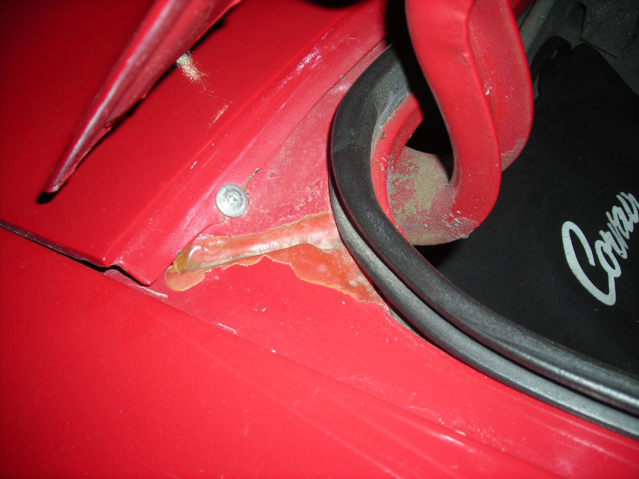

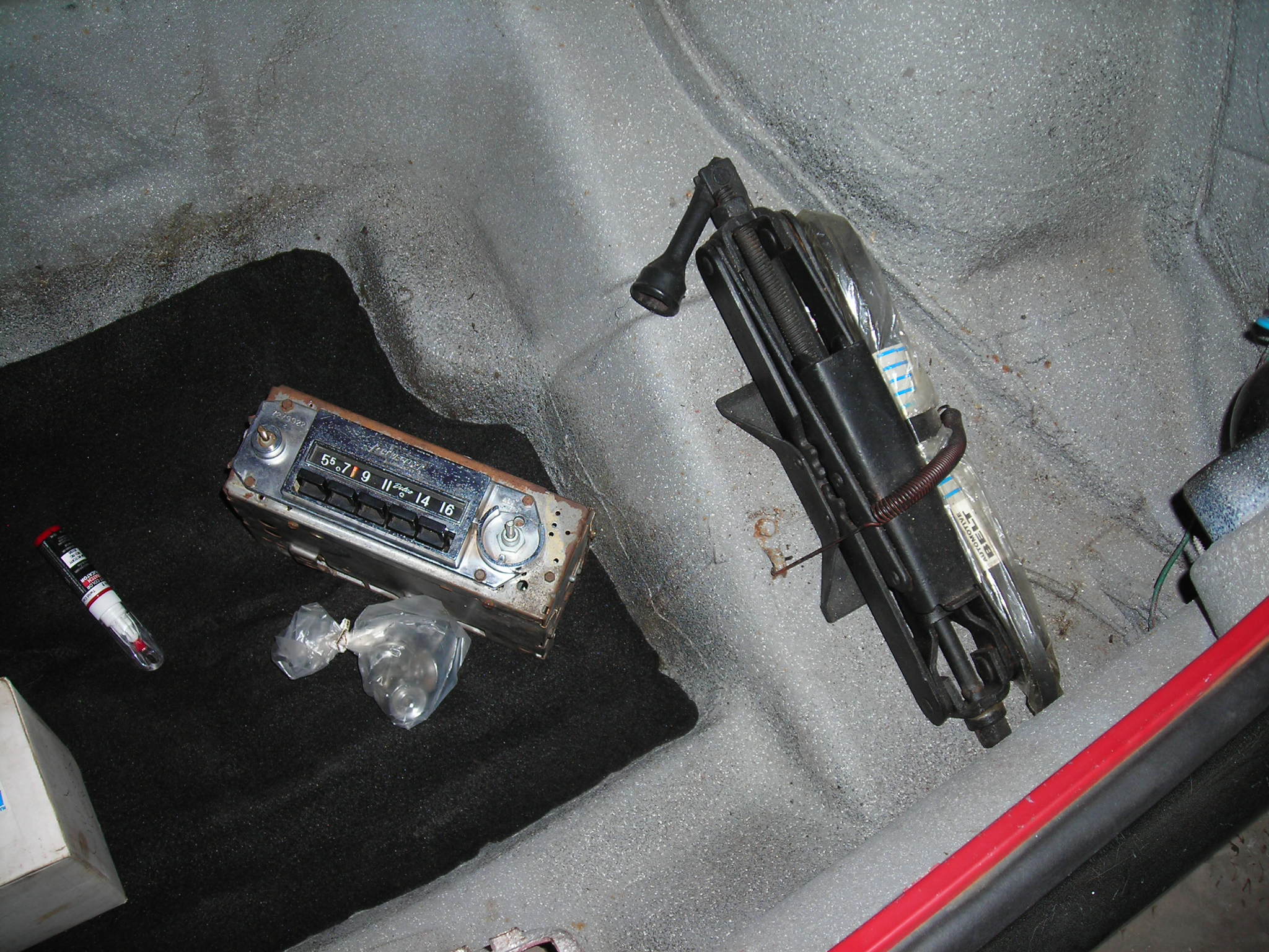

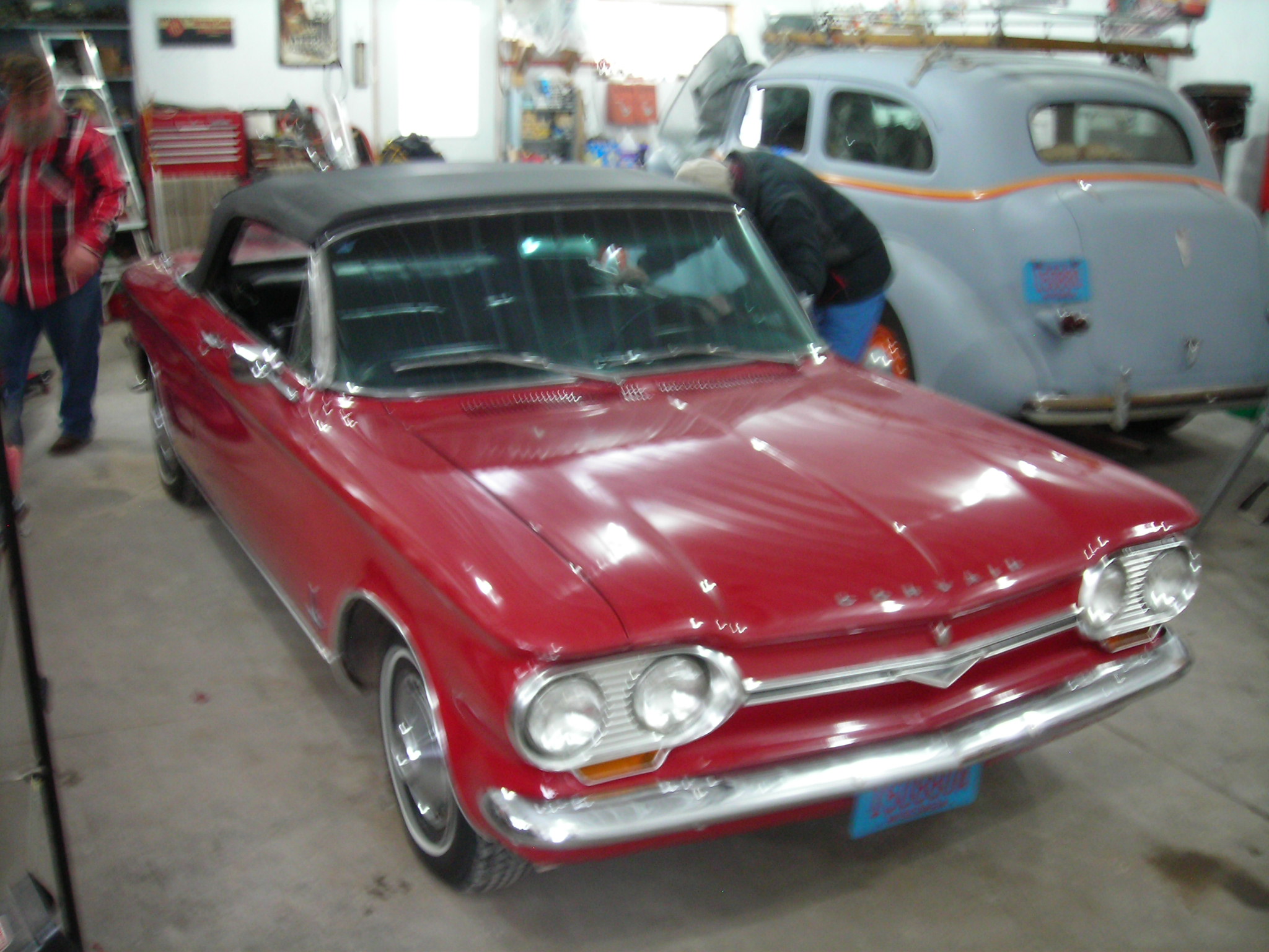

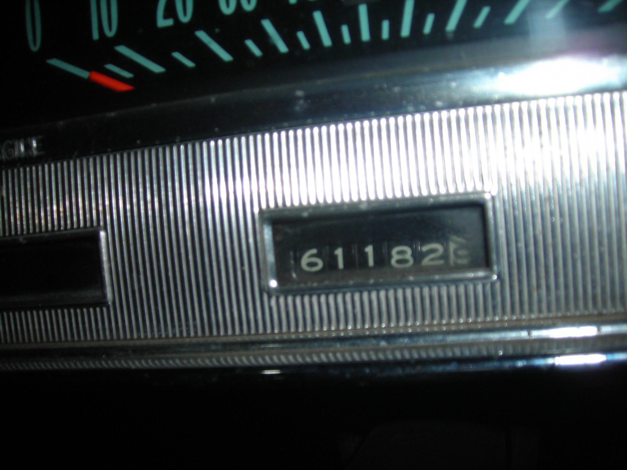

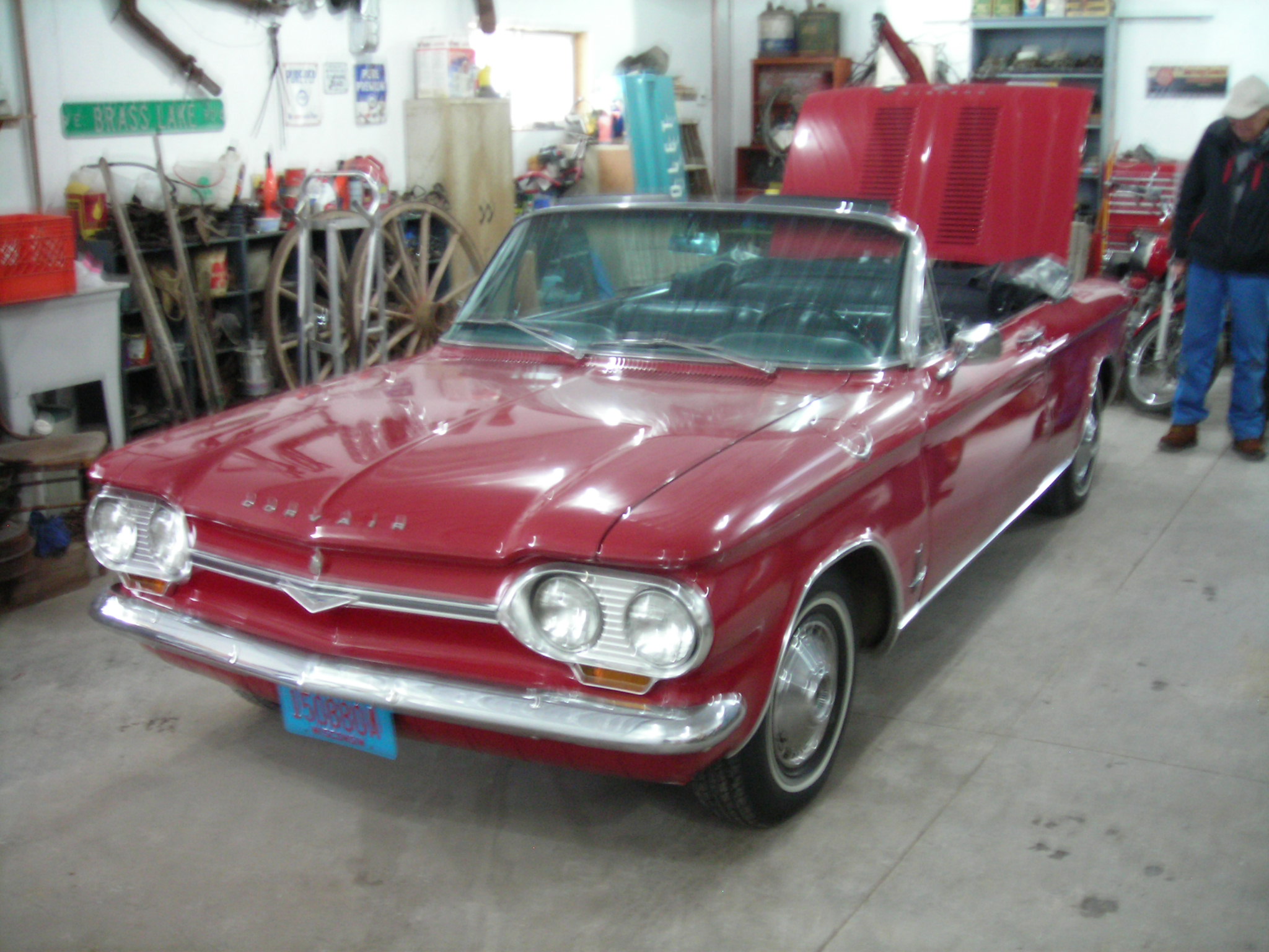

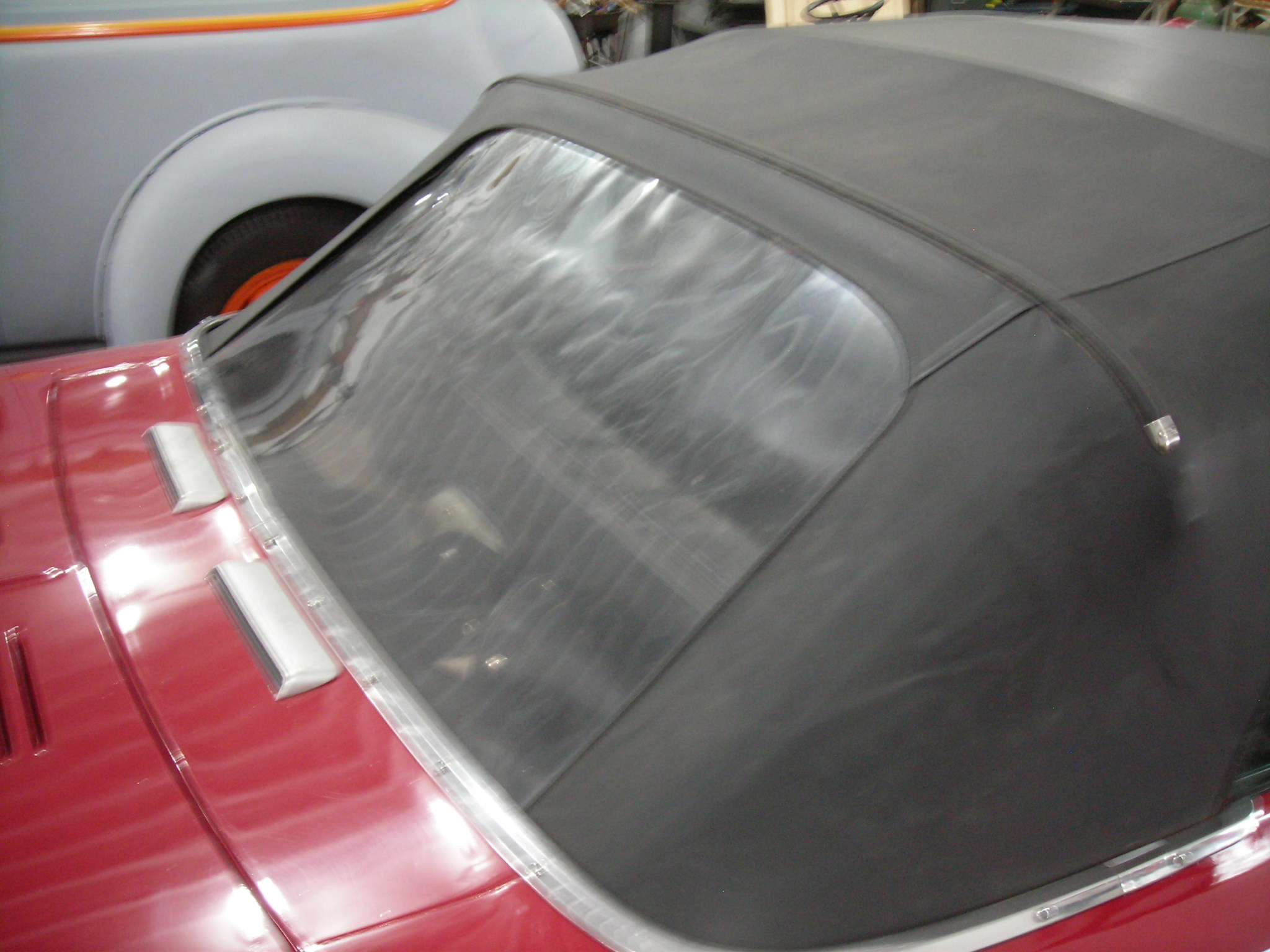

We went to look at a 1964 corvair today, 61k actual miles, 4spd, 3rd owner. Re-spray an unknown # of yrs ago, newer roof, unknown # of yrs ago, original interior, black roof and interior on red exterior. Some flaws in the paint, scratches, nicks. I couldn't find a bit of rust on it. Really. What you see is what the car is. Panel gaps are good, with exception of drivers door, which closes hard. ? if the chrome trim on the door is getting in the way, or if the door just needs an adjustment. Or does this point to something more? A little oil on the engine/trans, has a "nader bar" installed. Started on one crank, clutch was smooth, brakes soft. Was converted to dual master cyl, and blade style fuses. Had a groovy 8 track player, OEM radio is included. OEM jack and washer fluid bottle are there! What does anyone think about the condition, what do I need to look for if we go back, and value?

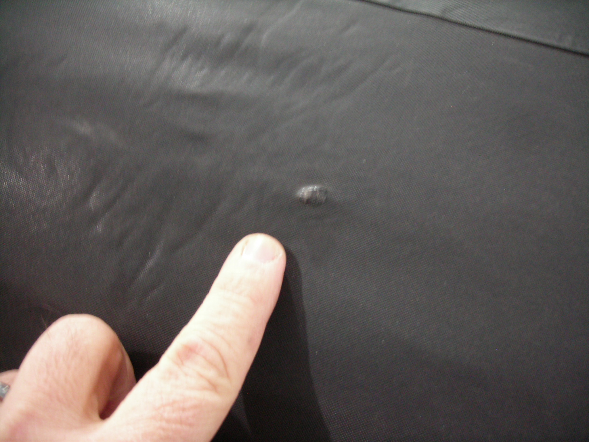

more pics- paint flaws, newer roof, cut to roof, good back window.

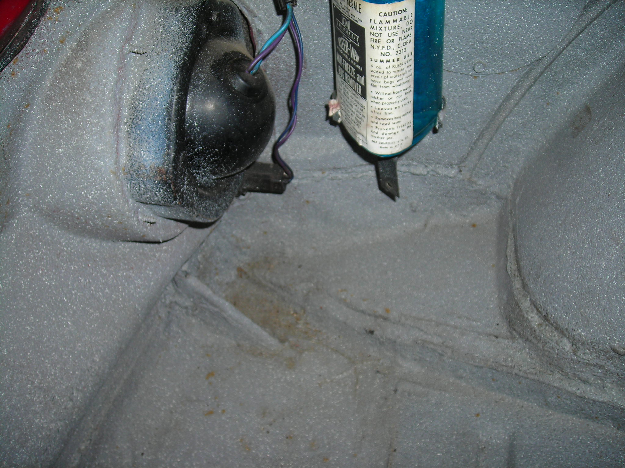

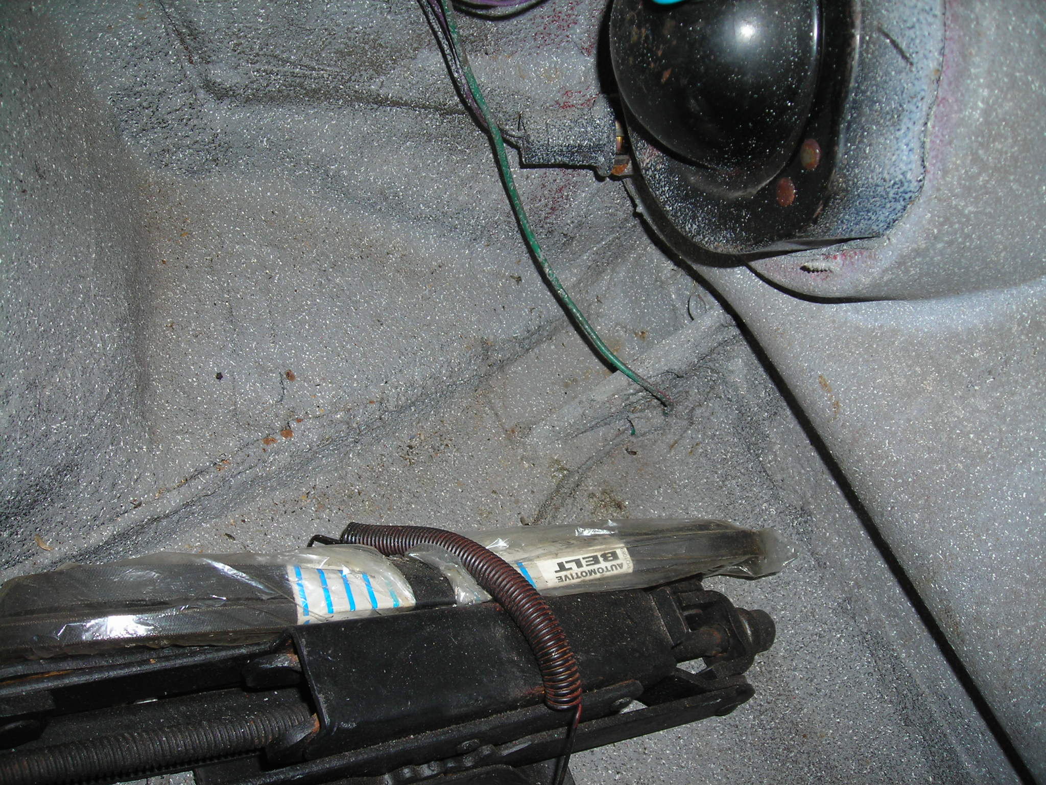

I wonder what all the spray bedliner is hiding. My first 914 had that in the rear trunk... it was not pretty under

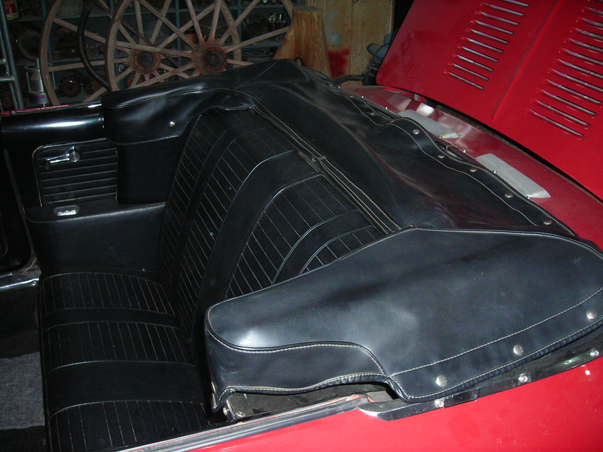

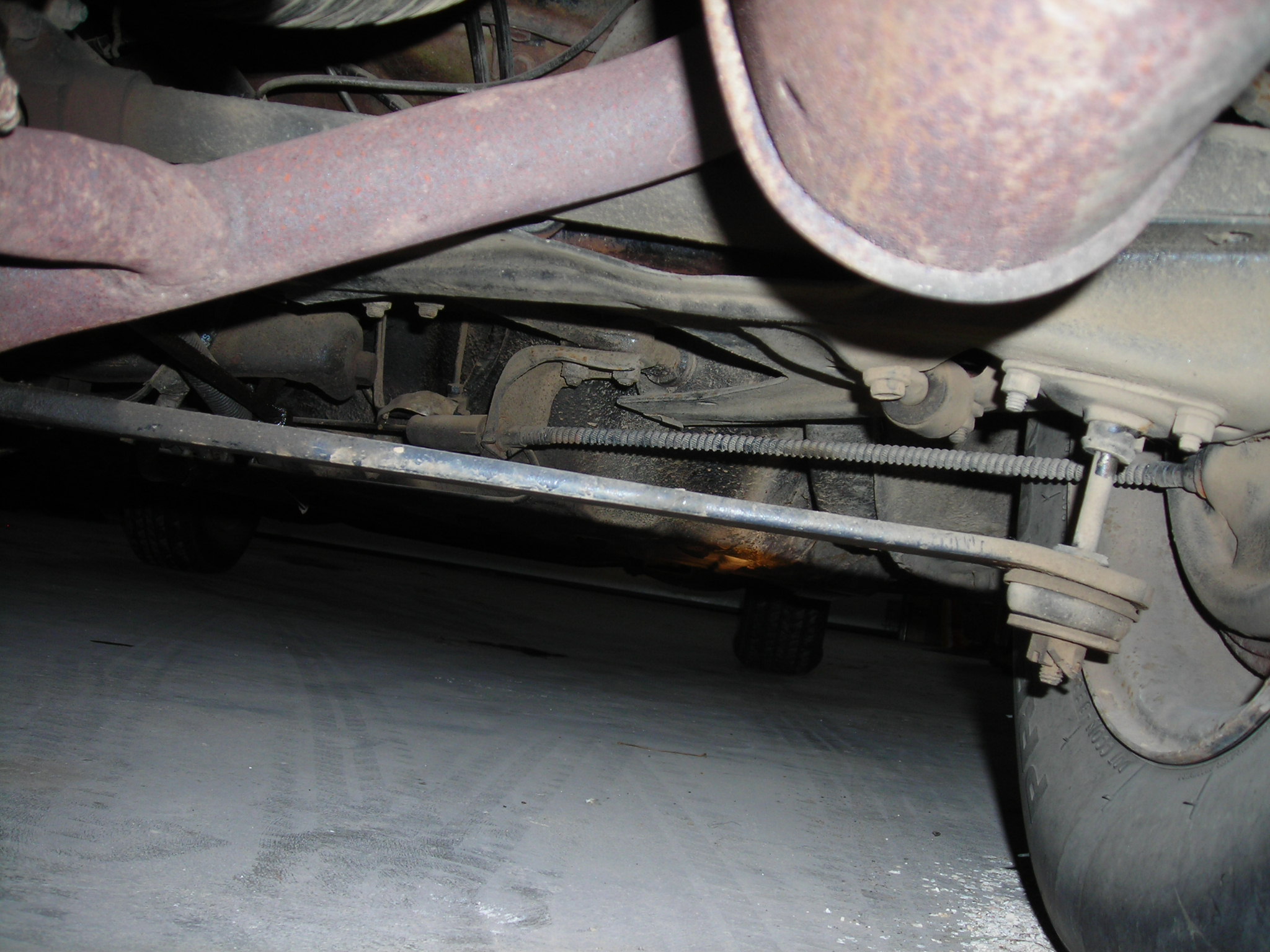

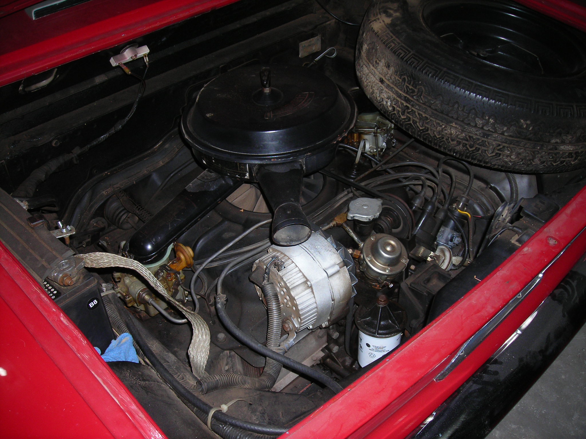

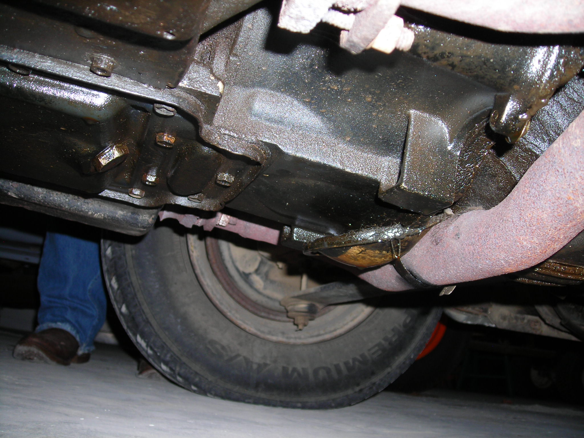

more pics, engine/suspension, interior.

1964 corviars came stock with the transverse leaf spring, as they went to really soft rear coils, and all the leaf does is hold it up to ride height. No effect on roll stiffness.

'64s have swing axle transaxles, '65s went to the Corvette style half shafts.

From what I remember.. early cars.. pre 65 tended to tuck in
the rear wheels in real hard corners, like early VW's.
Not sure if that was fixed by 64

As for the paint , it,s checking do to way to much paint. It needs to be taken down
to bare metal !

So what I have so far is the front trunk finish looks more like bedliner than anything from the factory, so warning sign there, and the engines/valves can burn up, so leakdown and compression check would be a reasonable thing to do as a next step if we really are interested, and that the paint cracking is a poor prior paint job, not for sure an indication of plastic in the body. I gave it the "thump" test, rapping on it with a knuckle in that area, and the tone didn't change, so I'm thinking it actually IS metal under there.
Any other warning signs to be looking out for specific to this car? Can I use the magnet test on the front trunk, or will all that bedliner- if thats what it is, get in the way?
Oh, and price. The owner made it very clear his price was cast in iron, firm, pay me or hit the road at $6500. He showed us an "auto trader" style rag that has this car listed at 7300 from a year ago, when he purchased it from the 2nd owner. Idea was a fun car for his wife, but she does not like manual trans cars. She fell in love with this one, but couldn't get past the trans. From the for sale add to our visit, the car had about 1500 miles added to it in one year.
Now what does anyone think?

The car looks to be in decent shape. Verts always bring more cash. The trunk may have been painted over, maybe not. That was what they looked like when new. I've had a bunch of Corvairs over the years. Loved them. That one has leaking pushrod tubes, real common but real easy to fix also. 64's are a good year, the looks of the original design, but the larger 2.7 liter engine and improved suspension. They sound great with a nice set of dual exhausts and the motor bottom end is really strong.

I've owned several Corvairs. I had a 61 Fawn coupe auto, a 62 4 door auto, a 63 Spyder110 manual vert, and a 64 140 manual. From our phone call. go through the brakes and fix the push rod seals. All else should be fine for a 82 yr old guy to drive Ms Daisy to the DQ.
The cracks in the paint look like old glazing putty cracks. The trunk pan looks like it had been patched. The finish is called Zolatone. It was always rough. The trunk was spot repaired/repainted. You can tell by the overspray on the head light bucket and the wire harness. The fuse panel has bee changed. These are not the worse things that can happen. It's typical of a hobbyist rebuild. Lets see if we can connect and I will go down with you if you want and we'll look at it. But overall it's a driver level car. $ 5,500.00 is not too much. Sorry the last guy over paid but that's not your fault.
