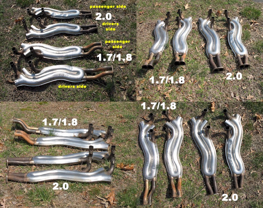

i have a '75 teener here...a 1.8...i bought a set of gently used SS heat exchangers from "a guy" here...in the picture...so, i think it may matter what year exhaust bits i get...'ja?

That set are from an earlier car than your 75.
Yes they can work...but you will need to replace/backdate a few items.
Muffler, hanger, J tubes, branch pipes, Warm air elbows ect.

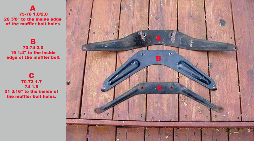

Those are 1.7L/1.8L (pre '75). You'll need a compatible exhaust/muffler and compatible muffler hanger.
Photos courtesy of Jeff Bowlsby's site
EDIT: Yes, what Rich said (I forgot about the heater stuff)

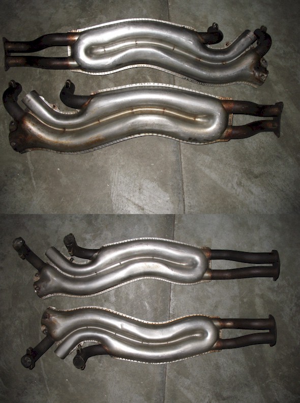

that's my deck in the 2nd picture.
if you are switching your 75', you'll need every item for 74' and earlier. branch ducting, warm air elbows, j-tubes, warm air guides (side and tail shift dr sides are dif) and as noted the correct exhaust/muffler and gaskets. the stub tubes and convoluted he's on the 75' can be a pain to remove. when i did a conv i just cut the the 75' stuff apart with a reciprocating saw and a handfull of metal blades

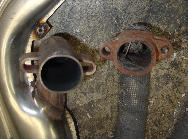

This photo shows the difference between stock 1.7 and SS HE

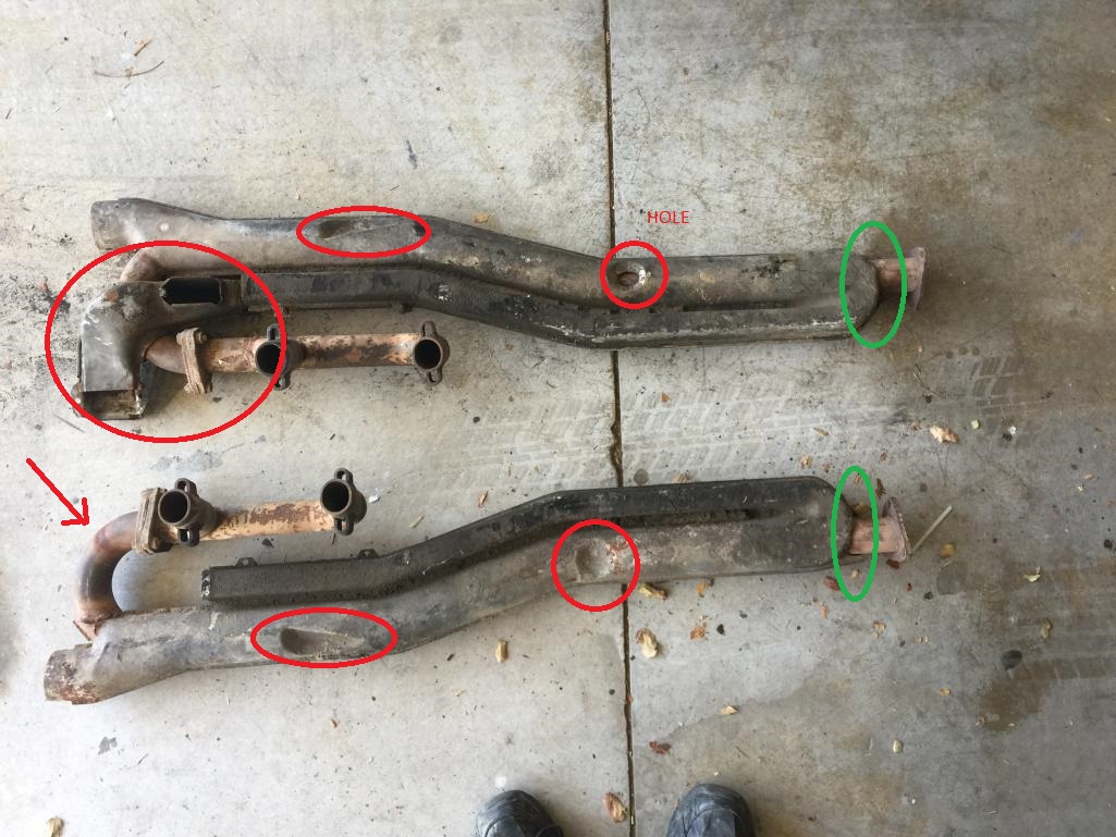

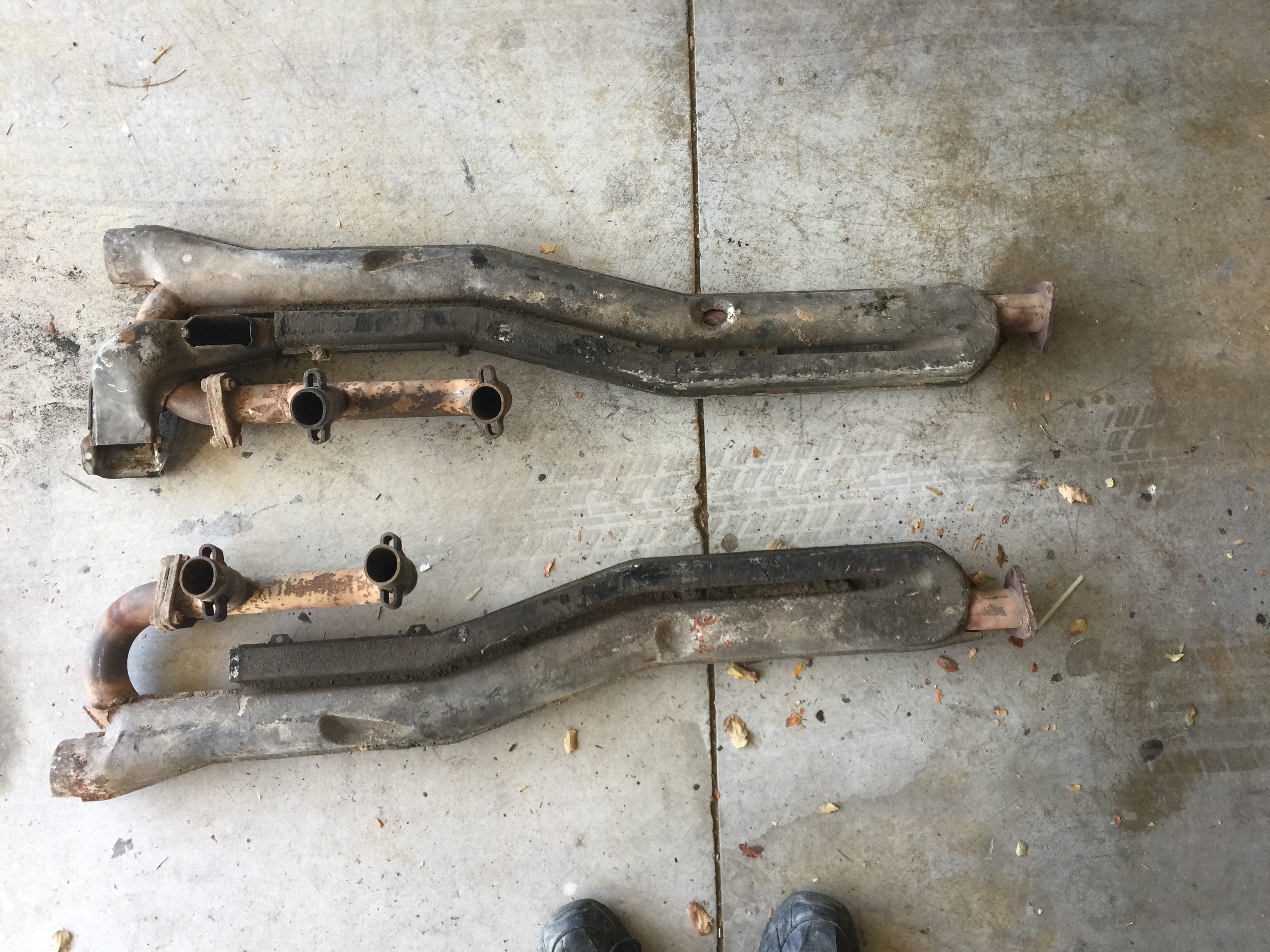

Ok. So I got a set off a member here. For free thank you! But it was wrong! I don't see this set in these pictures. So what do I have? Attached Image

That's a late model 75/76. 1.8/2.0.

That is the original 75-76 only heat exchangers.

Is that a hole in the top of the upper he pictured? Unless you have more parts not pictured you'll have to go shopping. Again. If you use those you need to source the l&r warm air guides. Hope you didn't pay too much shipping for those.

The hole is typ. for this version of HE's its common that all the places circled in red can / will be worn through rendering the the HE ineffective for its purpose.
You can see the collector section missing from one. The specific "J" pipes missing altogether.
The Green you should check on ALL HE's for rot / leakage (with perhaps the SSI's an exception)

Yes. There is a hole in that heater shroud. Looks man made or factory but didn't really inspect it too closely. I can't use it because the collector where you mount the muffler is totally different. I paid 30.00 bucks for shipping. And I gave the guy a few bucks for his time. My fault. I didn't know that this variation existed. Now I do. (IMG:style_emoticons/default/sad.gif) Still on the hunt for I guess an early 2.0 exchanger or pipes. If someone wants these LMK! I can't use them.
