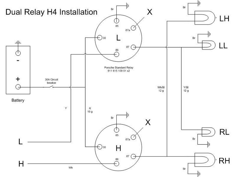

I put in the Hella H4 headlight conversion and its awesome. BUT Im worried too many amps will run through the switch. Does anyone have a schematic on how to put in relays to offset the load through the switch?

There's a 914 hi-powered H4 kit out there from AA, Automotion/PP/Ecklers, etc. - with the schematic. Otherwise Jeff Bowlsby's harness resto website may have a schematic.

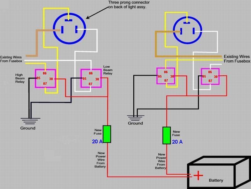

Luke M
post Feb 9 2013, 10:00 AM
Posts: 1,416
Joined: 8-February 05
From: WNY
Member No.: 3,574
Hope these help..
