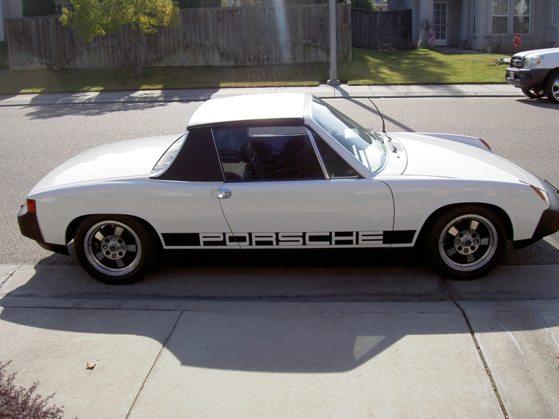

Tried to go for a drive today. Pulling the car out of the garage it backfired a once and had a slight hesitation. Then as I started to pull out it also died. It started back up and a I pulled out, then a very strong hesitation, bucking forward and it died.
It would starting back up, but not stay running.
It was turning over just fine, but just didn't want to fire up.
It's a 1.8 fuel injected 75.
Any help on where I should start looking for my problem would be much appreciated. I'm sure I'm being a bit vague with my issues but like I said I'm a complete newbie and learning as I go.
