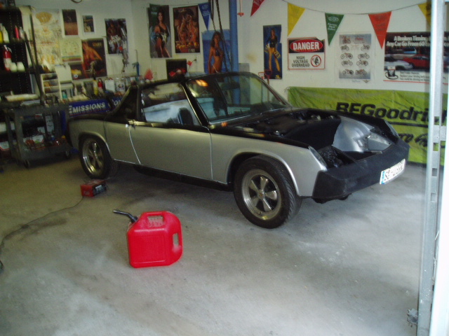

simple yes, but the wires on the old motor and the new motor are not exactly the same. We'll see if i have everything i need... anyone have a coil hold down braket?

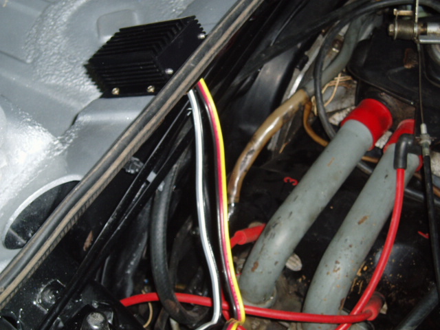

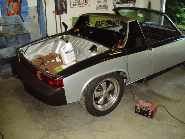

mo progress tonite. Wiring up the motor and mounted my xr700 in the trunk. Check out how low the rear is now!
xsboost90
post May 12 2005, 09:21 PM
Post #163
Posts: 1,393
Joined: 2-August 04
From: cincinnati
Member No.: 2,432
the ignition unit.
xsboost90
post May 12 2005, 09:22 PM
Post #164
Posts: 1,393
Joined: 2-August 04
From: cincinnati
Member No.: 2,432
wires hidden under the unit and through the panel.

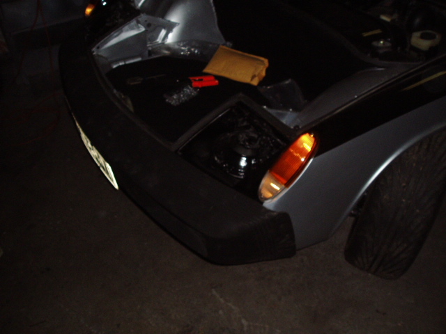

got the car running today, man she sounds wicked pissed! No rear exhaust yet. Seems the xr700 wasnt fully adjusted, got it fixed and she fired instantly. Also installed my euro marker lights, killer!
xsboost90
post May 21 2005, 08:09 PM
Post #176
Posts: 1,393
Joined: 2-August 04
From: cincinnati
Member No.: 2,432
(IMG:http://www.914world.com/bbs2/html/emoticons/clap.gif) installed

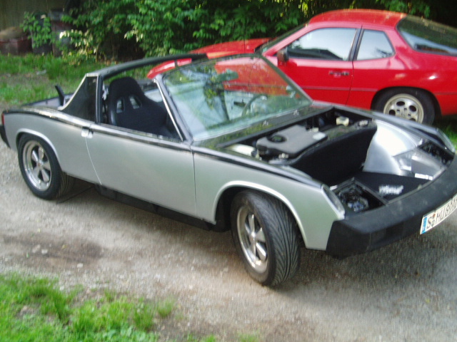

got alittle work done tonite, clutch cable installed, shift linkage installed minus my plastic cover im waiting on in the mail, and the ebrake cables are in but not installed. My bud cleaned and repacked my cv's for me tonite, got the ds axel in but still to do the ps and torque the splines back down again. I ''may" get to pull it out by its own horsepower tomorrow nite if i get some seat brakets done. (IMG:http://www.914world.com/bbs2/html/emoticons/smilie_pokal.gif)

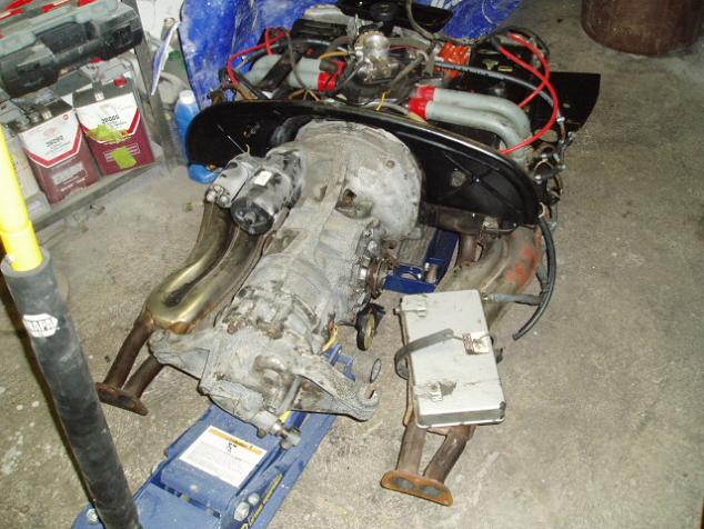

Question: my rear exhaust will not line up w/ the new motors heat exchangers. The new ones dont step up in the rear, they just go straight. THey also have a different pattern as for how they bolt up, the pattern is slightly wider. I have a show to go to in two weeks, anyone have a rear exhaust i can hang on there for a week until i can have my custom one made??? Any idea why this one is different?
mihai914
post May 23 2005, 10:09 PM
Post #179
Posts: 800
Joined: 2-March 05
From: Montreal, QC
Member No.: 3,697
The heat exchangers pictured are for a 2.0 engine, and you probably have a muffler for a 1.7 where the exchangers would bend upwards near the end of the pipes. You should look into a Bursh if on a budget for a new muffler or you can probably post a WTB add, there were some 2.0 mufflers available lately.
Mihai
xsboost90
post May 24 2005, 05:47 AM
Post #180
Posts: 1,393
Joined: 2-August 04
From: cincinnati
Member No.: 2,432
that would make sense, i guess someone had some 1.7 HE's on my old motor! They did bend upwards at the ends. Anyone have a stocker or something i can borrow for a week or two?
