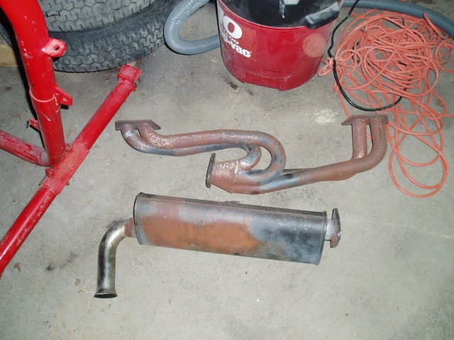

tomorrow time to clean the exhaust up, paint it and mount it up to see what she sounds like. Maybe put in the headlights and sand some stuff.
Anyone want a 1.7 rear section?

Well done sir! Glad to see you have an exaust that is workable. If the 1.7 is newer, with a little welding, you could use that muffeler section.

yeah i thought about that, but the flanges are different, and its more welding than i wanted to mess w/ right now. This one looks pretty good, need to get a collector gasket for the muffler, bbq paint it and throw it on tonite. Cant wait to hear it w/o the open headers. I keep having to talk myself out of throwing the primered hoods on it and cruizing it! Im going to try and get the black stuff primed and painted before sunday, a guy i painted this 53 chev truck for is putting on a "rat rod" car show and wants me to bring the teener. Its unfinished so i guess itll qualify right? Ill make that the maiden voyage!

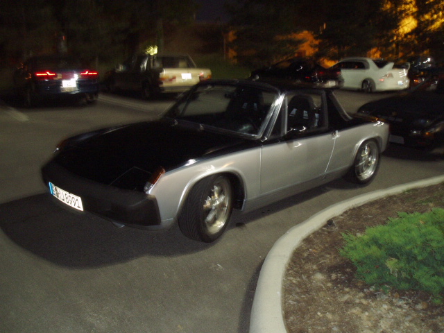

well i figured since a bud of mine was putting on a show today, i would slap on the primered hoods and take the car for a test drive up to the show. Made it to the show ok, but had a couple of issues to attend to when i got home. ONe was the car seems to sputter when you come to a stop, and when you go to take off, it hesitates, then takes off like crazy. The second problem was the rear tires. They were rubbing the rear fenders, slightly, enough to boil the paint on both the rear quarters. Sooo i had to take some camber plates out to get alittle more clearance from the wheel wells, and the sand down the burnt spots on my quarters. Ill be respraying the quarters as well as the roof, rockers, valance and hood/trunk/ hood this week. I reset the electronic ignition timing to double check the adjustment and the timing of the distributor. seemed to run alittle better..
heres a question. theres two places to hook vaccum to the advance on the dist. Now most pics show the hose going to the rear of the advance, like closest to the cap. This seems like it would retard the dist, instead of advance. I put mine on the outside of the dist, seemed to keep my motor from pre-igniting/knocking and runs slightly better. set the computer "knob" to full rich and turned up the idle air screw. Seems to keep a better idle now when coming to a stop. Opinions on how to set this w/o a machine-digital sun analyzer?

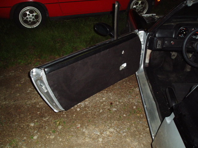

more progress last nite, got all the rest of the black stuff painted. Today i took the day off, ill be buffing and assembling. Also got my bronze bushing for the trans linkage so i can finally put all that back together w/ my new linkage cover! Pics from last nite w/ the door panels my g/f reupolstered in suede, shweet!
xsboost90
post Jun 2 2005, 07:02 AM
Post #216
Posts: 1,393
Joined: 2-August 04
From: cincinnati
Member No.: 2,432
ds door

drove the car today, to dayton,50miles, back 50miles...then to dayton for a cruise in...then back. Did pretty good, leaking alittle from the crank seal on the front.
