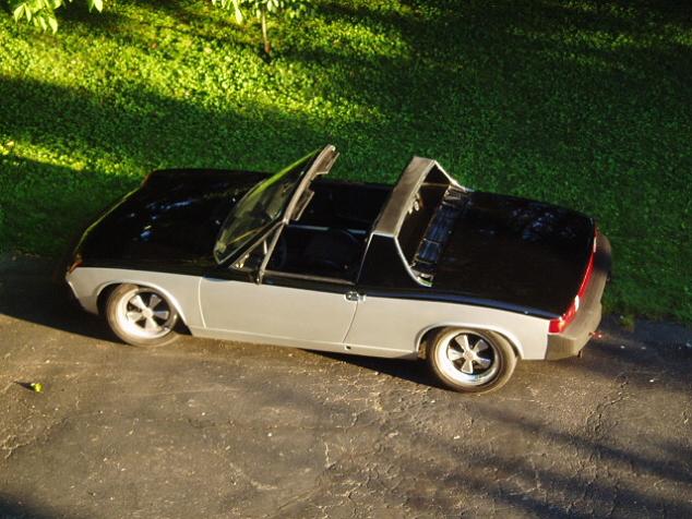

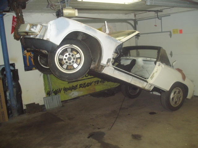

ill go ahead and introduce myself as im a regular on rennlist and recently more on here. My name is dan(xsboost90) since i used to be big time into turbo mk3 supras. Got my first porsche a year ago-89 944 and after doing alot of work/paint etc..traded it for a 924s and a 76 914 2.0. Now im in the process of rebuilding from the ground up this car including cutting out some rust-not too bad someone had already done alot-PO owned a body shop- but missed some in the floor and fenders. I also purchased a motor which has already been totally rebuilt w/ very little milage and a cam from someone local who needed more-200hp 2.0 rat motor!!- for their project. Ill go ahead and start a thread and try to keep its progress posted for those who find these things handy. I also have a couple of pics of what i plan on it to look like in the next couple months when i paint it..yes im a jack of all trades so to speak. Thanks, stay tuned. (IMG:style_emoticons/default/driving.gif)

xsboost90   i threw a "pull the motor out party" this saturday...   Nov 14 2004, 08:54 PM

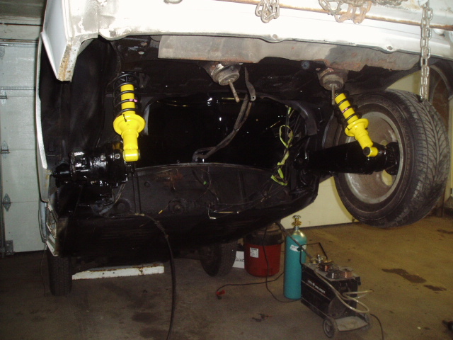

xsboost90   now i have the rear suspension out and im going to...   Nov 14 2004, 08:57 PM
914GT   My kind of party! I'd like to go where I ...   Nov 14 2004, 08:59 PM

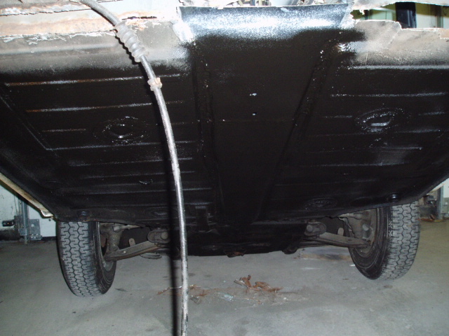

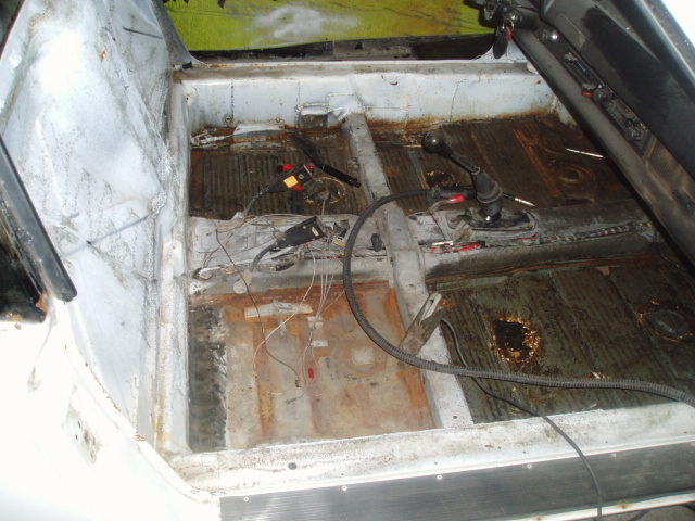

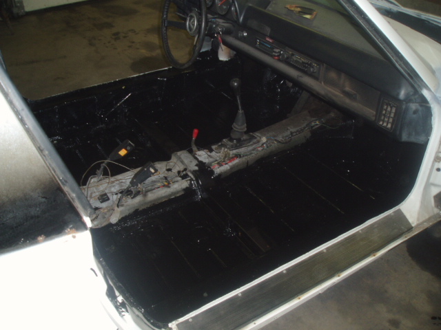

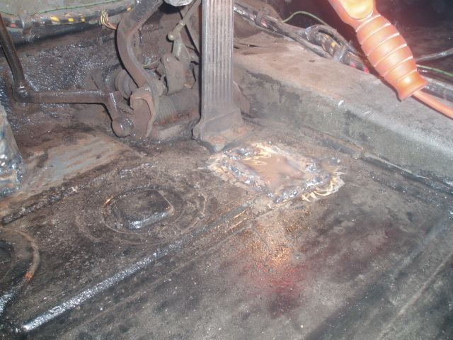

xsboost90   got the floor all cut out the other day and ready ...   Nov 17 2004, 08:55 PM

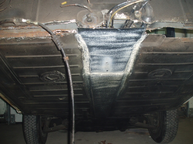

xsboost90   made a patch panel for the center and welded it al...   Nov 17 2004, 08:57 PM

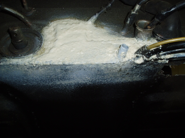

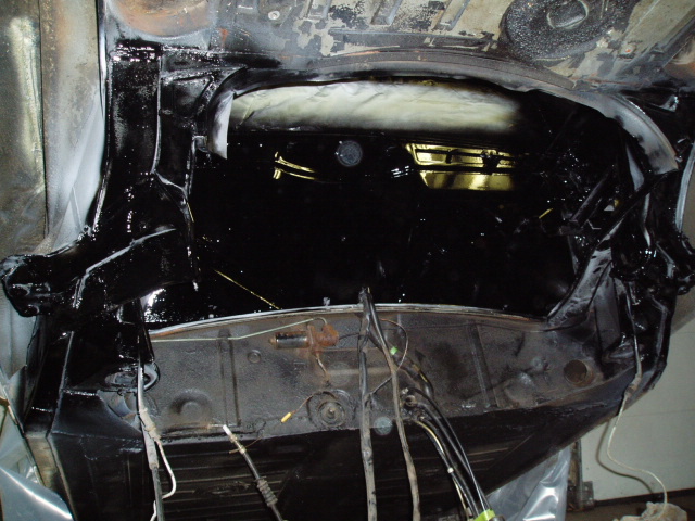

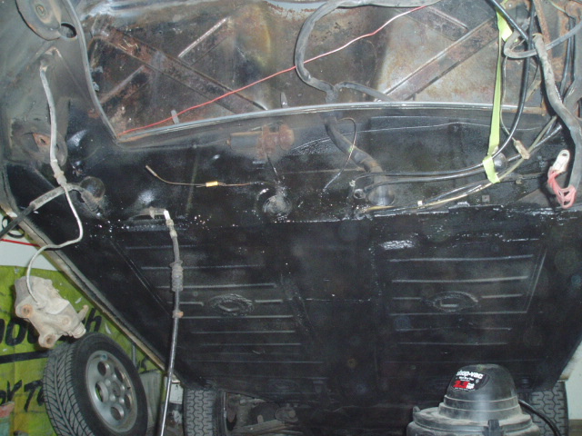

xsboost90   sprayed some rust preventer stuff all in the entir...   Nov 17 2004, 08:59 PM
xsboost90   and w/ the undercoat...cant wait till the whole bo...   Nov 17 2004, 09:01 PM

Bleyseng   Nice pics and yes, ditch the crappy adapters and g...   Nov 19 2004, 11:37 PM

xsboost90   i got three of the four adapters for five lug when...   Nov 26 2004, 05:37 PM
xsboost90   yeah! ordered my five lug rear hubs from eric ...   Dec 2 2004, 11:56 AM

Eric_Shea   Glad they made it! :trophy: From looking at...   Dec 4 2004, 11:58 AM

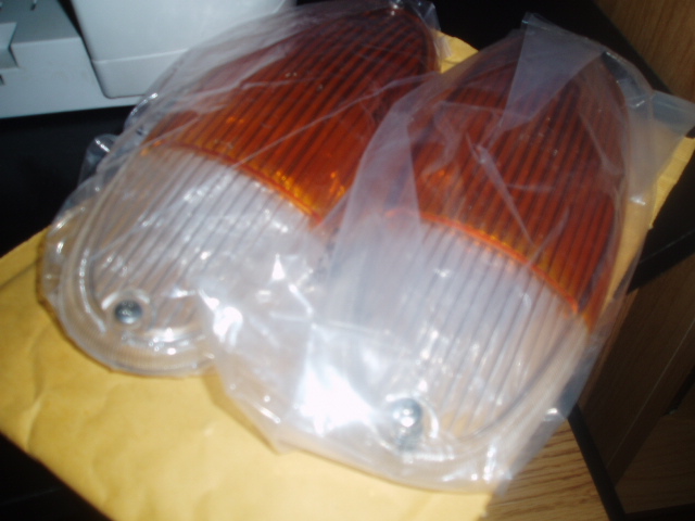

xsboost90   collectiing parts lately, heres my euro markers, a...   Dec 26 2004, 09:56 PM

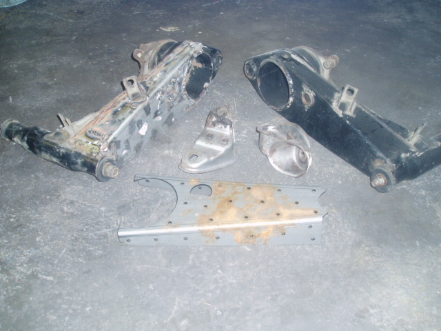

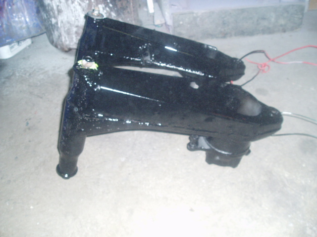

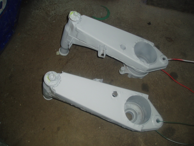

xsboost90   got my braces for the rear arms finally today, alr...   Jan 3 2005, 10:40 PM
xsboost90   got the second arm all welded up. Those little hol...   Jan 5 2005, 10:54 PM

xsboost90   ok so still working on the swing arms-may get them...   Jan 8 2005, 09:33 AM

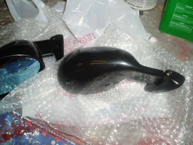

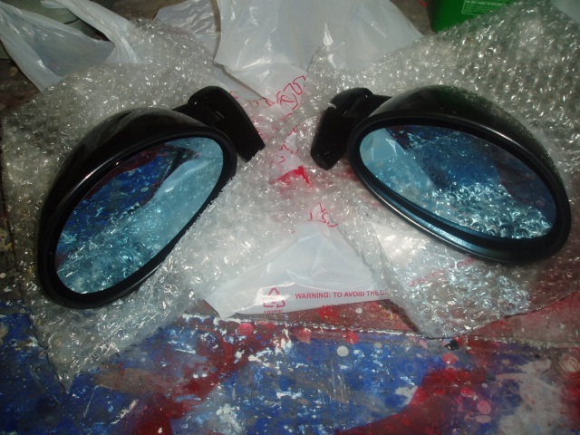

xsboost90   heres my mirrors- manually operated no cables or a...   Jan 8 2005, 09:34 AM

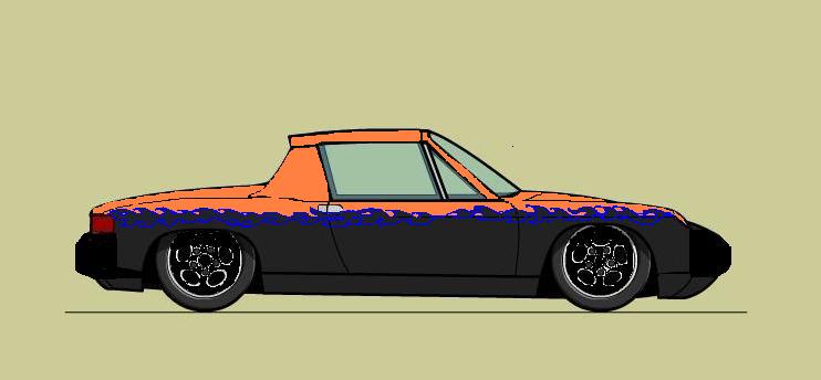

xsboost90   what if the paint scheme looked more like this????...   Jan 8 2005, 10:28 AM

xsboost90   got my arms all painted up tonite, will be hopeful...   Jan 8 2005, 08:34 PM

CptTripps   Did you scrape everything out of the wheel wells b...   Feb 19 2005, 09:28 PM
xsboost90   i tried a bunch, best out there is 3m, the big can...   Feb 19 2005, 10:38 PM
CptTripps   I've got a can of the NAPA stuff, the DynaMat ...   Feb 20 2005, 09:32 AM
xsboost90   i wire brushed the old stuff off and roughed up th...   Feb 20 2005, 09:36 AM

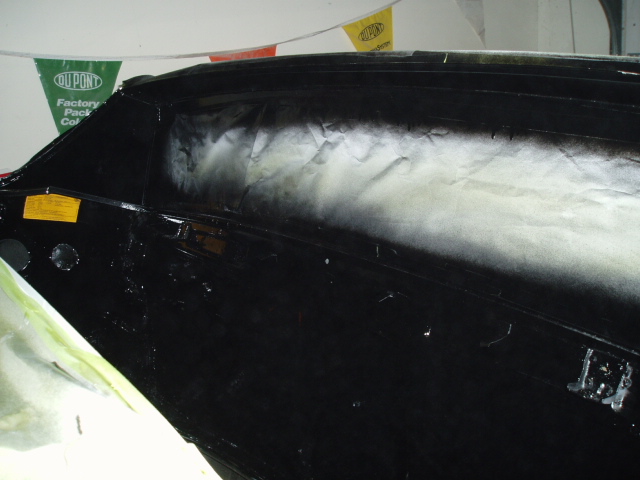

xsboost90   got the quarter stipped and sanded completely, sti...   Feb 26 2005, 07:43 PM
xsboost90   drivers quarter is perfect but the ps has some dam...   Feb 26 2005, 07:46 PM
